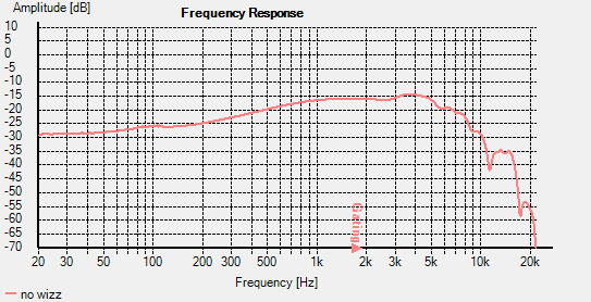

Also, how do you remove the dust cap, by using a sharp knife and cut around the cap? That is like a surgical cut.
Yes - I use a sharp craft knife and rotate the speaker. Sometimes I put a large bass signal through the unit and then hold the knife still whilst the speaker does the work.
I haven't got the graphs of the effect of dustcap easily to hand but the one thing one has to avoid is a cylindrical void in the middle of the voice coil. That is best capped off.
Here's a fullrange unit without whizzer
attachment.php

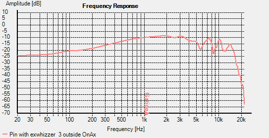

With whizzer as original
attachment.php

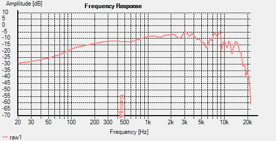

With enlarged whizzer and phase plug
attachment.php
Ignore response below 200hz in these graphs.
