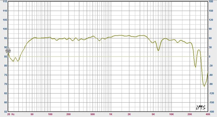

Here's a couple of piccies of the Queensway driver that has my curiosity:
There's a dip in the treble region - apparently our ears are forgiving of dips but not peaks.

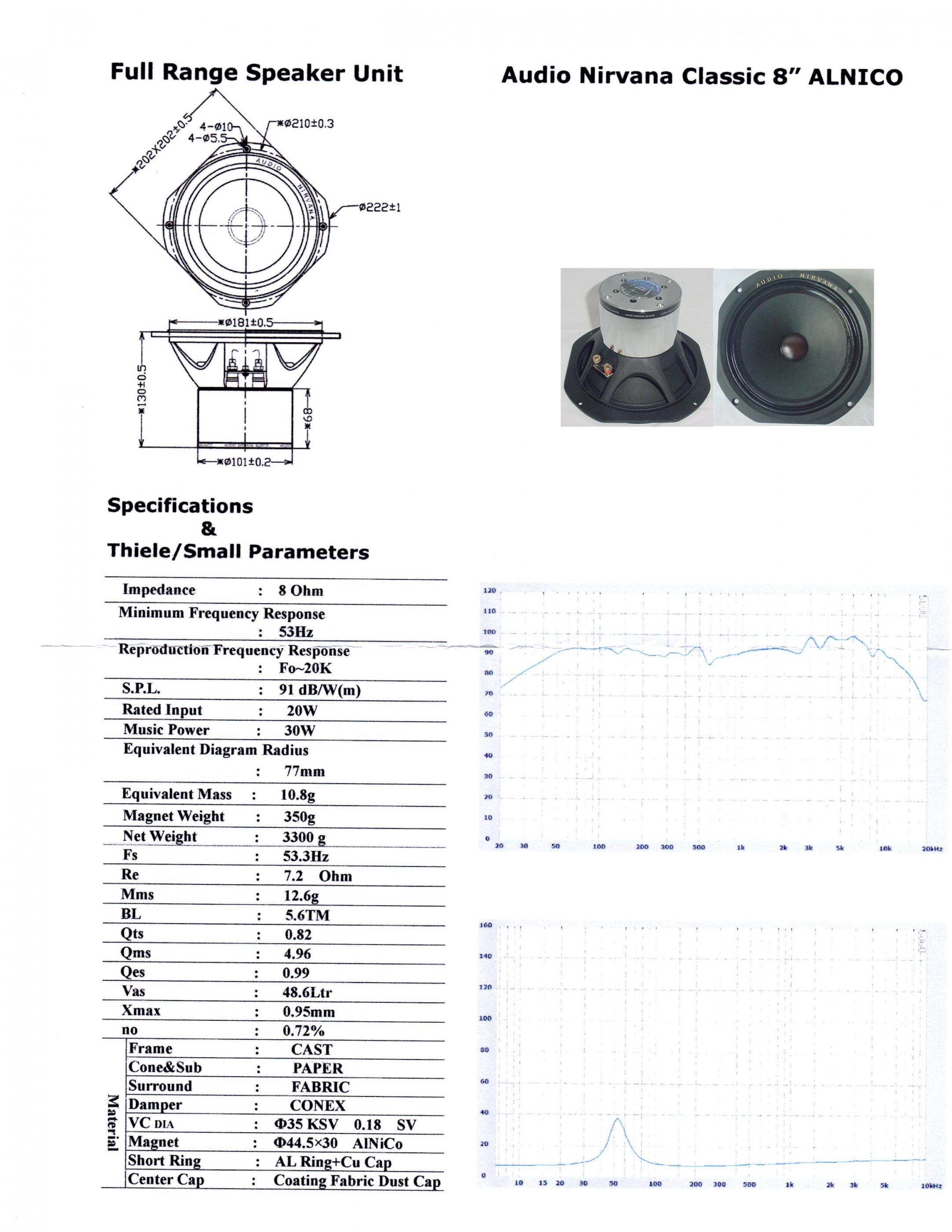

seems I stuck my nose in that thread but nothing came of it. It has a lower Qts than the Audio Nirvana, which helps make for a smaller box. But Vas is double the AN so it's a wash. One with whizzer, one without.
fyi - uploaded the AN classic 8 spec.
