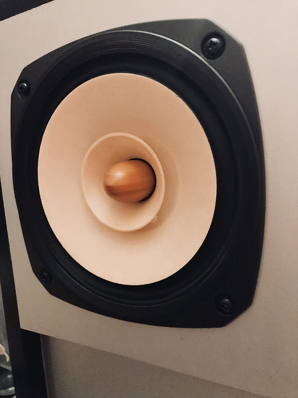

Fostex FE206E with phase plug
Hi everybody,
My first post on this forum!
I took a bold step a while ago: I completely cut away the center dome of my FE206E speakers and installed a wooden phase plug directly on the magnet. An extremely delicate job! The sound "opened up" and especially the dispersion improved a lot! I don't remember where I bought the phase plug anymore. (A US company)
I have become very fond of this speaker.
It is in Tony Gee's (Humble Homemade HiFi) Solo 206.
Tony is the man behind extensive speaker capacitor tests. See his website.
http://www.humblehomemadehifi.com/download/Humble Homemade Hifi_Solo-206.pdf
The speaker frame was strengthened with duct sealing compound and the magnet is covered with thick felt.
Great speaker, especially on tube amp and vinyl.
I might replace it one day with a Tangband W8-1772. Does anybody have any experience with the Tangband in a BLH like the Solo206?
