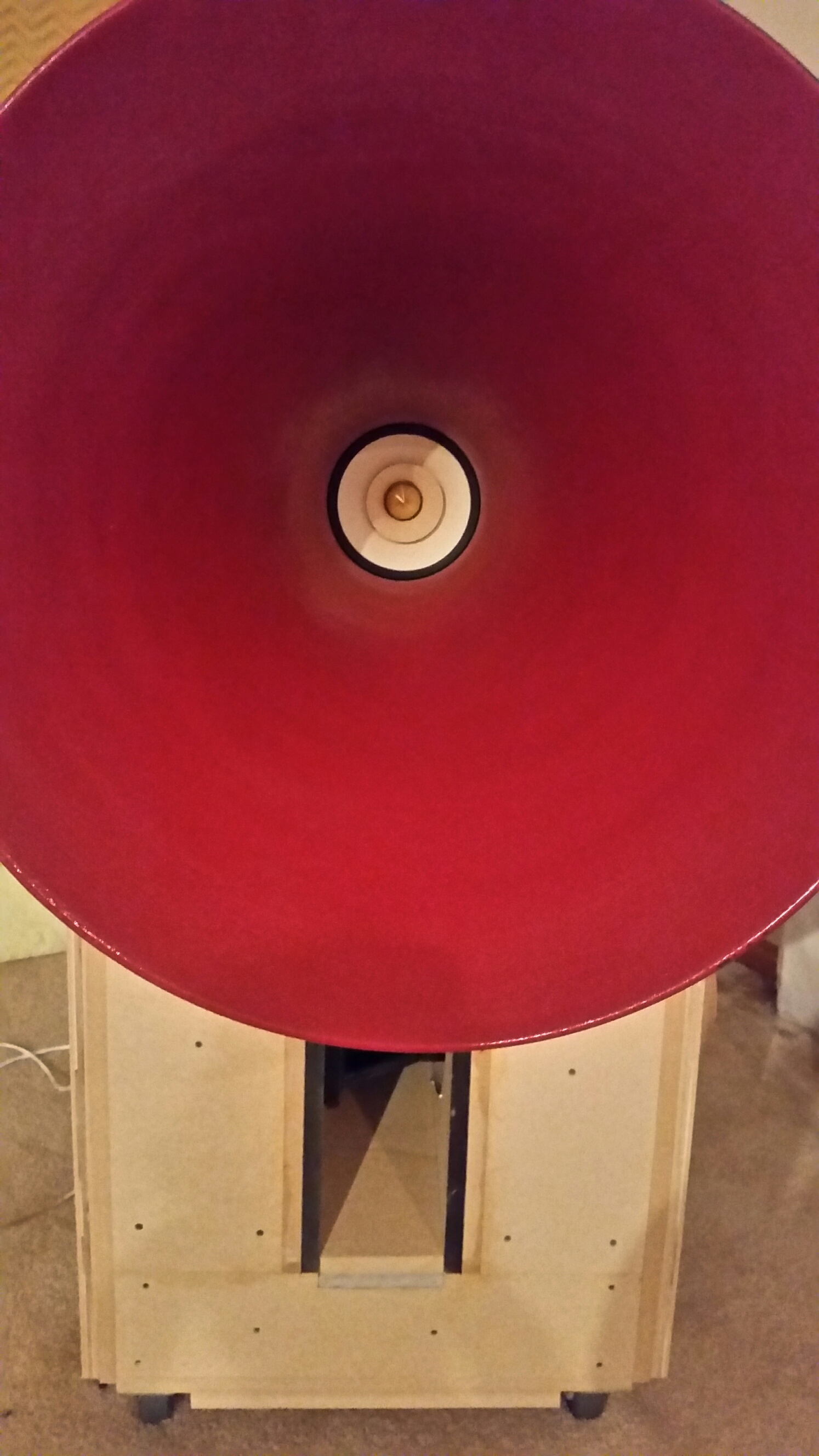

It really is a 7" in an 8" basket size. Mine, seen here: http://www.diyaudio.com/forums/mult...ed-driver-you-have-worked-16.html#post4333695
SUPRAVOX 215-2000 EXC in big horns 😱

I've never heard lowther loudpeakers and in only use class D amps with medium to very low efficiency loudpeakers at home.
I was a little doubtfull with the 215-2000, his motor was very hot.
Almost too hot to touch (lauthing out loud in my head) and i've listened Martin Logan electrostatic big pannels just before (absolutely fantastic loudspeakers).
My head stopped to laugh immediately after the music starts, it was extremely energic and natural, the lows were amazing for a 21cm driver.
It was these ones :
http://ebenisterie-musique.fr/Docs/Lembda Piel.pdf

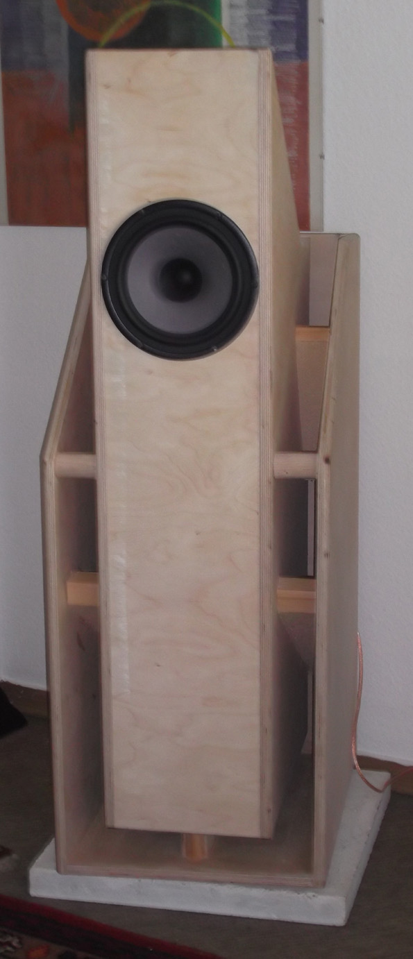

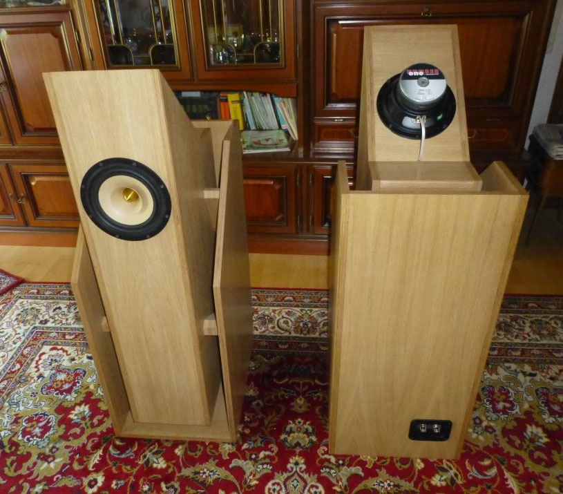

Hello,
i listen until 1980 mainly 8" FR, i found that there is no best driver, a lot of driver sound and measured nearly equal.
for example the B200 for classic listeners, because no whizzer cone, end ~12kHz, but Rms ~0,4 very good for low level listening.
Seas Fa22RCZ, superb, best mids because the membranmaterial and the small HT cone.
Sica 8 D 1,5 CS 8, for the money excellent, dust cup.
TB W8-1772, superb, but Rms ~1,6, at very low level you can miss details.
all drivers show on IEC baffle a rising response over 1000Hz, to taime it passiv is possible,
but not a must. i developed the double horn technic: ad an different driver invers indirect, to fill up below ~ 1,500 Hz, to get full SPL, low level of membranmovement and a better soundstage.
look my HP double horns, with feedback, measurements and plans.
a lot of driver have only Xlin. 1 mm that´s even in a horn most time enough for one Watt,
but it limits the bass and in single horns also at ~150 Hz the performance,
so they are not the hit.

Your baffle is original and beatiful.
There are two separate horns ?
The surpression at the end of the horn d'ont affect the fillrange membranne ?
yes,
look the measurements of the Kornet, and below the single simulations

Two separate horns... clever desing.
The only flaw is the baffle depth of 600mm... it is too much for me.
It should be perfect is the baffle were reduced at 300mm depth and raised around 1800mm.
Is this possible ?
no came back from open baffle
Some designs are attractive
My acutally listening room is a cube of 8m² and my Orions d'ont work great in this small environement... i'm trying to find a small room design.
silverprout, you can get "every" design you want.
A world of infinite possibilities, great !
