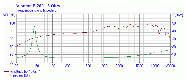

My experience with the W8-1772 is that is takes lot of series resistance in teh BSC filter to make it sound right. To me, the 1772 has the best overall sound of 8"ers I've tried (not the Exotic!). The FF225WK sounds better up to a point, but has to have a tweeter.
Bob
I also like the sound of my 1772, but they do indeed need help. I went the DSP way instead of playing with a bunch of hard to get components in my corner of the world. They can surprisingly handle a wide range of music styles.
If you look at the on-axis FR from Visaton, you see a maximum of about 100 dB up high and just under 90 dB at 500 Hz or so. If you listen to a set off-axis you are asking "these are good, but i wonder what a tweeter would add", listen on-axis and it is "ouch, those are hot, too hot".
Adding the phase plug disperses that rise in response, they have a much wider, smoother, even HF response (you can go from side to side behind the listening couch in my room and the top changes little).
The measured sensitivity is 89-90 dB.
dave
dave
