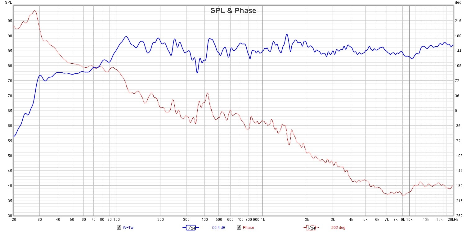

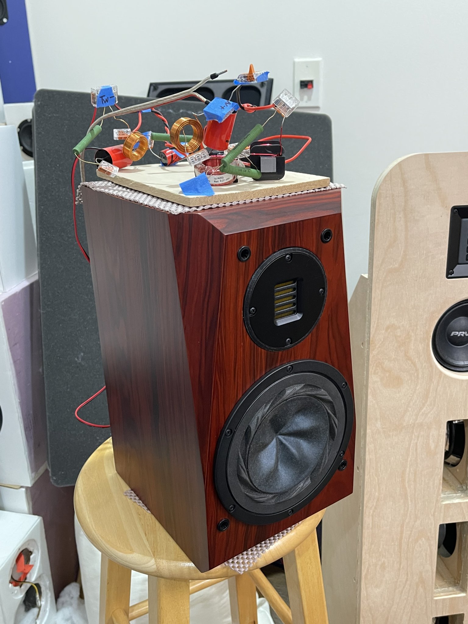

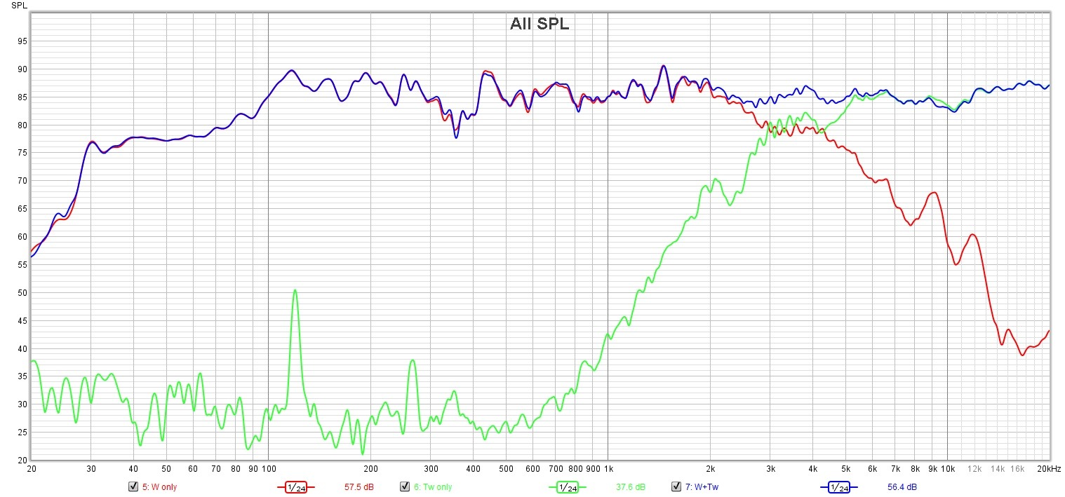

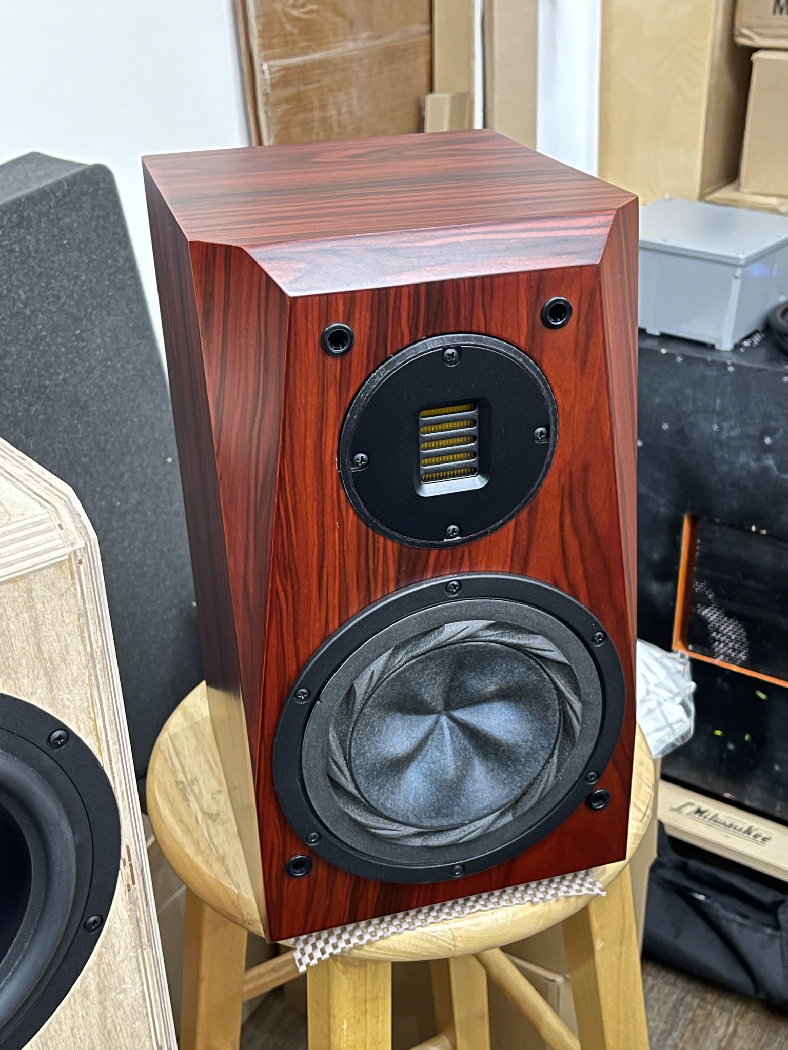

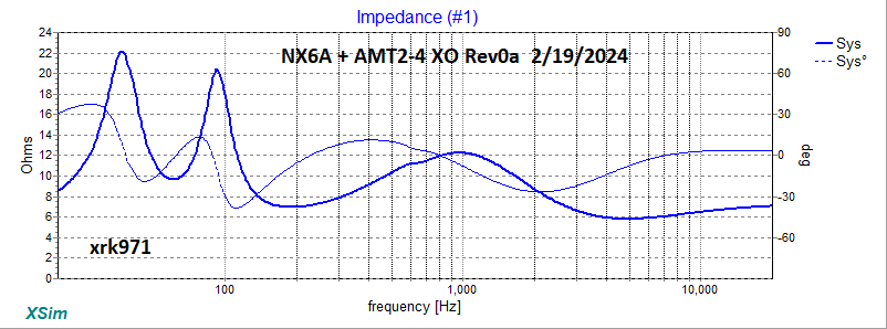

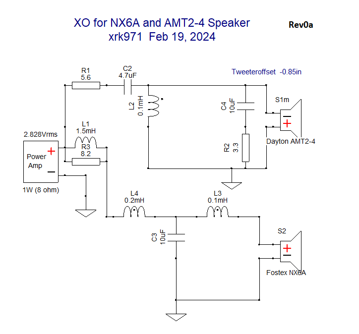

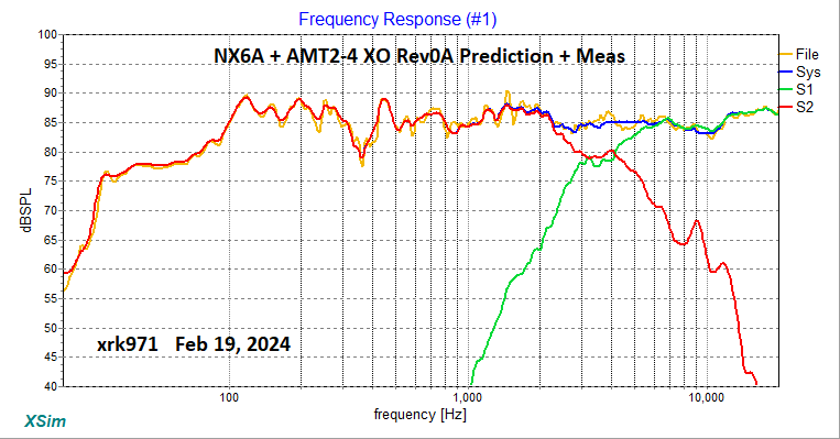

I have the first cut crossover built and listening to it now. 3.5kHz symmetric higher order. Nice smooth phase variation through XO region. Low distortion overall. Very good overall sensitivity of 86dB at 2.83vrms and 1m.
Predicted and measured (orange) frequency response:
Predicted impedance shows box tuning at 61Hz and never dips below 6ohms:

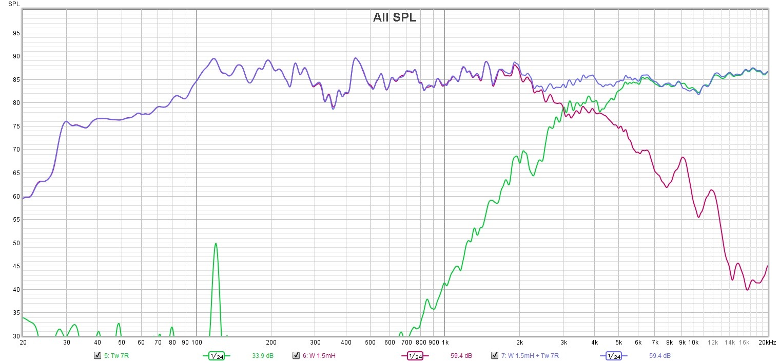

Measured XO response in detail:

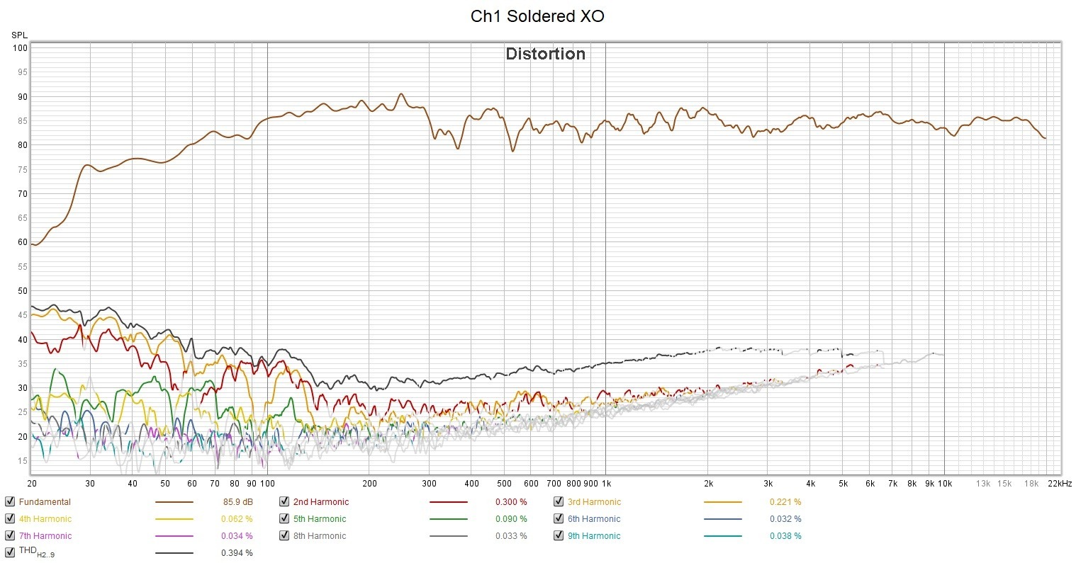

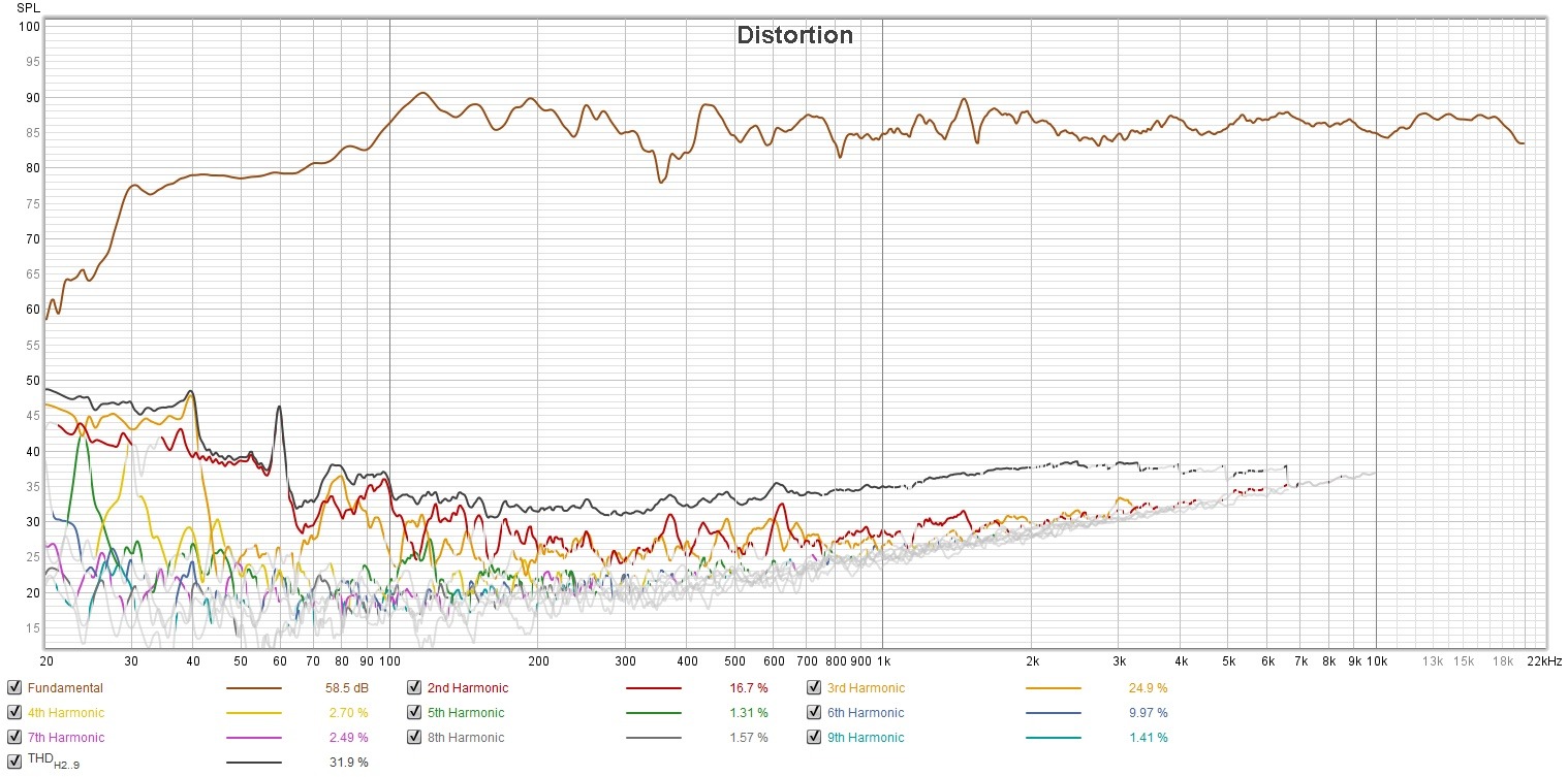

Measured Distortion (2.0Vrms at 0.5m):

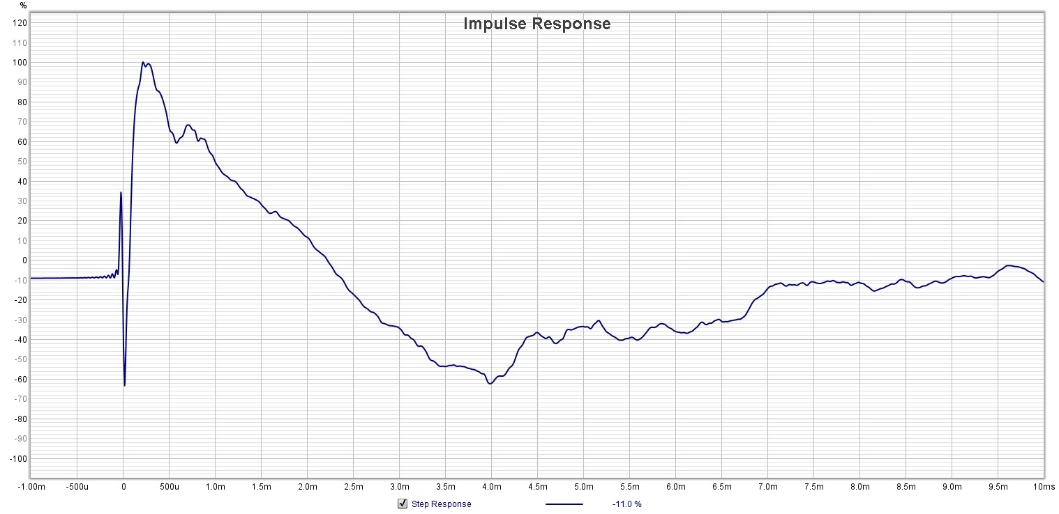

Step Response almost looks like idea right triangle - indicative of good time alignment for good transient snaps:

In measuring the drivers for the XO I accidentally stumbled upon quantitative evidence of break-in. The distortion in the woofer at start was awful. I thought I had a rattle or something stuck in the voice coil. But after playing 45Hz for 5min it went down a bit. I let it play 2.8vrms of 45Hz for an hour. Distortion (nasty 3rd and 5th) went down by 15dB in 150Hz to 700Hz range. Dramatic.
Might still improve a little even who knows. Suspension loosened up is all I can think of.

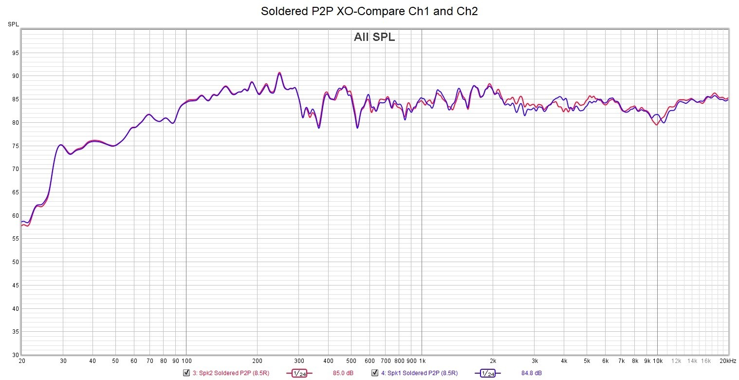

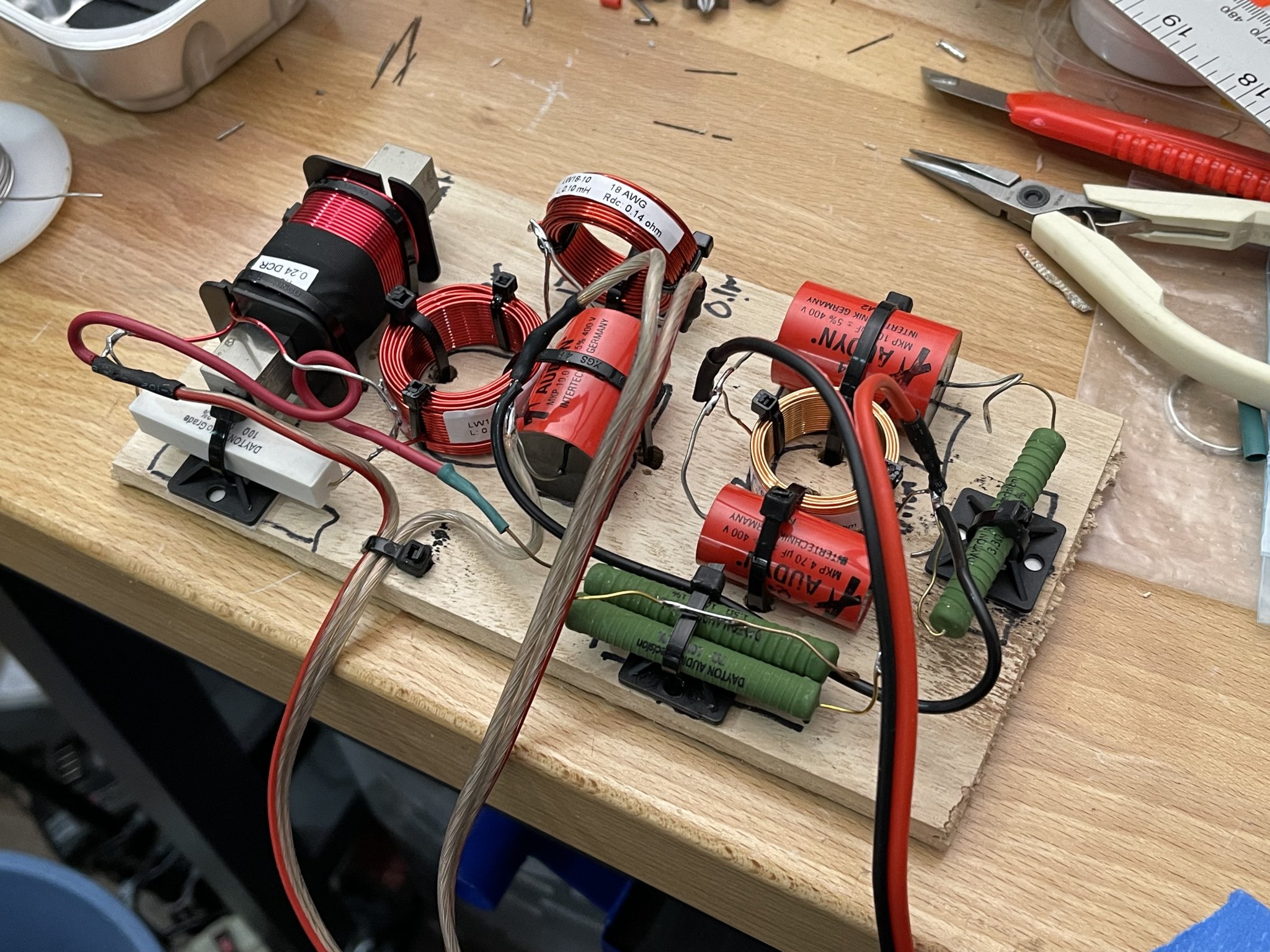

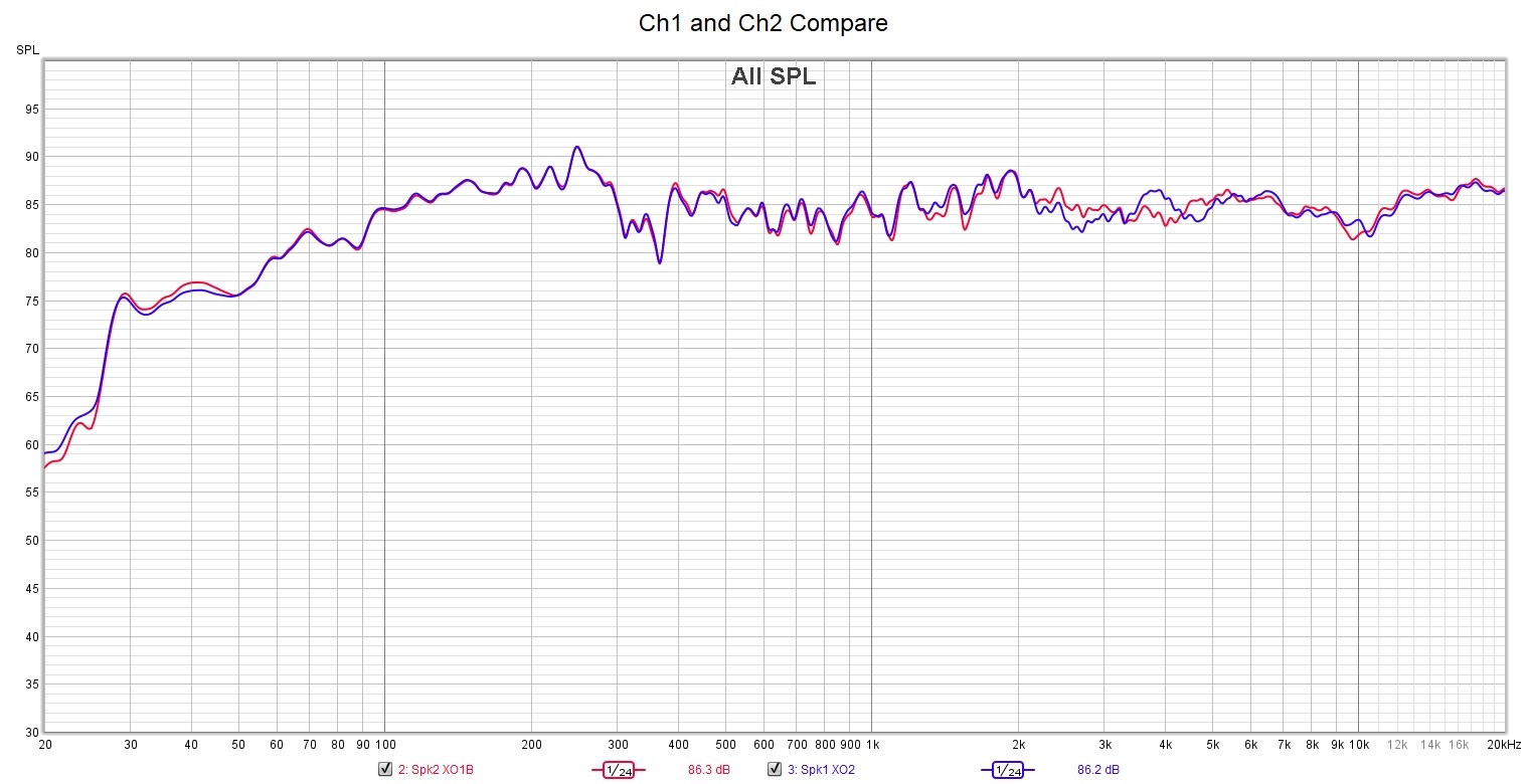

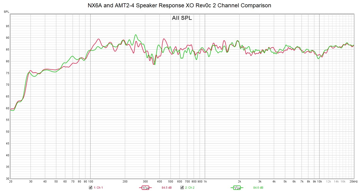

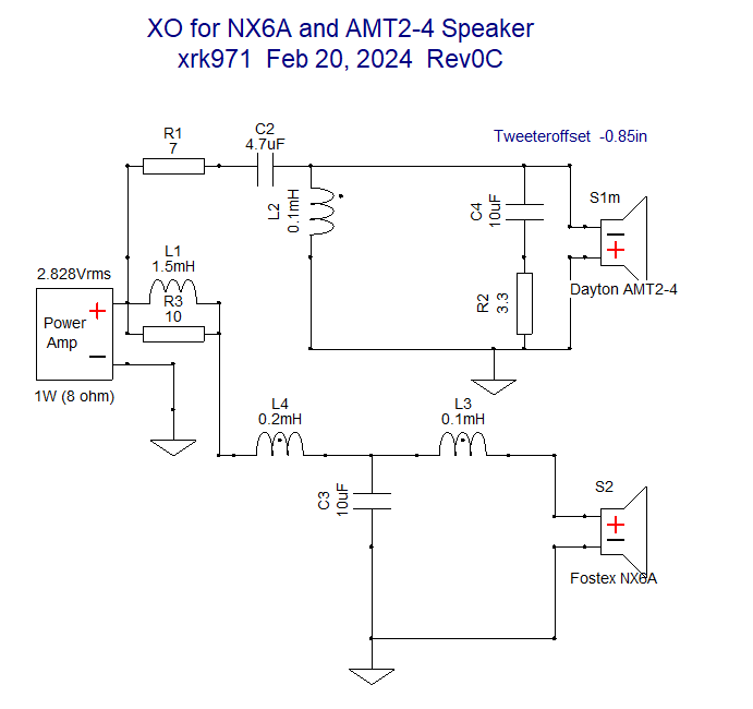

On the bench last night and tonight was the second channel of the Fostex NX6A / AMT2-4 speaker that I have been working on. I built up the second crossover and got a much smoother measurement of the bass response around 100Hz. It did not have the peak and rapid falloff.
The green is the second speaker with the second crossover. The red is the first speaker with the first crossover.
This puzzled me so I put the second crossover onto the first cabinet and the strange behavior went away! The only difference was the screw terminal block I was using (steel contacts). So I redid the crossover without the terminal block and the measured response between the two speakers is nearly identical in the woofer bass range.
This bass behavior is much nicer than before. A smooth shallow falloff without the sudden jump and a bump near 120Hz. The lesson here is not to use steel connectors or terminal blocks on crossovers!

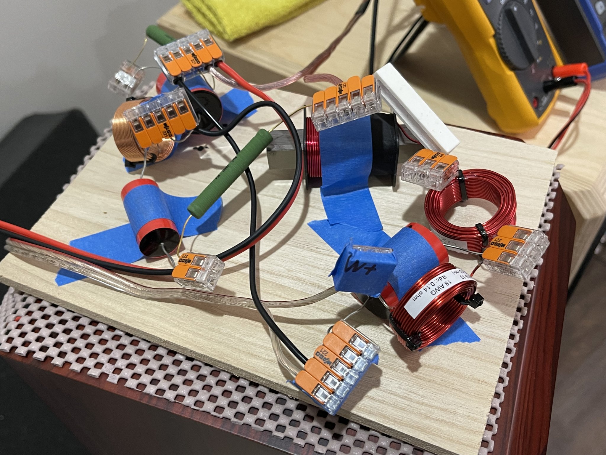

Here’s the crossover without the steel terminal block. All Wago connectors. I’m going to do about a week of long term listening and adjust voicing to see where I want the tweeter padding level to be set at.

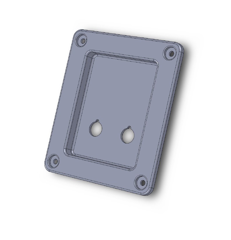

Do you mind going over the basic details and operation of ‘Solid Works’ as well as 3D printing in general? I see you used SW and a 3D printer for the tweeter bezel as well as a binding post cup, both of which look very nice, especially for small hobbyist and prototype work! Some questions would be:

Making something like the bezel adapter requires drawing a circle sketch, then extrude it to a “boss”, then cutting into it like a milling remove material operation by drawing another circle, then cut holes for the screws using same remove material operation. Followed by a chamfer operation. Drawing precise dimensioned CAD sketches is key and those concepts using construction lines, offset, extend, trim, mirror, make array, etc all come in handy. The tricky things are compound curves, blended curves to flats etc. more advanced stuff takes time to develop the skills to make on CAD.

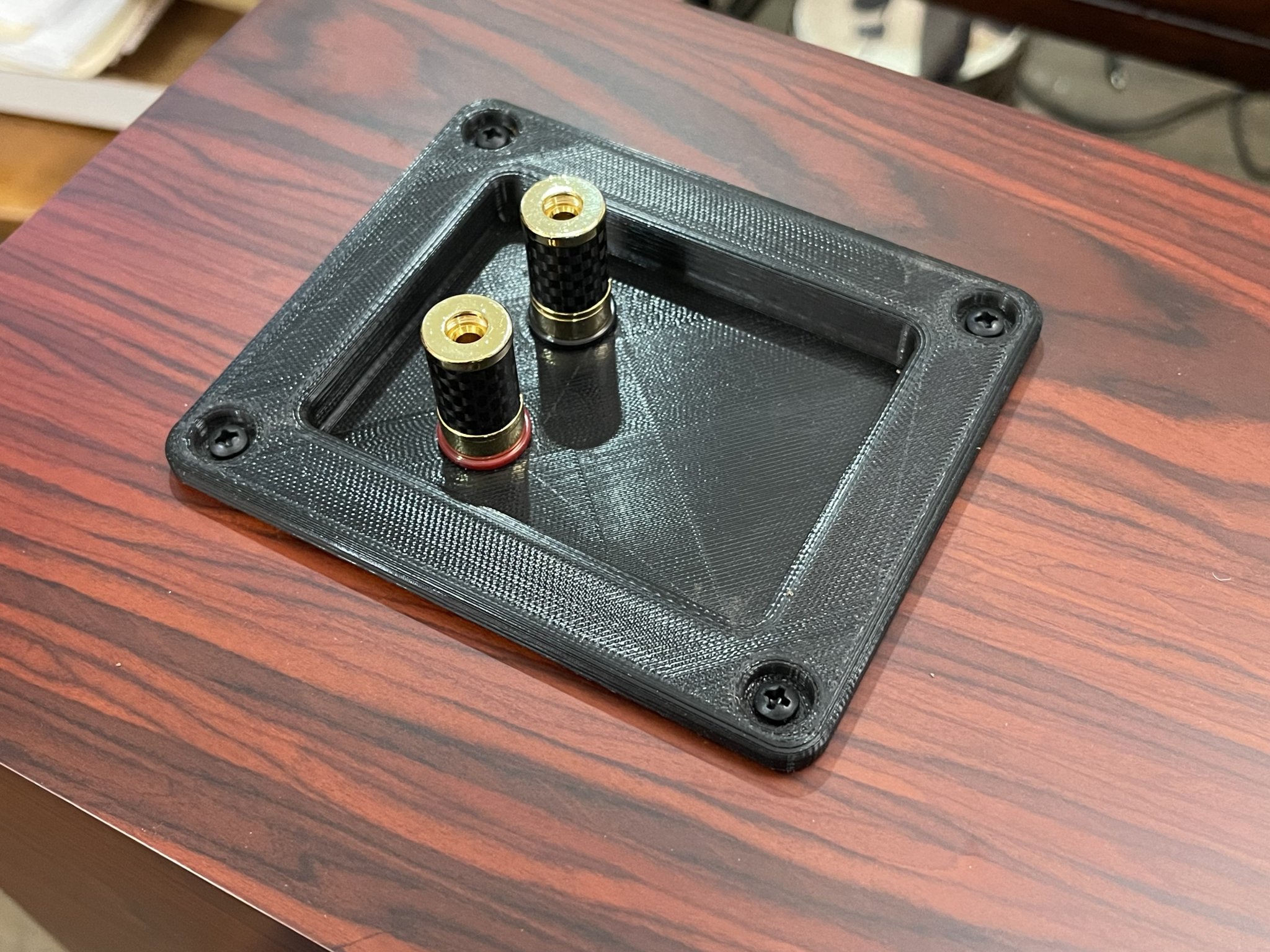

To give you an idea of effort involved, the binding post plate took me 20 min to make in SW but 4.5 hrs to print because I made the walls 2mm thick and there was a lot of support structure underneath. It turned out well though:

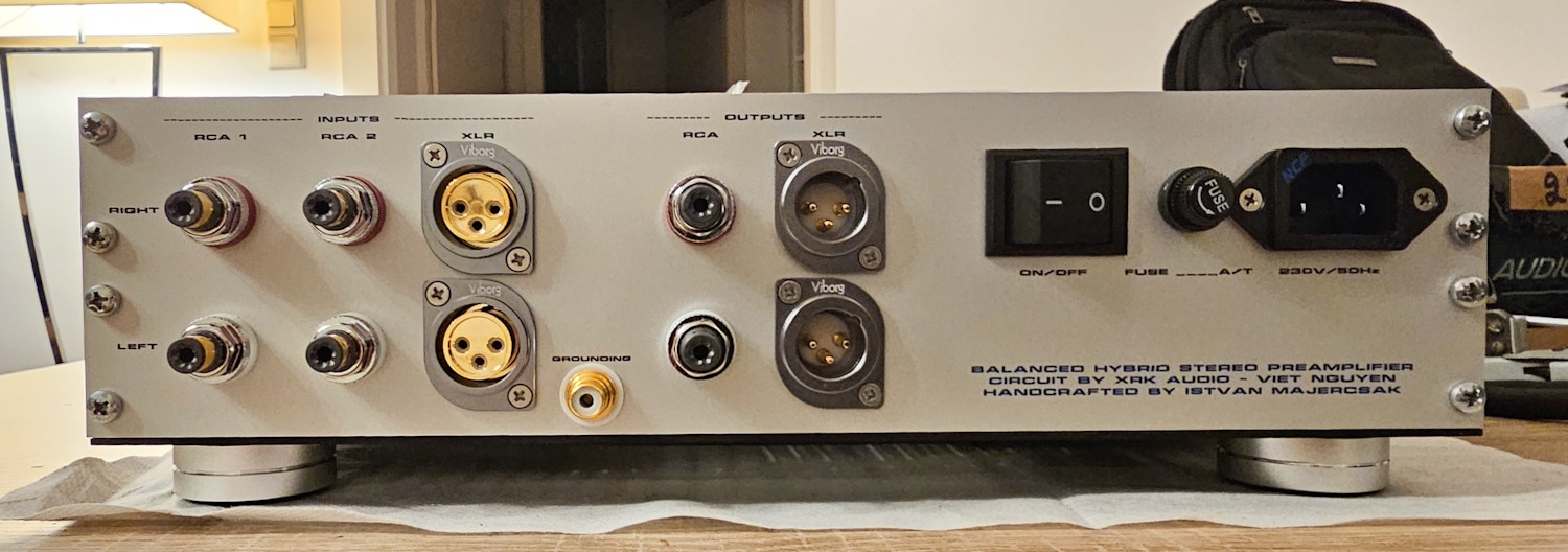

Hi Plott,
Wow, you have done an amazing job! Looks fantastic. I love the layout - you have an excellent sense of balance and placement. I couldn’t have done it any better. Thanks for the attribution on the lettering.
I see you are using Viborg XLR’s. They look great. I have mostly used Neutrik but these look nice and premium because they are all metal and grey color. Nice!
Looking forward to hearing your listening impressions and more photos!
Thanks!
X
Joined 2021
Hi X,
many thanks, glad you like it! I really like to design layouts:D
Yes, the XLRs are Viborg, they have a great price/performance ratio; the RCAs are Furutech as is the IEC inlet.
Tomorrow I will get all the panels, so I think the first listening could be tomorrow in the very late evening hours.
As I wrote, the test bed version was very very promising, so I'm really looking for the listening in my system.
Pictures will follow, of course.
