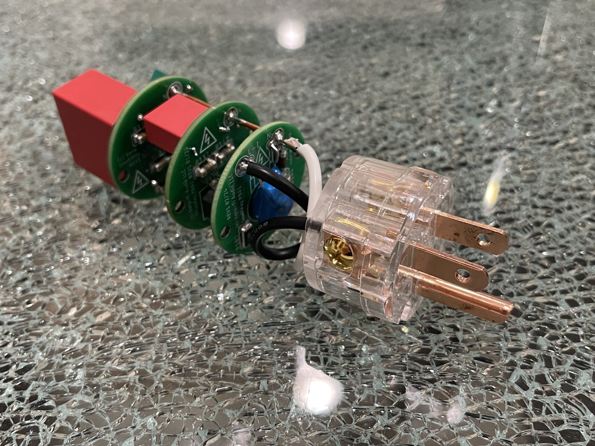

On the bench is a new SnubWay Noise Defender mounted in a Viborg acrylic plug base with solid copper blades.

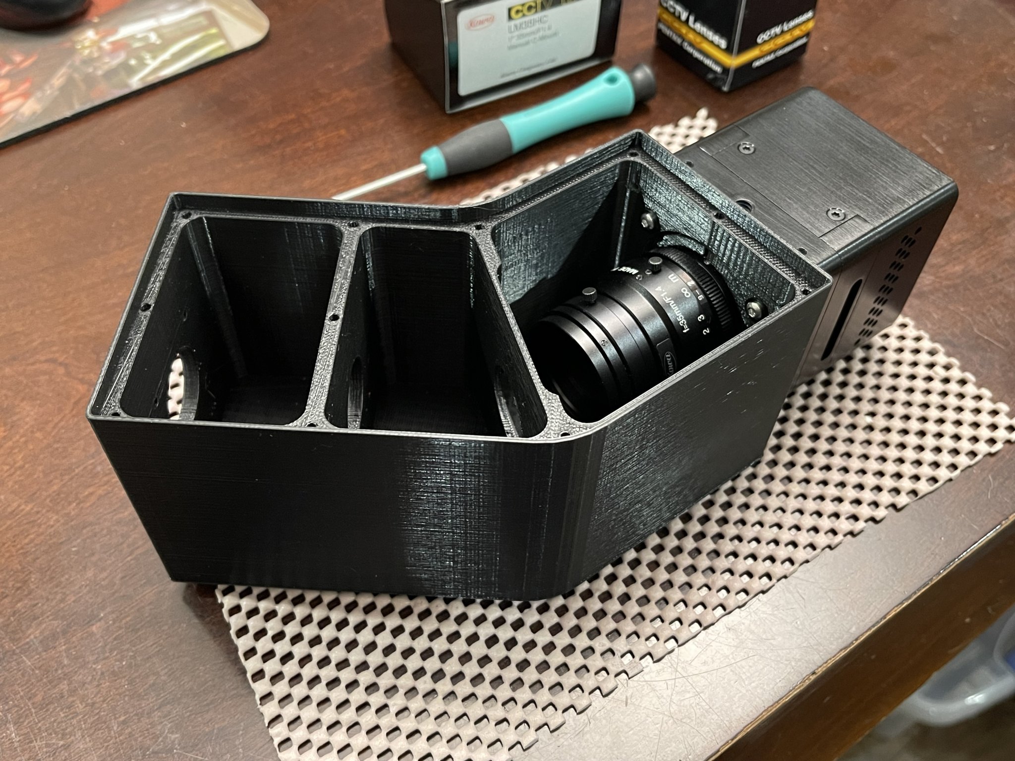

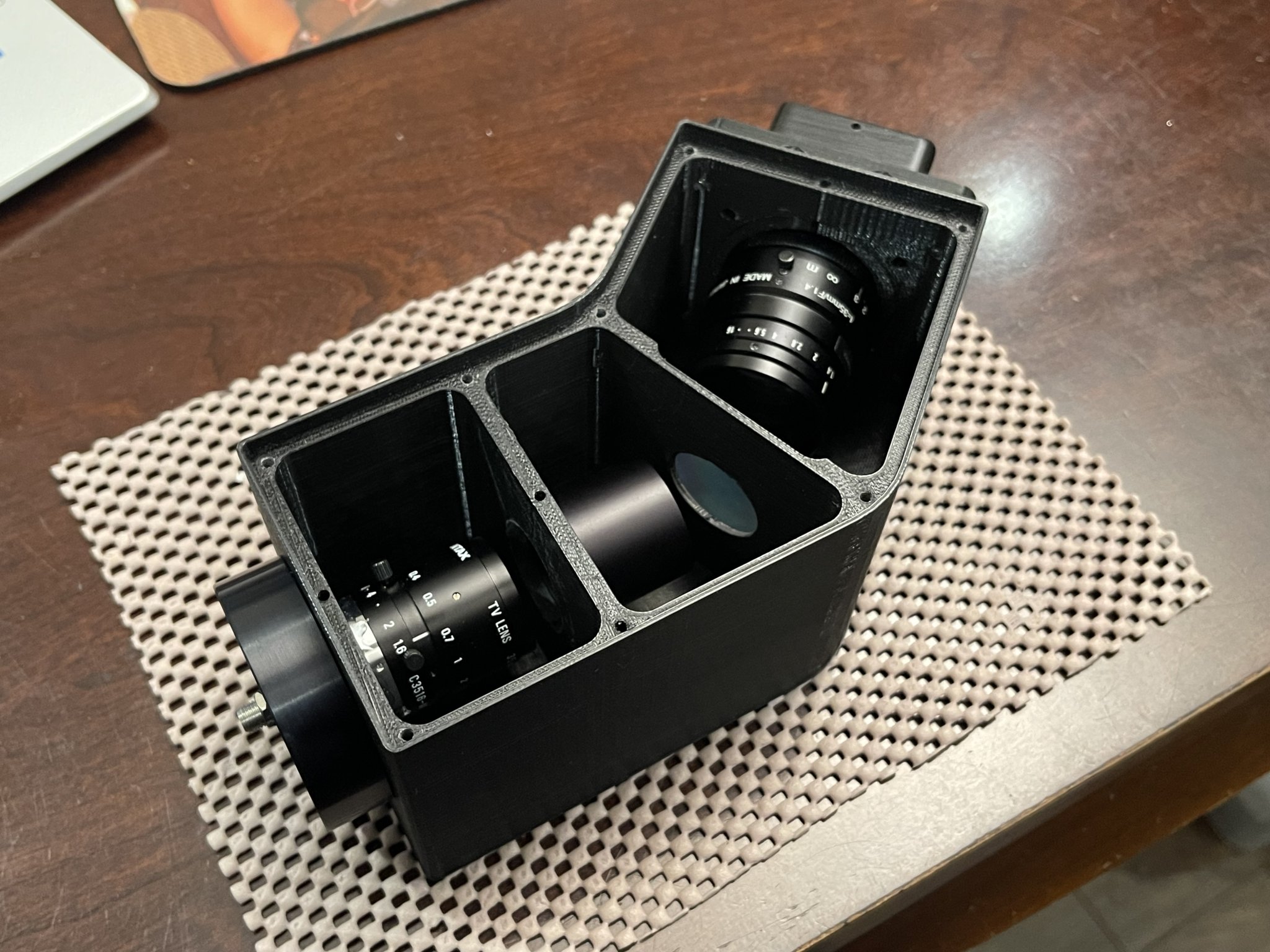

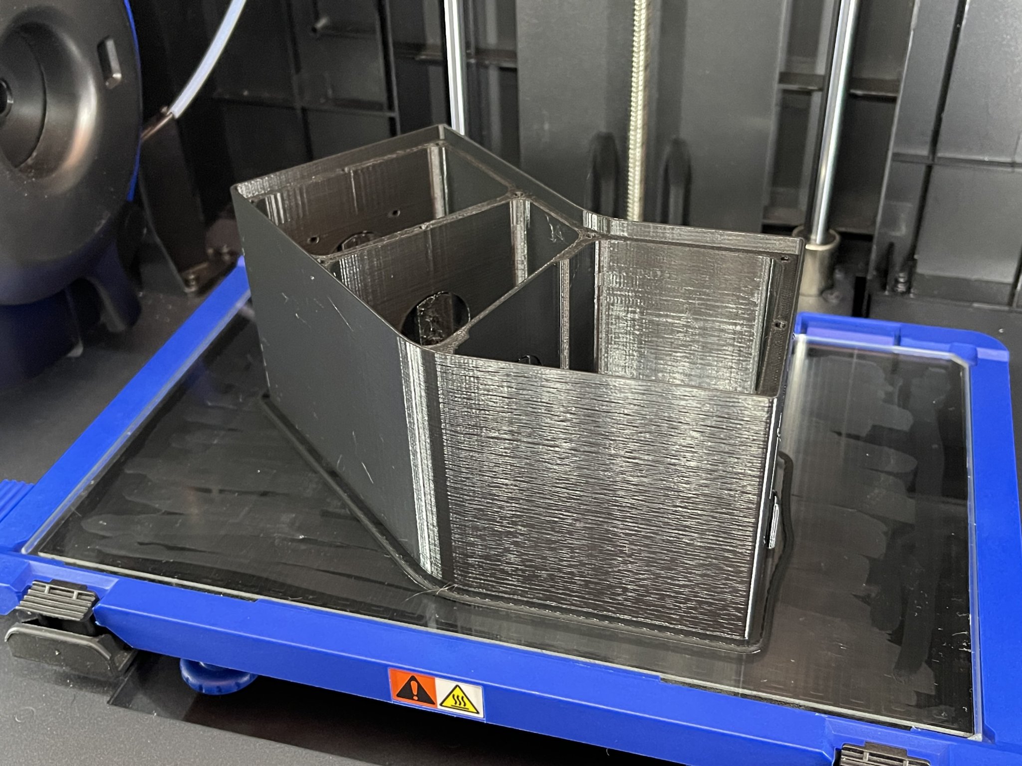

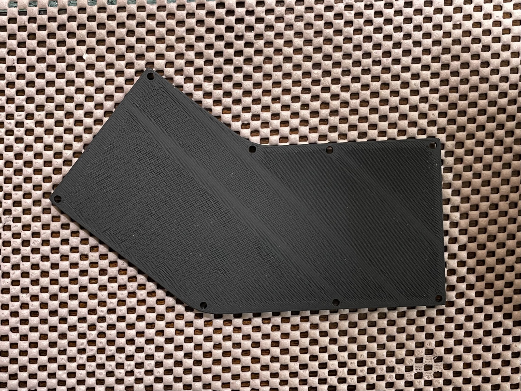

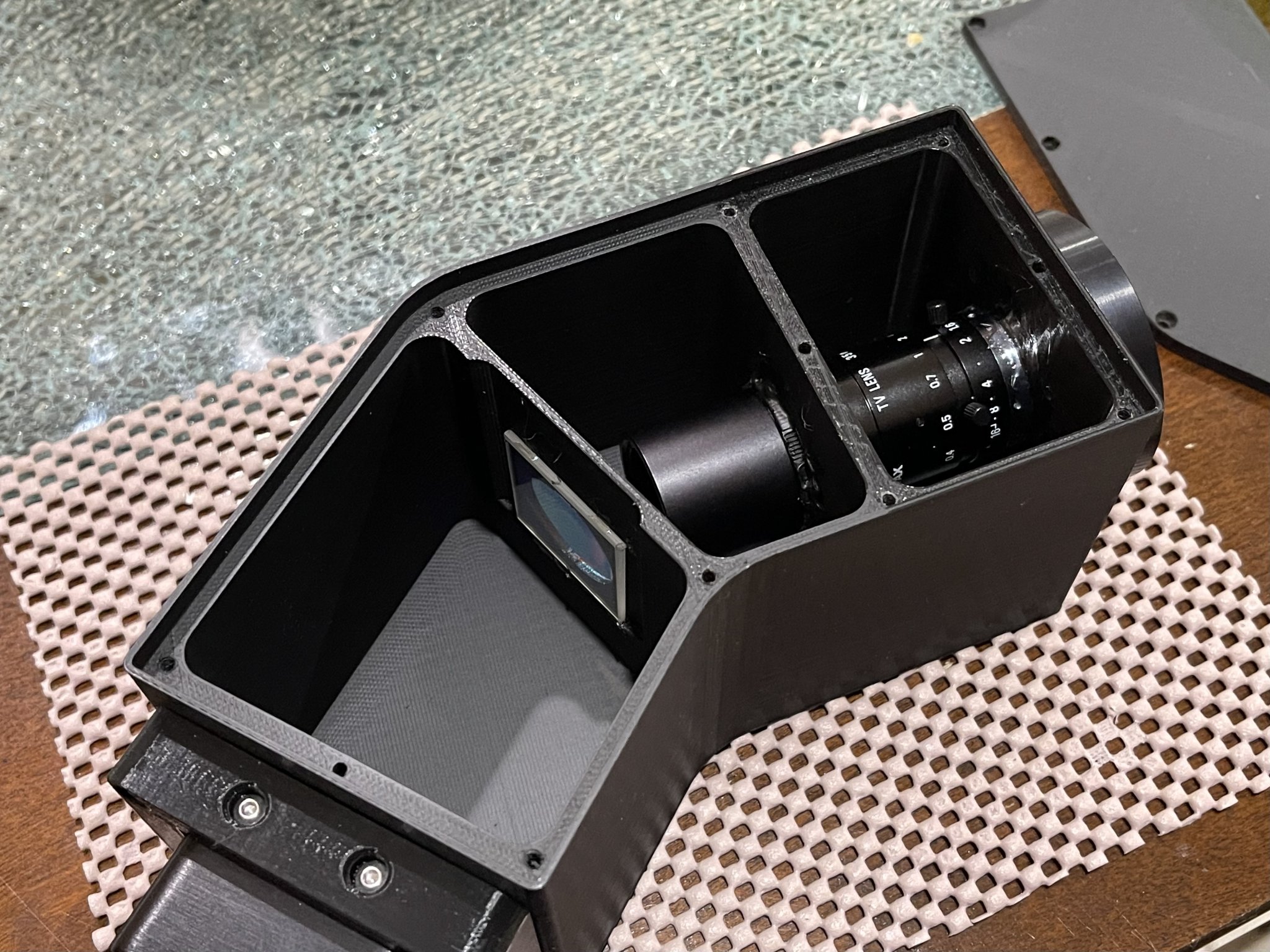

On the bench tonight is a compact optical spectrograph (a spectrometer that disperse light into component wavelengths in one dimension and has a 1-d line image in the other dimension). This is a design I developed 15 years ago. I had to make a test print because of a slight modification to the mechanical adapter to a new camera I am testing out.

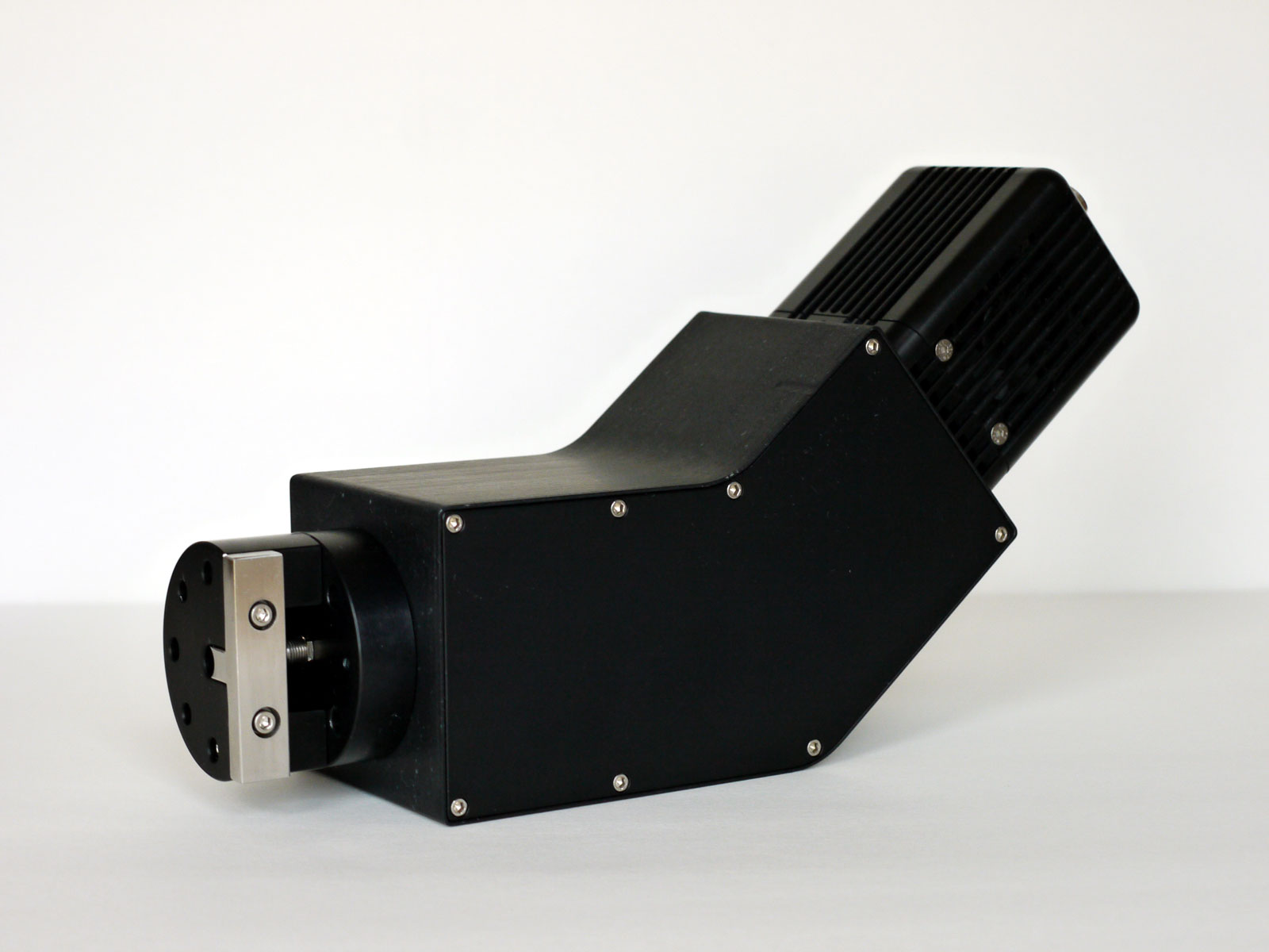

This is what the original one in CNC aluminum looks like:

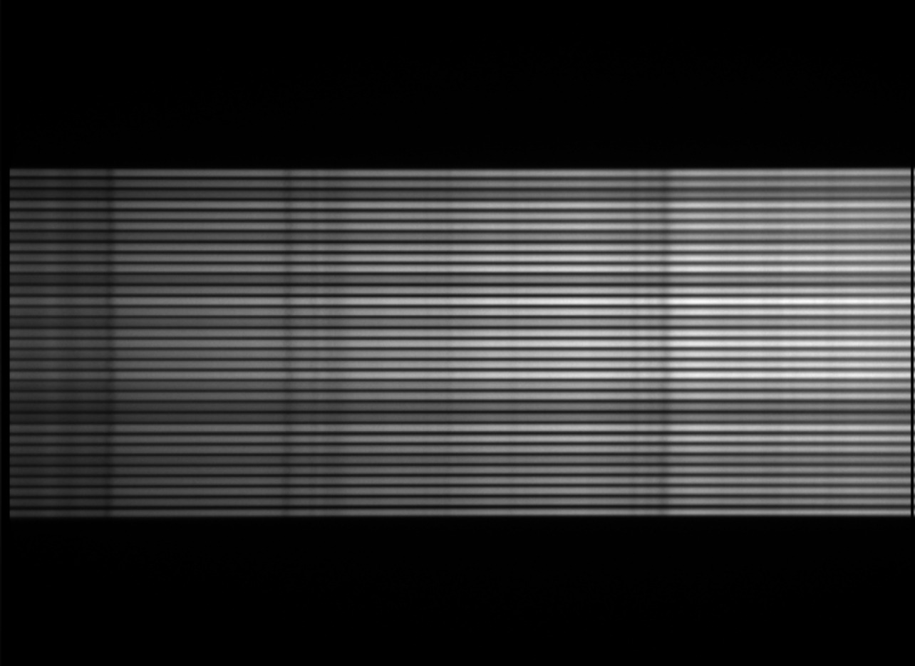

This is an image of sunlight as captured by 36 x 60 micrometer fiber optic array. Left to right is wavelength from about 400nm to 800nm. Up and down are the 36 different fibers.
Next step is to run a 1in x 32 UN2 tap through some of the holes for a “C-mount” lens. Then tap some M3 threads for the screw mounts for the lid and camera.
I managed to capture the moment when the print job finished:

The print is working out well - camera and lens fits perfectly. The structure is very stiff and structurally very sound.

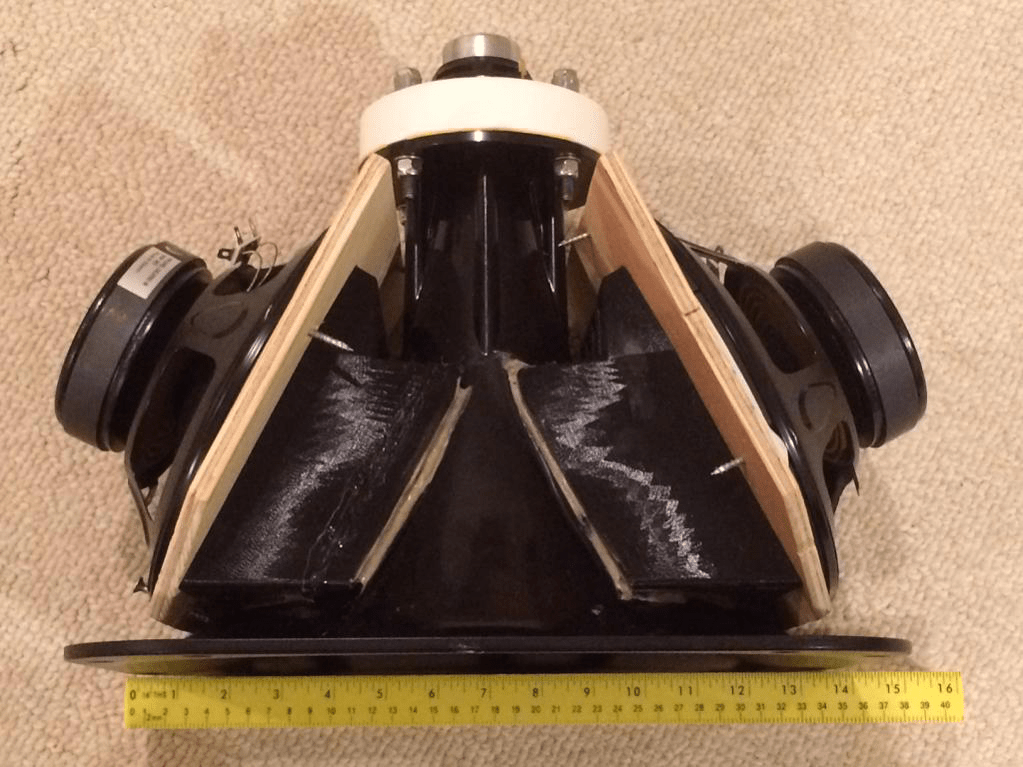

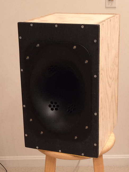

One of my most ambitious 3D projects is the bookshelf pointsource horn, here.

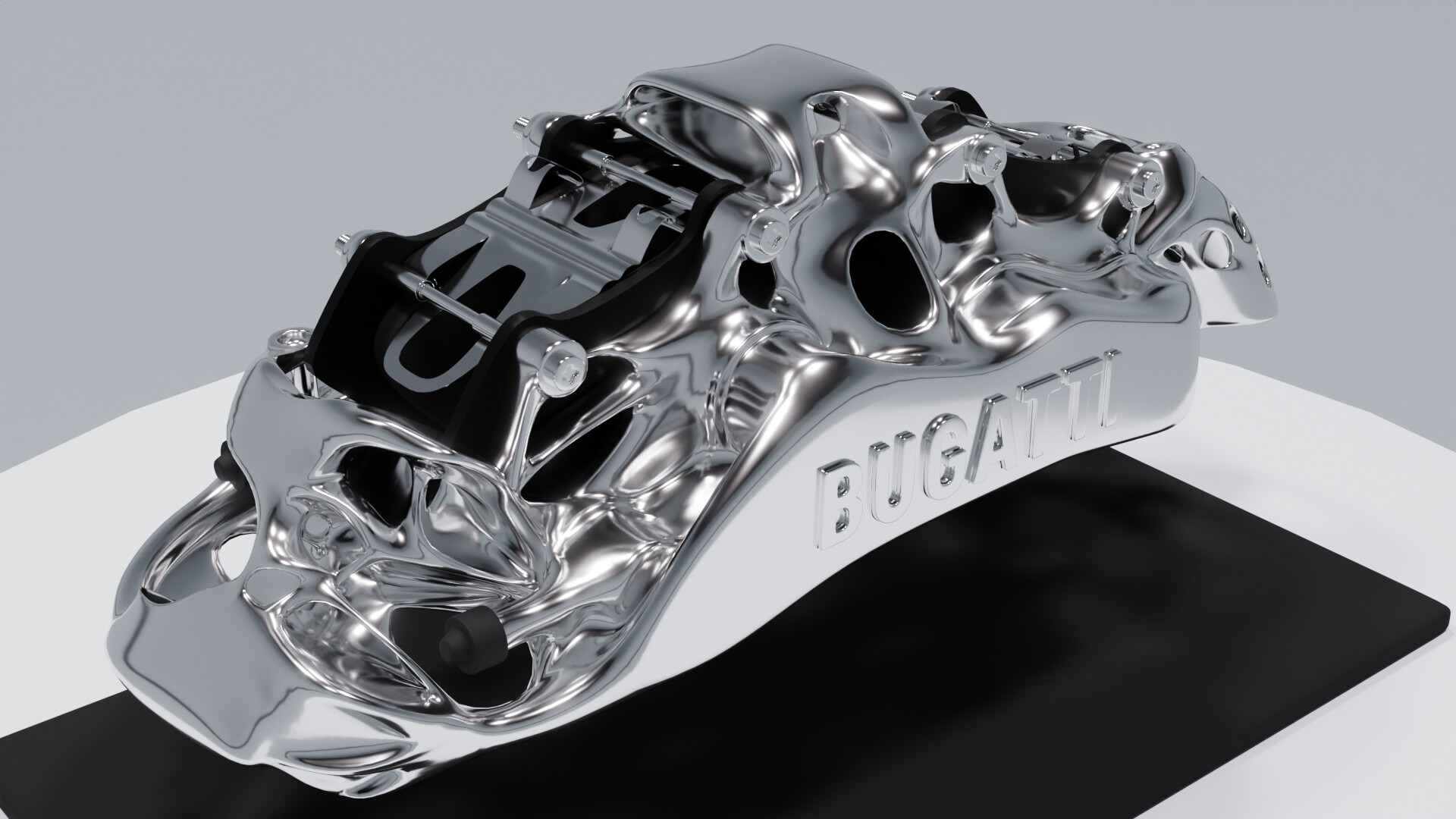

I could of used some metal 3d parts during some of my car projects when I had to shape them out of aluminum with a drill press, band saw, grinder, etc to test fit then have a machine shop make them for me. I will have to learn basic CAD and maybe a bit more advanced but printing at home would be very fun as you mentioned watching them magically appear... But more serious parts or if I ever got the bug to produce something to sell having them made on a higher end machine does look like the way to go.
From a few years ago, designed for a 300MPH street car no less.

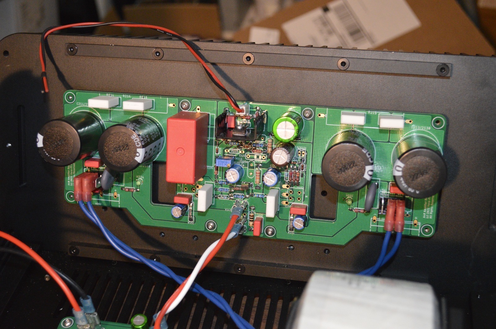

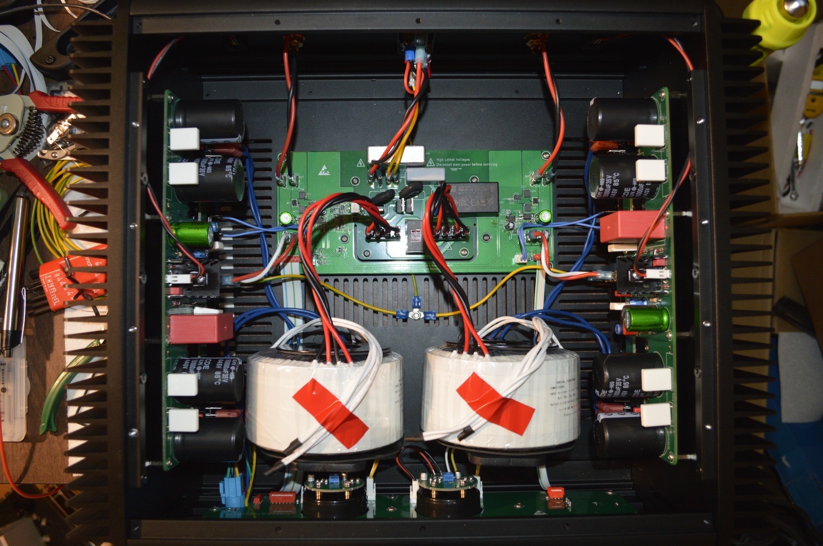

On the bench last night is the A40 Class A amp. Moving along nicely with Keantoken’s expert construction. We are very close to applying power for the first time.
In one of the last versions the transformers were in different twisted positions, I thought it was intentional to reduce mutual interference.
The orientation of the trafo can have an effect on the mains hum/noise pickup in the amp and we often listen while adjusting the angle of the trafo. It makes a difference since the windings are not perfectly uniform. The basic 90 deg on its side position of the trafos is fixed by mechanical design constraints.

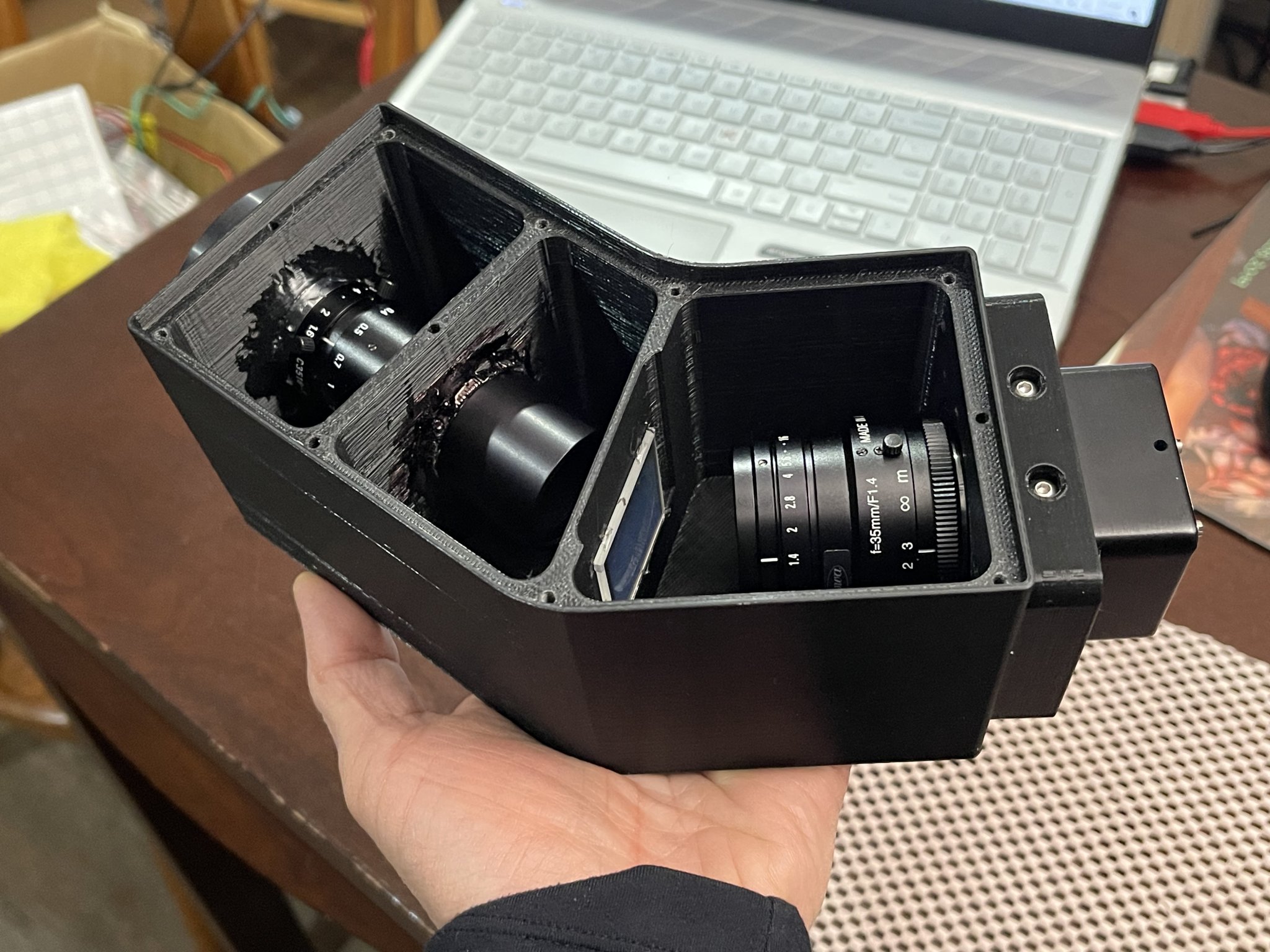

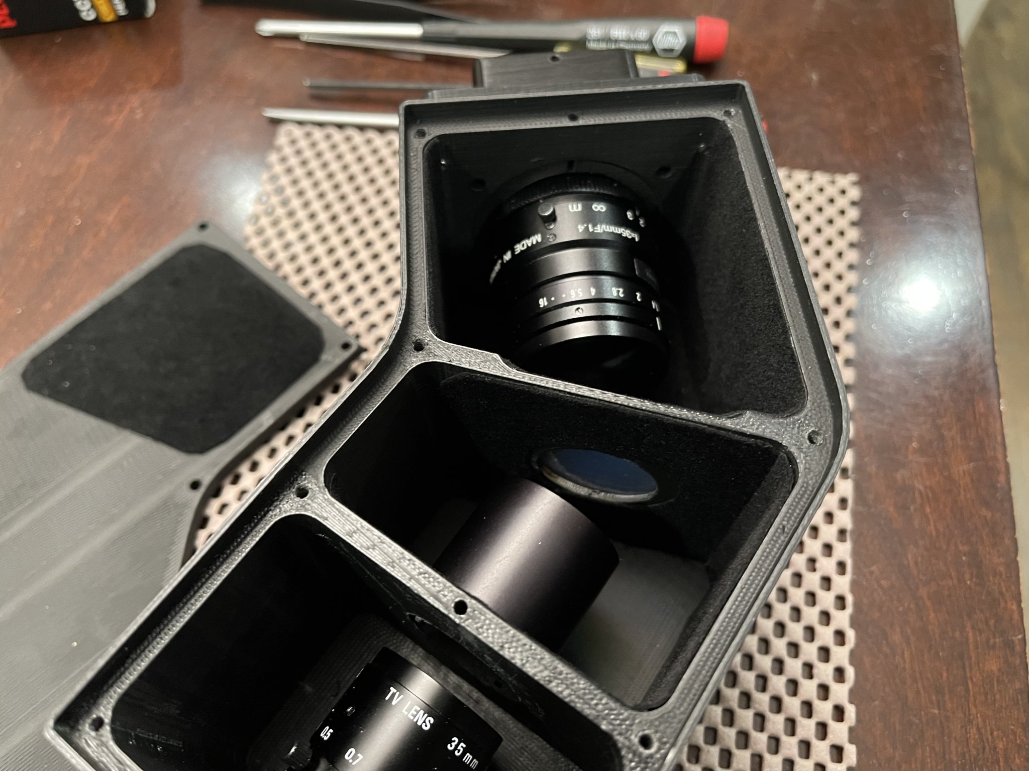

Spectrograph is almost done. Lenses and holographic volume phase transmission grating are installed. Sharp long pass prefilter will be installed next inside the middle lens tube. Black flocking will be added in strategic spots to reduce reflections to increase contrast. System optical throughput is F/1.6 - very fast for such a compact spectrograph.
Hi X, it looks really great! I know what a spectrograph does, but for what exact purpose are you building this particular device?
Job (I think) or private pleasure?
This is a laser Raman scattering spectrograph and can be used for many applications where Raman spectroscopy is useful (sensing chemical compound composition in pharmaceuticals, sorting plastics in recycling, detecting contaminants in water, etc.). My main use is measuring molecular gas concentrations in air. This is really demanding as Raman scattering in gases is very weak and hence design has to collect all the photons there are. This is for work obviously but it’s a lot of fun.

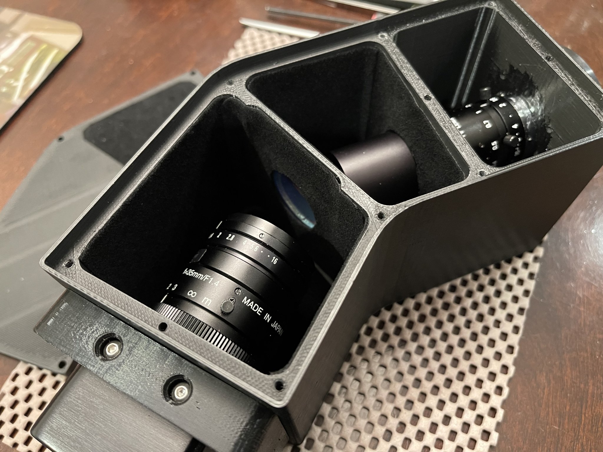

On the beanch tonight: I applied matte black spray paint to the inside surfaces of the spectrograph. Next is black flocking on critical surfaces to reduce stray light.
Black flocking installed. Spectrograph is basically done and now all that remains is focusing and alignment.

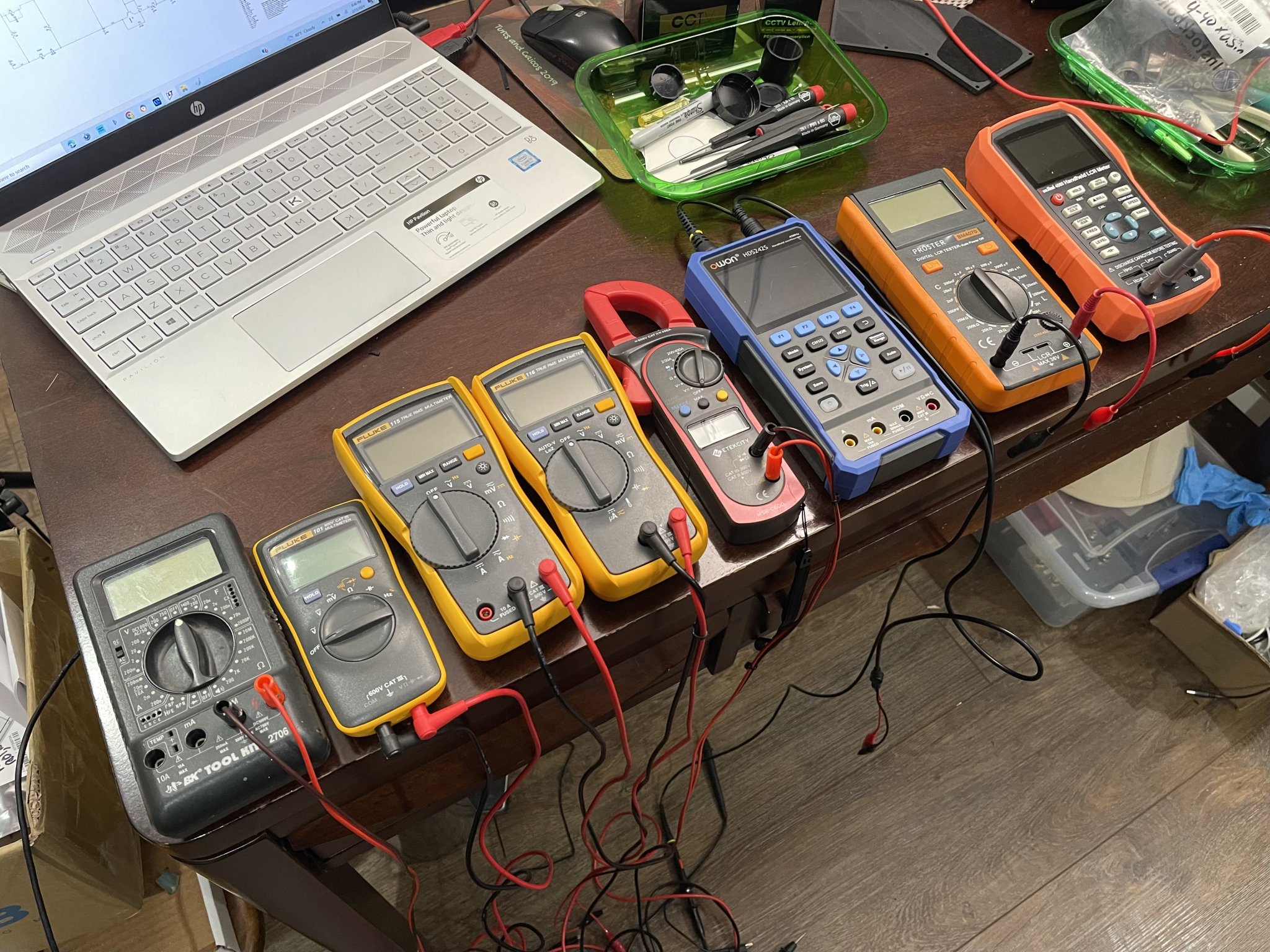

Cool meter collection! I only had one really good one and it died a few years back, a Fluke I really liked, cap, inductance, etc....Now I have a couple of cheap ones and one half decent unit and still have my very old Radio Shack analog unit and an old SPL meter.
I need something good and affordable to check EMF, etc, 11 F'ing Smart Meters really close to my desk. I have shielded the new rear and back side walls and doing the whole place as I remodel, next I need to get the wire mesh window screens done but also need to test the results.
All I find online seem to be more BS marketing that verifiable facts....
Any suggestions?
