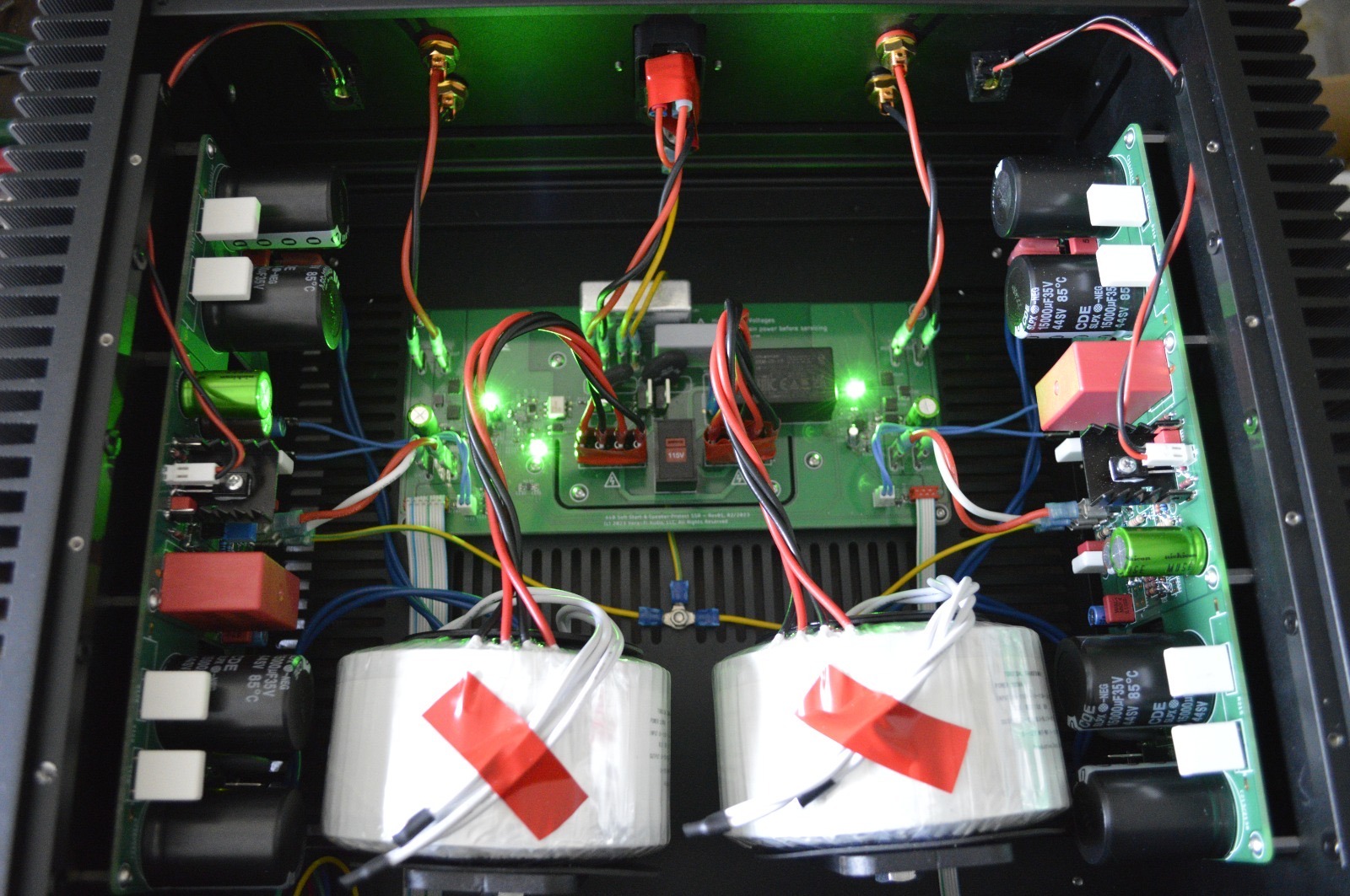

On Keantoken’s bench tonight is the A40 getting checked out and VU meters calibrated. Solid state relays tested. LED light intensities adjusted.
Reactions: Plott
Nice looking amp! Love the meters on black case.

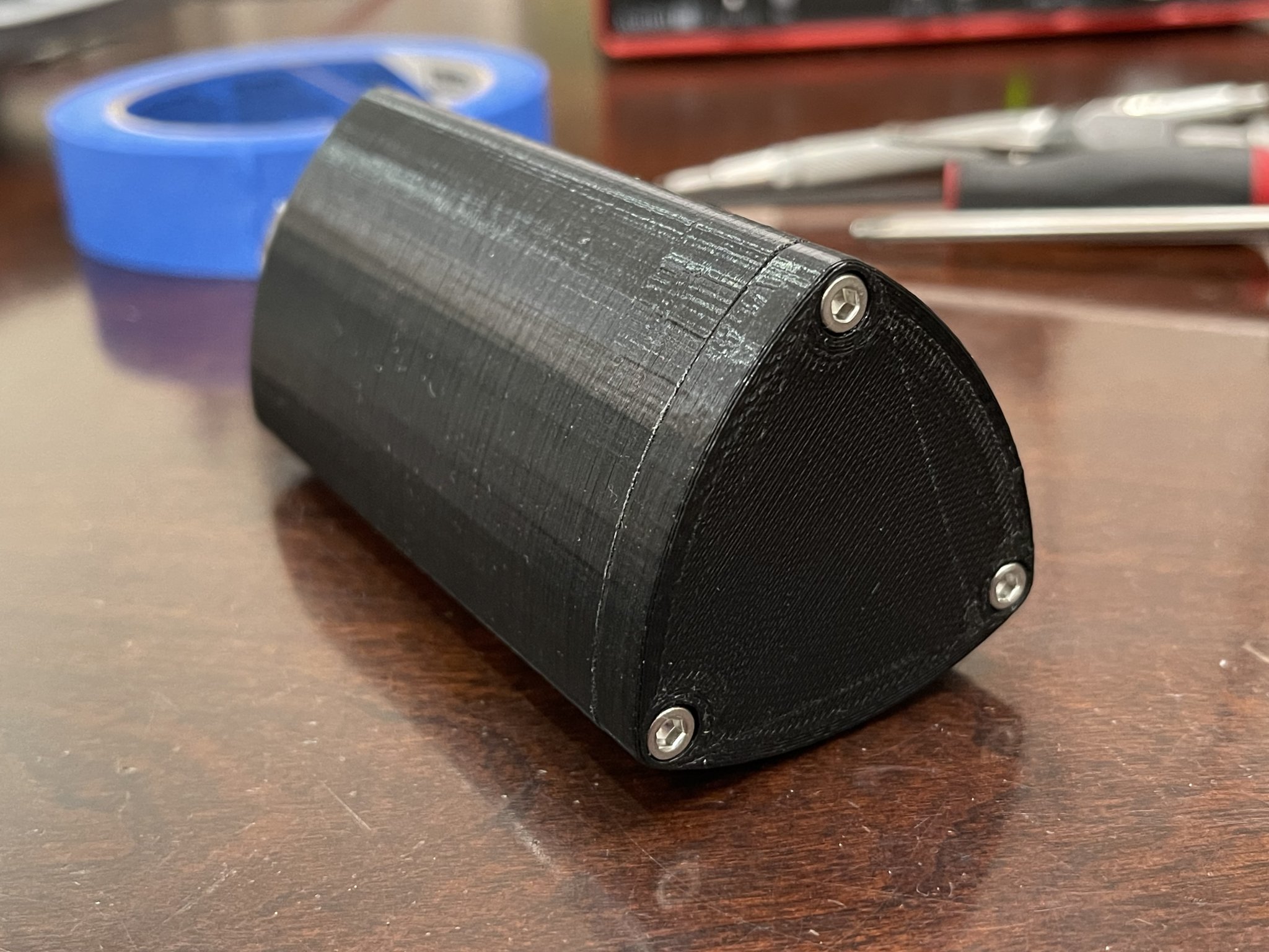

On the bench is test fitting the SnubWay to a new Viborg plug base. Super quality in clear acrylic and solid pure copper terminals. For the 3D printed prototype I am using brass M3 threaded inserts whereas on final it will be CNC aluminum with tapped holes.
The fit is perfect as the 100mm long M3 hex socket cap screw goes through all three PCB assemblies and hits the threaded inserts on the lid. In the metal production unit we will have insulating liner between the circuit board and the Wankel shell. There will be a small vampire stub connected to ground touching the shell from the base.

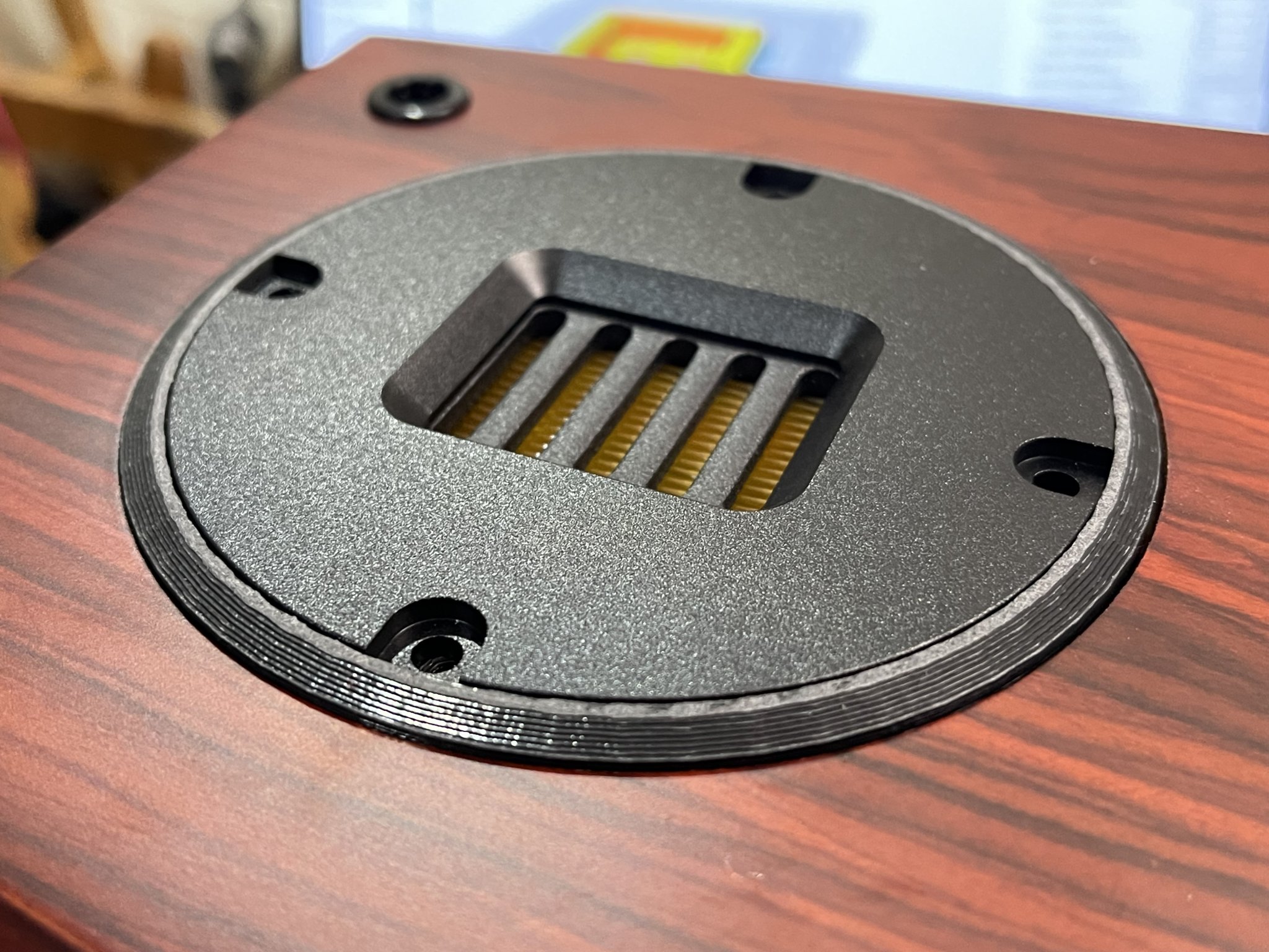

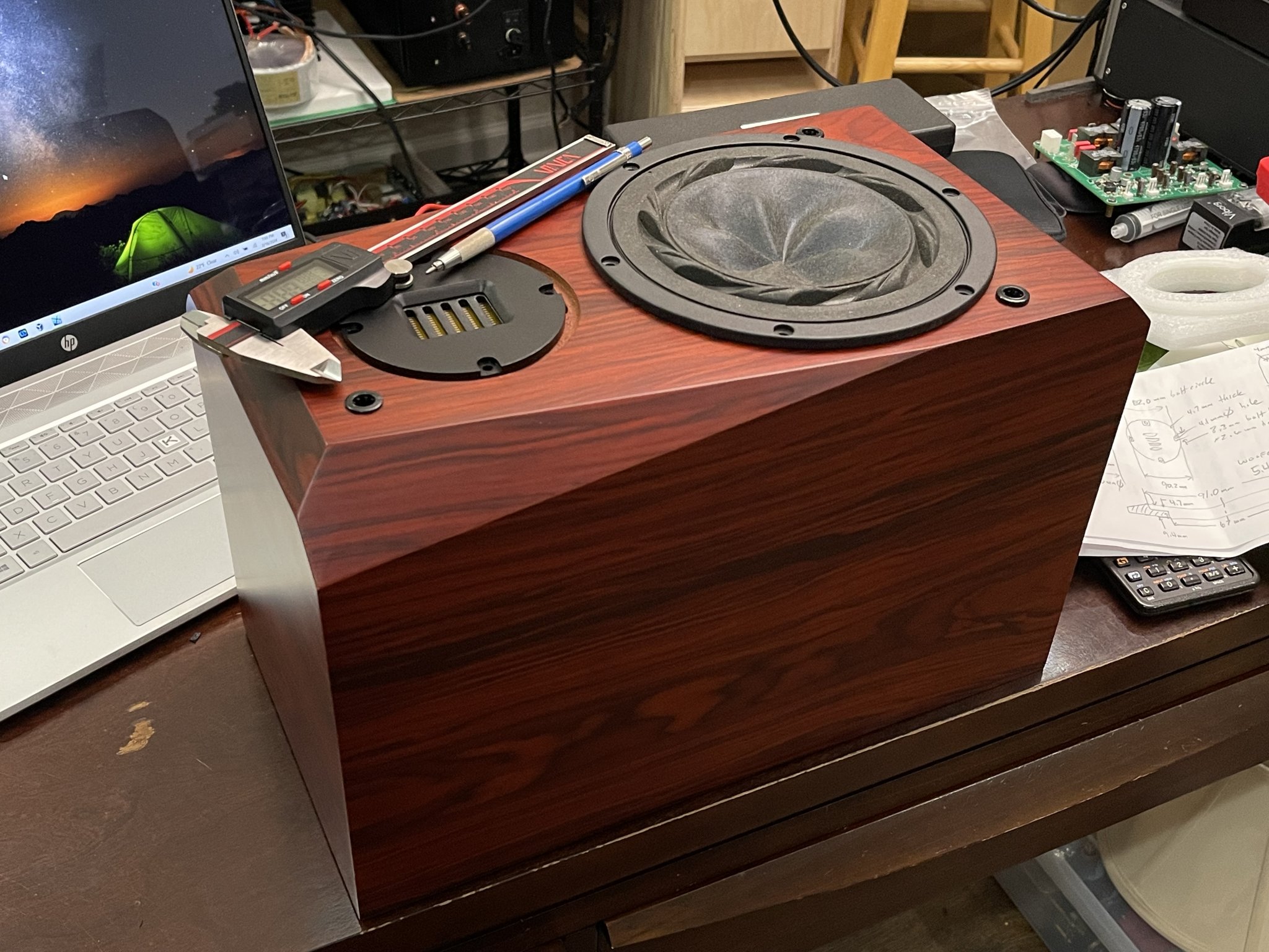

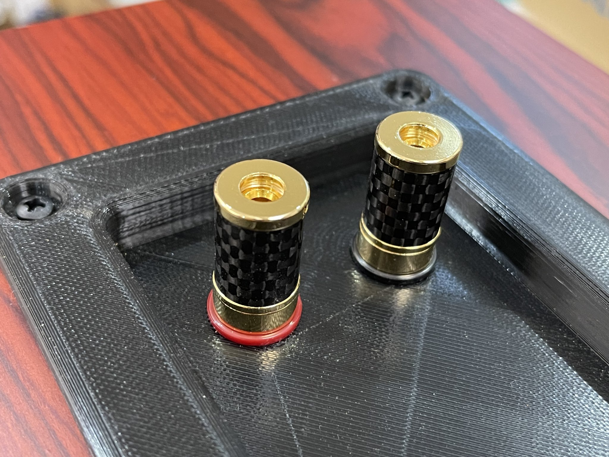

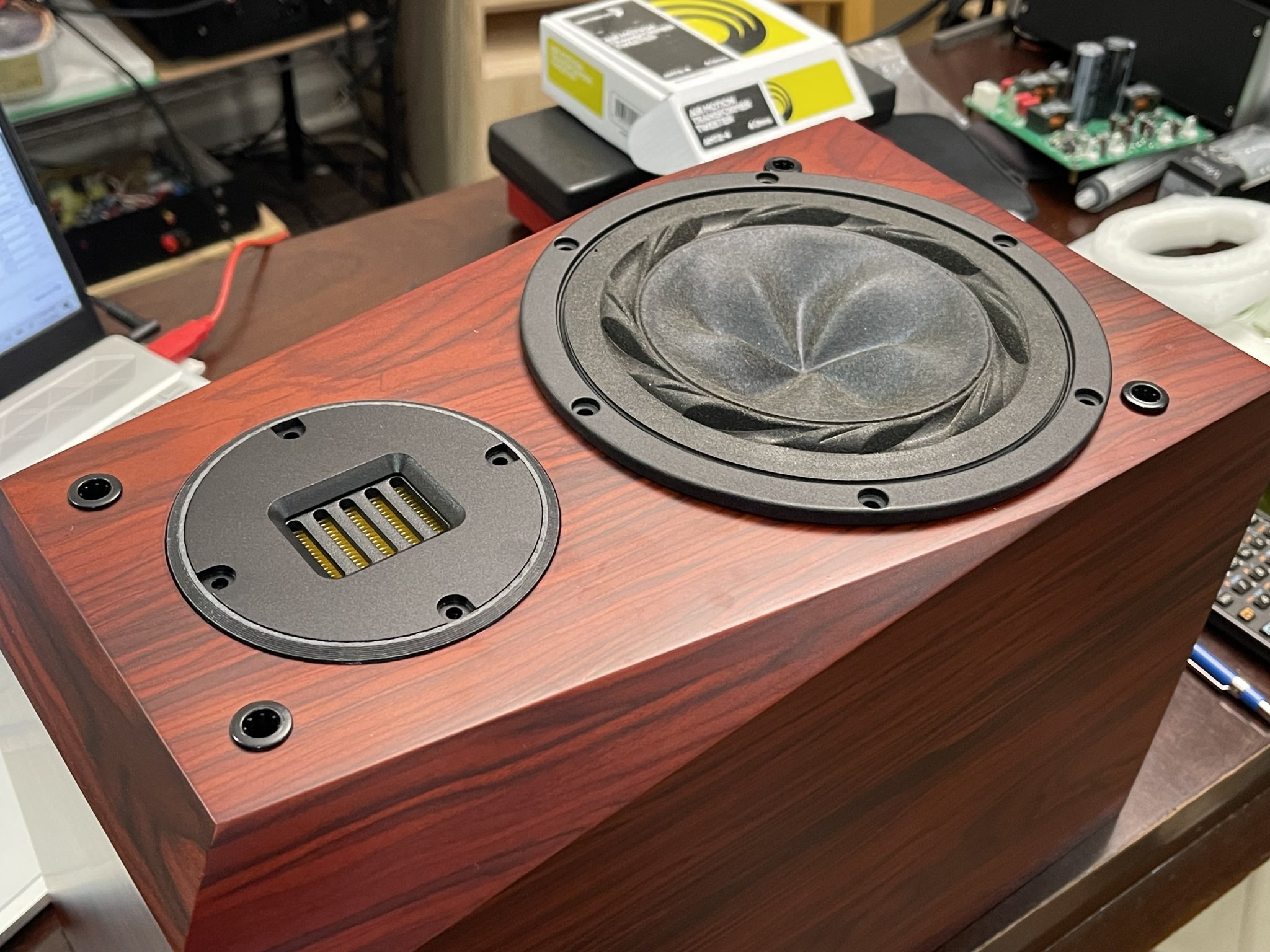

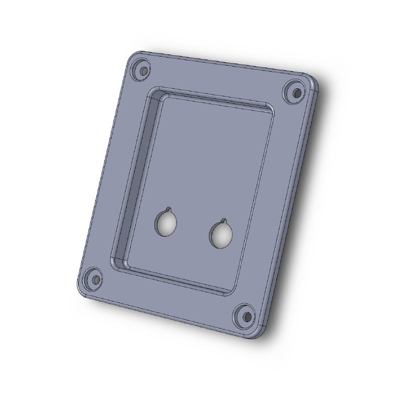

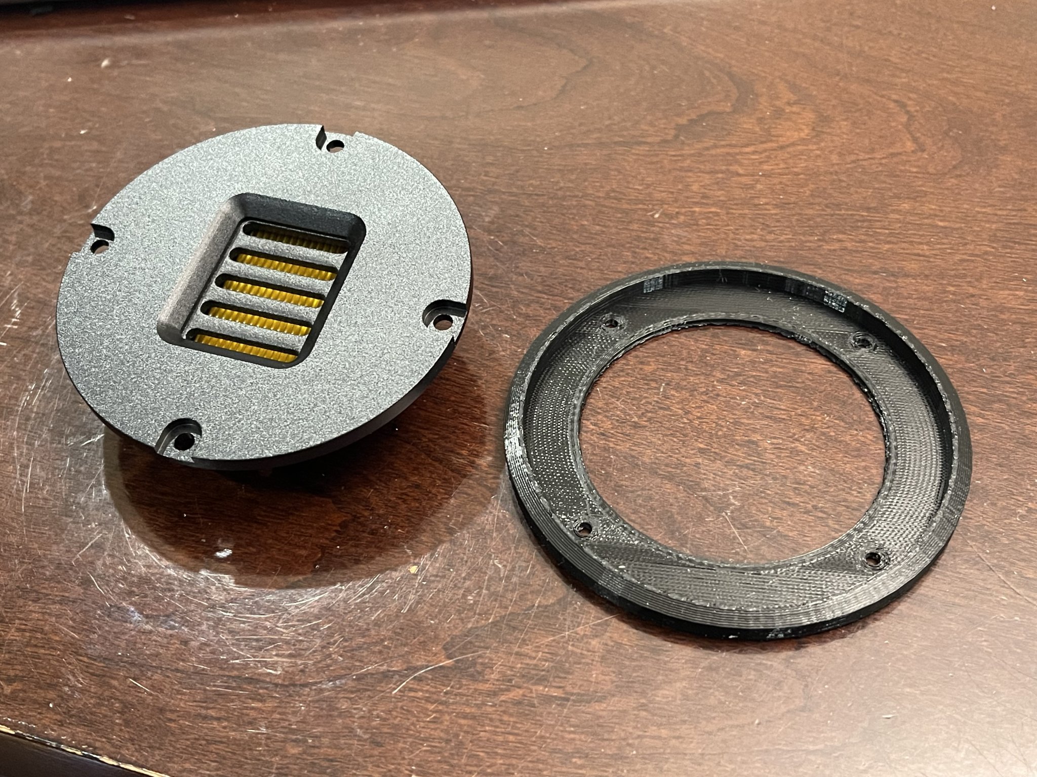

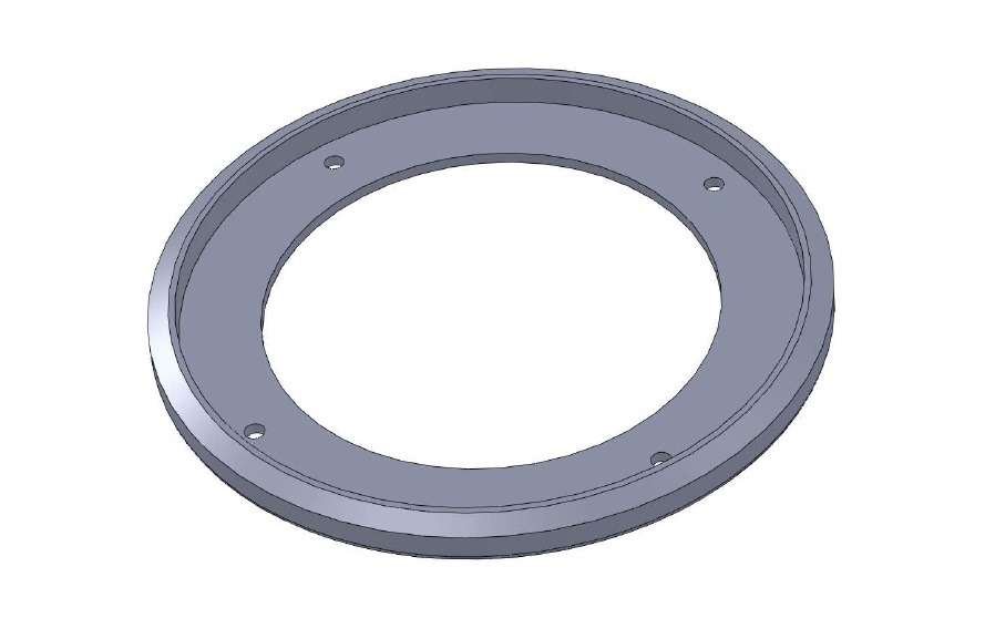

On the bench tonight is a personal one of a kind monitor I am building as a treat to myself. I bought these Fostex NX6A woofers 3 years ago for a blowout deal ($15ea). I have a spare early prototype cabinet with cutouts already made for some other driver that we never used. The cabinets are really nice immaculate rosewood veneer. I have some Dayton AMT2-4 tweeters sitting around. I think these will go well together. I need to make an adapter ring for the tweeter on the 3D printer. I need to get some binding post cups for the precut rectangular hole in the back. Box is 10.4L internal volume. Off to SolidWorks now for the ring adapter. The woofer is not flush mounted and sits about 5mm proud. I think I am going to make the tweeter come out by equivalent amount as well with an angled slope adapter.
I’m thinking crossover will be at 3.5kHz. Reflex box tune circa 60Hz.

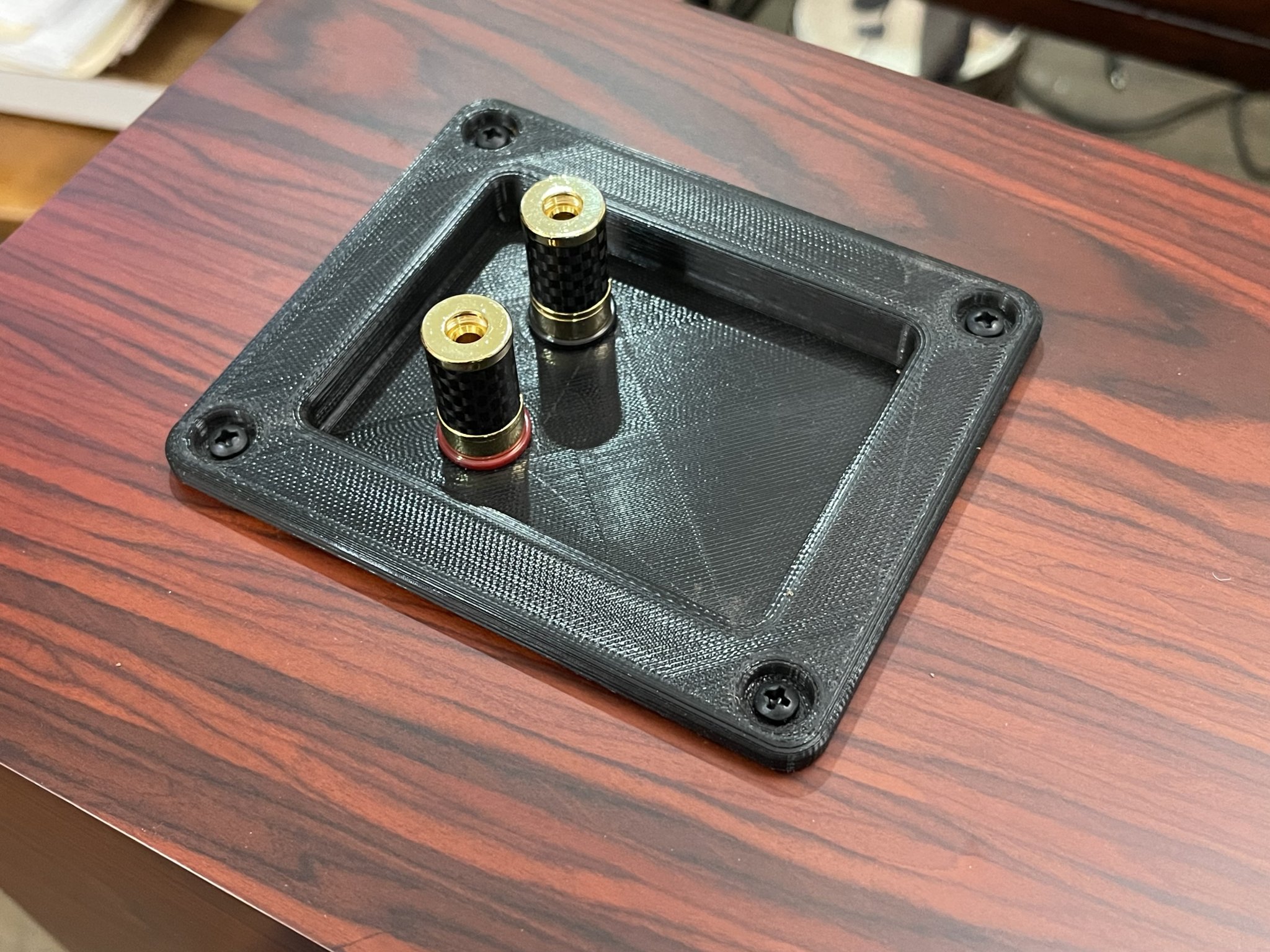

Model for binding post cup is done and now go to get print of tweeter adapter from printer and start new job for the binding post cup.
Print turned out well:
You may be wondering why I did not make the tweeter flush. The existing cutout is too large and the 4 screws miss the wood sort of. The adapter plate will attach to the baffle with glue and has to have some thickness for the tweeter screws.
