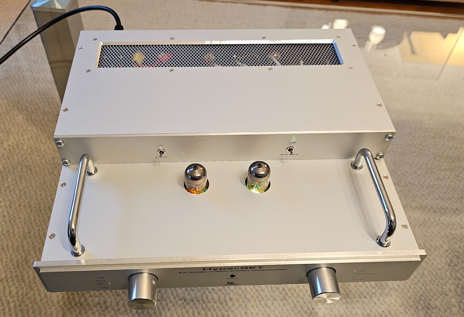

on the bench - my new HyperSET preamp😀
Now I have to integrate it into my system - and the listening can start.

Many thanks X!Super job, Plott. Nice design for the chassis shape with the step and top facing handles. Very cool.
You can relax and listen to it now.
In this moment I will start listening. Had a short delay because of a defective internal signal cable, I thought it's the amp, but luckily everything is fine now.
Many thanks, glad you like it! I like it too 🙂wow your hyperset looks like a high end commercial product! those connectors on back look super premium too
Hi Anand, man thanks! I very much stick to the industrial design for whatever reason@Plott
Absolutely superb execution and industrial design Plott, I love it! 2 BIG thumbs UP! 👍 🤓 😍
More pics please!

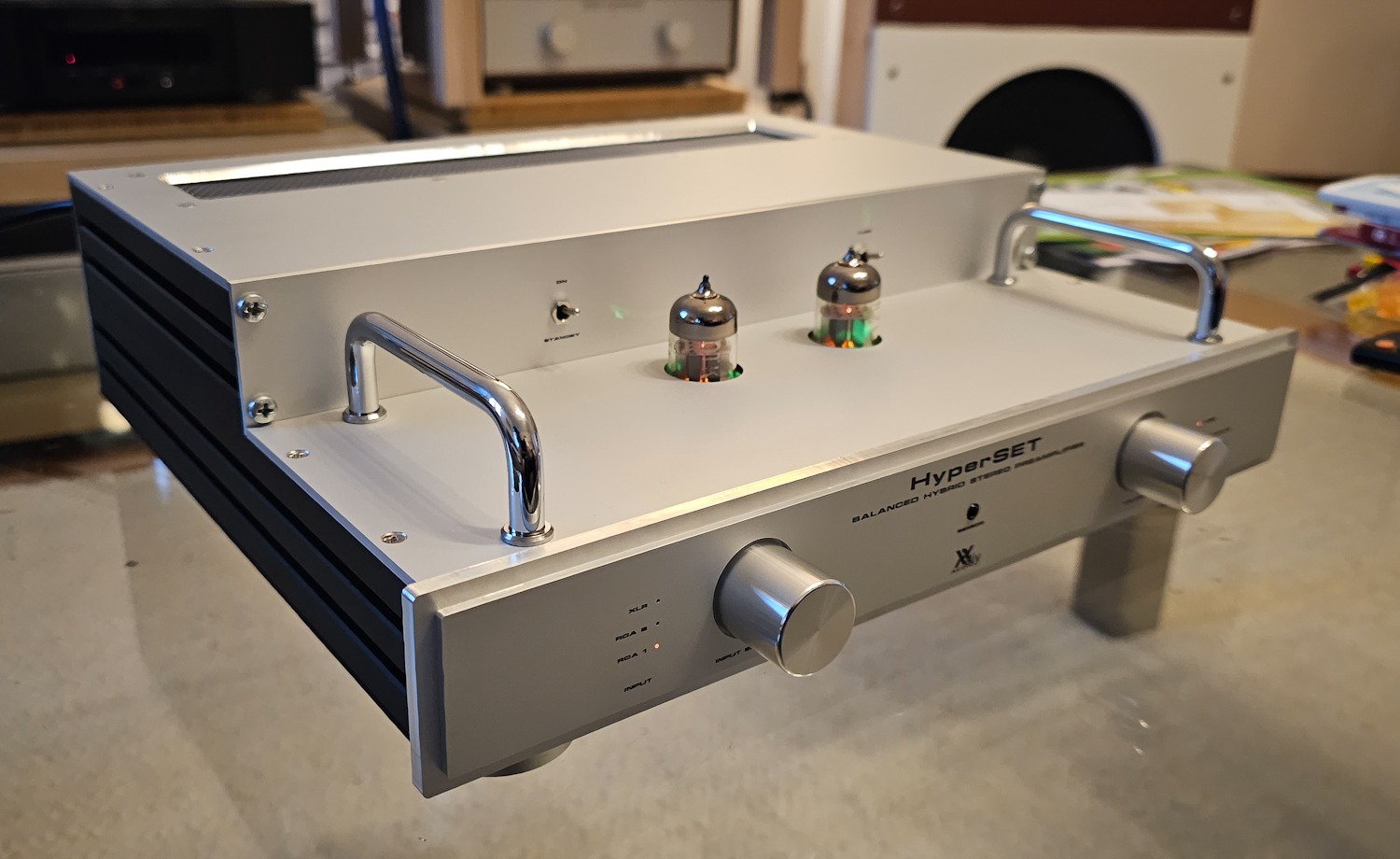

Pics will follow next week - I have to change both switches... The output selector switch was broken after switching 5 times... I have now ordered two new switches, they will arrive next week. And I will take puctures.
First impression after just a few songs: WOW!You can relax and listen to it now.
This amp sounds gorgeous 😍 Period. It's very dynamic but at the same time very relaxed, not strained, not exaggerated.
It creates a huge soundstage with depth and width and height, the instruments are placed very well. Singing - beautiful. Chantal Chamberland stands in front of me, her voice is completely natural, the s-sounds are perfect. Goosebumps.
All these comments concern the tube output.
I’m glad you are happy. More people need to know how good this preamp sounds. It’s one of the reasons the EP600.2SE sounds so good. The LSA HyperDrive-2 headphone amp uses the same tube buffer topology.
Enjoy your beautiful creation - now you can go through your music collection all over again.

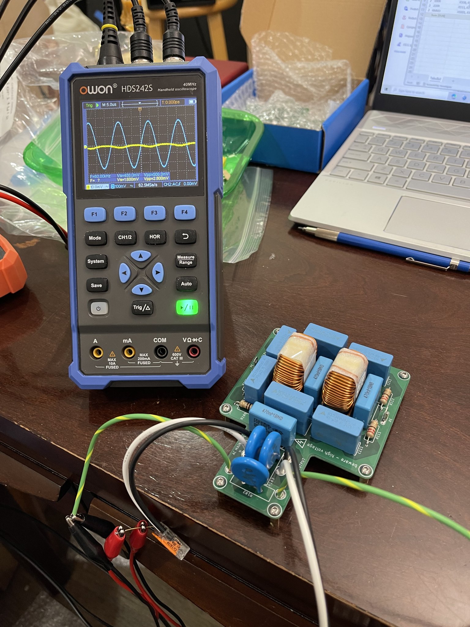

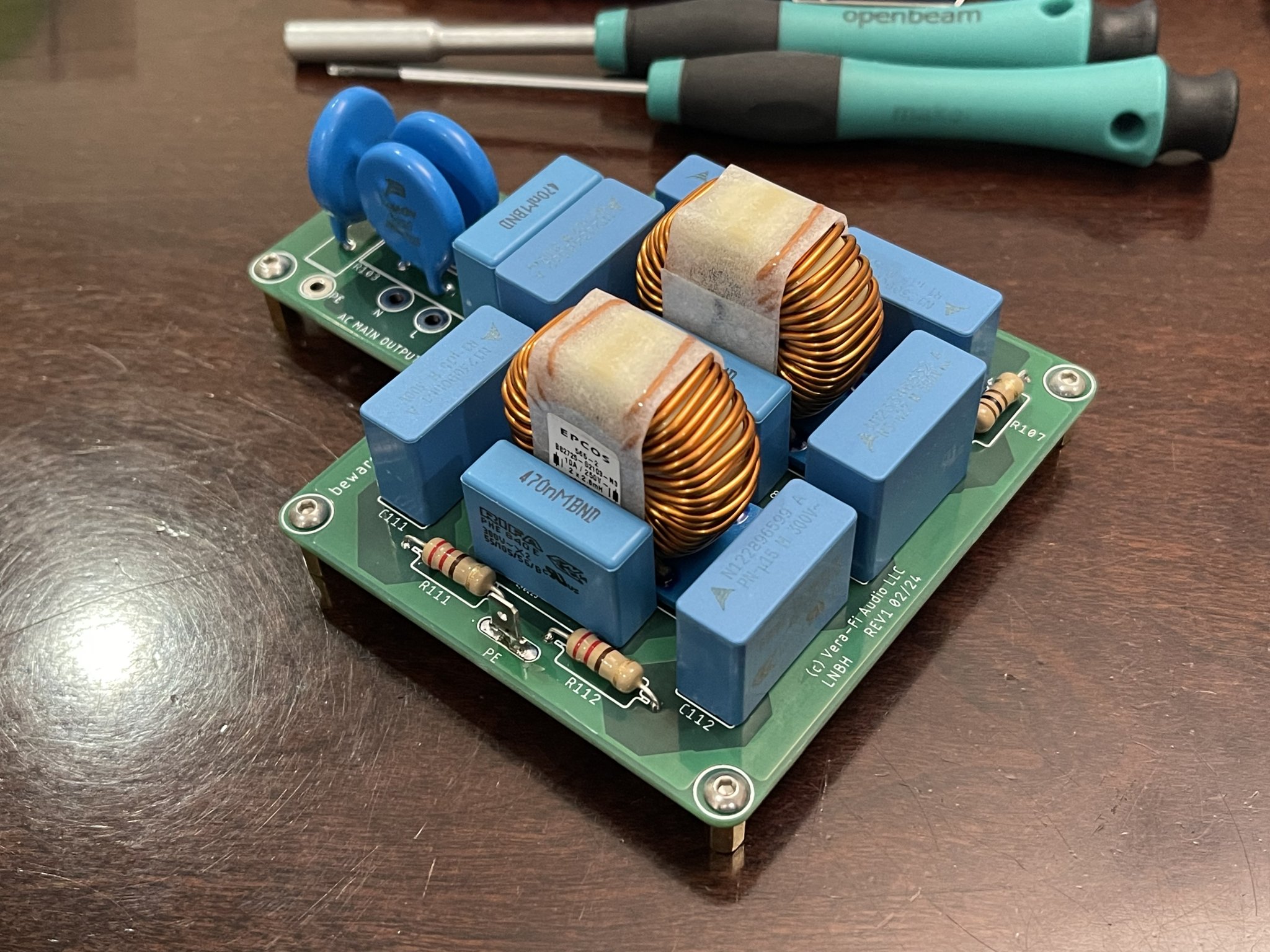

On the bench tonight is the rev B of the Line Noise Black Hole. I have reduced it down to two CMC’s in a 5th order Chebyshev filter the achieves a predicted -55dB at 100kHz and -47dB at 60kHz. I tested it at 60kHz and measured 2.8mV out of 508mV for -45dB, close to -47dB.
Good for 10A of current at 110 to 230vac. Built in triple MOV/GDI lightning suppressors for protection of your equipment from HV spikes. It’s a very compact and robust package now.

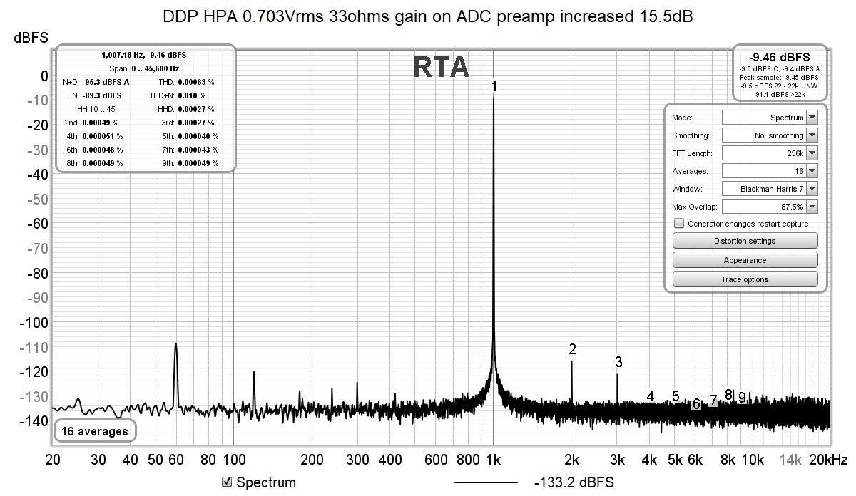

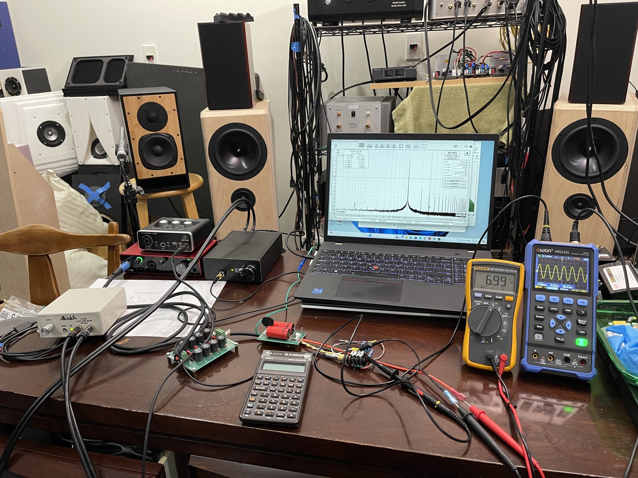

In the bench tonight is the Desktop Diamond Plus (DDP) Headphone Amp designed by Jhofland. It is similar to the Desktop Diamond Buffer HPA but has a built in AC/DC PSU with a filter and low dropout voltage regulators. Plus a solid state relay headphone output protection with turn on delay to prevent turn on thunp, and instant off to prevent turn off thump. Also includes a 3 way selector for 0/6/12dB Gain.
I am using a 1kHz Akitika oscillator and Focusrite 4i4 audio interface.
Max power before clipping into 33ohms is 7.0vrms. That’s about 1.5Wrms.
The THD is 0.011% at max power.
At a more reasonable power level of 1.00Vrms (30mW into 33ohms) the THD is 0.0013% and FFT is all second and third harmonic with dominant second:
The noise floor measures 850nV rms. The 60Hz mains peak is at 5uV rms. This means that the amp is absolutely silent with no music playing.
But if I increase the gain in the input output of the Focusrite by about 15dB to fully utilize the dynamic range, the THD is now only 0.00064%:
Here is the test setup:
