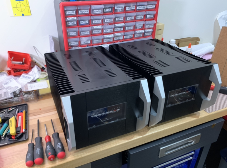

The Dual monoblock chassis will house two LuFo boards each (SuSyLu balanced 100w amp). So it looks like a have a lot of PCB building in front of me. Wondering if I should use a bigger 600VA trafo for the SuSyLu. 3.1A x 2 = 6.2A - probably could share a common single rail SLB? 6.2A x 28V = 173VA. Might be too much for a 400VA but perfect for 600VA if sag is an issue.
I just started physical placement of the heavy hitters and it looks tight. A 12 lb trafo plus 11lb inductor plus 22 lb chassis is 45lbs. Man that’s heavier than I thought when I tried to pick it up.

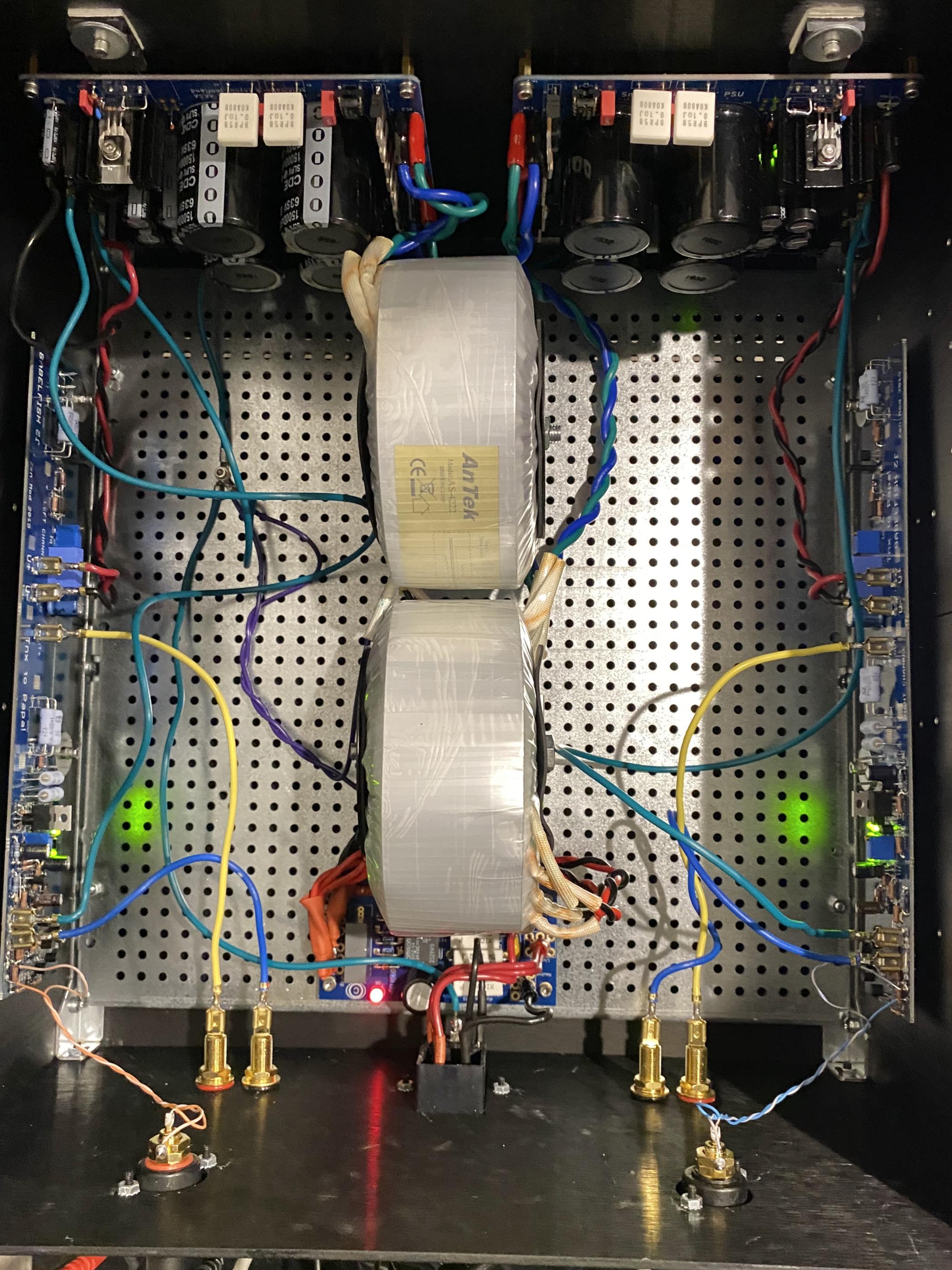

Anand, I have to give you credit for the SLB’s mounted to the front panel. I’m using that configuration in my Babelfish J2 build. It’s a great space saver! Thanks for the idea! Still need to install a pair of SSR’s. Will get around to that one of these days.

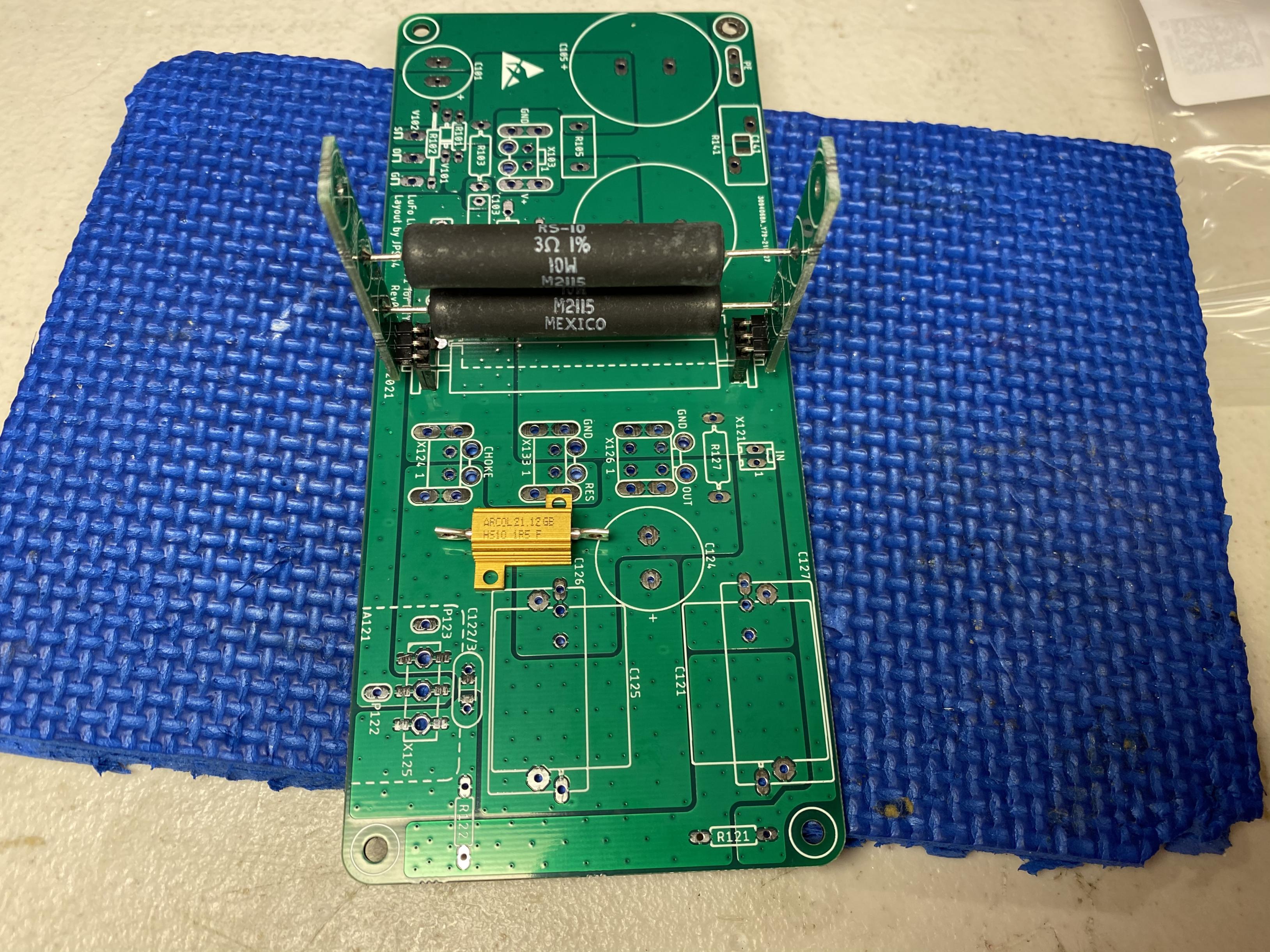

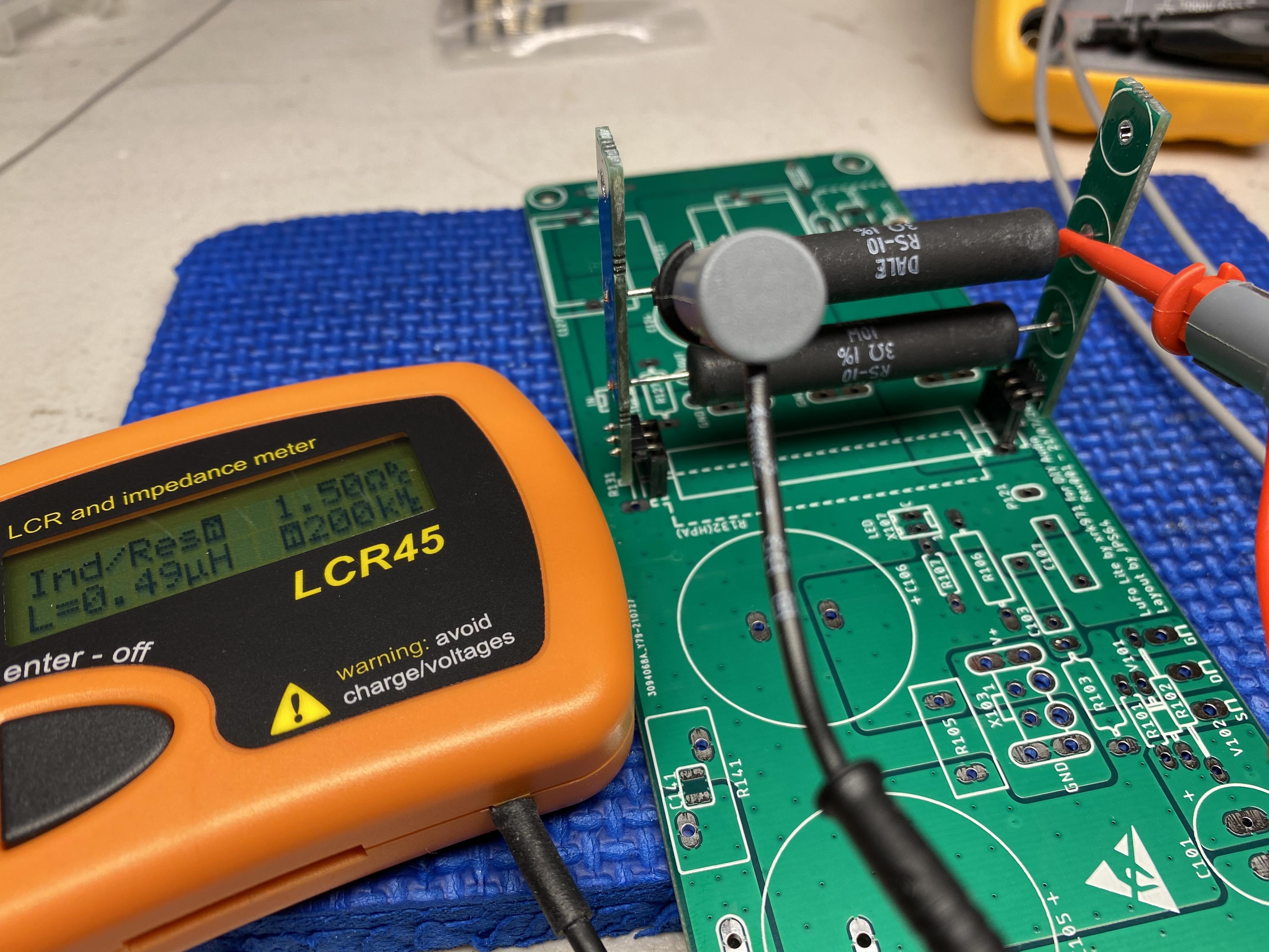

I was farting around at the bench tonight, no real motivation. I was curious how the resistor ladder will look on LuFo Lite. Here is a pair of Vishay RS-10, 3R resistors installed. I have socket headers installed so I can pull the resistor assembly off for value tweaking. I also have 10W, 1R5 Arcol metal body resistor option that can mount on the heatsink with flying leads.

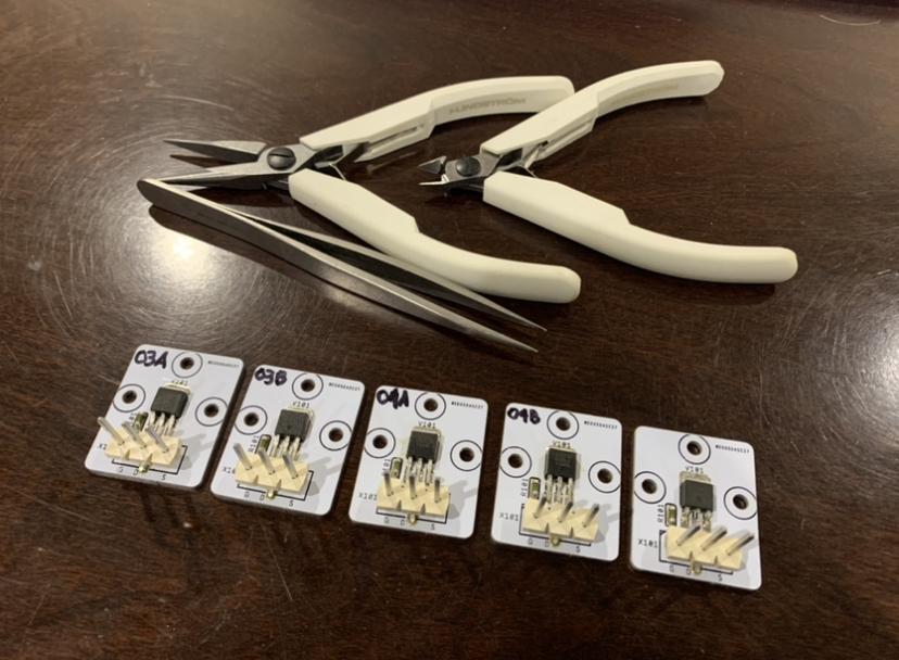

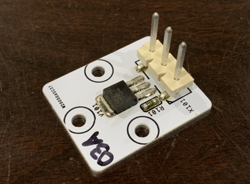

On the bench tonight Aug 13, 2021 are some LU1014D JFETs. I just soldered up more LU1014D’s onto the TO-247 aluminum IMS adapter PCBs in preparation for my proper LuFo / SuSyLu build. These were AliExpress units matched by Woofertester. Also a random LD1014D was assembled to go with the other random LD1014D.
