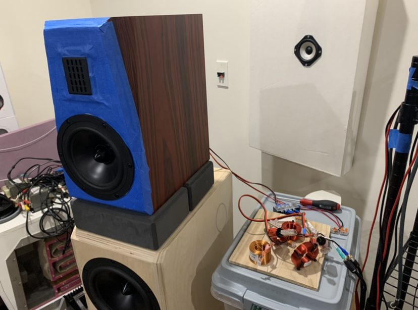

On the bench tonight Aug 15, 2021 is developing a new XO for a speaker. Planar GRS 3in tweeter and RS180-8 woofer. Measurements and simulation so far. I might get a chance to make a prototype XO using Wago connectors.

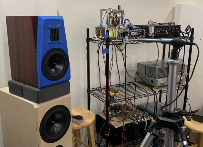

Yes, it is next. This GRS 3in planar with the RS180 sounds pretty fantastic. I’m listening to it right now and the tonal balance is spot on. Nice upper extension with the planar while not sounding at all fatiguing. It’s voiced perfectly.
attachment.php
@peppennino: you have good eyes. Those yoga bricks are perfect for desktop speaker mounts for near field monitors (like my Rockvilles). I figured $7ea is way cheaper than similar $40 ones made of same EVA but sold for speakers. I had to really get this speaker high off the floor to avoid a floor bounce dip.
I have also had my Manfrotto 3021 for 21 years! Yes, it still works like new.

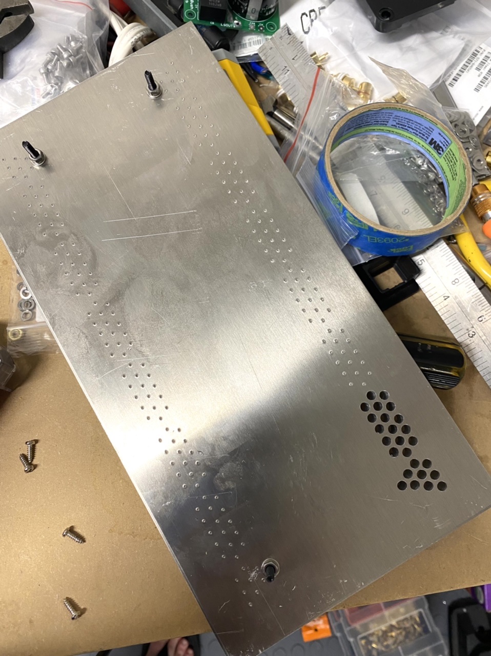

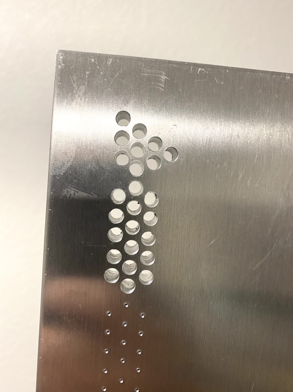

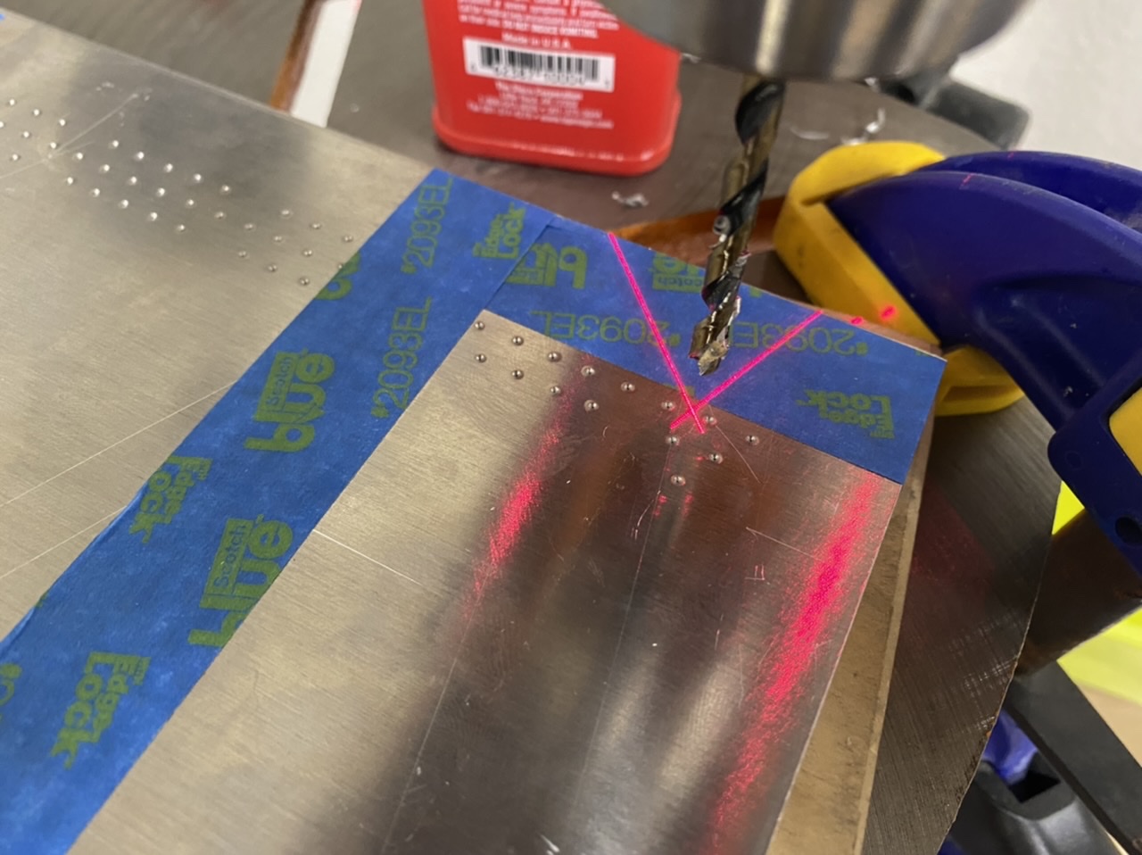

On the bench tonight. Lots O Drilling. Custom mono-block parts. I have just a few more holes to drill. 😀

You have laser guide marks on your drill press!? Cool.

Yep! Makes finding the bit center so easy. It’s a WEN 4225 I got a couple years ago. I fit a nice keyless chuck on it. All in all, great value for the money.

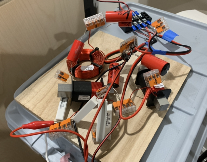

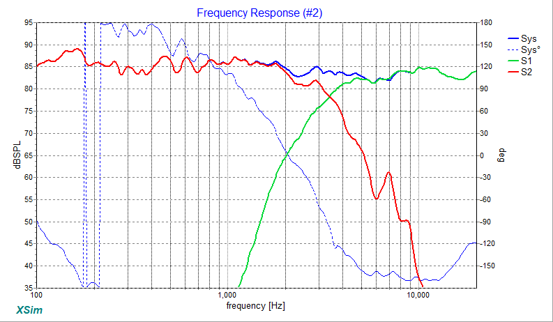

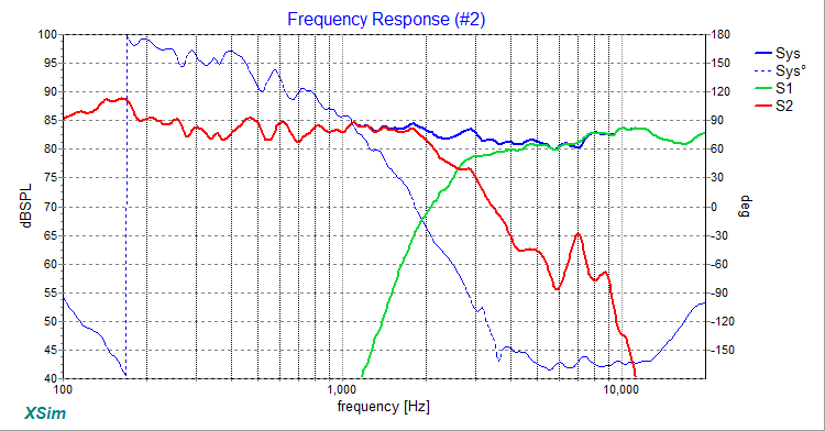

Latest update to my speaker XO now at 3.5kHz. Sounding really good.

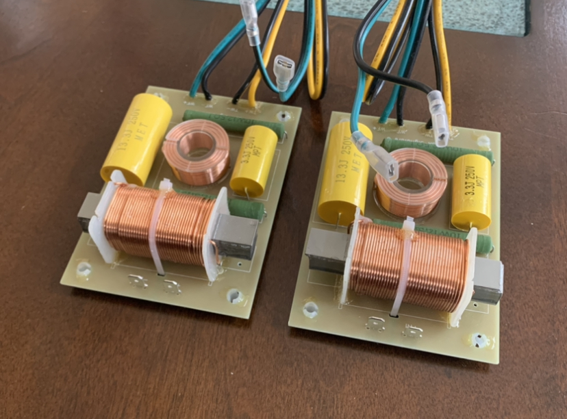

These crazy “Wago XO’s” eventually become neat and tidy custom crossovers like these samples that just arrived from the manufacturer- these will go into a new commercial speaker that I designed recently for LSA.
attachment.php
All the components are made to order - exact values. Have you ever seen a 13.3uF film cap? 😀

Thanks, Jwjarch! I am upgrading the 13.3uF cap to MKP in the production version. It’s a nice crossover and amazingly compact for what it is vs a hand P2P job.

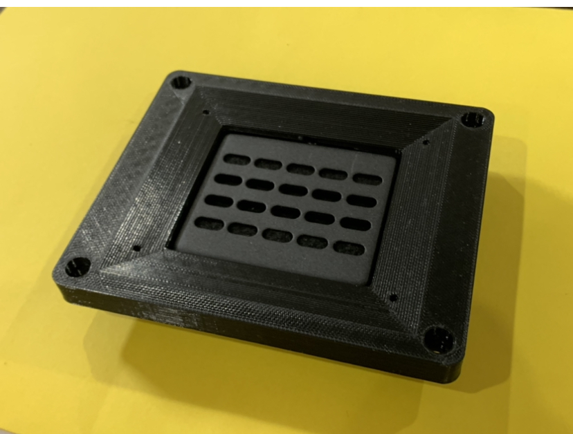

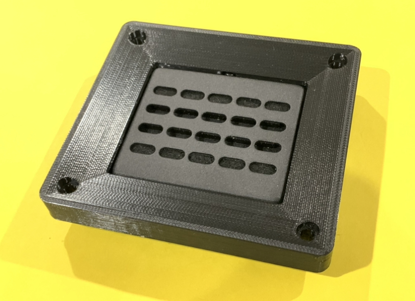

I revised the waveguide to be much more compact. This looks a lot better and has smaller CTC distance to the woofer. I nailed the fit on this one. No Dremel tool post print cleanup work needed. 🙂

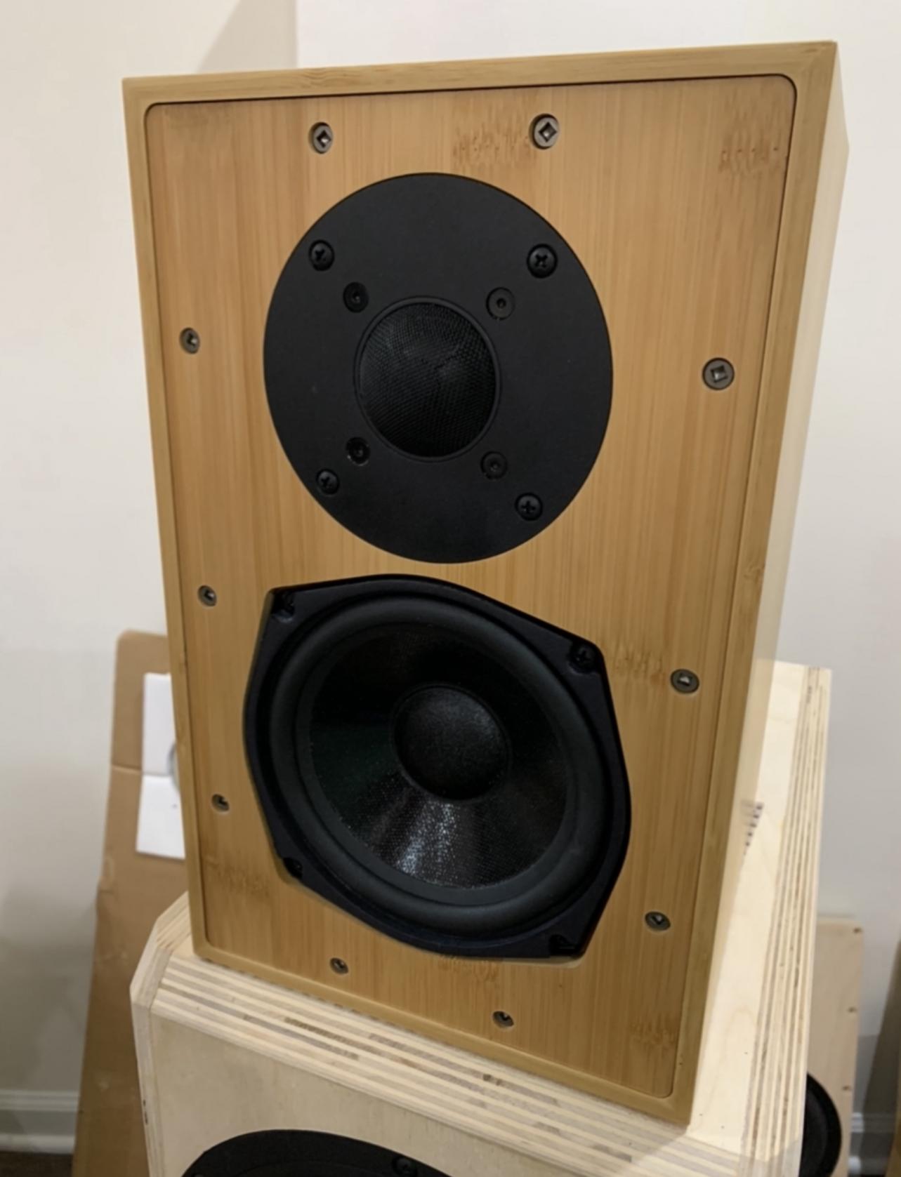

I think it’s good to leave one side unfinished to let the wood breathe. Coming from someone who leaves most of his cabinets bare wood I guess it doesn’t mean much. Some wood like carbonized bamboo has been treated with basically a sealer that’s like plastic you don’t even need to finish it. Just sand it smooth and buff it.
These are my Rockville’s made from bamboo.
