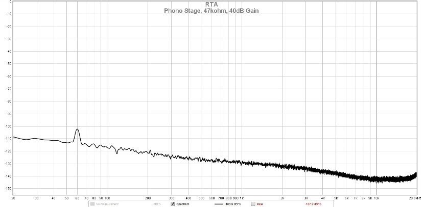

My initial measurements of the FFT of the noise floor shows that the preamp is very quiet at -120dB noise floor at 1kHz for 47kohm and 40dB gain setting with no hash anywhere on the tilted 1/f noise floor. There is a small blip at 60Hz which I think is EMI picked up by the 4 skinny wires from the cartridge through the tone arm.

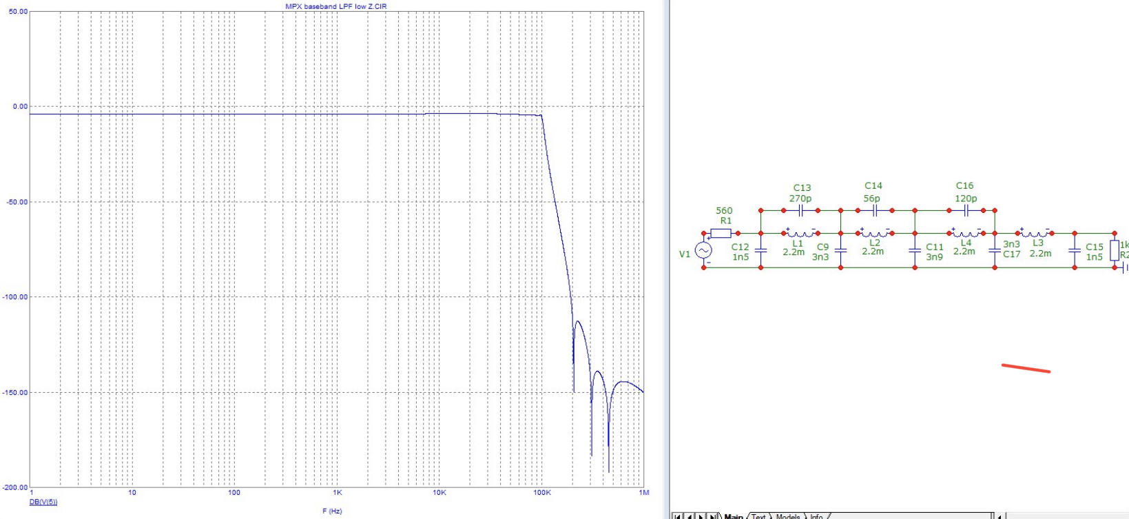

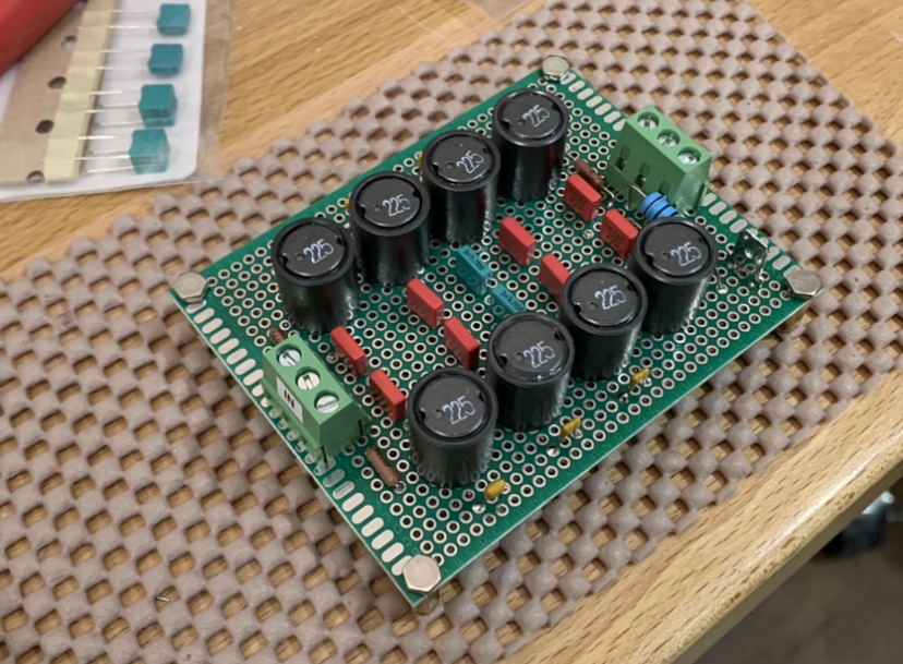

On the bench last night July 8, 2021 was a new ultra steep slope 100kHz low pass filter designed for removing the pulse width modulation carrier frequency from Class D amps during FFT and noise measurments.
New filter in action measuring a 350W GaN Class D amp:

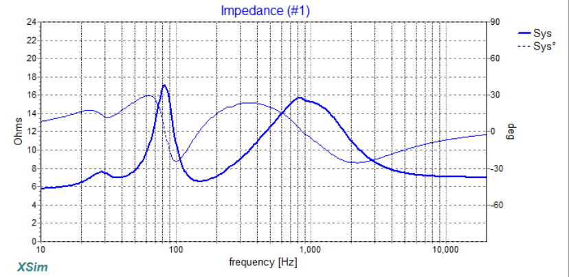

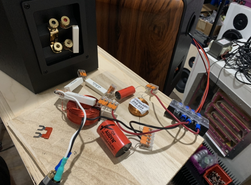

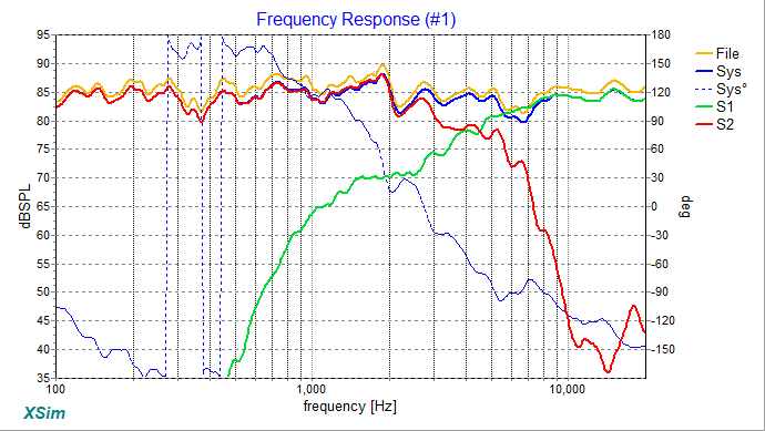

A new speaker design was on the bench last night July 11, 2021: this is a 6.5in 2-way design that I am developing for LSA. The predicted (blue) and measured response (orange) looks excellent. Another passive “Harsch-like” crossover with asymmetric slopes and positive phase on both drivers. XO frequency is at 3.8kHz.

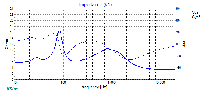

Predicted impedance:
Listening in mono - driven by TD7293 amp, it is sounding excellent. Very nice tonal balance and clarity. The distortion on this OEM woofer is very low and it has a wide bandwidth allowing such a big crossover frequency.

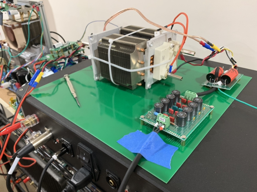

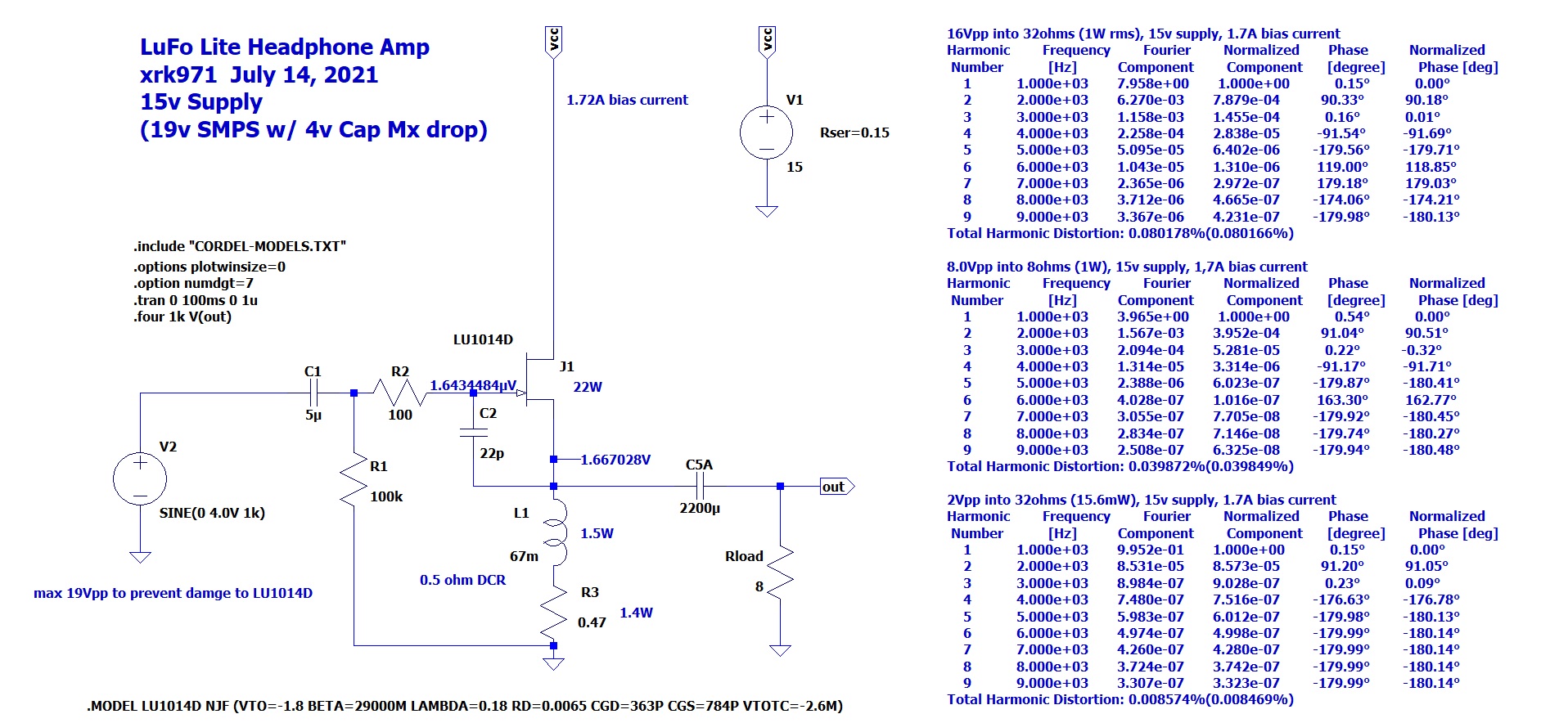

On the bench tonight, July 14, 2021 is the LuFo Lite - a very simple amp that drive a few watts into either speakers or headphones. I am testing it with a 12v SMPS so only 8v after the cap multiplier. It is running at 2.6A bias current and I am not sure why it is so much higher than the simulation that was predicted (1.7A). However, 8v seems perfect for the heatsinks that I have as they run 43C and the music is plenty loud.
Here is a video of its first sound playing on a 3FE22 test speaker.
LuFo Lite First Sound - YouTube
Schematic and predicted distortion:
VERY interesting. An even simpler version with lamps/resistors instead of choke I think would be much appreciated

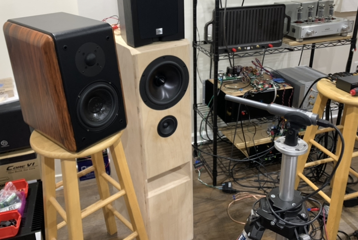

WOBT (in the wee hours) July 16, 2021: I finalized the crossover design for my new speaker - it measure and sounds great.
https://www.diyaudio.com/forums/attachment.php?attachmentid=967853&stc=1&d=1626553795 is a commercial product so no part number available for the drivers.

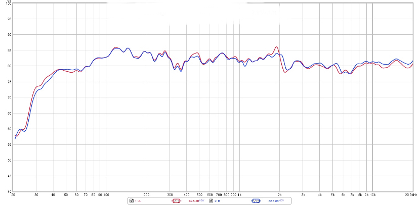

Frequency response of channel A and B:

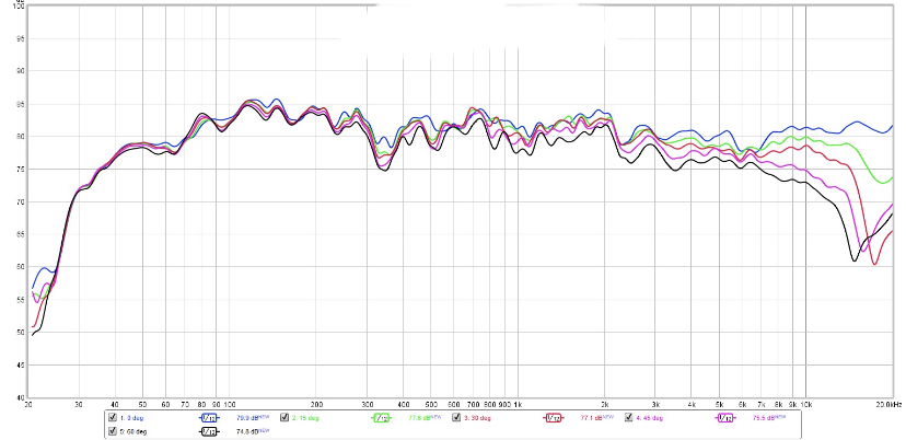

Polar response:

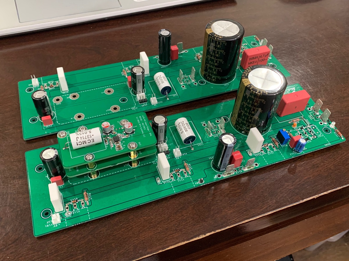

On the bench tonight, July 18, 2021: I just finished up my LuFo Lite headphone amp (that can play 3w into 8ohms). It sound superb. Perhaps one of the best headphone amps I have heard.

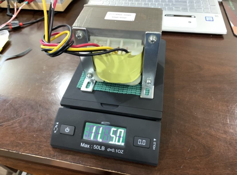

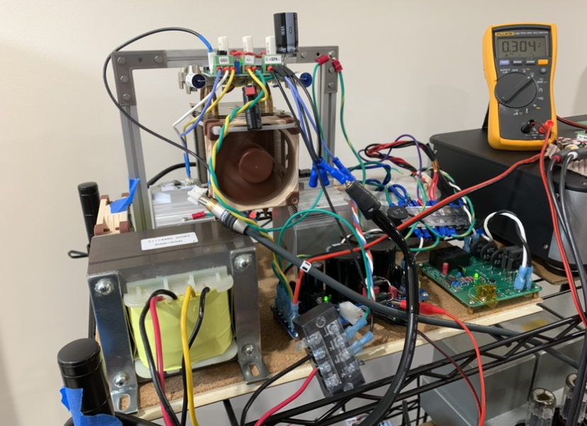

On the bench last night July 27 was a set of custom bifilar wound balanced chokes. Spec was 60mH and 0.5ohm DCR at 10kHz. These are 600w Class EI cores with a 0.1mm airgap. They measured well - identical reactance curves that lie on top of one another. Also checks out at 60mH at 10kHz and gives 160mH at 20Hz. They got a little banged up in shipment but seem to measure and work well. These are for the balanced LuFo 100w single ended Class A amp.
Listening to it in SE mode (non balanced output):
It sounds very good. The reactance varies smoothly and linearly over the audio range. Whereas the MOT has dips and peaks around 5kHz.
These are heavy suckers:

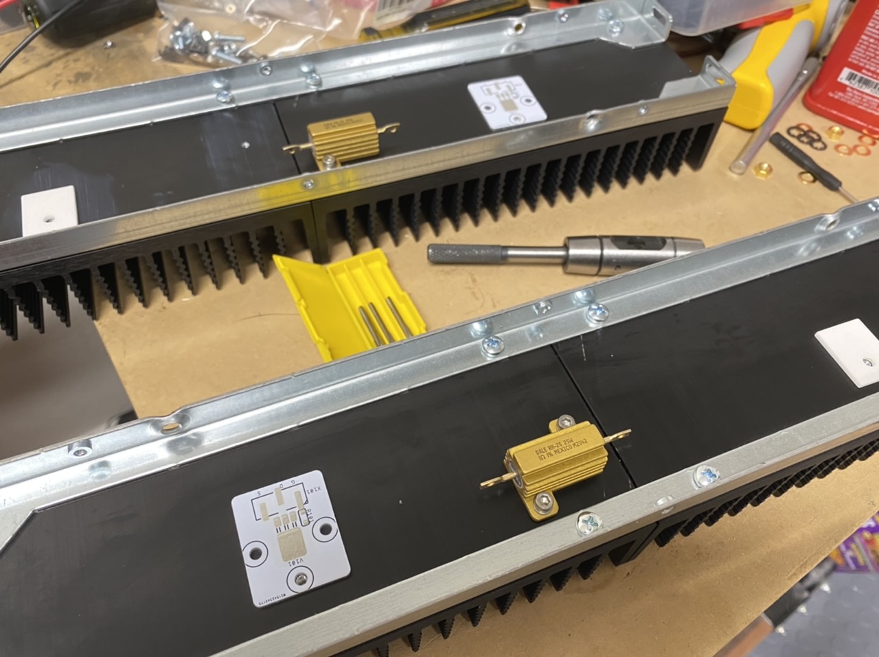

It is X. I had it laying around for another project but figured I would use it for something better. 😉 I think it should be able to handle the heat. I'm also going to space out the covers just bit with some washers so I can fit the MOT's inside. Should end up looking pretty clean.
That reminds me, I need to order the verification build PCBs for the LuFo Lite! Forgot all about it. Good luck on your amp!
