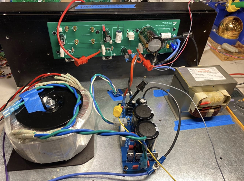

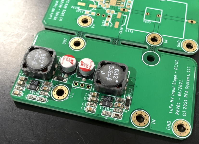

I just got back from vacation and these fine looking OPA454 and +/-35v DCDC booster power supply boards were waiting for me. I may have to do some SMT soldering tonight! 🙂

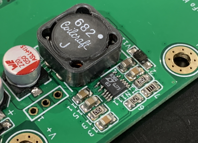

WOBT June 23, 2021: SMT assembly of the +/-35v DC/DC converter board for the LuFo OPA454 front end (FE) board. This is using an LT8364 SEPIC topology which is nice in that the output is galvanically isolated from the input.

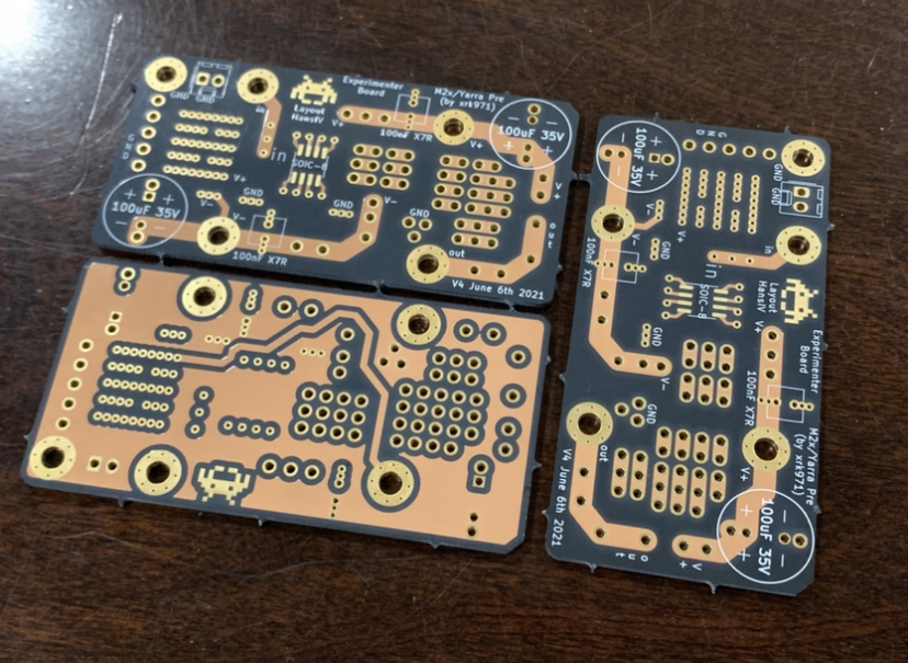

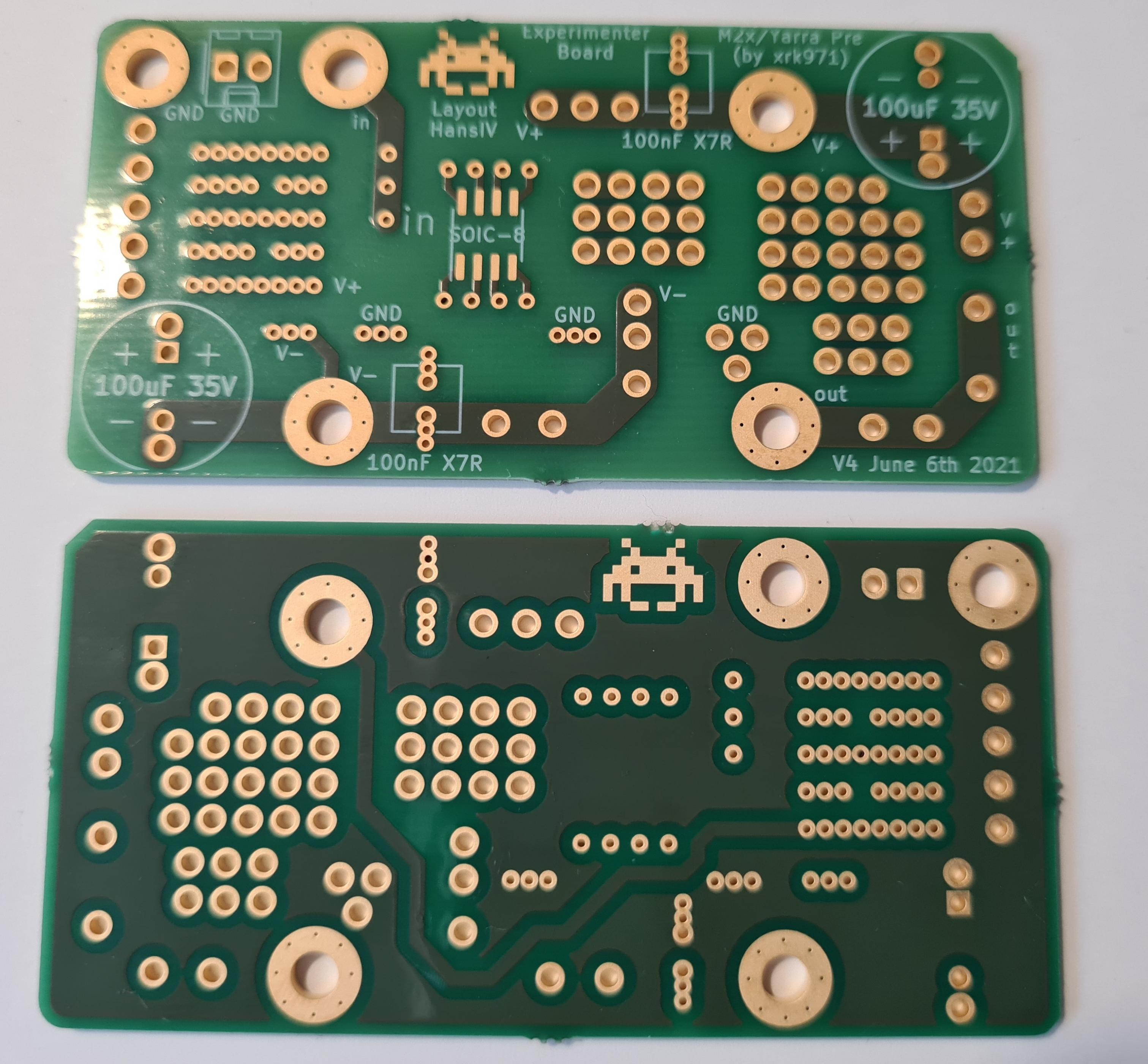

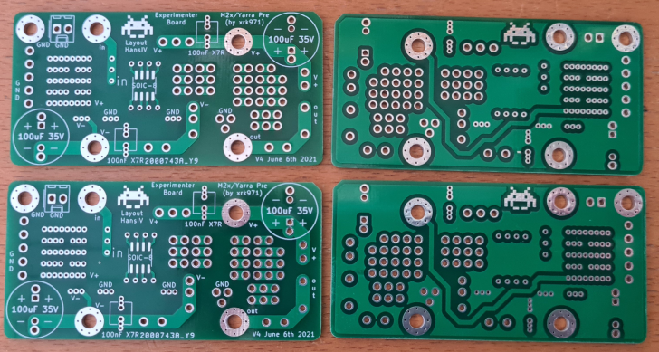

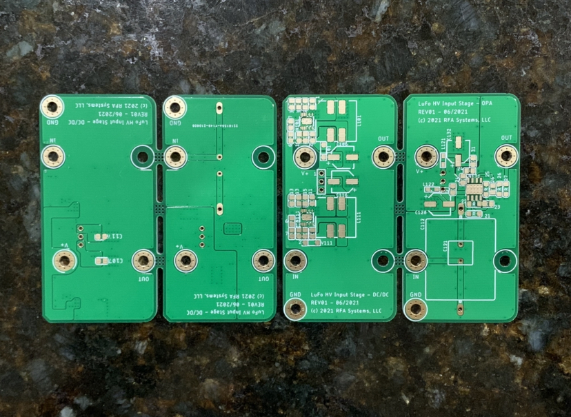

Experimenter boards have arrived. JLC PCB is the fastest. They look nice too.
Now waiting for my M2x boards from the diyaudio shop (shipping takes weeks / months). Hope they arrive soon, so i can start experimenting 😉
Hi Puijkh,
Thanks so much for sending me some boards and even a set of purple boards with ENIG from OSH. They are super premium looking!
These will be very handy to have around to try new designs.
WOBT June 25, 2021: Assembled the OPA454 Front End board for the LuFo amp. It fits on top of the PSU board nicely.
The OPA454 works! It’s singing away and sounds great. Very quiet too. Cannot tell it is turned on.

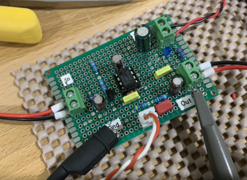

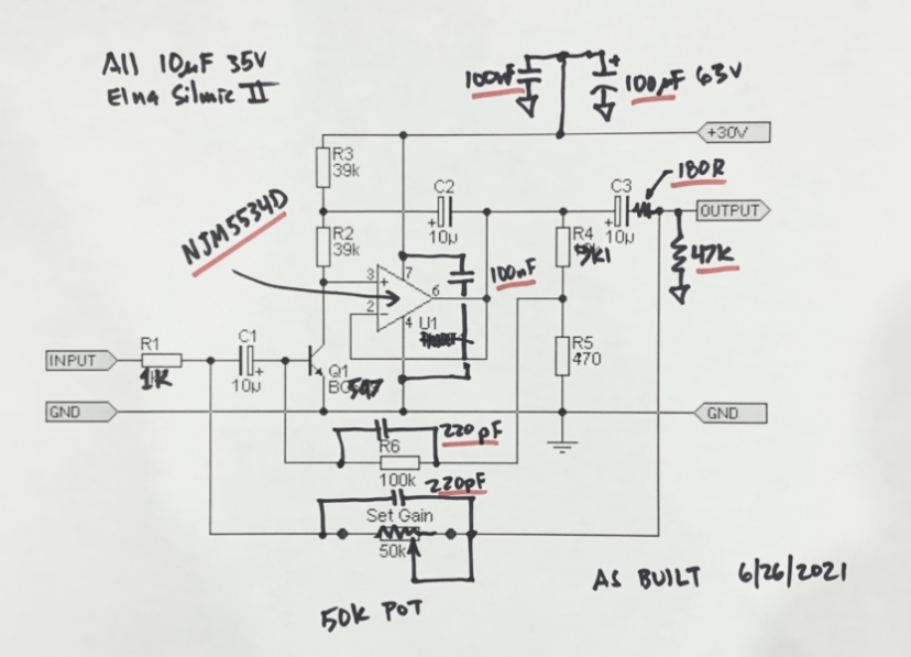

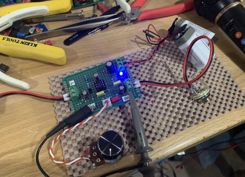

On the bench tonight is a simple dynamic microphone preamp. I got the circuit from Elliot Sound Products (ESP) website. I happened to pick one (project 113 figure 3) that was not verified but Rod Elliot said:
Famous last words… 🙂
Well it is missing a bypass cap across the power rail pins, needs a 220pF compensation cap across the 50k feedback resistor, and needs a 47k load on the output. It’s amplifying sound and works now but I could not get it to work with a TL071CP. I finally switched to NJM5534D and at least it doesn’t swing wildly rail to rail and makes sound.
This is a project that I am helping my neighbor build for his home recording studio setup. Simple projects like this never are simple. 🙂
Schematic as given:
This version has not actually been built and used in earnest, but has been simulated and is a viable proposition - it can be expected to work as described without problems.
Schematic as given:
Hi Puijkh,
The after dark from Osh park look really good. 🙂
I also recieved the enig ones from Aisler (about 2 weeks production time).
I am compairing different pcb vendors. The Seeed pcb's are still in transit.

I finally got the mic preamp to work. There’s no way this could have been done without an O-scope (a critical tool for any bench). I found oscillation at 13MHz and another at 2MHz. There was a massive rail to rail oscillation with TL071CP which went away when I used NJM5534D. I am using two 9v batteries for 18v rail and it works fine like that. Super quiet when powered with batteries too. It required two 220pF film compensation caps, a series resistor at the output of the opamp buffer, and changing to a BJT input opamp before it worked. But now that it works, it sounds beautiful. Super quiet , nice variable gain up to 32dB and now I know how to make a nice mic preamp. But yes, there went 4 hours of DIY audio projects time for my own stuff. But hey, I learned something, and I appreciate Rod Elliot for putting so much content out there for all of us to use for free. I go his site all the time to see how to do stuff like this.
Here is the circuit as built that now works great.

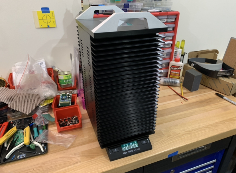

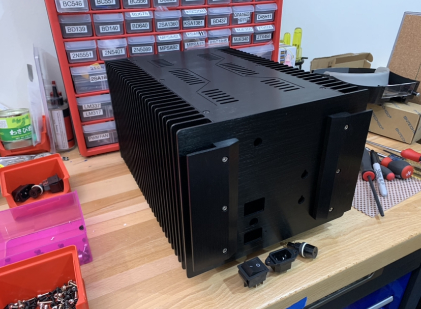

WOBT June 30, 2021: assembling the chassis for the LuFo amp. This is the first channel. It all fits perfectly. This thing is built like a German tank. Very nicely done.
Nearly 23lbs each:

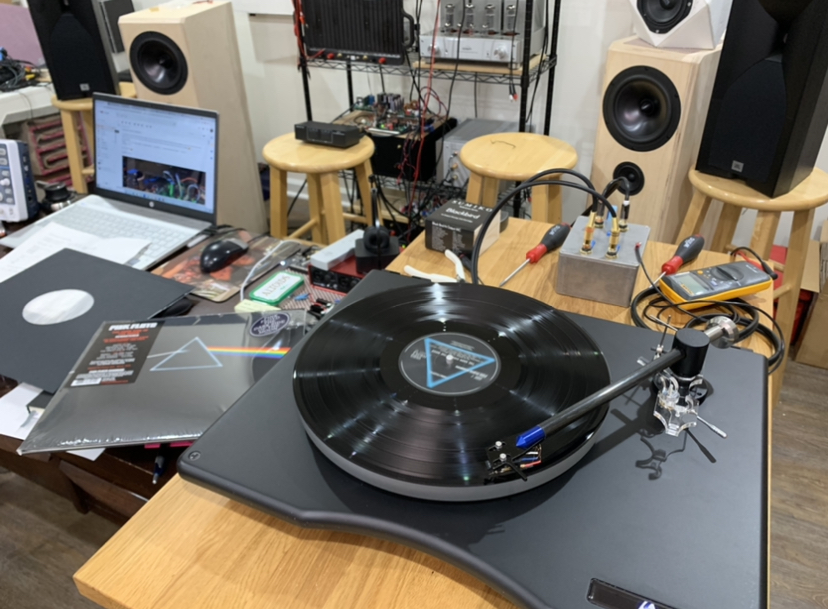

On the bench tonight - 4th of July, 2021: testing a new phono preamp design by Jhofland and layout by JPS64 on an LSA T2 TT with a Sumiko Blackbird MC cartridge. Using the LSA HyperSET hybrid tube preamp to drive DIYA VFET amp and 10F/RS225 TL speakers. Pink Floyd sounds amazing. This record gives me chills/goosebumps-good kind of a music experience.
