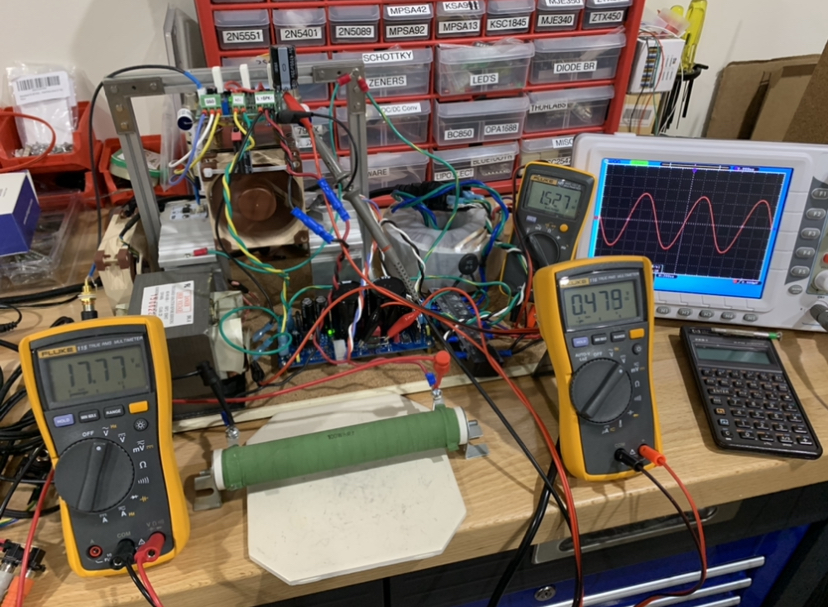

WOBT May 26, 2021 - Max power test of LuFo. I managed to get 17.77vrms into 8ohms. That’s 39.5w. As predicted and before onset of clipping.

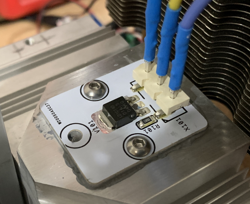

WOBT - May 27, 2021: I got a shipment of LD1014D’s (SMT version of LU1014D) from AliExpress based on a tip from Danny66 that they tested out to be genuine’s. I installed them on my aluminum IMS PCB adapter. It was so much easier to install these without having to bend the pins. They installed just fine. Then I quickly installed them in the LuFo amp to make sure they work. The bias current set up real nice and stable. The music sounds great. Running about 2.9A and Vs about 1.53v.
Here is is installed in the heatsink for the LuFo:

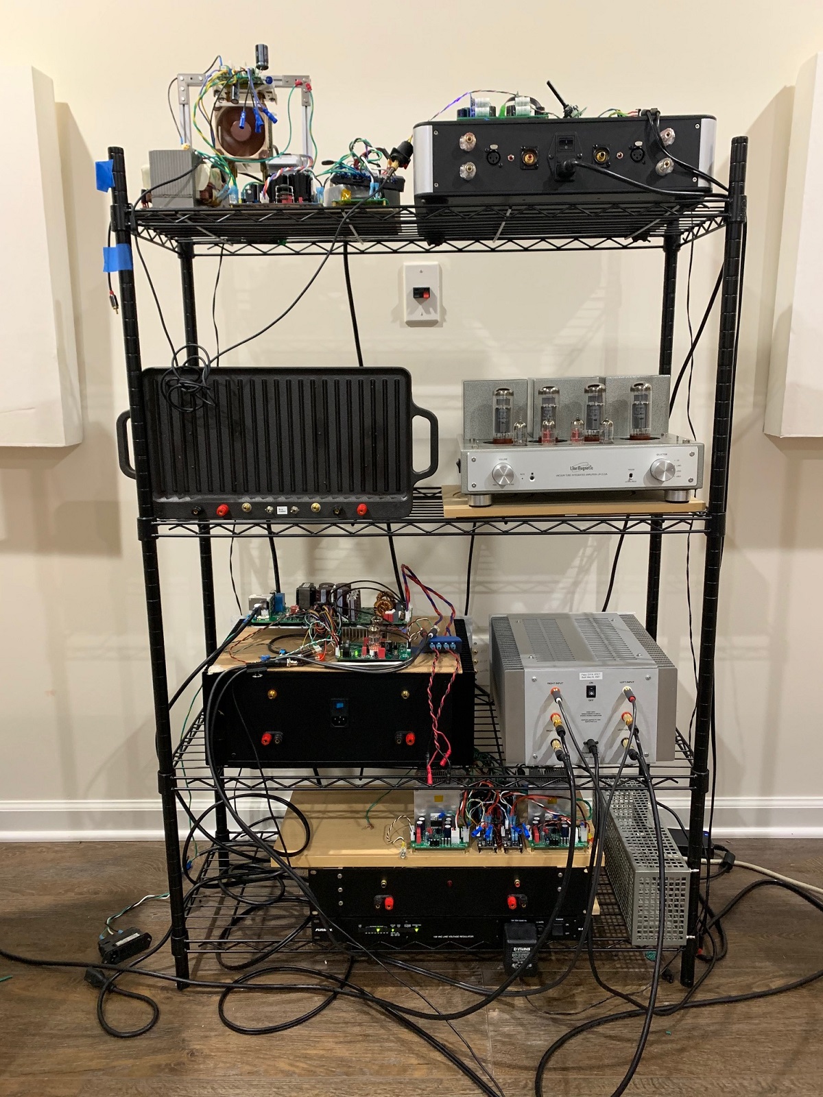

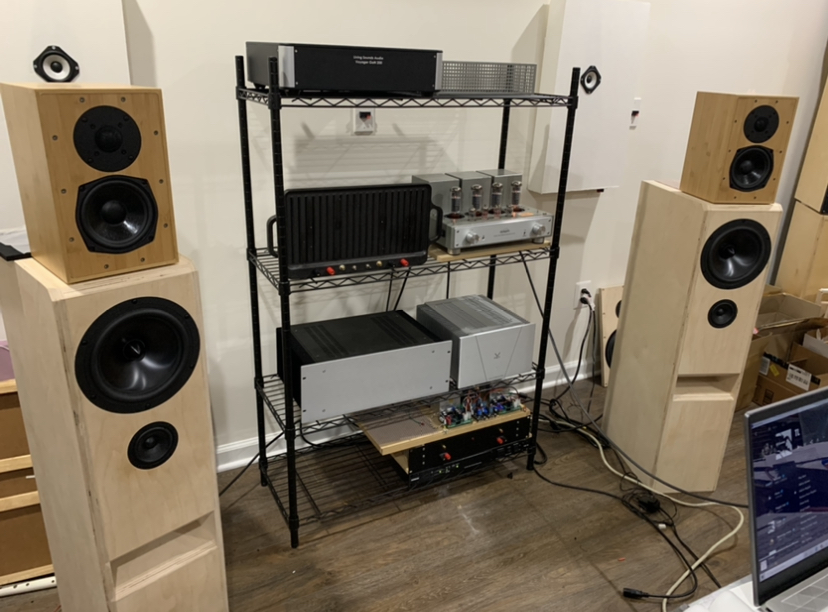

WOBT - May 28, 2021: Some lab cleanup to the front of the house mess. I got a 4 level wire shelf from HD (350lb capacity per shelf) and this let me populate all 7 working amps. I got a couple of new amps today for evaluation. A GaN Class D from LSA, and a tube amp from Line Magnetic. Here is the new rack of amps:

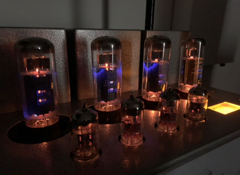

The LM-211ia makes a fine glow. Listening to it now - sounds very nice with the TLs:
I have only used if maybe 4hrs at a time. It does radiate a lot of heat from the tubes. But the chassis seems fine. I have not had any issues. This amp has been around a long time so I would imagine any over heating issues would be fixed by now.
WOBT - June 1, 2021: Listening to my amps on their new rack. Am I the only one who installs his amps backwards, or butt-out? For me, it makes no sense to put the front panels in front as I like to listen to different amps routinely. Much easier to use the rear side of the amps like a patch panel by plugging in the RCA's and speaker cables directly rather than reaching around the back of the rack. The only one not butt-out is the LM 211ia which has an IR remote control receiver window on the front panel.
Playing tonight is the Pass DIYA Sony VFET amp (s/n 010) on the lower right. A full 10w into 8ohms but it sounds very nice. I am driving it with a special hybrid tube buffer preamp with 14dB gain.

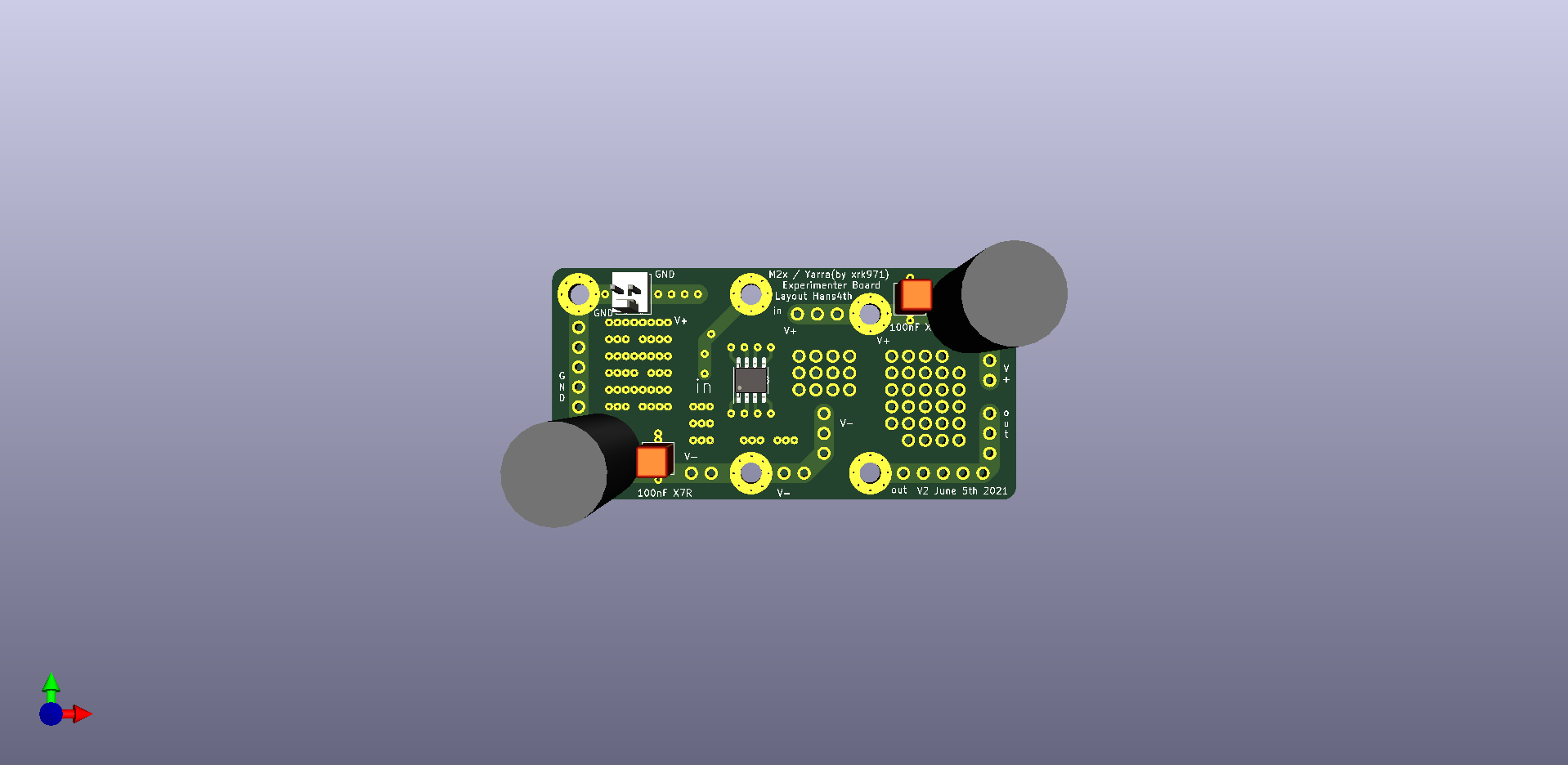

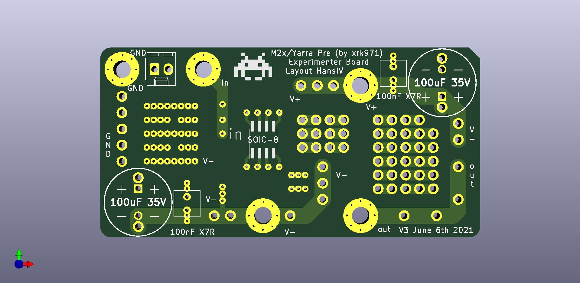

M2x / Yarra Pre experimenter board
Hi xrk971
I made a little experimenterboard in Kicad for the M2x / Yarra format pre amplifiers.
This way i can experiment with dead-bug style pre amplifiers.
Could you take a short look and give me some feedback. I am learning Kicad on the go. Maybe your blessing ??
Hi xrk971

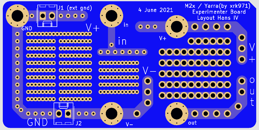

Hi Puijkh,
Wow - very cool! I was just going to ask JPS64 to make something similar to this. Of course, you are free to design this - I just ask that you make the Gerbers freely available. I do have a request - can you put a standard SOIC-8 pad with breakouts somewhere in the middle? Also, for the +ve and -ve PSU bolts, please add holes for say 100uF, 35v rail caps and 100nF X7R bypass caps? Double check your bolt hole locations. The horizontal spacing on the the 4 bolts looks compressed.

Hi xrk971,
Will update the experimenter board to v2 with suggested additions.
I will make the gerbers available together with the Kicad files on github (or any other place if more handy)

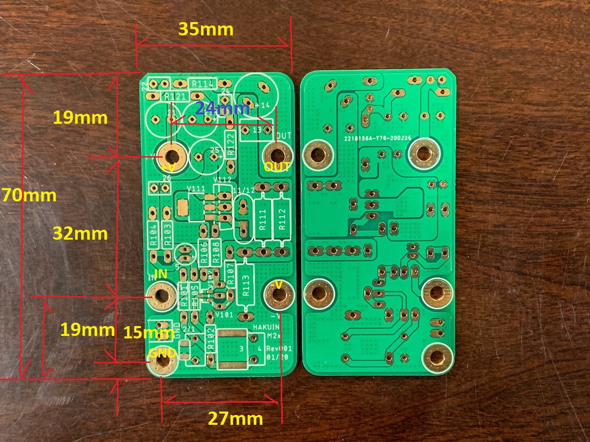

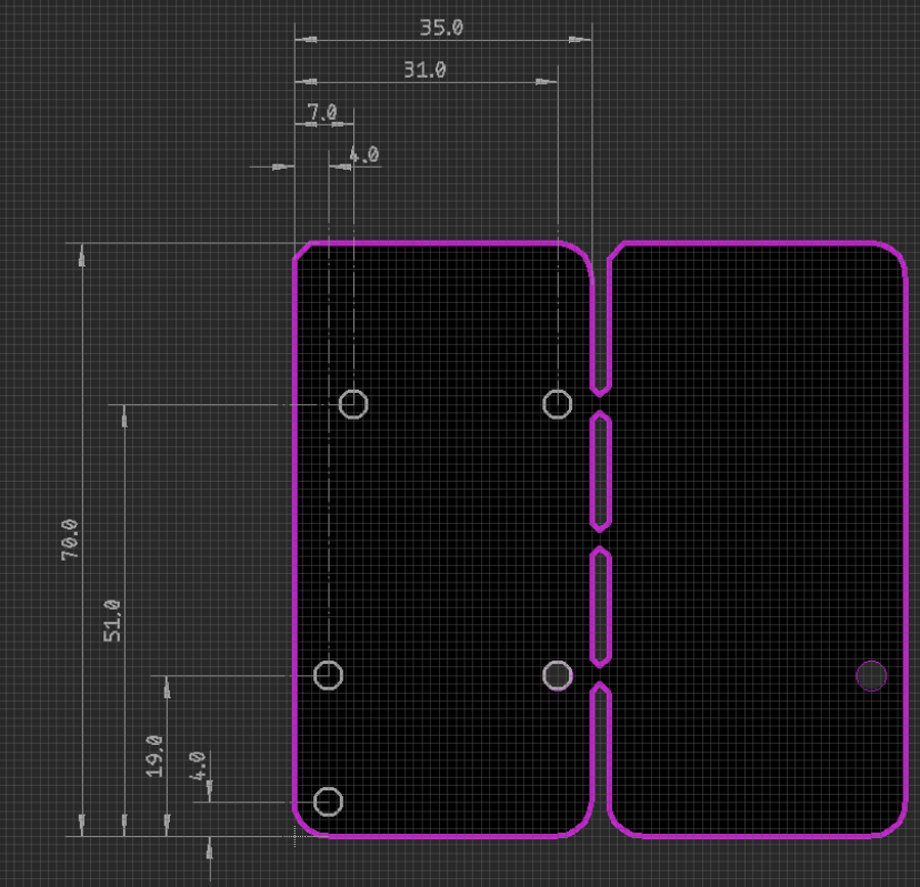

Might you have a mechanical spec for me for the mounting/signal holes.
I cobled it together from measured screenshot together with a M2x gerber.
Here is what I have for the board dimensions using a dial caliper. JPS64 might have corrections. The holes are all for usial M3 screw clearances (about 3.25mm dia). Board is 70mm x 35mm. Four holes are 32mm (Long) x 27mm W (larger) x 24mm W (smaller). GND hole in corner is 15mm offset. Board has 19mm overhangs on each end.

Hi Puijkh,
If your planning to use the Yarra/M2X mounting pattern, the V- is not in the correct position.
