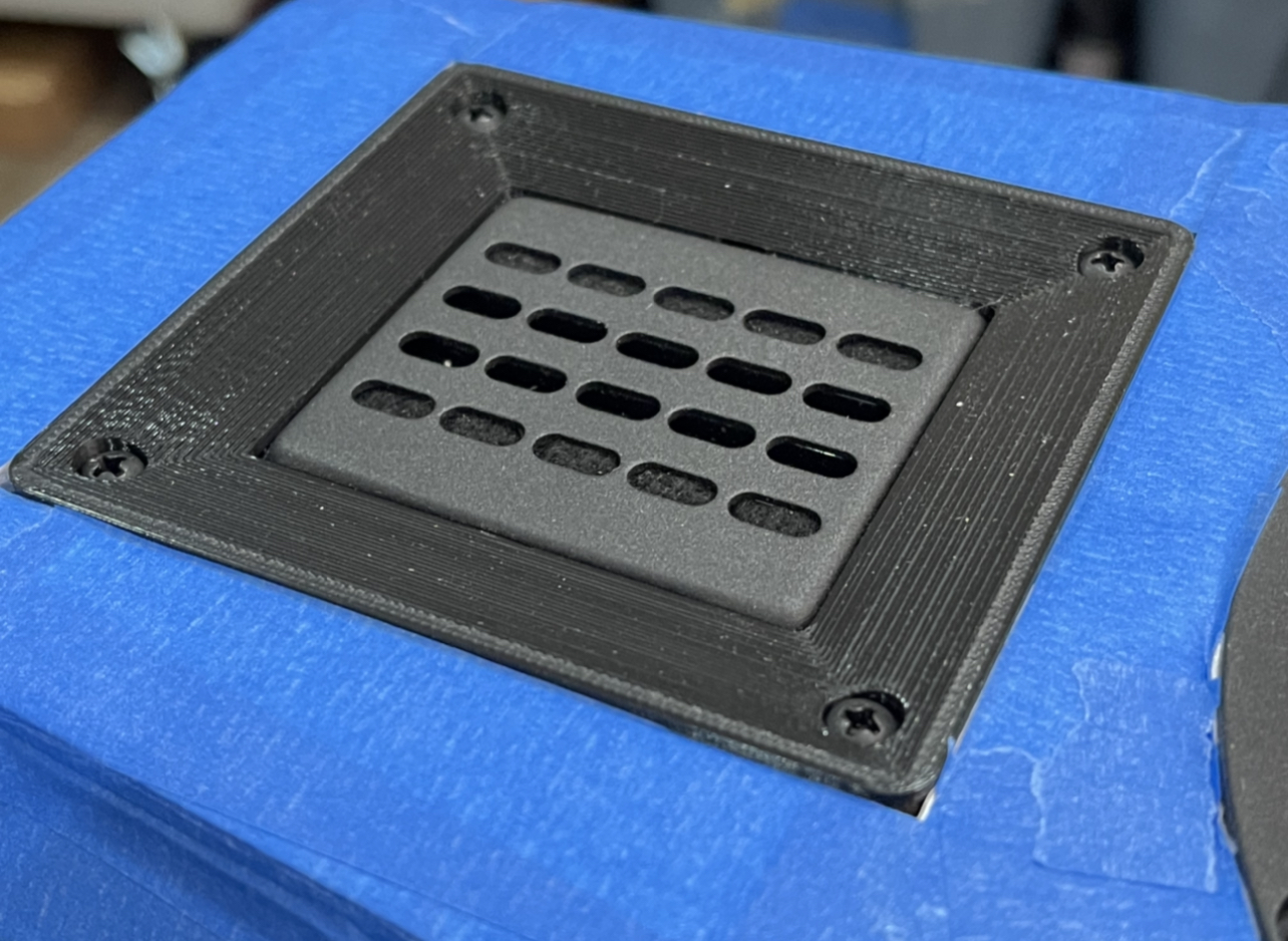

Tonight on the bench, I installed the new waveguide and took some measurements. It’s works great. Reduces distortion and flattens the response even more. The setback will require me to redo the XO but that’s ok.

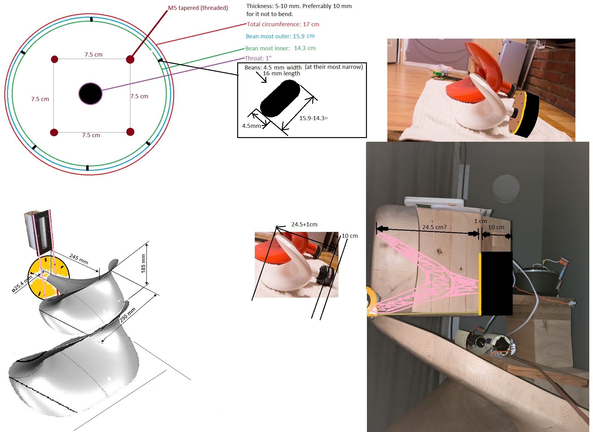

Let's see if the horn factory understands this drawing: xD
You want to make an adapter for a ribbon tweeter to a “fish lips” waveguide? The transition of the ribbon housing to the waveguide is very tricky to do and not get a nasty cancellation dip. I have tried to do this with a RAAL and a tractrix and was unsuccessful.
Nano-Trynergy - a Compact Tractrix RAAL Ribbon Point-Source Horn
Also, for some reason, ribbons and AMTs, and planar membranes do not seem to be able to get the usual 10dB gain by putting them in a waveguide. Something about them being non-pistonic.
I think the waveguide for the RAAL can be done if much shallower. It doesn’t like any waveguide that has semi parallel walls or a “tube” leading out of the exit plane.

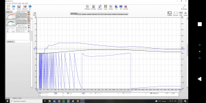

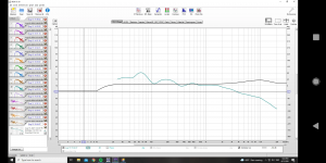

Yeah, there is 4-5mm space before it arrives to the horn. Raal measures amazing from 26cm but less amazing from 3 meters and almost need a treble EQ boost as you may hear in the video. After the video I boosted the treble and it was slightly better.
Future setup: Just to check what I am missing: Two pairs of compression drivers in Iwata 220 and Iwata 600 and the Raal with no horn, or very small horn but only to boost 10k-16K. I will consider removing the faceplate somehow. Is it even possible to remove the faceplatebon a 14-150D without the ribbon falling out?
Pictures are Raal playing alone measured at 26cm and the whole system from 3 meters measured with REW and Umik-1 microphone.
If you remove the faceplate, that releases the tension on the ribbon! You will have to follow the factory instructions on how to set and adjust the tension.
It is good then that I will run it without a horn., for whatever surprising reason I can motivate such a change with.

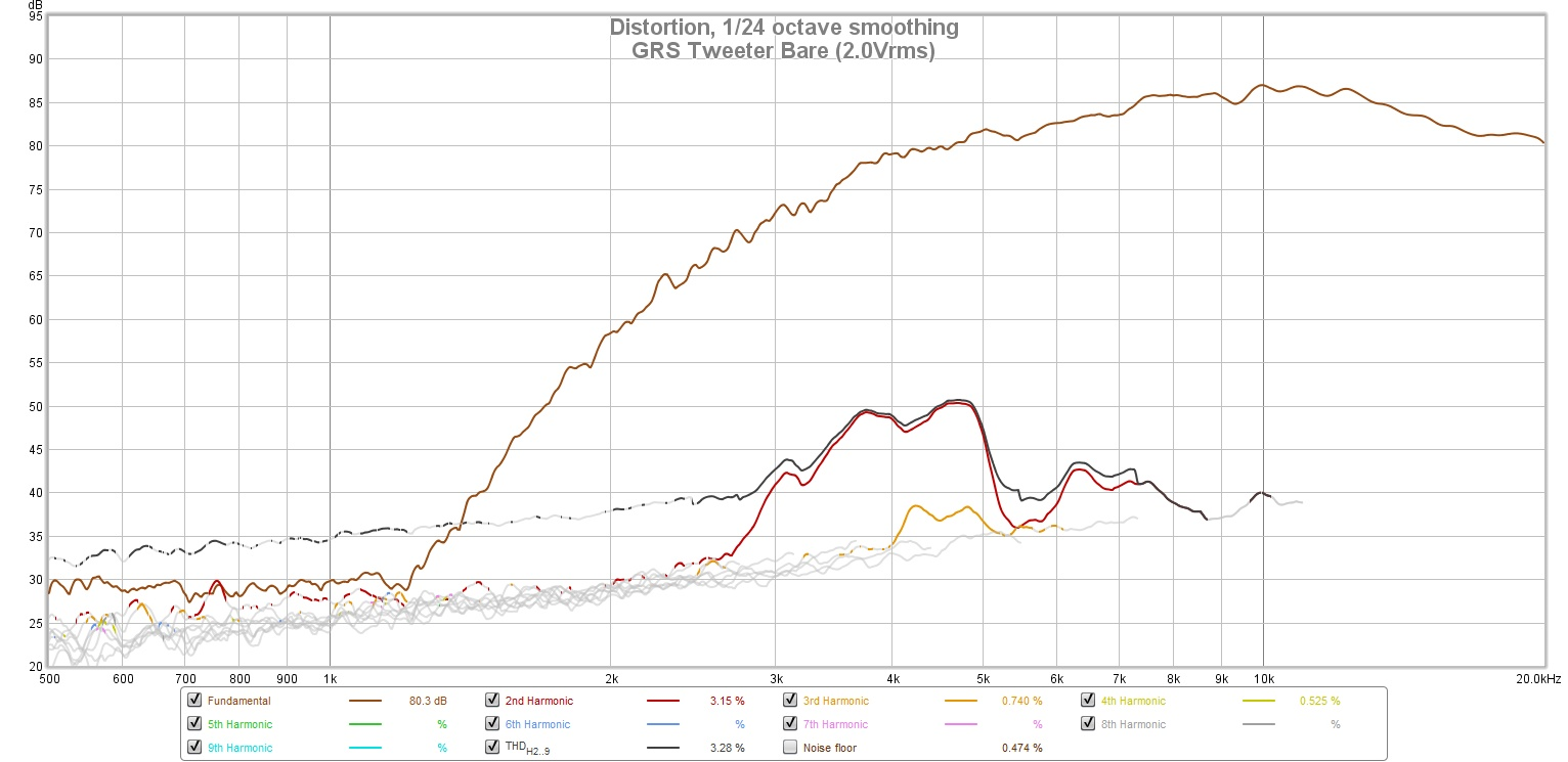

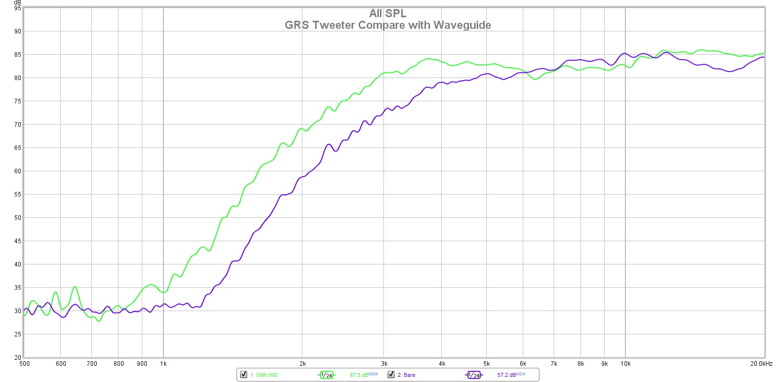

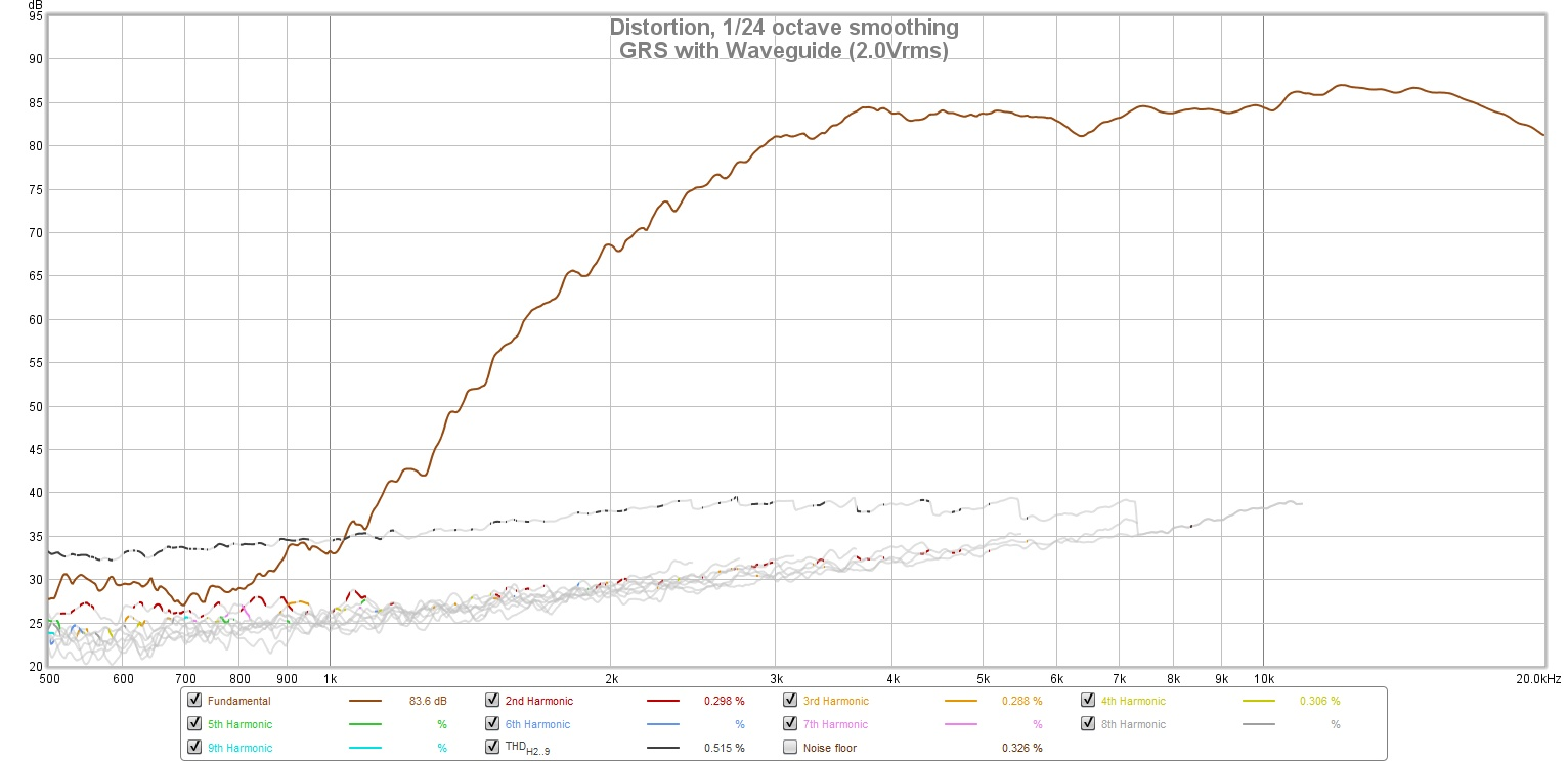

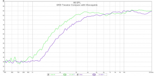

Look at what a waveguide can do here. It’s quite amazing - like it’s a totally different tweeter. For the same crossover filter, the tweeter reaches lower with more sensitivity and is flatter in response, better high end reach and distortion bump at 3kHz to 5kHz is basically gone.
With waveguide is green curve. Both are 2.0Vrms and mic is at 0.5m away:
Here is distortion without waveguide:
Here is distortion with the waveguide:
It’s amazing what a shallow waveguide can do.

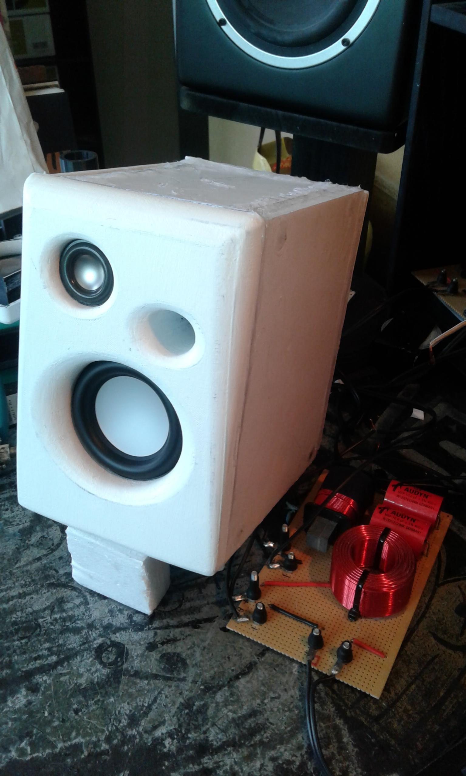

Great memories of those audiostar. Here's my XRK inspired, foamcore Boombox! It has a TPA3116 based 2.1 channel plate amp. I still use it in my shop for background music.

I forgot all about that speaker. Looks great!

Thanks X! That was one of the builds that really got me hooked on diyAudio. Can’t believe that was 4 years ago!
