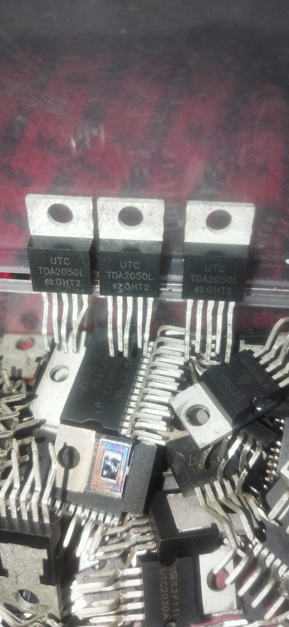

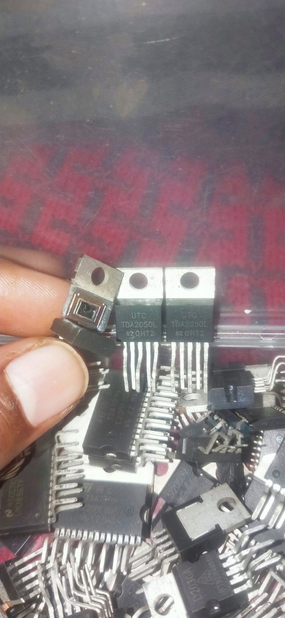

I bought them regularly , whenever I think so , sometimes I have to wait like 1-3 weeks but still I can see UTC tda2050l , although I don't find any LM1875 UTC made yet😑I still have 50pcs or more UTC TDA2050L in my personal bins and many National Semiconductor LM1875 NOS

And I bought them locally
Easily available here, but sometimes have to wait until new stocks arrives 😑

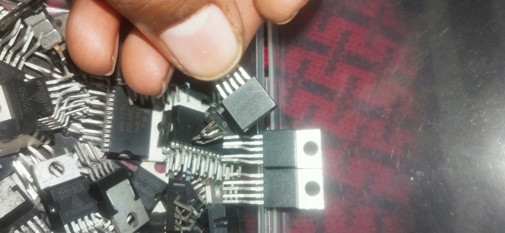

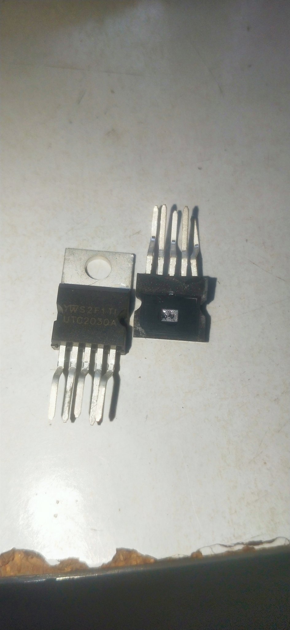

Otherwise available without any problems, and these days UTC fake aka Chinese made UTC2030 and UTC2050 are in the market,YW marked ICs are fake UTC made in China

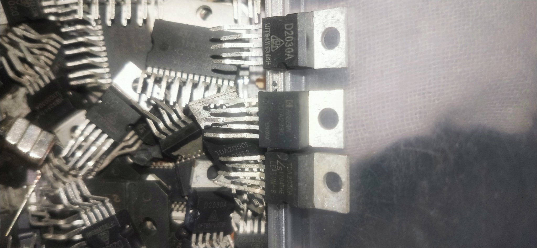

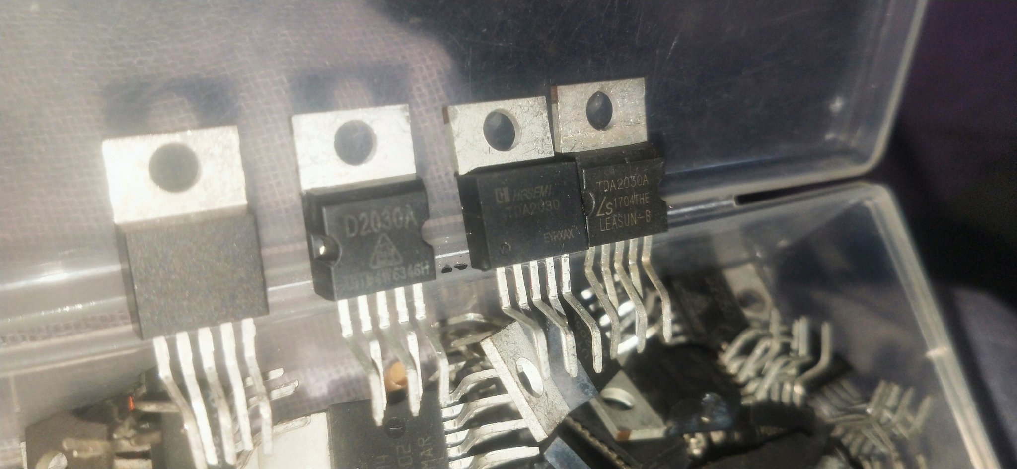

Also recently I found HGSemi TDA2030A and Triangle D2030A

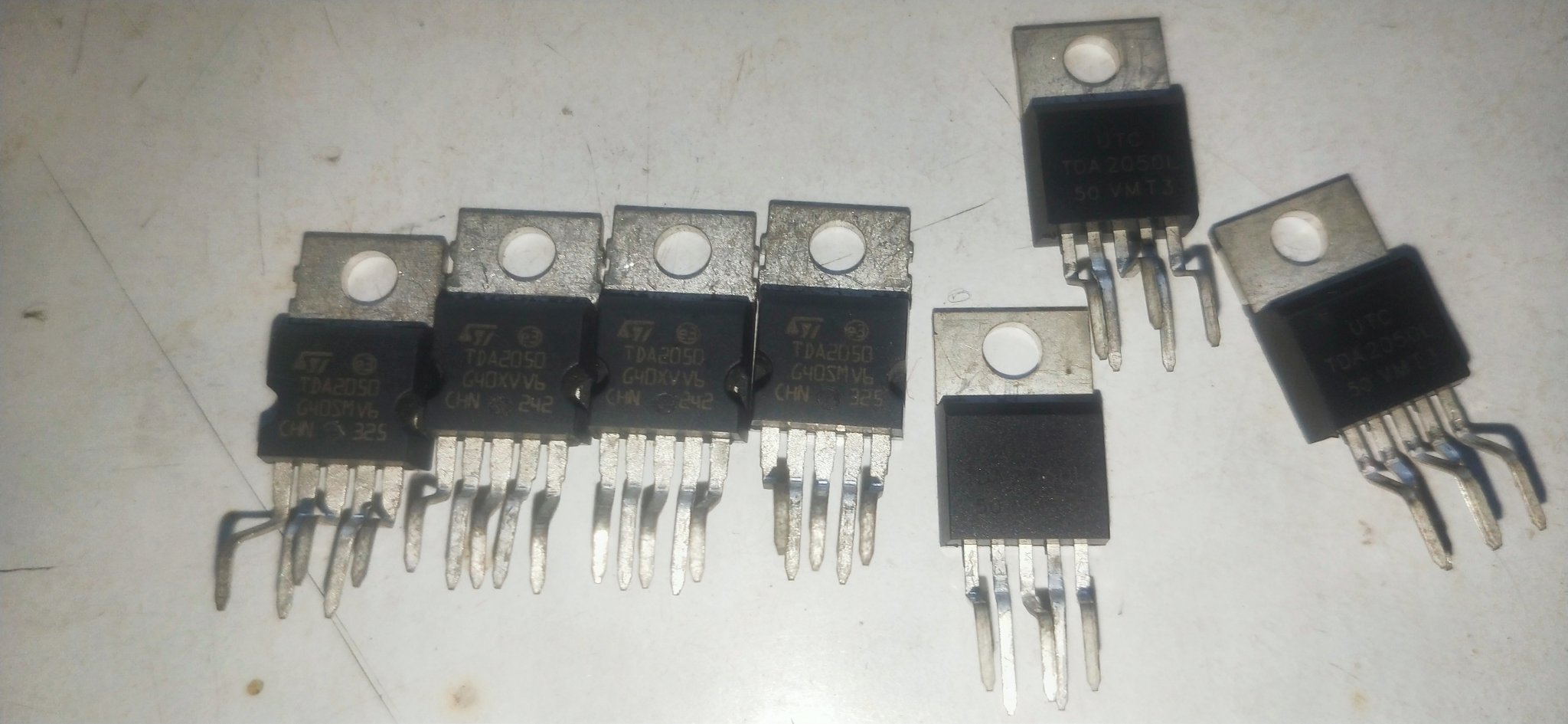

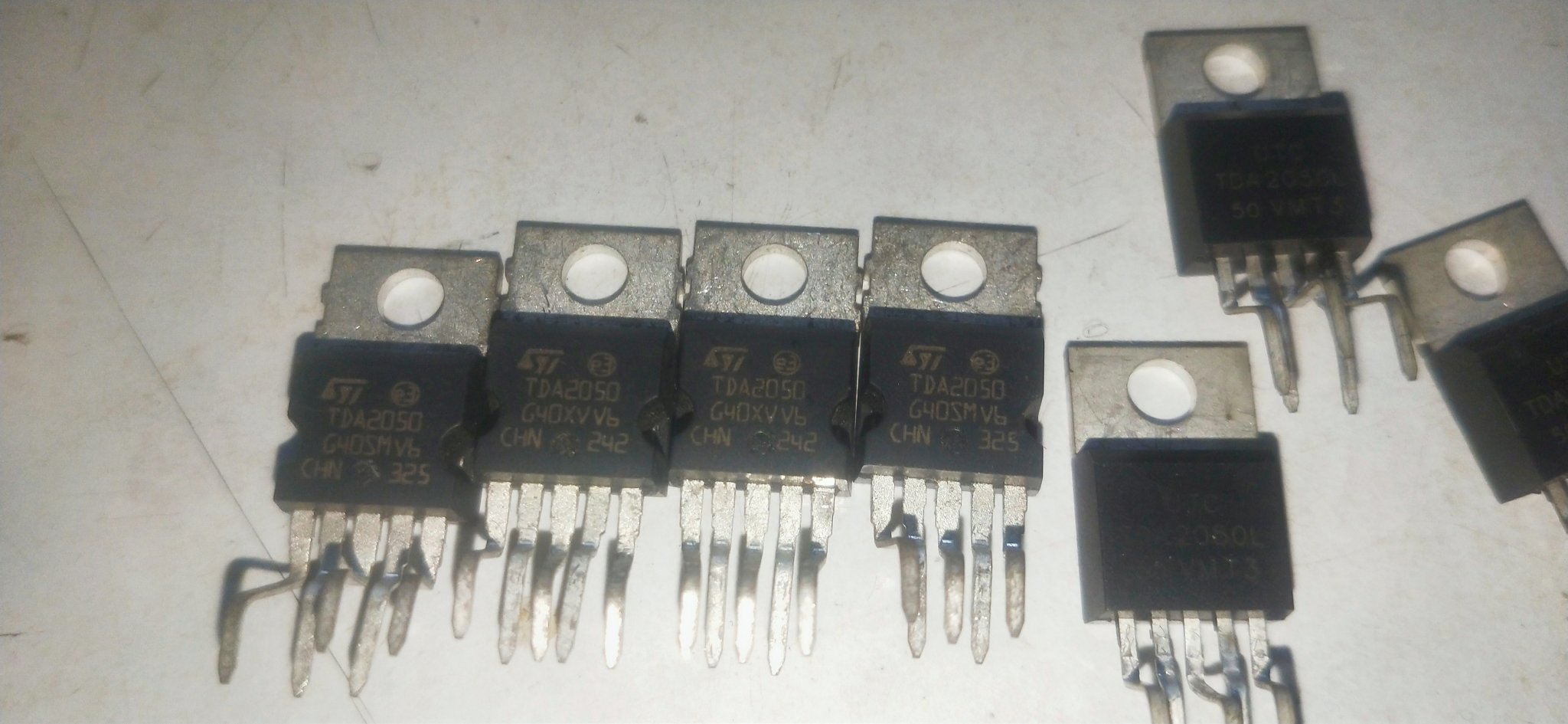

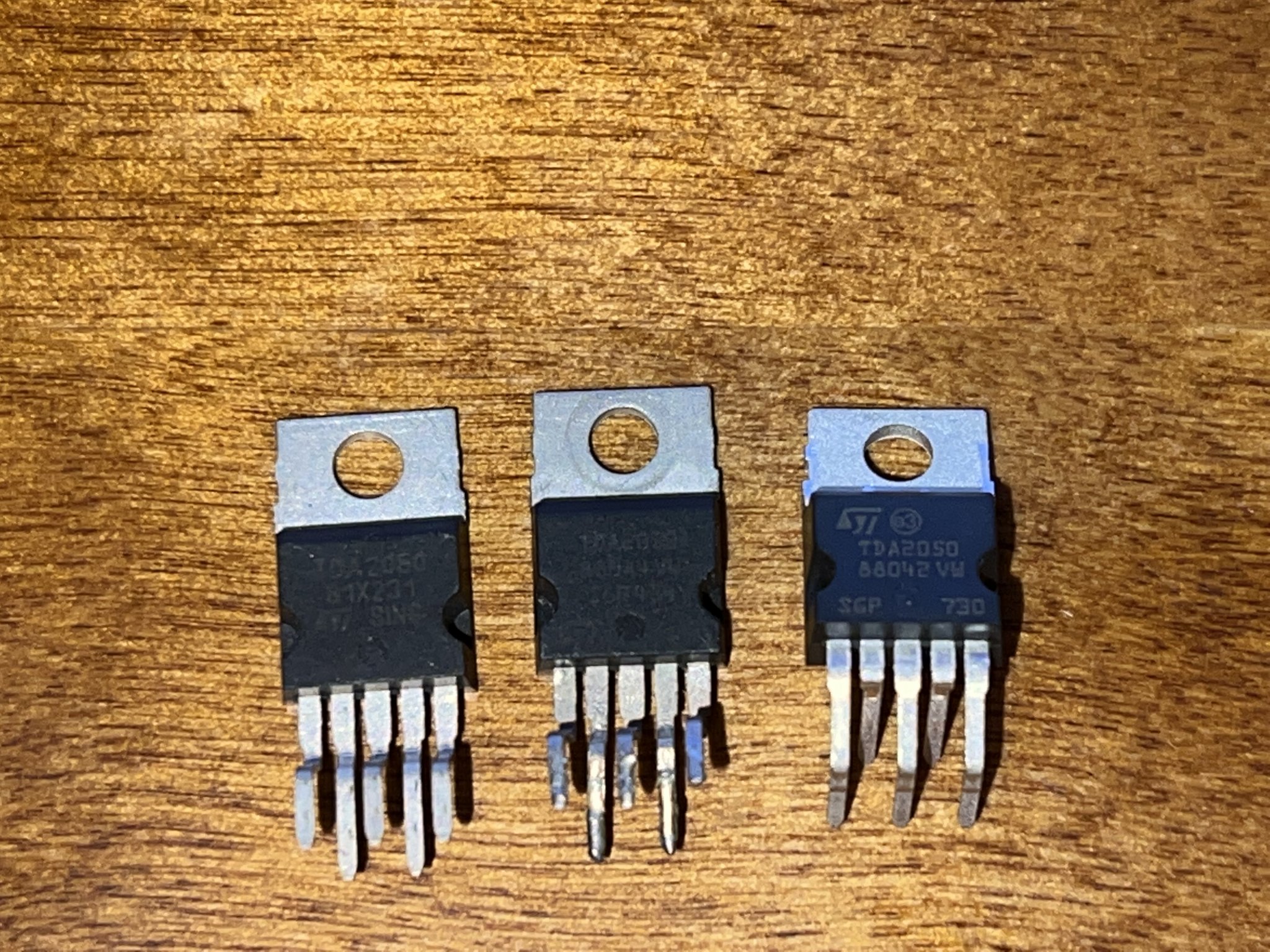

And this year was little bit lucky enough that I found Original ST TDA2050 , sadly only 6 ic, but Original

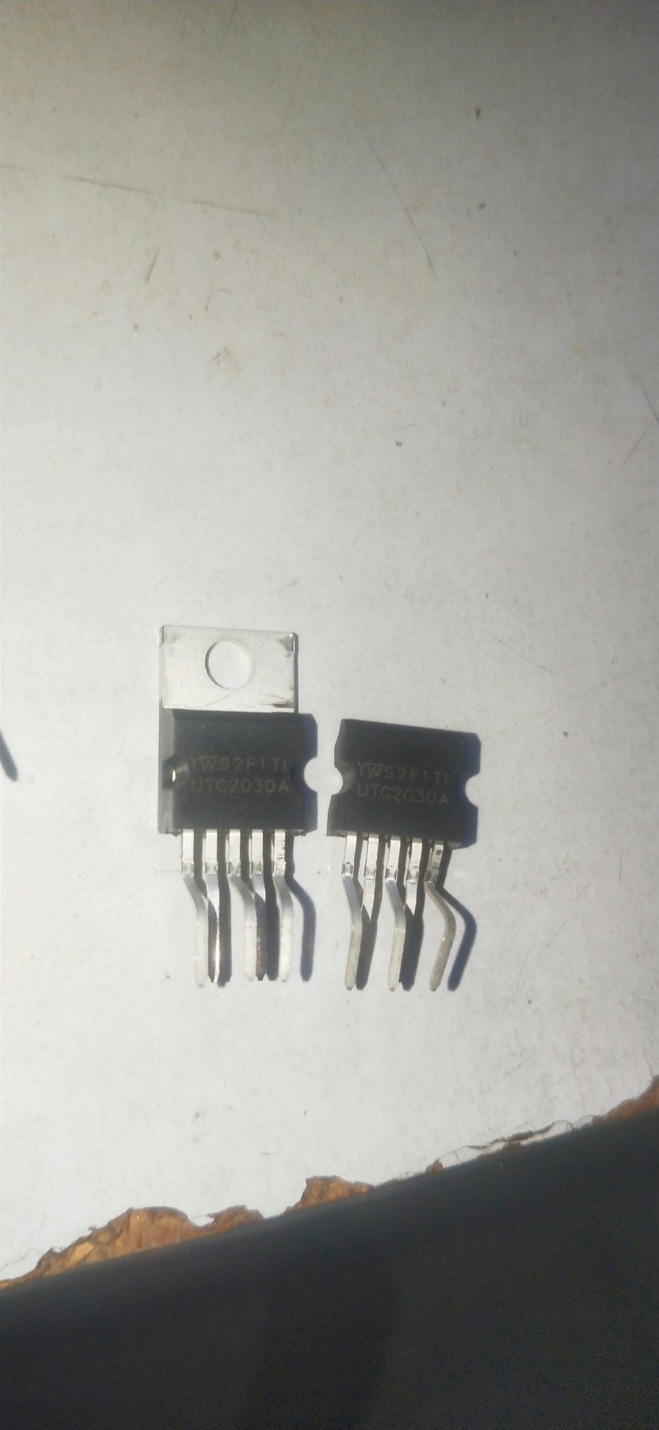

Here is the HGSemi and Triangle TDA2030A and one other ic which I haven't identified yet 😑

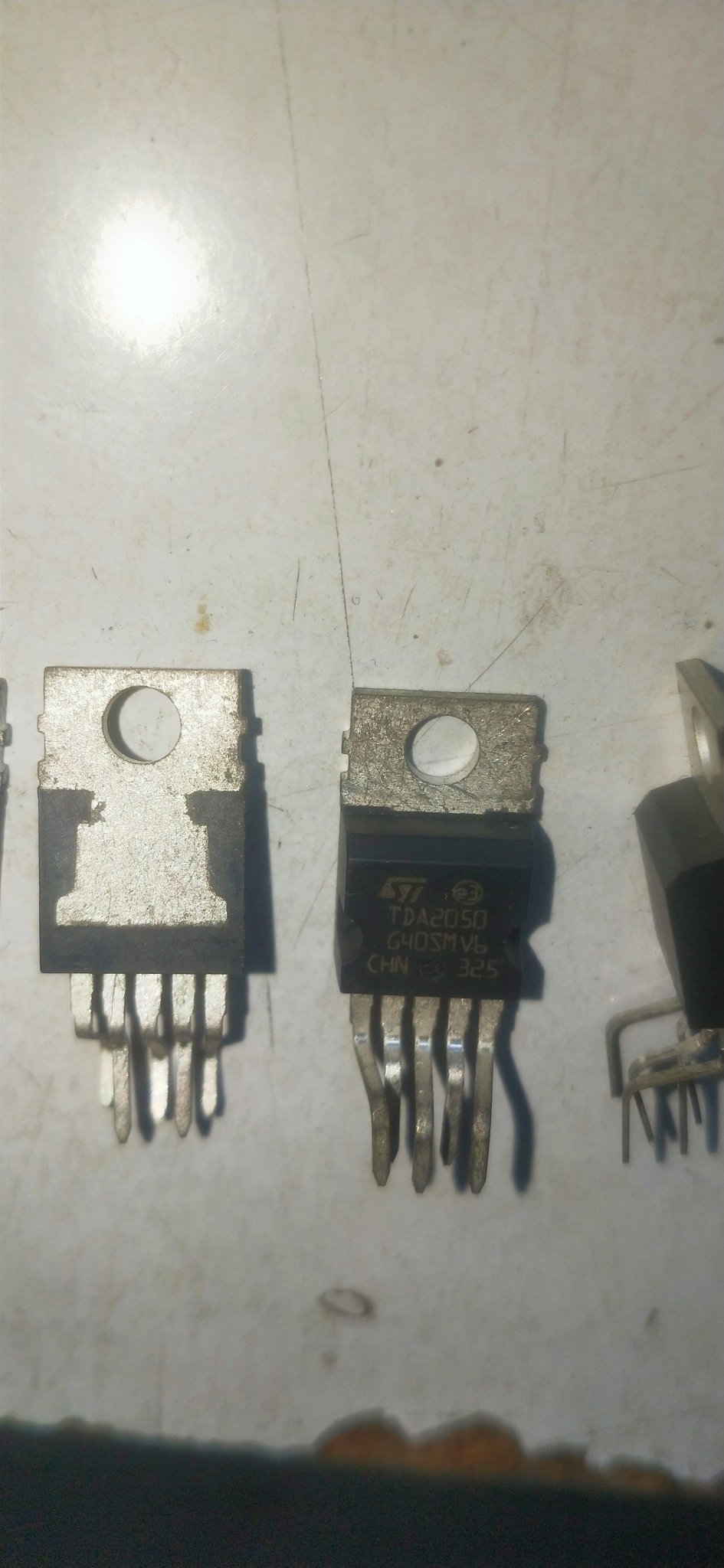

Here is UTC fake made by YW China copy

Those ST tda2050 look like the real deal.
Can you plz post a picture of their back ?

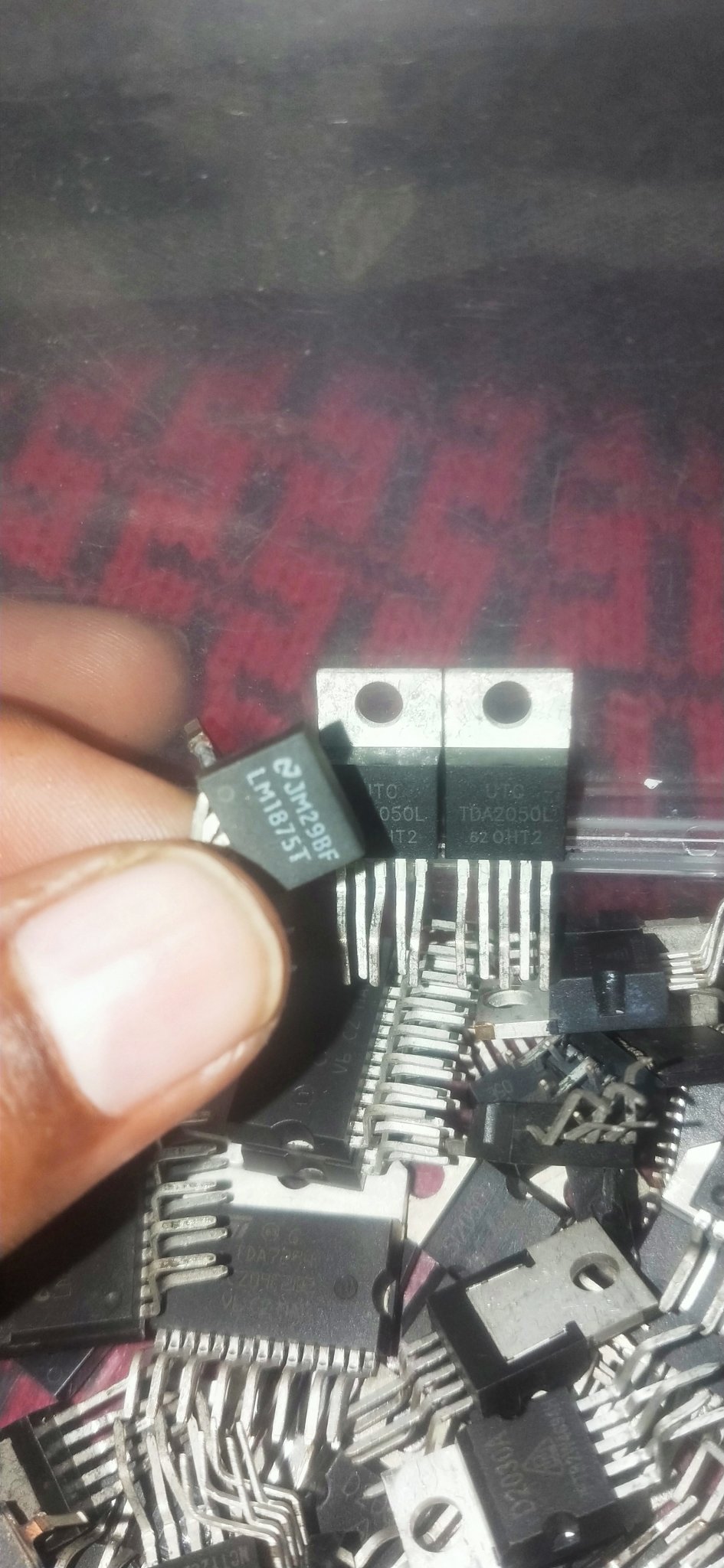

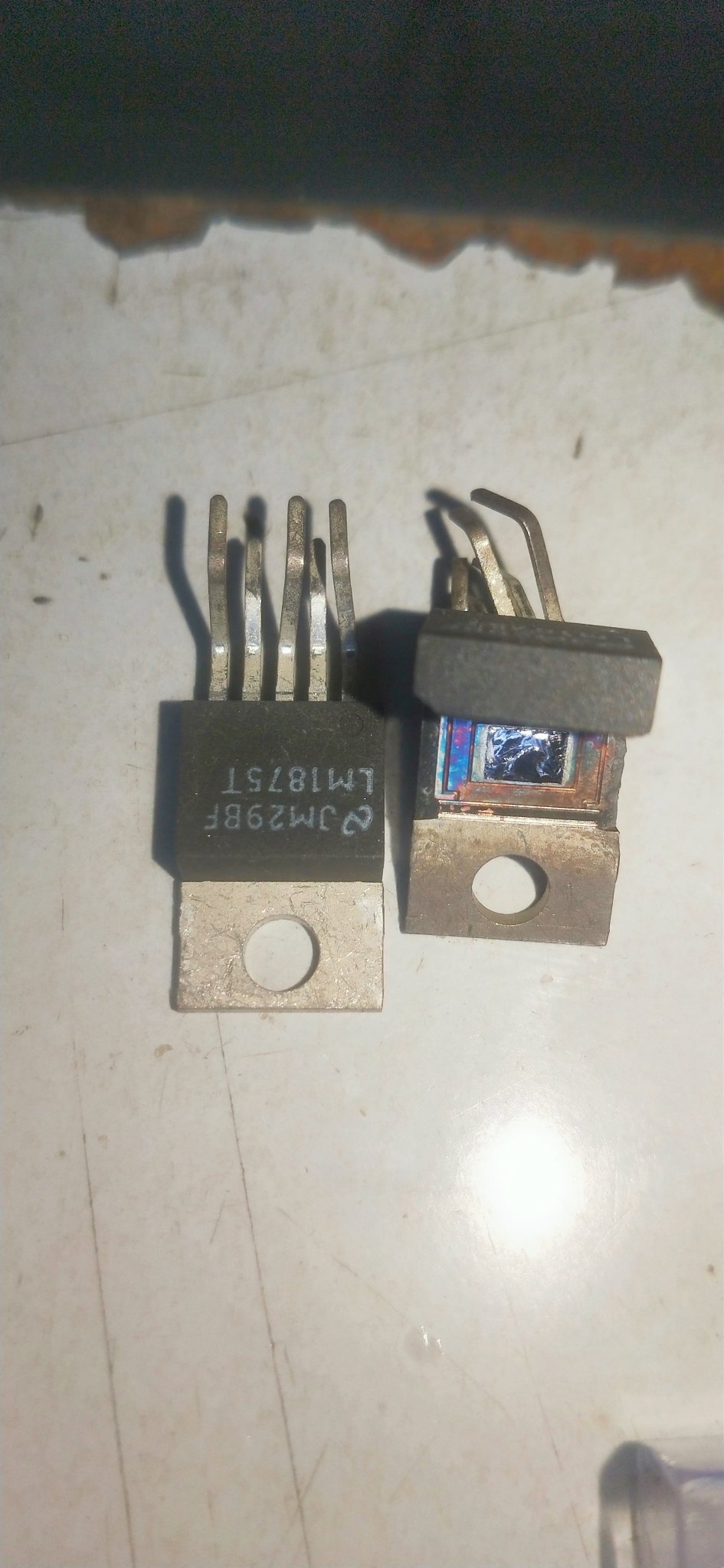

Here is the National Semiconductor NOS LM875T

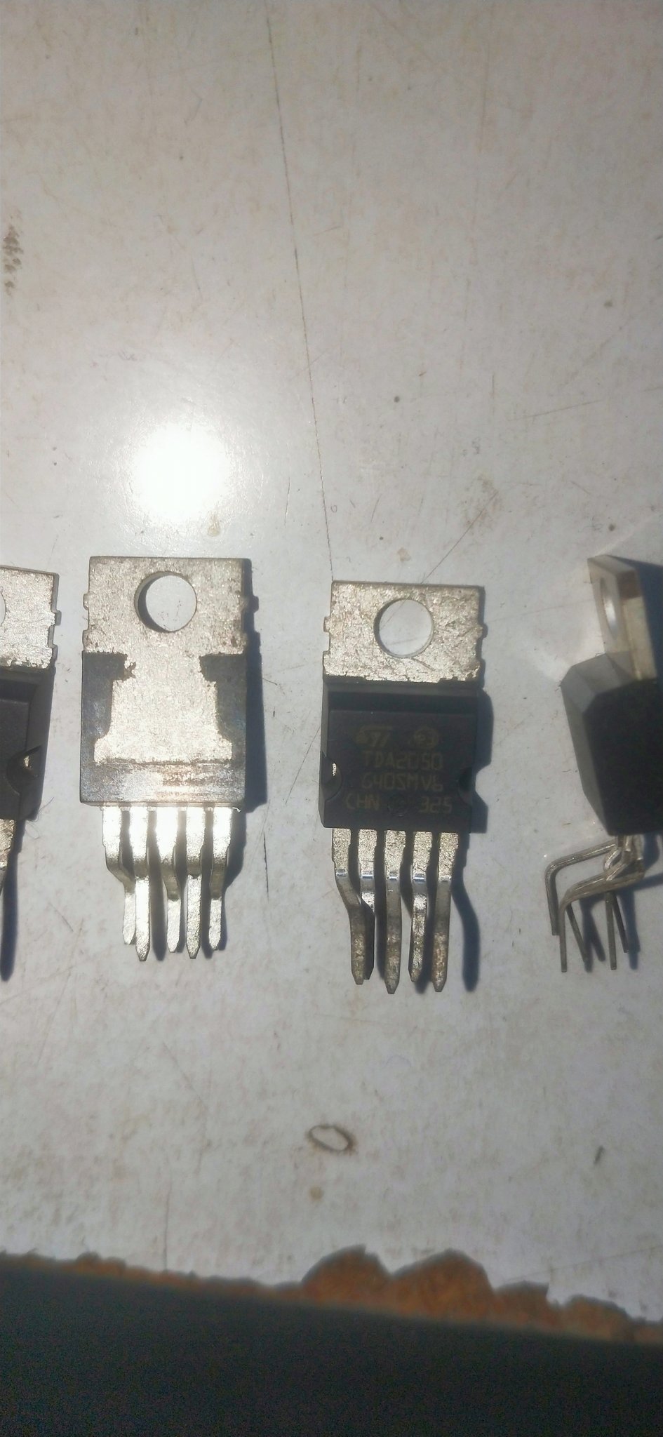

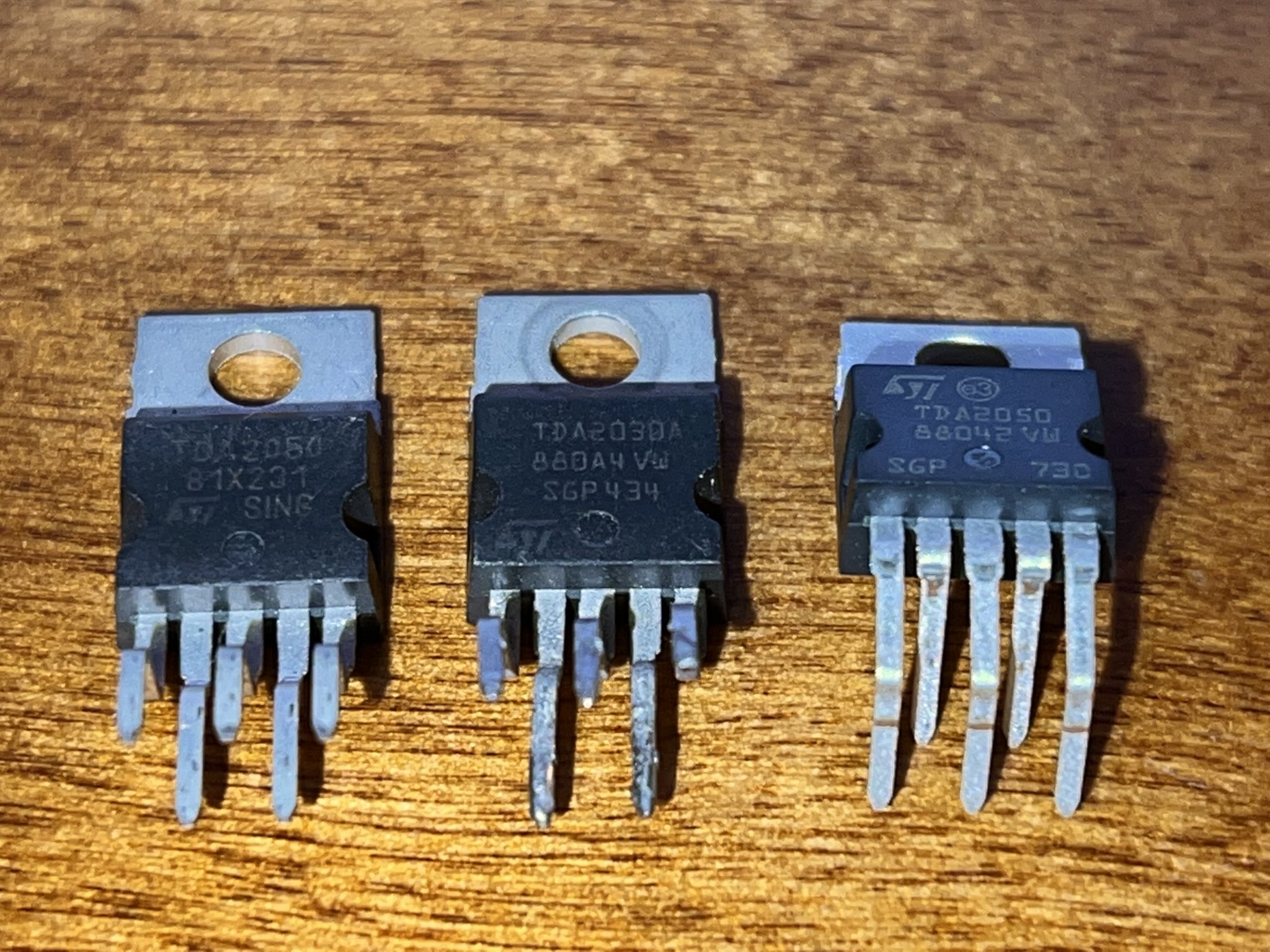

Yours are made in China( under ST licence ), mine are Singapore.
The one on the left is 2050v, in the middle is 2030A, the one in the right is 2050H,
the back of these chips(made in Singapore) is IDENTICAL but it looks different than the ones made in China.

No that Big one is Original LM1875TTHANKS Vipinsaini20 🙂
Your "big chip inside" confirmation
made me trust the UTC2050 ones which I´ll order from Profusion, probably 200 of them.
I must first arrange some "channel" through Argentine Customs so they don´t get stopped there , as in some beerbelly corrupt agent saying in mocked astonishment "TWO HUNDRED!!! What do you need that many for?" hinting he might let them through "just once" if I suggest some "generous contribution" ..... oh well.

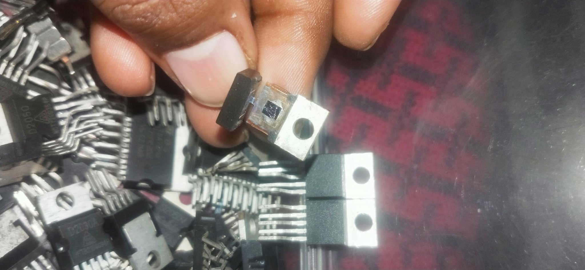

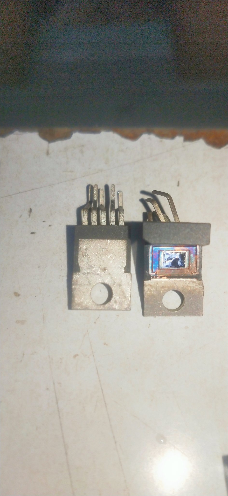

Look carefully
LM1875T have 10mm² die inside
Now here is the UTC TDA2050L die
It's smaller than LM1875T , but it's a very good quality product
Don't worry about quality of UTC,
