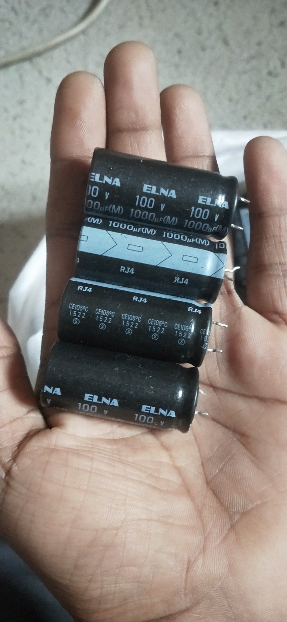

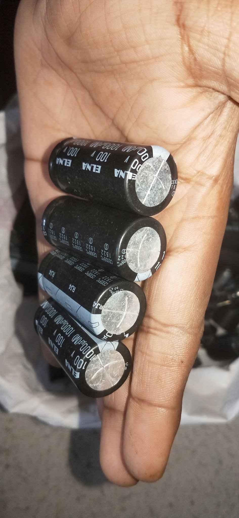

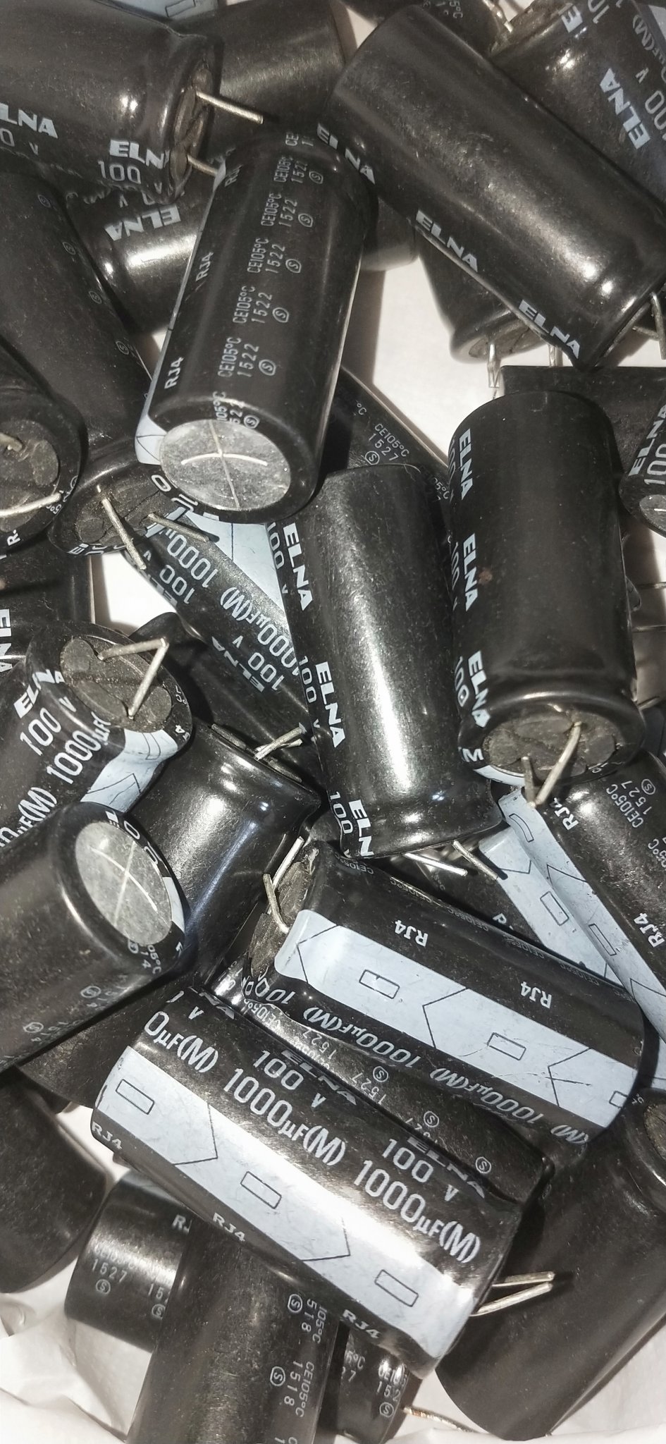

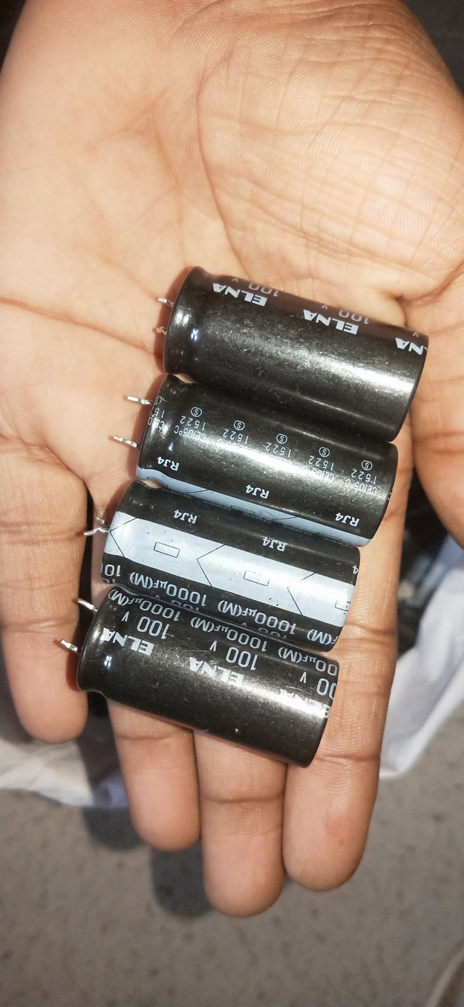

Hello guys
Little bit off the Subject here
I got some capacitors recently
ELNA RJ4 Series 105°C Capacitors
What you think about their Originality and Quality
Capacitance is within 8%
ESR is 0.06 , Datasheet says that 0.13

I think some self-restraint is needed. One photo would have sufficed...
LlQ
Some people needs 360° viewI think some self-restraint is needed. One photo would have sufficed...
True enough, but having 4 of them, all 4 sides can be shown in a single picture 😉
Geometry 101 😉
On the other side we are missing a good closeup of the rubber seal, which certainly can tell its side of the story 😱
In any case, we are only seeing "a plastic sleeve"
FWIW it is EASY to cut open an original one, flatten it (maybe between 2 glass sheets), take a picture of any resolution needed, "clean" image in Photoshop or even redraw it in Corel Draw which admits bitmap input and turn it into a perfect Vector image.
Output in 2 bit Black and White is the perfect artwork to have tens of thousands printed and used to wrap junk, if so needed.
Meaning: I don´t care too much about "Forum picture identification", a dedicated faker can copy that easily.
If anything, "mechanical" stuff , such as transistor or IC back metal parts are much more difficult, they involve expensive dies and machines.
But .... a LABEL? .... any day of the week..

The dies on top (vents), and bottom (seals) are hard to make, and distinctive, like the tabs on different 2050 like shown previously.
There are web sites about those, and experienced people can identify capacitorss without the sleeves.
Check out Mouser etc., 105 degree caps are less numerous than 85 degree ones.
See here:
https://www.elna.co.jp/en/capacitor/pdf/catalog_07_08.pdf
FWIW, the dents on top look genuine.
