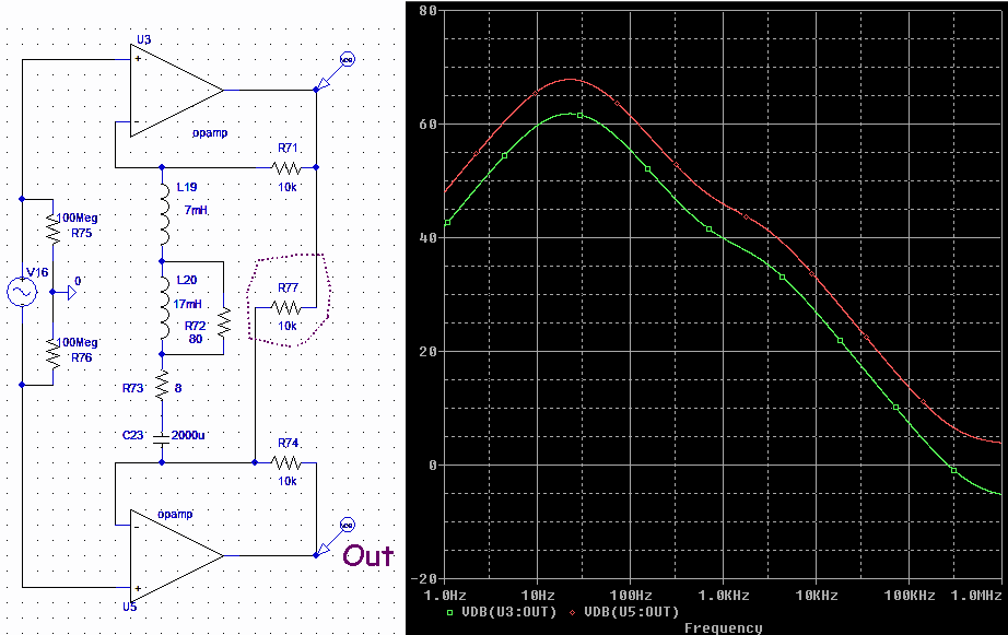

> doubling up an expensive RIAA network is inelegant
No need to double-up. You may hate the answer. Attached.
100Meg dummy resistors just placeholders.
The inductances and corner freqs are dart-boarded to a right octave but will need better calcs for accuracy.
The size of C23 is embarrassing, true. There are other ways.
First consider without R77. If cart is truly floating, or balanced, output is balanced. If one side of cart gets grounded, output is poorly "balanced".
Now connect R77. The lower output is a true SE of the differential input.
I must say that ignoring poor contacts in plugs and green-lead, essentially all the hum in dozens of systems was stray field from motors, PTs, lamps and such getting into the cartridge. First clue is that the hum changes as you move the arm. I have had to compromise for lowest field on the record, allowing some small hum on the arm-rest. I have had to tell users they could NOT put that reading lamp right next to the turntable (or if they did, don't complain to me). I have not observed any hum I thought was common-mode.

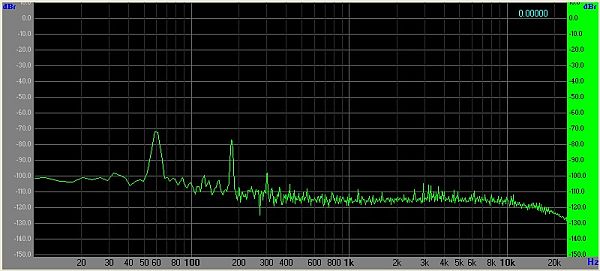

EDIT: Just found a comparison between RCA/Coaxial and Floating/STP: http://www.proaudiodesignforum.com/forum/php/viewtopic.php?f=6&t=423&start=134
These tests were done with an S681 mounted on an arm.
Unbalanced RCA connections with a grounded differential input:
Balanced Flat Phono Preamp with RIAA EQ Applied, Noise Floor, Unbalanced coaxial RCA Connections, Grounded Differential Input, Stanton 681
Balanced shielded twisted pair connections with a fully differential input:
Balanced Flat Phono Preamp with RIAA EQ Applied, Noise Floor, Balanced Shielded Twisted Pair Connections, Fully Differential Input, Stanton 681
The difference in "hash" between 1-10 kHz is significant.
The 60 Hz hum is about 6 dB less.

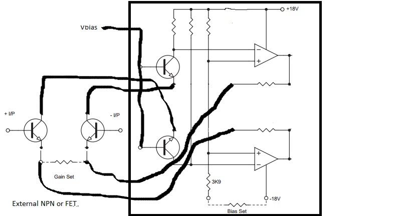

I got distracted and didn't post my circuit. The new THAT pre-amps bring out enough pins to allow substitution of the input pair with external JFET's or NPN's with a large latitude for setting bias level. The ZTX devices would probably need an offset servo. I think any cart could be optimally noise matched. Excuse the crude drawing, the input pair is pulled up to a bias voltage and becomes the cascode for the external devices seems a win-win. I have built this with other in-amps but I need to fill in the details here after I get some samples.

What collector current do you like on the ZTX devices? Over a certain amount some extra attention to preserving headroom is needed in that circuit.
I used far more collector current than necessary (7.5 mA) just to see how low a NF I could get and yes there was a resulting loss of headroom. Pro Audio Design Forum • View topic - A Low Noise Balanced In Moving Coil Preamp Using the ZTX851
The circuit thus far is a simple proof-of-concept to see what the ZTX851 are capable of. It should do quite well with a far lower Ic.
