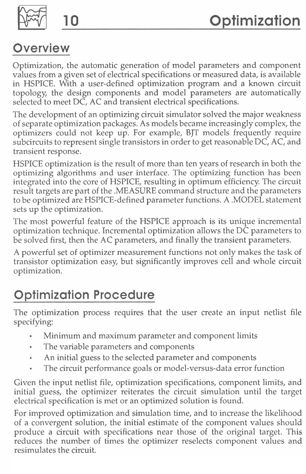

Today of course we'd just throw the whole business into a numerical optimization routine and let our multi-gigaflops laptop computer crunch out component values at nine digits of precision. Easier still, if your circuit simulator includes a built in optimization routine (as HSPICE does, see below), you can simply tell it to find the optimum component values that give the minimum error. Couldn't be easier, in today's modern world.

.. and I'm sure everyone who buys Self's new book will be conversant with Matlab, HSPICE etcToday of course we'd just throw the whole business into a numerical optimization routine and let our multi-gigaflops laptop computer crunch out component values at nine digits of precision. Easier still, if your circuit simulator includes a built in optimization routine (as HSPICE does, see below), you can simply tell it to find the optimum component values that give the minimum error. Couldn't be easier, in today's modern world.
Excel (spreadsheet program) is very inexpensive and the numerical optimization package for Excel is free. Quite a number of us diyAudio people use it to optimize SPICE model parameters, i.e., best fit between measured transistors and simulated transistors. Once you learn how to use the optimizer, you can apply it to RIAA network design. It's so 21st century.
Again Python is all free and has a particularly good optimizer module with a lot of strategies to choose from. I tried to tell Charlie L. that Excel can/will give garbage answers for ill-conditioned problems (i.e. poles outside the unit circle for IIR filters) not sure he paid attention.
Why would you buy a book on making it yourself and not be interested in expanding your horizons?
