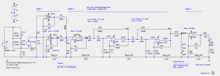

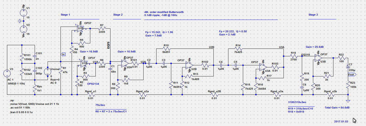

Nigel, I'm currently working on just that. Not because I believe it to be better, but I've read so much about it I decided to have a go at it.
It's a bit of a challenge to nail it - the eternal battle between noise and headroom. I've attached my design, so feel free to have a go at it.
Currently I'm in the build phase, so I cant tell you how it sounds. Only this : the first OPA *must* be a FET-input (due to bias etc.)

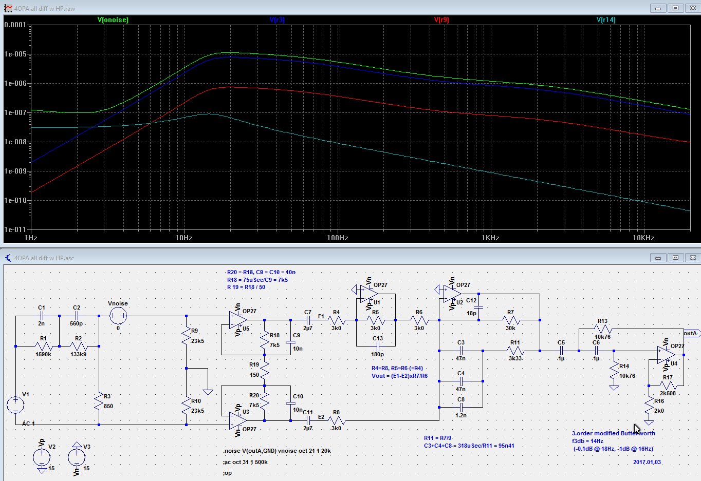

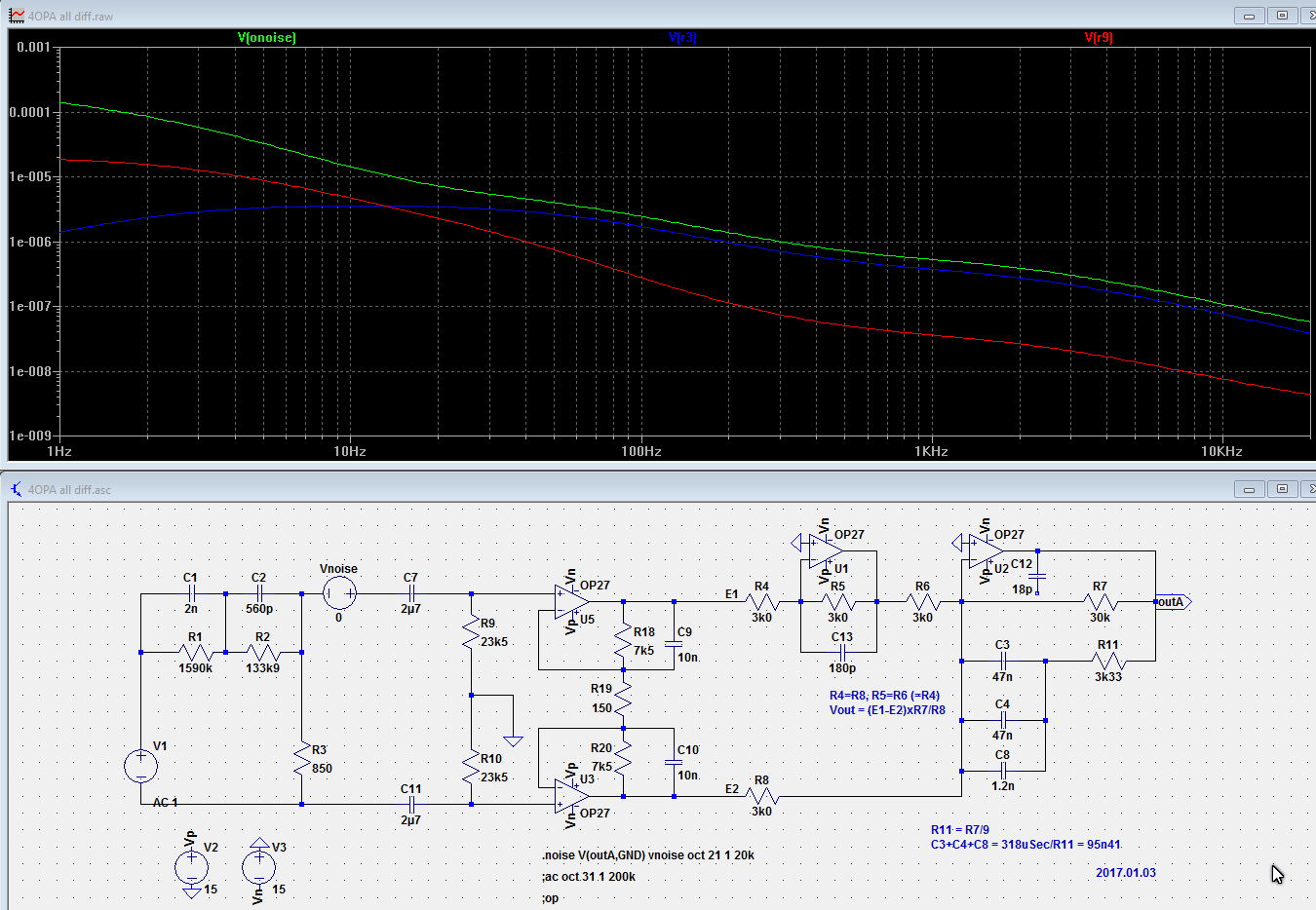

I'm currently working on a (relatively) simple amplifier with a differential and active input - see attachments.
I know You are not too convinced about the joy of differential RIAA amps, but if you take a look at the noise curves, it is quite obvious, that the "4OPA all diff" has a *much* higher noise level below 10 Hz than the "4OPA all diff w HP" mainly due to the fact, that the input resistors (R9 & R10) is in parallel with the cartridge at all times.
If the input resistor(s) is allowed to be "detached" for VLF you will have all the noise from the much larger (47k) input resistor. Further, a differential input is just a special case of parralled amplifiers, ie the noise from both input resistors and OPAs are reduced with 3dB. Another advantage of a differential input is that you can use BJT based OPAs *without* input capacitors, as long as they are matched (LM4562 ?)
I may be wrong, but I think that excessive sub-sonic noise may put a veil over the lower bass, so everything sub-sonic has to go, hence the third order filter.
The bottom line is - I guess - that differential amplifers has something to offer in terms of reducing noise while preserving a large headroom, and that I would love if you would dedicate a section to the subject.
