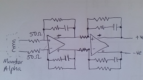

As someone said MC pick ups have high current output. A transformer of the best possible design could make available lets say 20 mV and still have a low coil resistance ( less than an MM coil I guess ). Who knows where that might go. As far as I know nobody did it that way. I have no idea if the realities of how transformers work would catch up with us. Tim de Paravacini at one time thought transformers should go down to 5Hz. I only mention it as he did.
Here is rough schematic. I gave up on opamps eons ago so didn't keep any records on this but you get the gist. All balanced of course (OPA1632). There is a zero at 50kH, I know there is a lot of controversy about this. But my first preamp was an Allen Wright FVP, and I learned a lot from his preamp cook book, so I always put this in. And anyway, it makes sense, doesn't it. Of course infinite gain is NOT applied to a cutting lathe, there must be a hf roll-off somewhere. Where should be complimented in the playback circuit.Could you post the schematic please. I'm seriously interested 🙂

These days I use discrete components. Here is description of my current m-c stage. My component values are slightly different to accommodate my SLA battery power supply, and it sounds great with Monster Genesis 1000. This cartridge is only 0.24 mV, but there is plenty of gain. I don't use this circuit with m-m catridges, I am going to build a new one for my Decca - this will feature jfet (2SK369) in the front end, but topolgy will be pretty much the same. So yes, I use a different, optimised ciorcuit for each cartridge, because I also have another pre-amp for my strain gauge.
