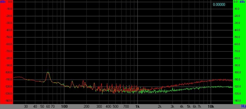

I replaced OP27 in a commercial product with 5534 and got a dB or more improvement in real life noise IIRC.
I just measured an OP270 (Ib-compensated essentially a dual OP27) and compared it to some various op amps.
The following FFTs are with the balanced input preamp in the FLAT, non-RIAA, mode to reveal the HF differences which are quite small. I compared the noise level with identical op amps to make sure the curves overlaid then mounted one op amp in the left and a different op amp in the right. The source is a Stanton 681EE, on a turntable, located a few feet from a dimmer.
Flat Balanced Input Preamp, OP270 Green, OPA1642 FET Red
Flat Balanced Input Preamp, OP270 Green, NJM2068 Red
Flat Balanced Input Preamp, OP270 Green, NJM5532 Red
Flat Balanced Input Preamp, OP270 Green, LME49720 Red
The OP270 is actually pretty respectable for a MM input. With the preamp input balanced in an instrumentation amp topology the low Ib doesn't provide any significant benefit since the "Ios" of dual op amps (between different op amps in the same package) is quite small based on experience. I left the OP270s in to listen to them.

I can't see your plots clearly - you are showing dBr (dB Relative?) - is that ref 2V FS on the sound card? Can you share how many averages you have done?
96 kHz SR, 32 kpts, avg=10, 0 dBFS approx +8dBu/2V rms.
Note that the preamp output does not have RIAA EQ applied.
1 kHz 3.54 cm/second (L or R only modulation equivalent to 5 cm/sec lateral) produces -23 dBFS. (This gives a headroom of about 4-6 dB for flat recordings.)
The A-weighted noise with RIAA EQ (not shown) is just shy of -99 dBFS with the OP270s which are what not I normally use. IIRC I measured about -95.5 dBFS with the OP270s, no weighting. (The measurement bandwidth is - I think - Fs/2 since I'm not using an external or internal filter.)
There's no magic in this circuit other than it's wired with shielded twisted pair cart connections, has balanced in/out, and common mode rejection is realized with "double-balanced" (cross-coupled) line receivers. I followed a no BS approach having given up worrying about input bias current around 2011.
