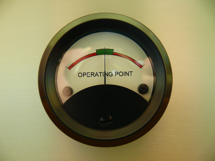

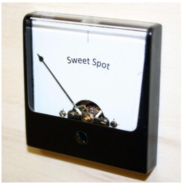

The "Z" meter 🙂
Yep ! like Papa´s SIT-1....
the "sweet spot" is all you need to know !! 😀
The "Z" meter 🙂
😱 oh, and, Michael, i almost forgot, you did it yourself. ages ago,
on page 19 of your first L’Amp-paper...

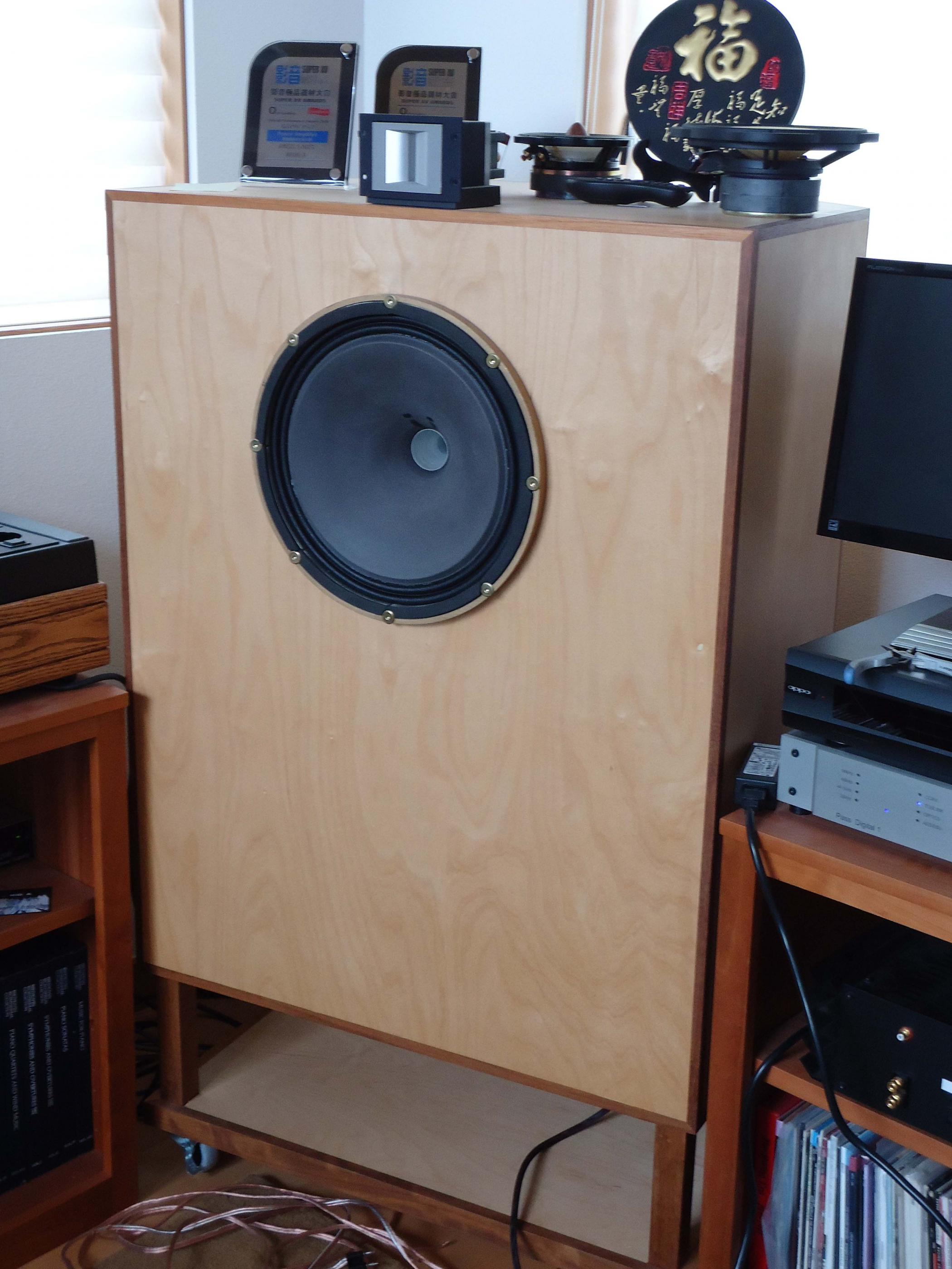

DIY version of Imperial.

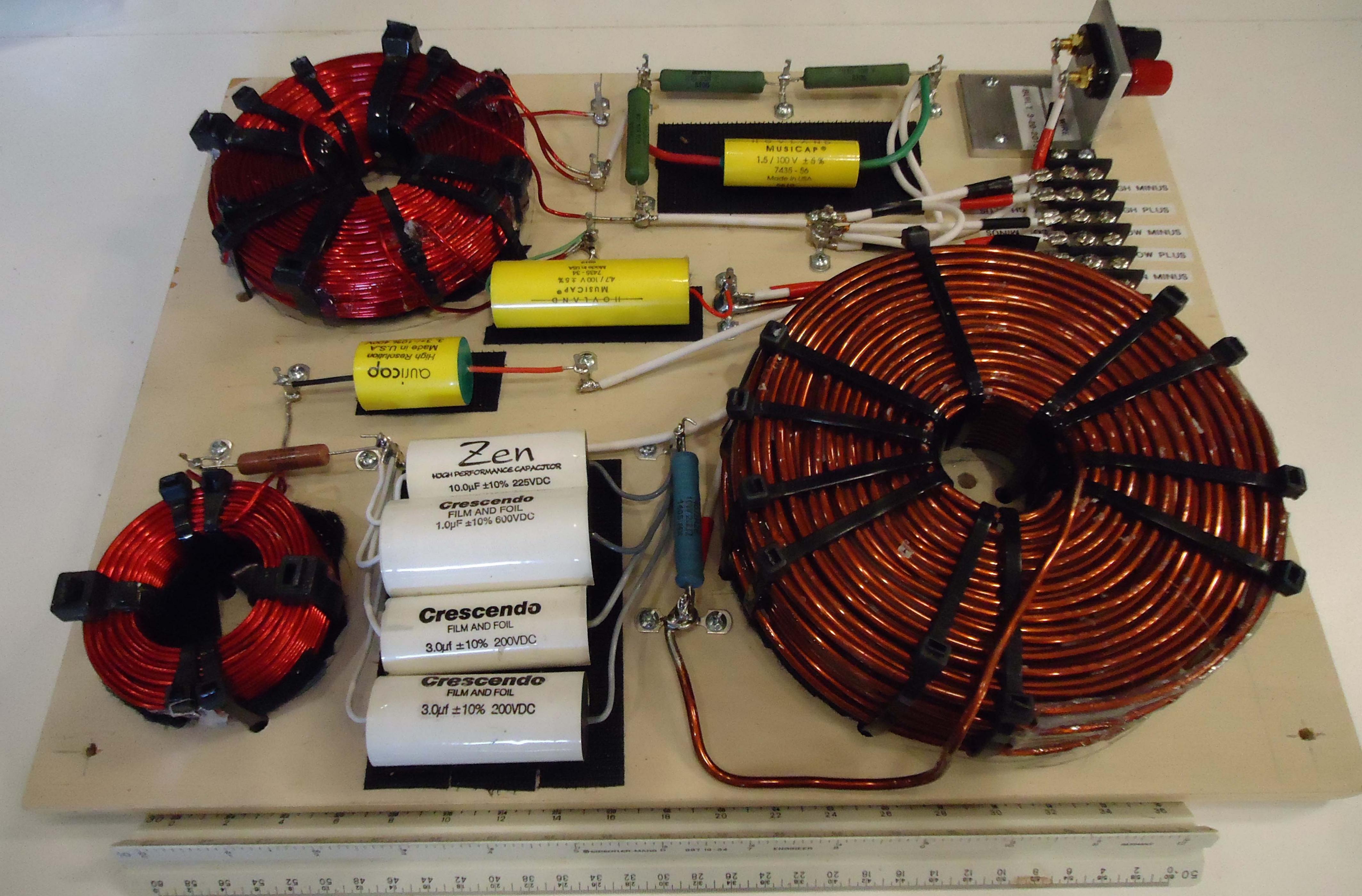

Here's a pic of mine, and a photo of the crossover network
(ruler included to show scale)

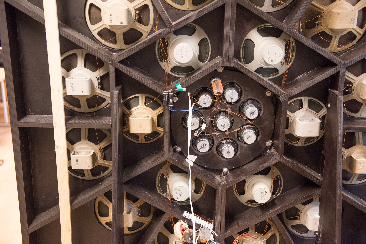

here is picture of later , proper , iteration

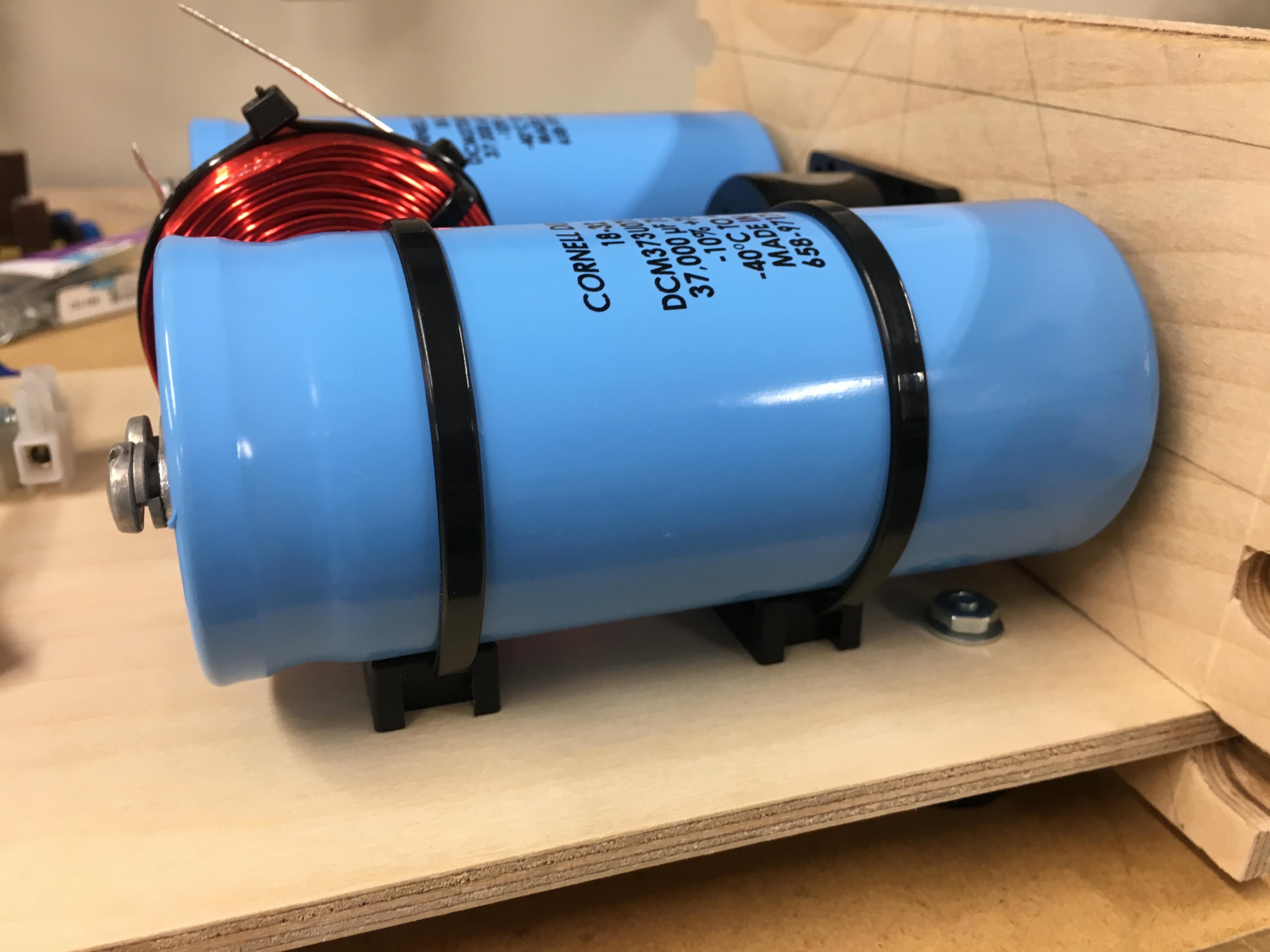

Damping crossover capacitors and the coils with material who soft tiny mechanical vibrations and his contact with wood surface

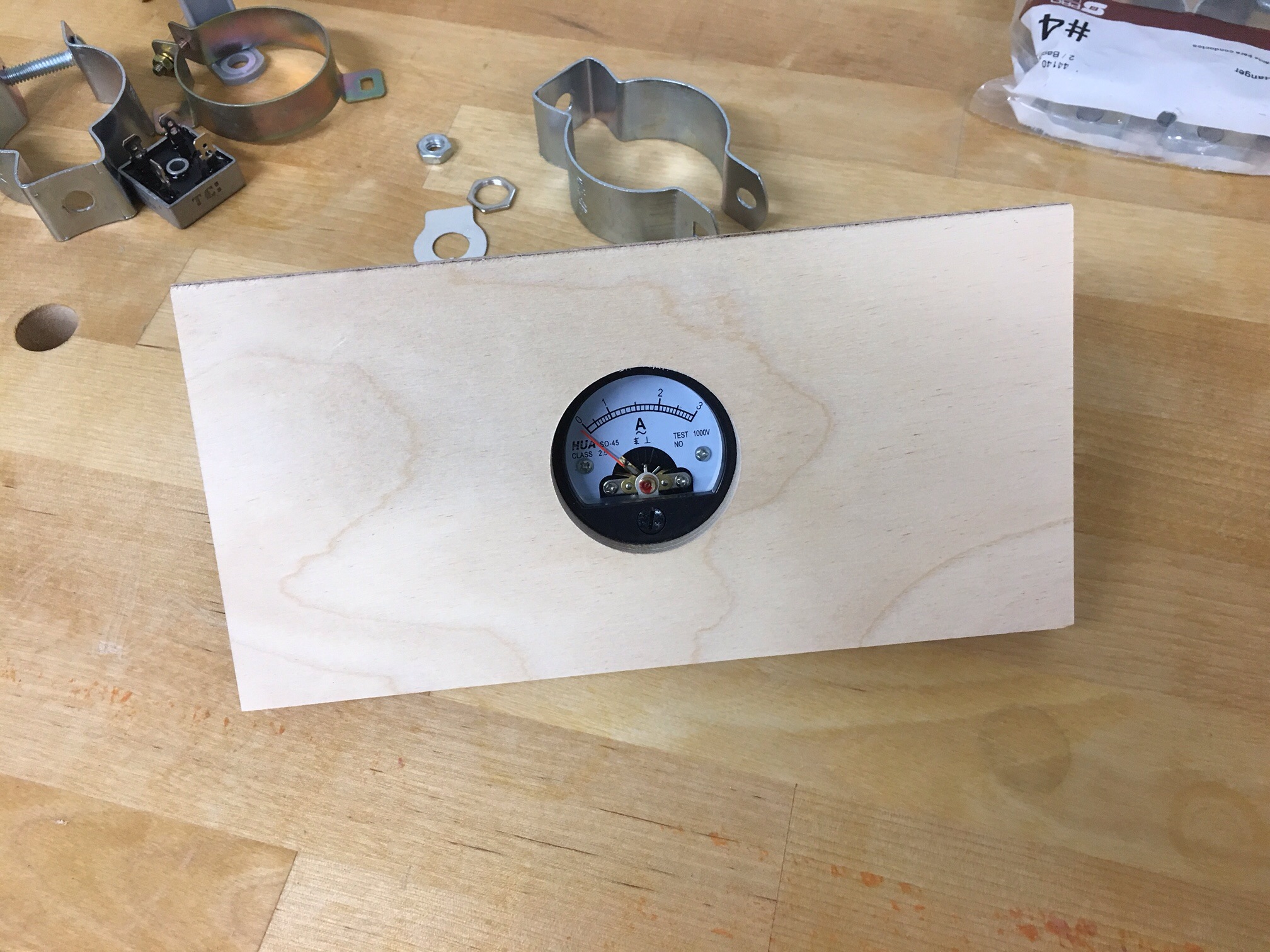

All the best amplifier designs start with the faceplate, right? 🙂
See Uncle new amp faceplate can match Papa speakers perfectly after touch of varnish haha
See Uncle new amp faceplate can match Papa speakers perfectly after touch of varnish haha![]()

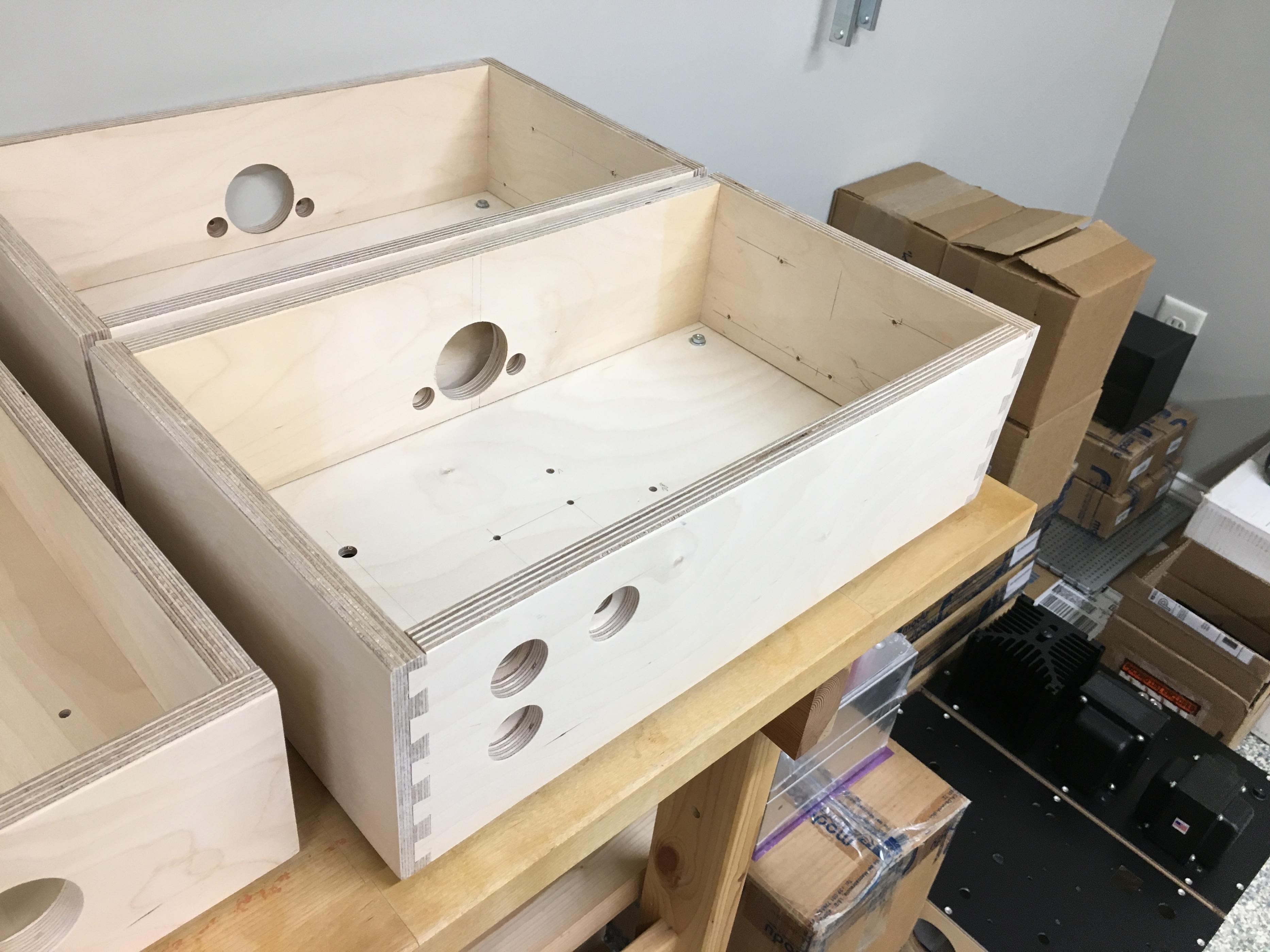

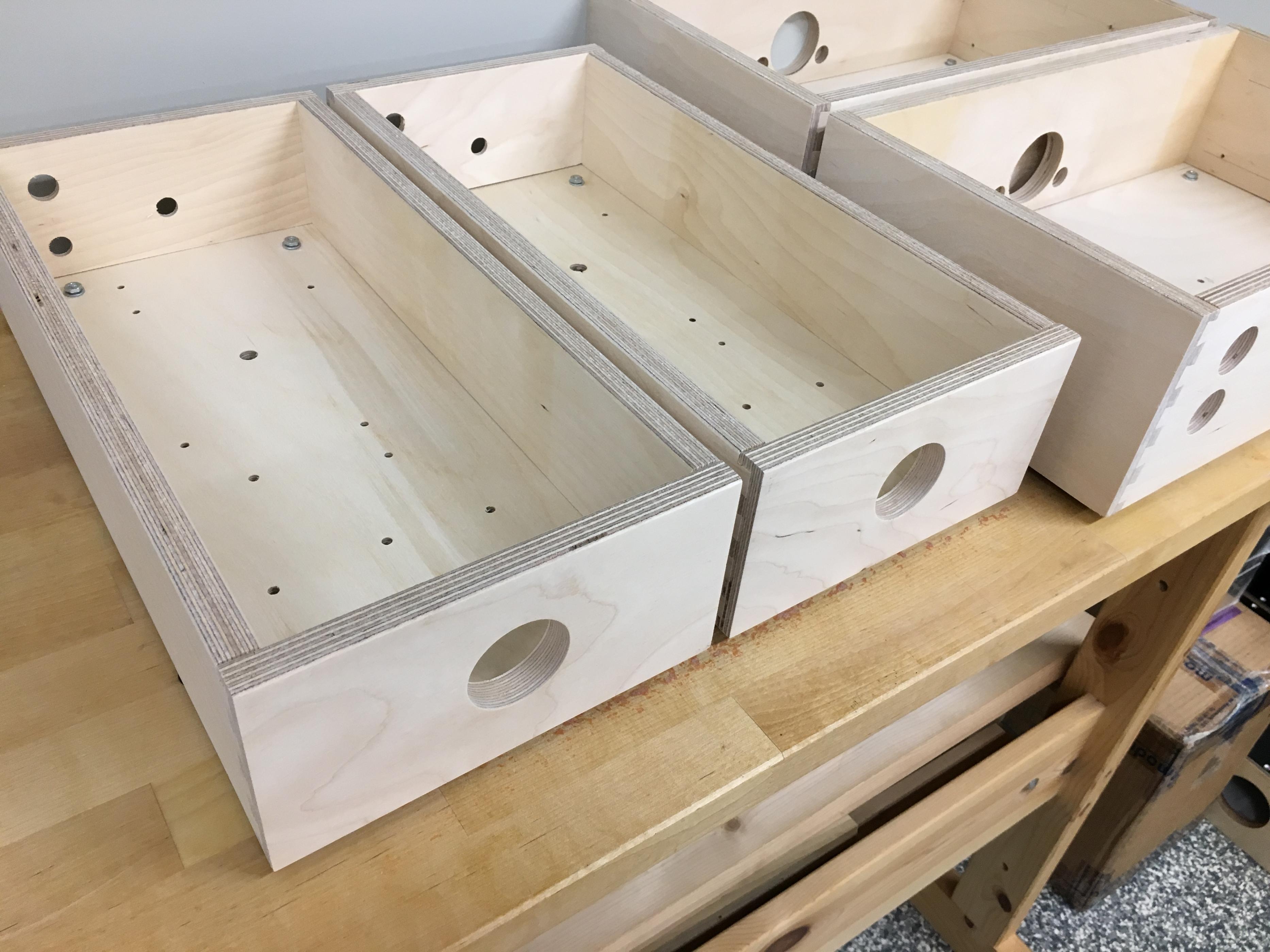

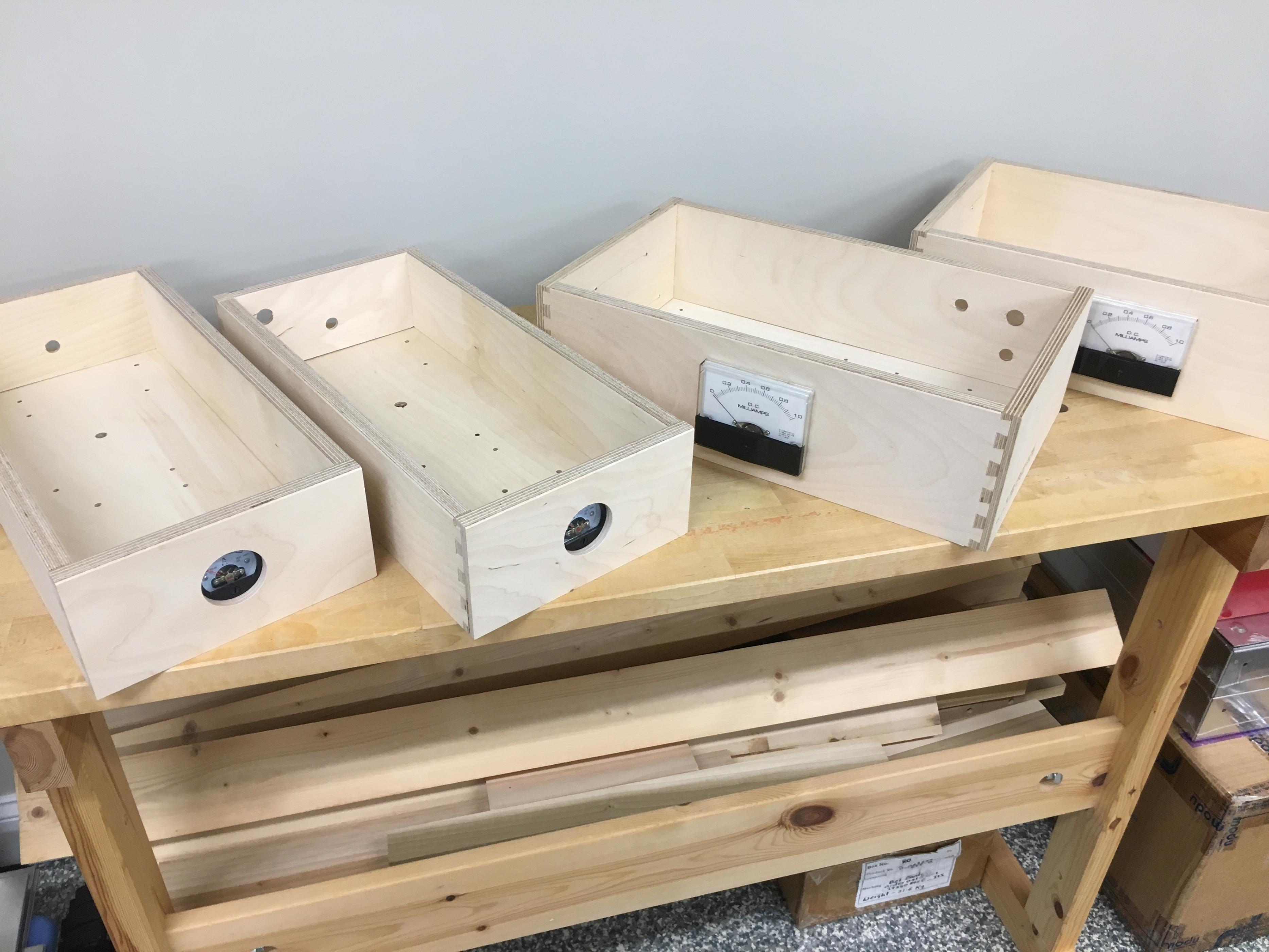

Just finishing up some woodwork today. 🙂 Poly coat tonight.
The big ones are "L'Amp Revisited".

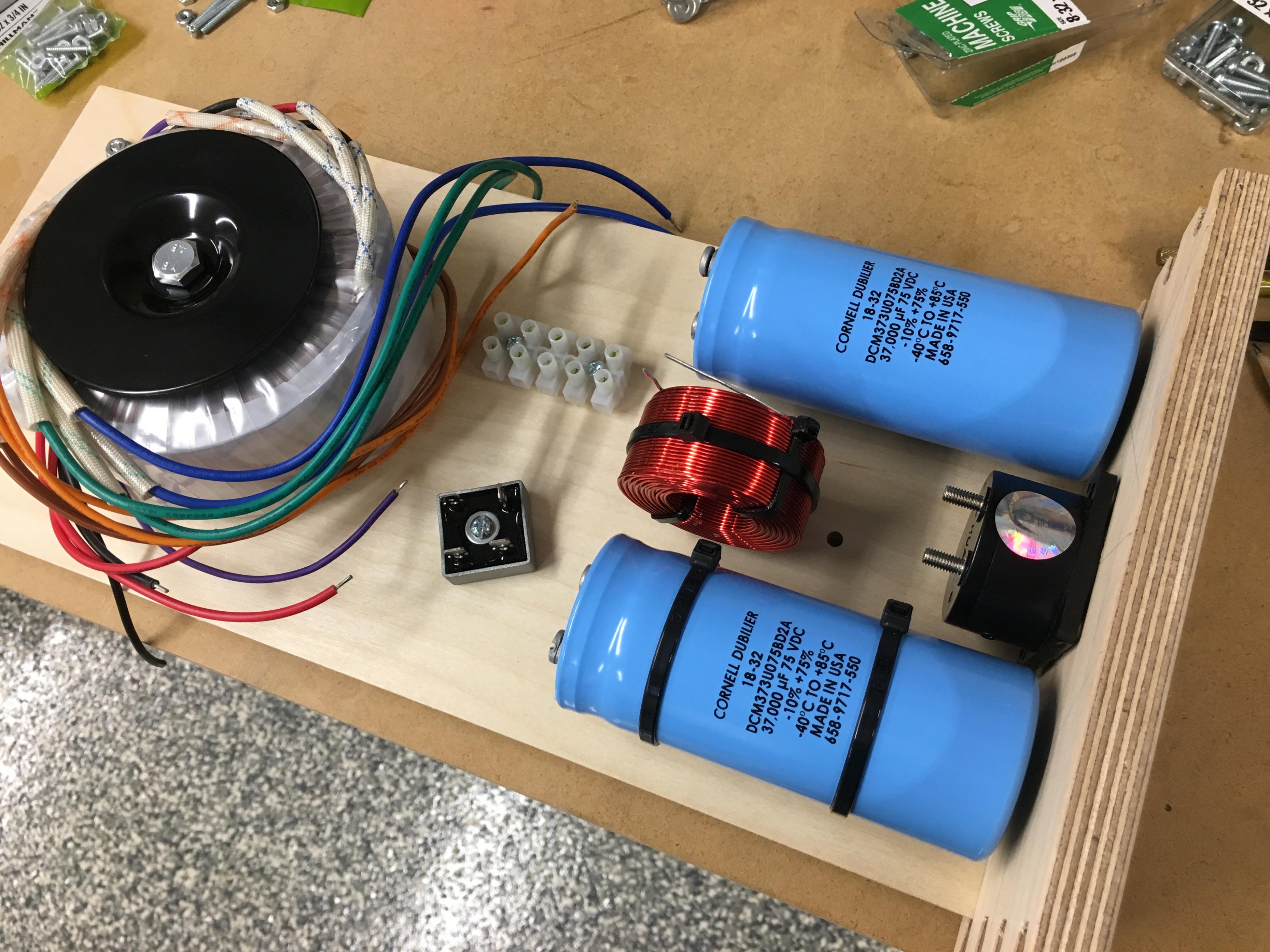

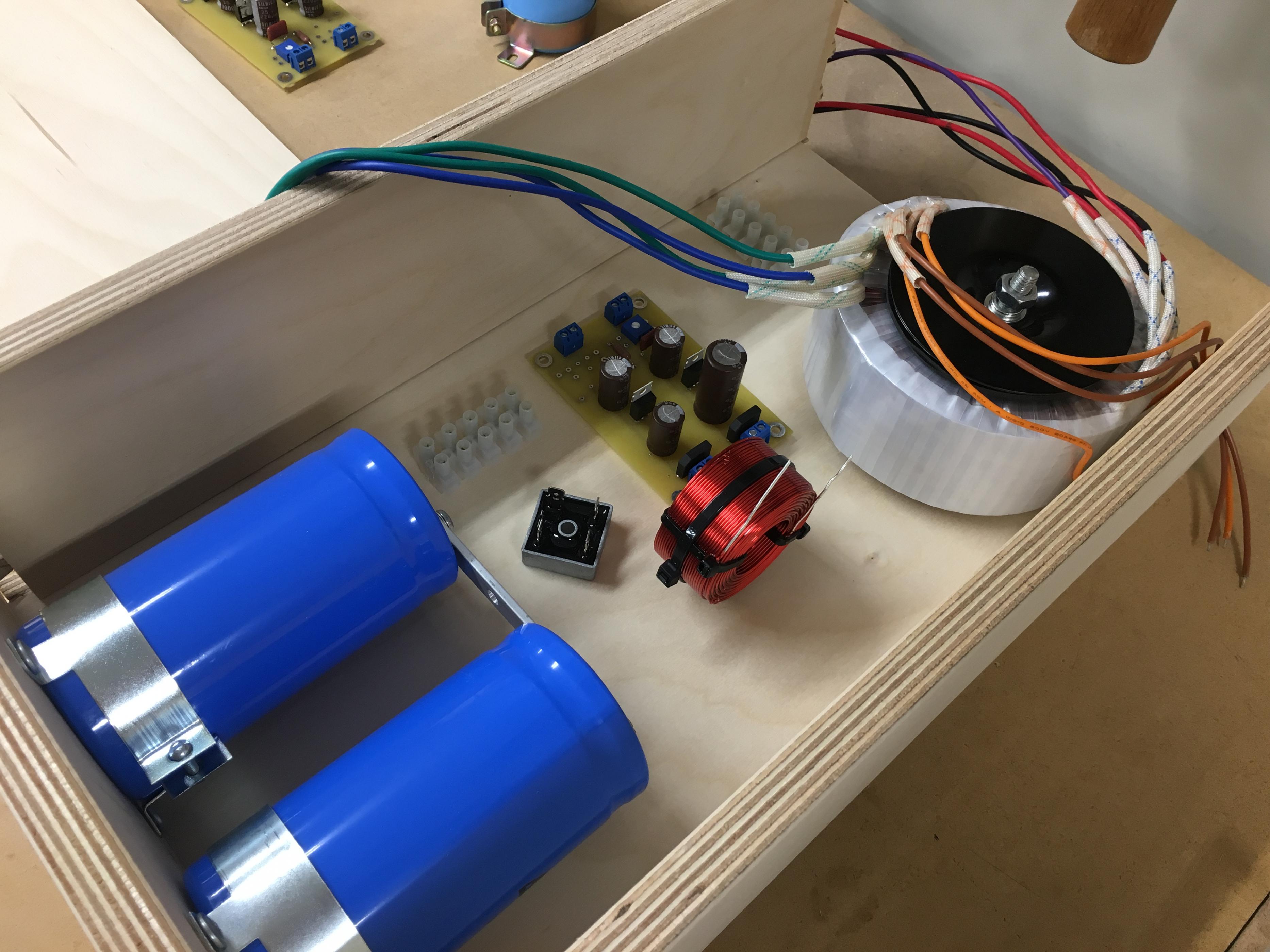

Either way is workable. The little amps use a 3A FS meter in series with the L in the CLC. Or you can sample voltage, e.g. across the R in a CRC, source resistor, etc. 🙂
