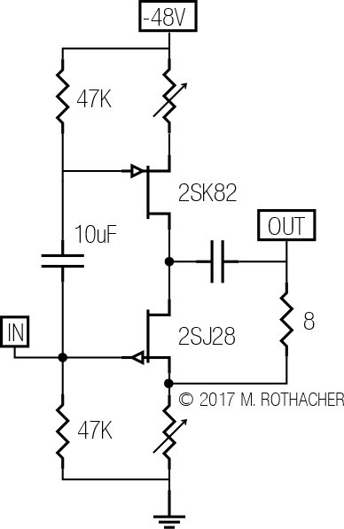

It's an iteration of #5.
The circuit is apparently a thought exercise to build an amp with no fixed resistors. It was implied that this same circuit could be used at 120V 40mA or 40-45V 1.2-1.5A. Perhaps I misunderstood. As a preamp he says:
- THD 1v eff. Output voltage: 0.07%
- THD 10v eff. Output voltage: 0.5%
- THD 20v eff. Output voltage: 1.5%
and provides these scope traces
The Hungarian thread is here:
http://www.avx.hu/forum/index.php?/topic/20255-v-fet-single-ended-amplifier/
