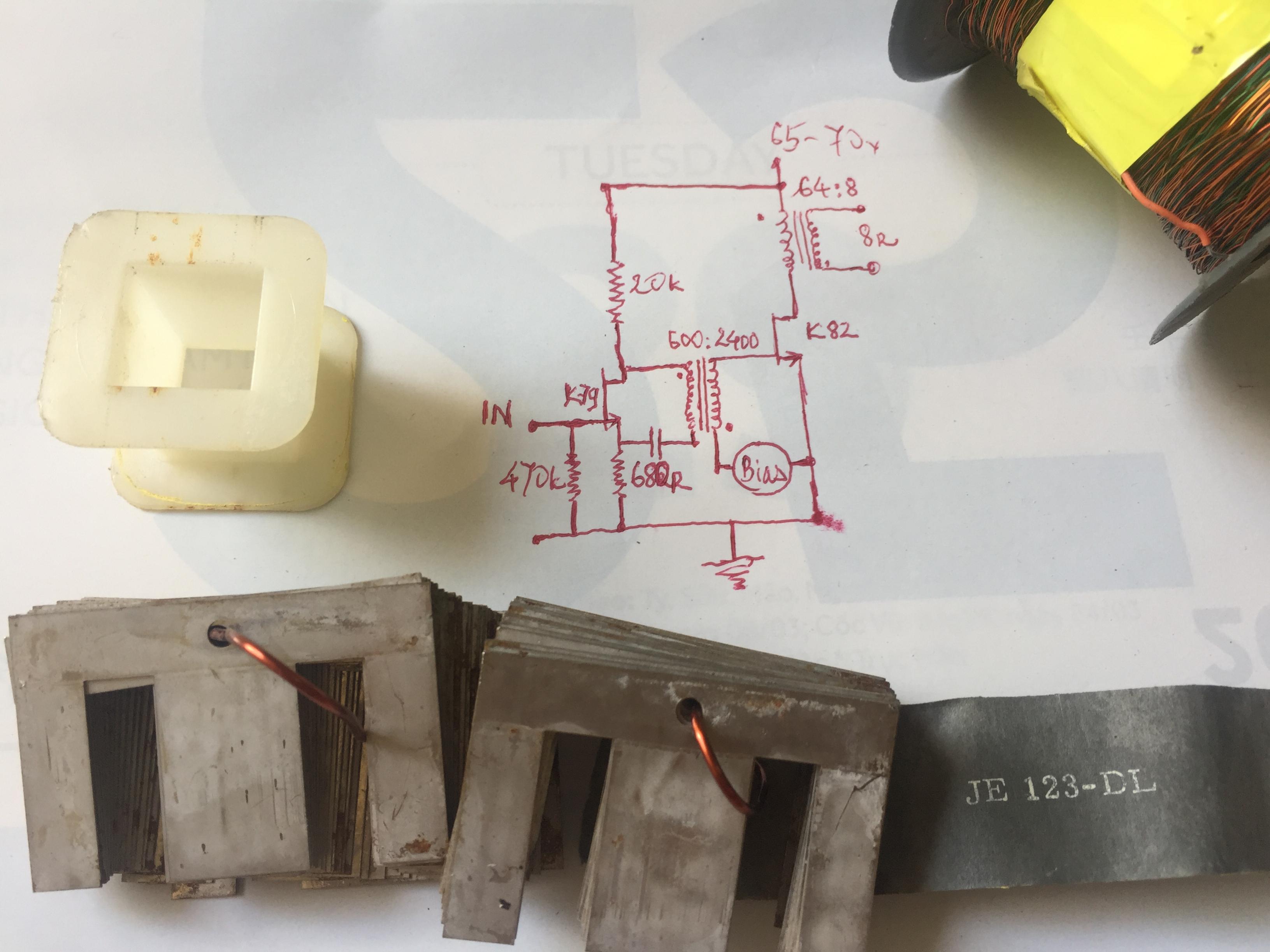

Are you saying that one of your 2SJ28's has a Vgs of 4.8V and the other has 12.5V (for what current?) Or, are you saying you have a matched pair with Vgs 4.8V (again for what current) 🙂
In this project, you want the lowest Vgs values possible, since we're using self-bias. You also want adjustable resistance, which is why I used rheostats. 4.8V won't leave much across your SITs, so you'll be wanting to use higher supply voltages.
I have about 50 x 2sj28, they all tested in Mr.Pass'maching circuit by Nagini. B+ = 15v, Id= 0.5A and Vgs were noted and selected pairs and quads. They have Vgs ranges from 4.8 to 12.5V.
Maybe I have to wait for you and study much more about Vfet and circlotron if I want to play Vfet with self-bias, and I hope someone will help newbies the method of calculation self-bias for Vfet too.
eg: If I saw "The SoundHapy" circiut before I would never destroyed JE-123 DL in order to rewind and try the same :headbash:

you got pretty much everything - just choose CCS flavor you like
for starters even resistor will do
and , btw. - I can't see any resemblance to Aleph J
By resemblance to Aleph J i mean not completly,
only because is single-ended power output stage with his active CCS.
Details of the two are different's for sure.
Don't know what transformer is and N channel Vfet , resistors, caps values, CCS semi etc.
Mighty ZM are experienced not piece of cake for me...
Edcors or Jensen's are available & resonable priced
