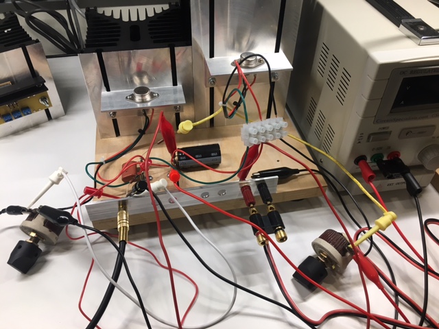

That diode will drop about a volt(ish) at 1.5-2A.
If you want to move forward on your own, here's what you could do: build the circuit with 22-25 volt supplies, your lowest Vgs pair, using 4-5 25W ohm rheostats and start by balancing the current loops at 1.5A and low DC offset. I wouldn't bring the diodes into play until you've tried that. If you find you can't get the current below 2A, then you can pursue the diodes.
Don't forget to have fun 🙂

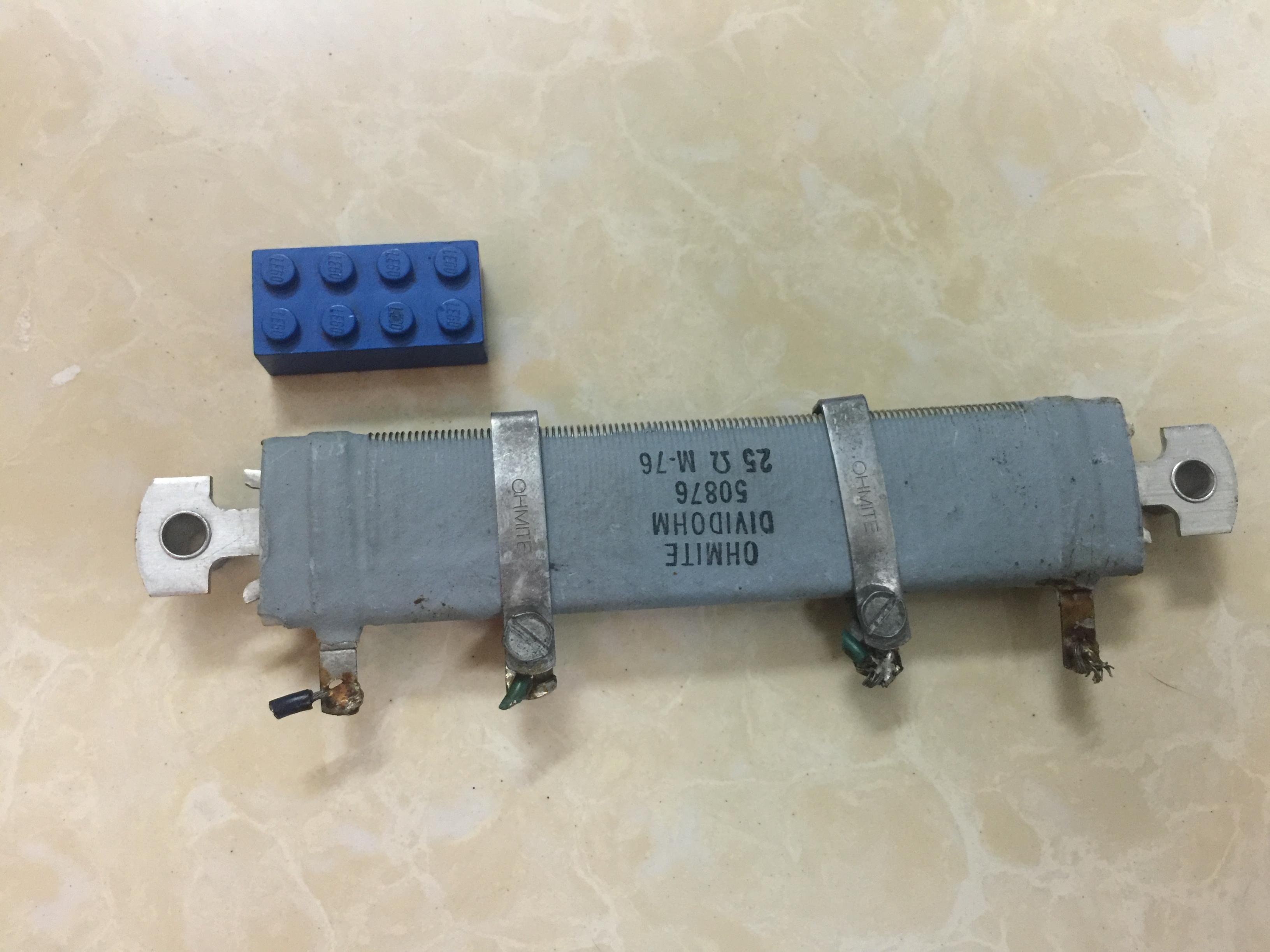

Thank you, Mr. MR! It is kind of you to answers all my silly questions 😱
One more question:
Now I don't have low value wirewound potentionmeter Rheostat, but I find some 25ohm wirewound variable Rheostat which could be easy divided into two parallel 12.5ohm rheostat by cut resitance wire(about 50W). Could we use them to adjust bias and DC offset in schm(6)?
If not, I find 4-5 25W ohm rheostats.

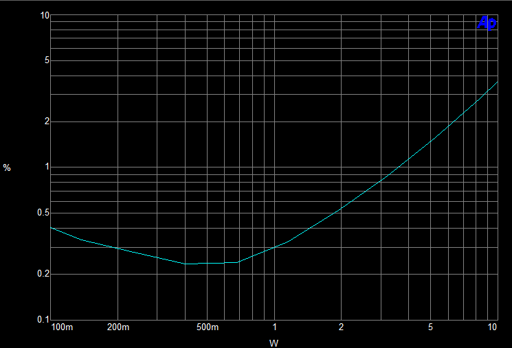

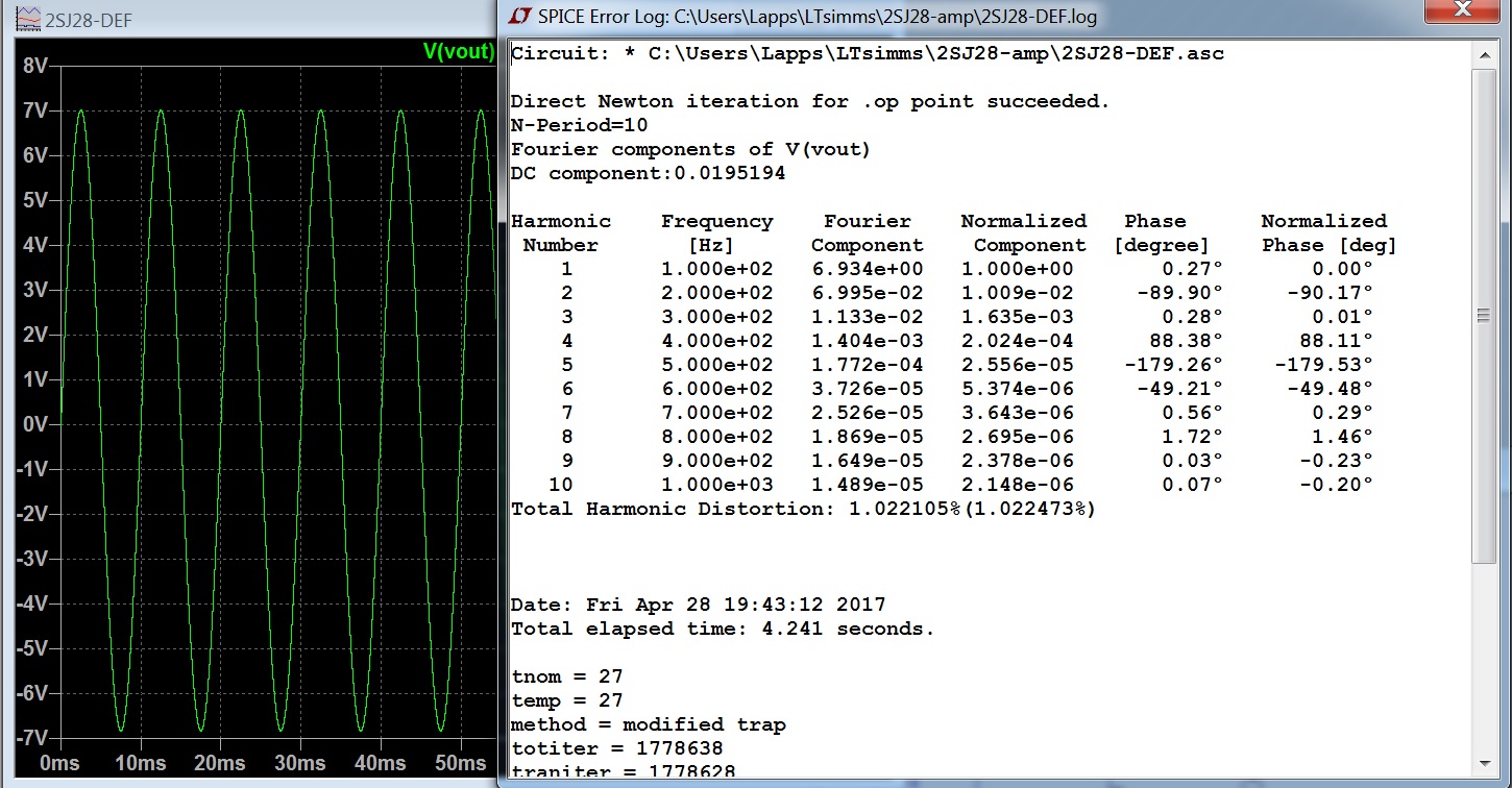

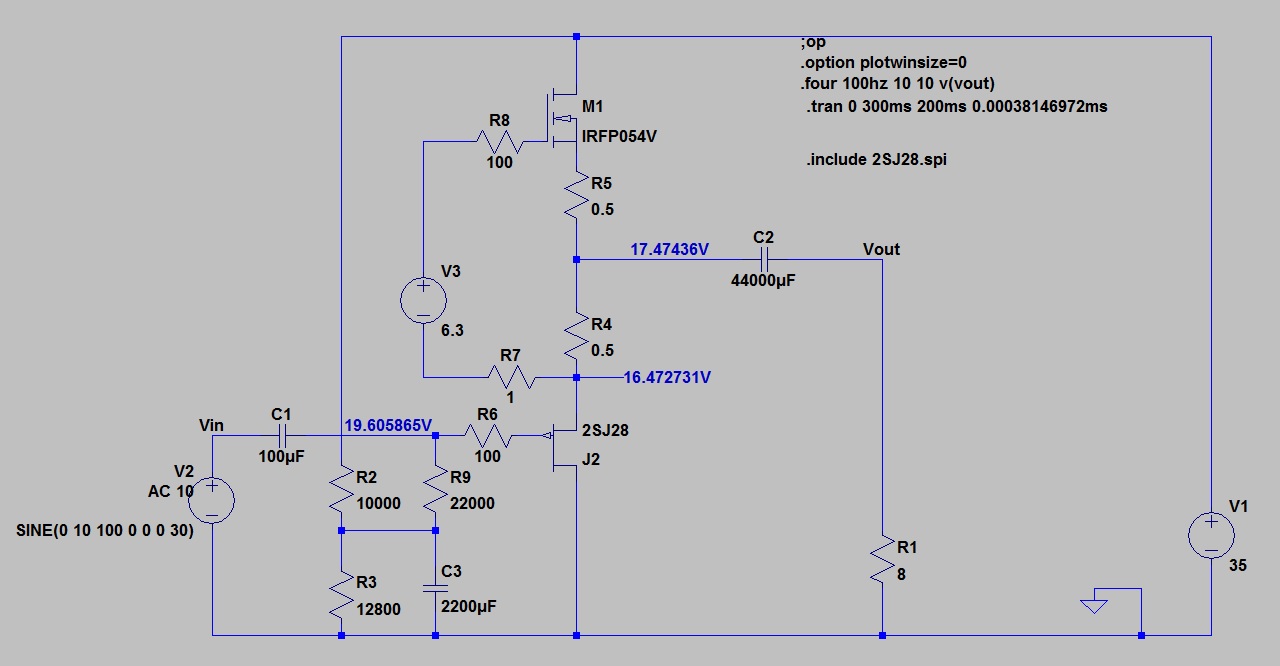

A simple test with a battery biased SRPP dynamic current source and a 2SJ28 as a source-follower.
10+10 volt P-P input gives 7+7 volt P-P output. The 2SJ28 does not have a lot of transconductance. I am used to the IRFP7430 and IXTH140P05T so the 2SJ28 seems very weak and "soft".

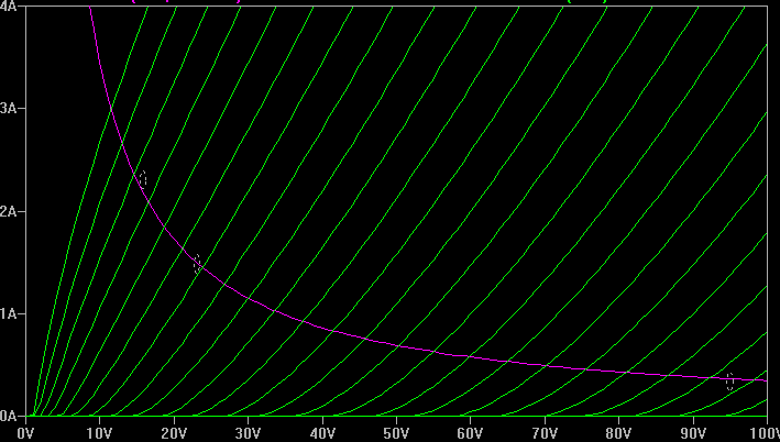

Something worth contemplating when you design with SITs:
The transconductance is a function of current and voltage, so that
it increases both with current Ids and voltage Vds. This is true
of all gain devices, but in SITs (and Triodes) the variation due to
voltage is much greater. We would say that they have a lower Drain
(or Plate) impedance.
In amplifying we see that the voltage Vds decreases as current Ids
increases and vice versa, so there is the opportunity for some
cancellation, giving a more constant transconductance figure, lowering
distortion.
At the "sweet spot" they cancel 2nd harmonic, giving the lowest
distortion numbers. Off the sweet spot, there is a 2nd harmonic,
variable in amplitude and phase.
There is a curve of such "spots" depending on the load, and what we
see is that the idle dissipation of an SIT in or near the sweet spot tends
to remain the same.
As a single-ended Class A example, the SIT-1 transistor does this
around 25 watts. Into an 8 ohm load minimal distortion occurs
around 15 volts and 1.7 amps. The output for this is around 25 watts
peak, and the dissipation is about 25 watts.
For a 16 ohm load, the voltage goes up to 21 V and the current down
to 1.2 A. Same dissipation and peak output.
A similar proportional relationship applies to push-pull operation, as well
as bias through mu followers. I leave you to figure the numbers out for
these cases (hint: they alter the apparent load).
Once you figure out what this number is, you can estimate the probable
ratio between supply voltage and bias current for a given SIT topology,
and if you work with these it may save you some time and effort.
