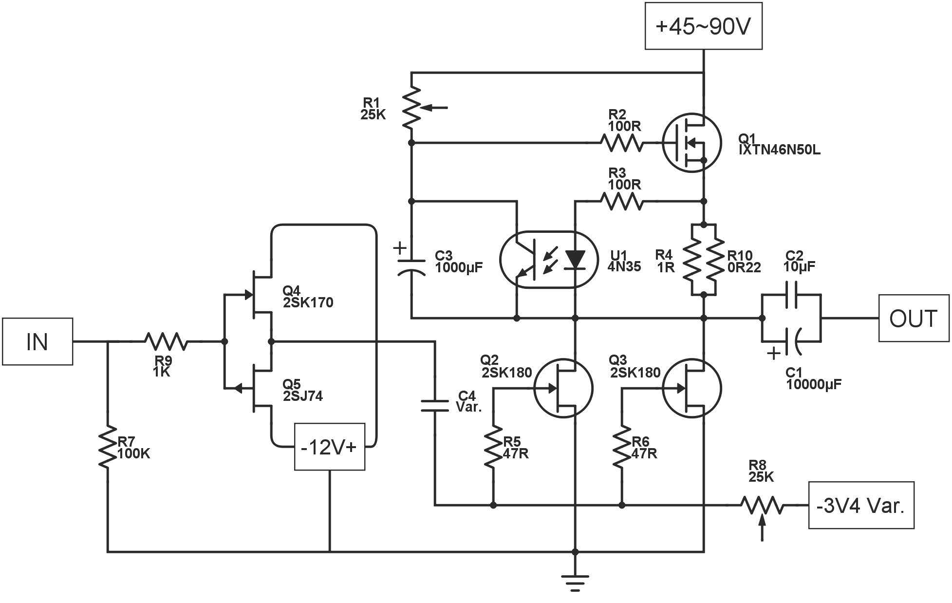

I keep looking at the attached and I am hoping (expecting) for someone to educate me on the inevitable flaws in this cunning plan... apart from 600W of heating and (with luck), some good vibrations.
The Aleph CCS addition does make the CCS device `see' both sides of the amp, and to this end perhaps I could put the sensing resistor in the drain path of the gain device and shield it from the contribution of the other side with the cap in schematic (I tried this and couldn't seem to make it work). It would allow independence and better matching perhaps
Does cancellation via complementary pair or `balanced single ended' or circlotron pairing start to kill the `character' of a SIT and if so should we focus on a single device single ended toy?
As an aside how much influence does the choice of the device for the CCS make on the sound of the output? It seems a bit extravagant to run two 2sk180s in a single ended stage (one as the gain device and the other as the CCS). On the other hand, I'd guess as soon as you start using the mu or Aleph CCS then the 'CCS device' starts to play an increasing role

JAMA on this forum has already built the amp you are asking about: using the IXTN46N50L (a linear part, not a switch) as the CCS and driving 2x K180Ds. He even measured its H2/H3 performance and it's a deadringer for a 45 triode amp he built earlier. In other words, he has built a parallel 2SK180 SE amp that delivers 50W Class A into 4 Ohm!
Attached please find the approximate schematic and his own descriptions are here: http://www.diyaudio.com/forums/pass-labs/280950-baf-2015-coverage-87.html. Great work as usual, JAMA!
Hi Ci11,
I was aware of JAMA success with this circuit, but I wasn't aware that he had tried multiple different CCS devices and found it made no difference to the sound.
I do not know JAMA had tried diffeent devices for CCS including the K180, but he did deviate from the original BAF2015 circuit which uses the IXFN140N20P in both CCS and output. The linearity of the IXTN46N50L made it far easier to achieve a stable bias.
As to the sound, his schedule for the second channel build is later this year so he probably has not heard it on speakers yet - but his FFTs showing the amp's harmonic balance and that very lovely 10kHz square wave response are very interesting: what I glean from those measurements is a quiet, powerful SS amp with lightning fast reflexes and the harmonic character of a tube amp.
