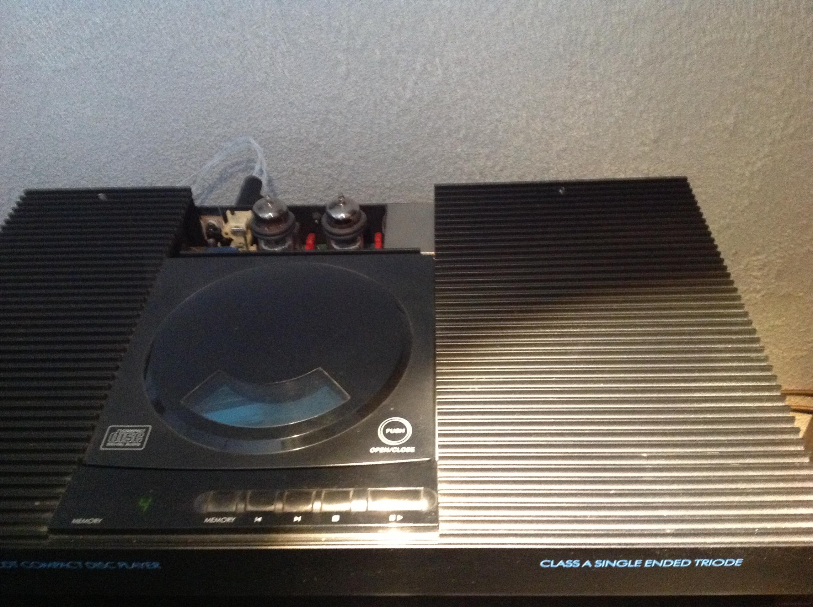

(sitting on 3 pairs of 2sk180 and wondering about SIT-3 versus a BBA3/SE CD topology)

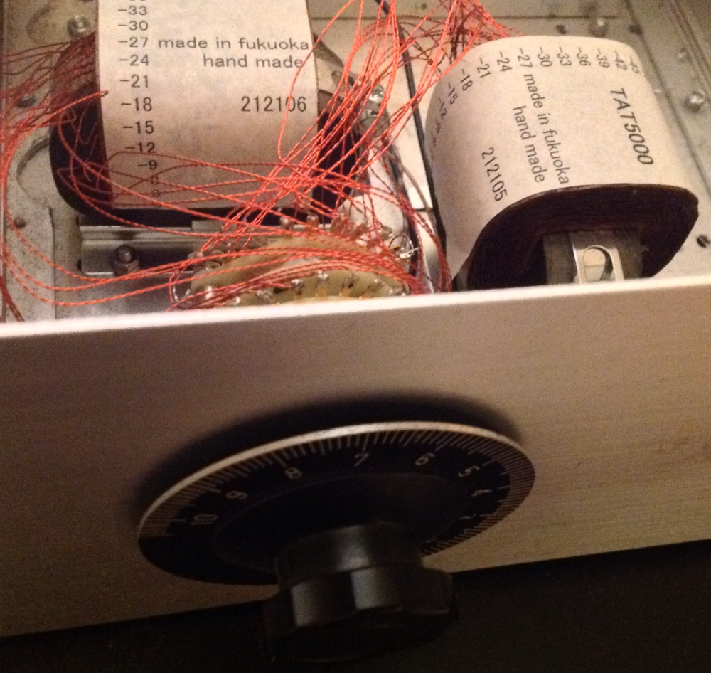

I get buffer with passive autoformer voltage gain stage now.
All my gratitude to Mr. Pass who give M2 schematic for greedy DiY boyz.
It's work and sound phenomenal. What we see SIT-3 have flat distortion versus frequency response.
Well with Edcor M2 i have enjoyable music reproduction and fantastic high resolution on 12'' full ranges without crossovers.
Non more active line stage in my audio chain.
Total silence noise floor.
Is only class A cd player + autoformer volume control + M2 + FR alnico drivers.
In near future after BAF i hope try diy version of SIT-3 with Papa blessing and crazy Uncle Mike new vfet amplifiers.
My kindest regards 🙂

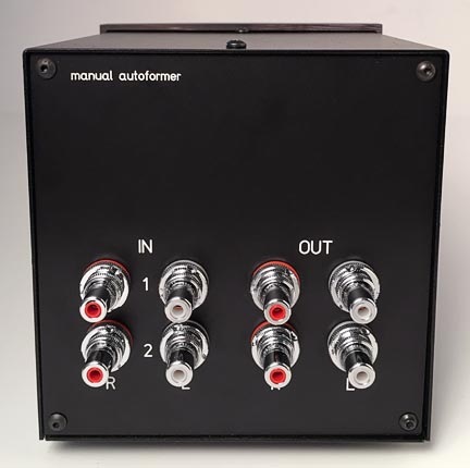

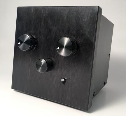

Emia brand autoformers " Manual "model is affordable if you interested :
MyEmia
+ Hockey puck more gain sit 2SK180 L'Amp version and Onken horns
yummmy delicious :lickface: music :note:

thanks for the autoformer , nice box ! as for the price we have not the same "affordable" definition 😀

Autoformer with jfet buffer is a keeper 10 year is ~ 140 $ a year.
You save money on your electricity bill without active pre amp.

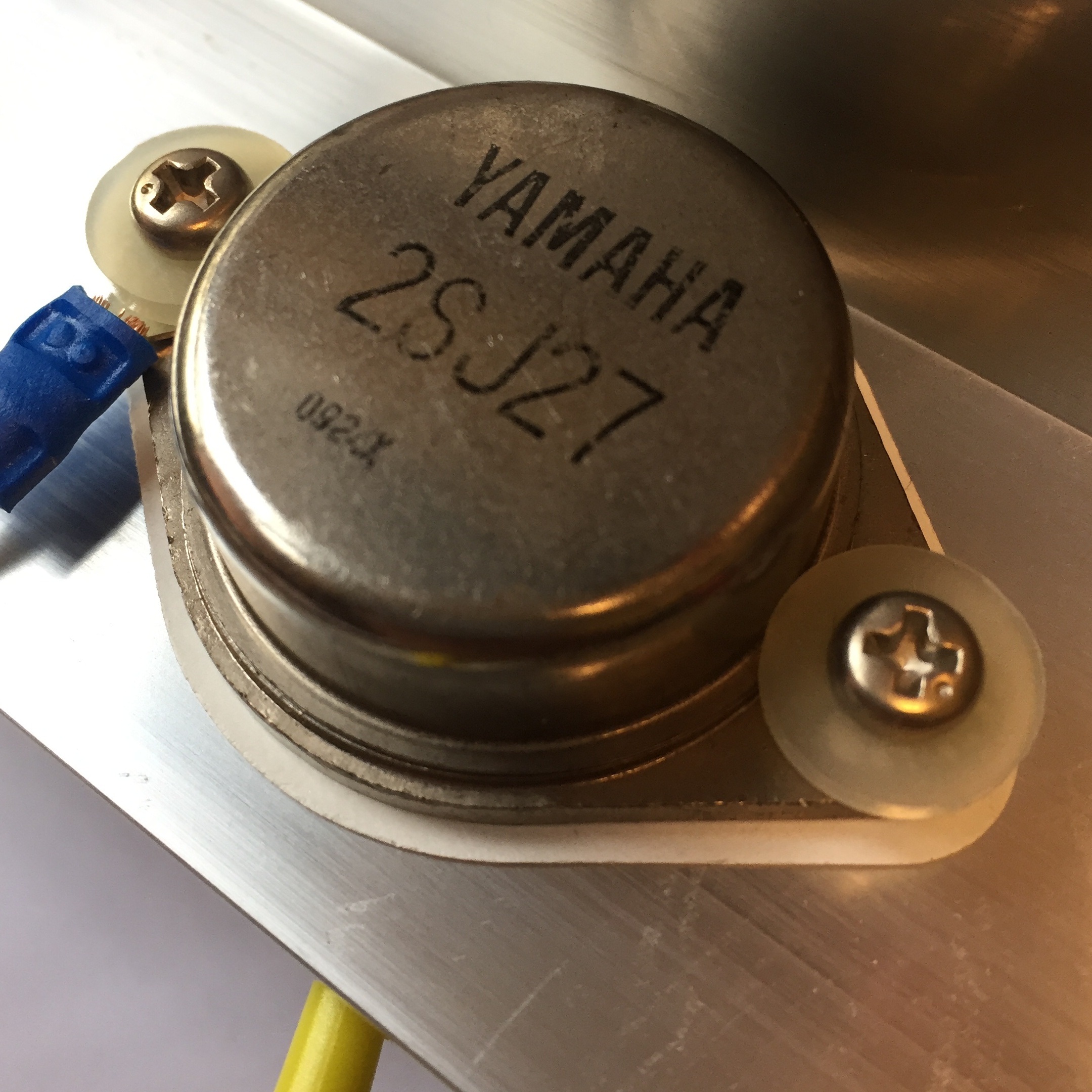

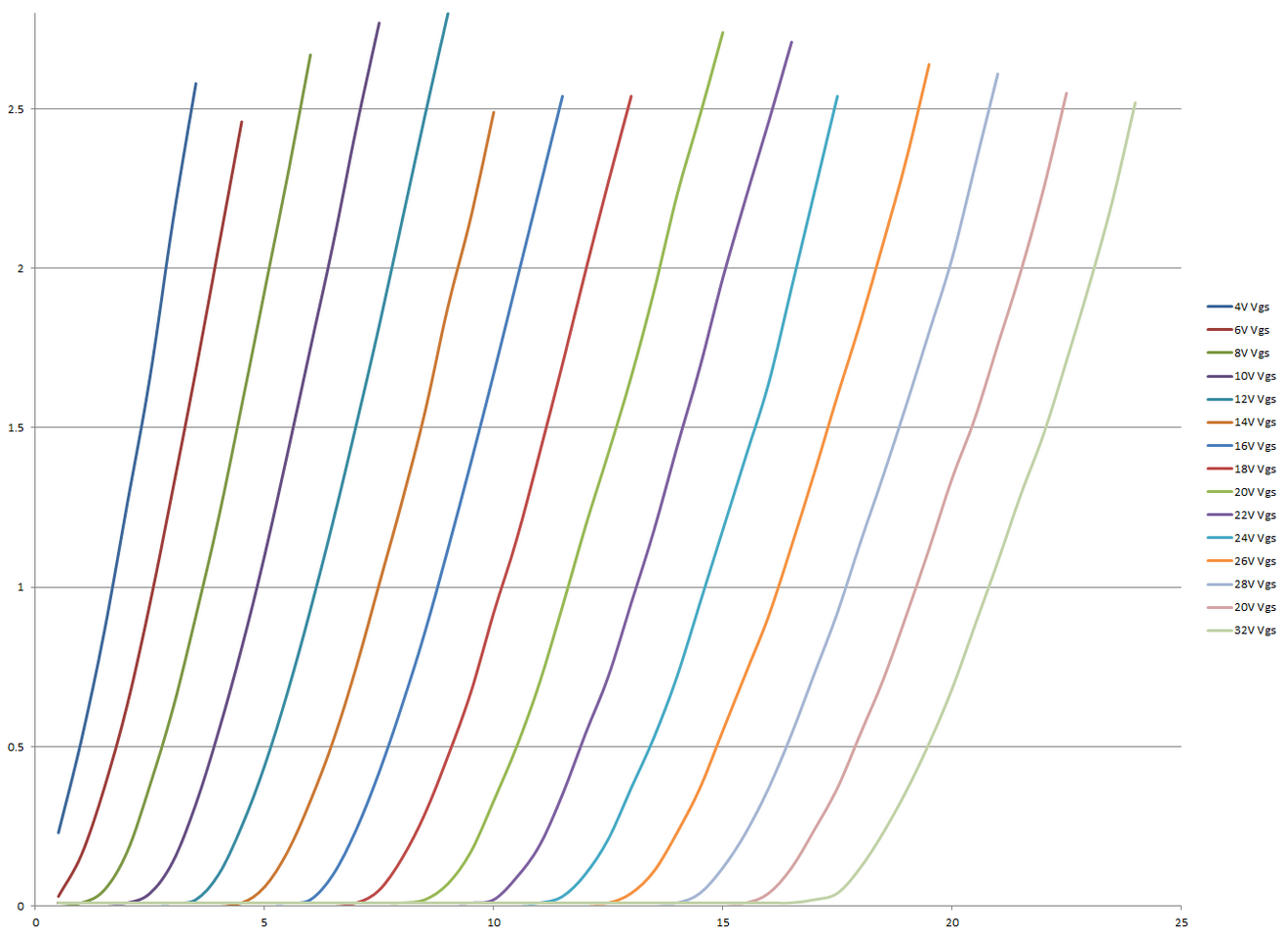

Does anyone have the datasheet for 2SJ27?

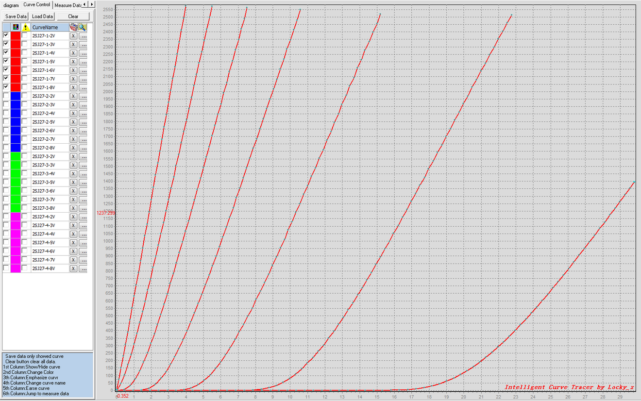

I got six pieces of these rare trannies from China recently, to check if they're real, I measured their Id vs Vds curves (manually, my curve tracer was dead since some time), one sample attached (Vertical axis in A, and horizontal axis in V) and it seems like they're indeed P-SITs with triode curves.
However, these curves look rather different than another 4 pieces of 2SJ27 I got from a trusted forum member before. So, I want to compare them against the datasheet, but Google didn't help me finding it so far.
