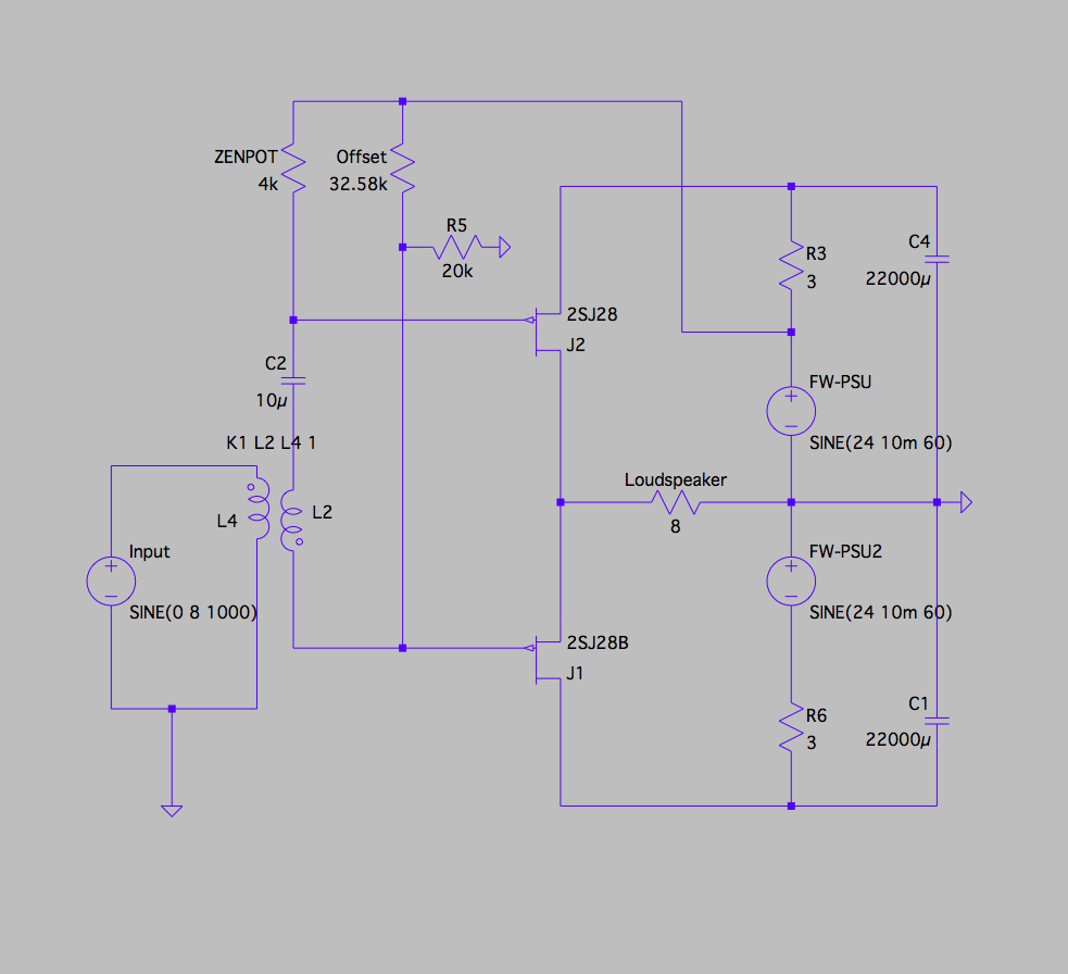

I've spent some time simulating this one with 2sj28 in spice and it looks interesting. I thought I may try it with parts I have around. The transformers I have however are the F6 ones and their data-sheet says no DC at the primaries so not the best choice I guess. Anybody can confirm this? Thanks

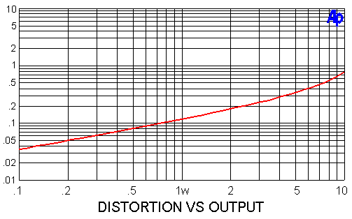

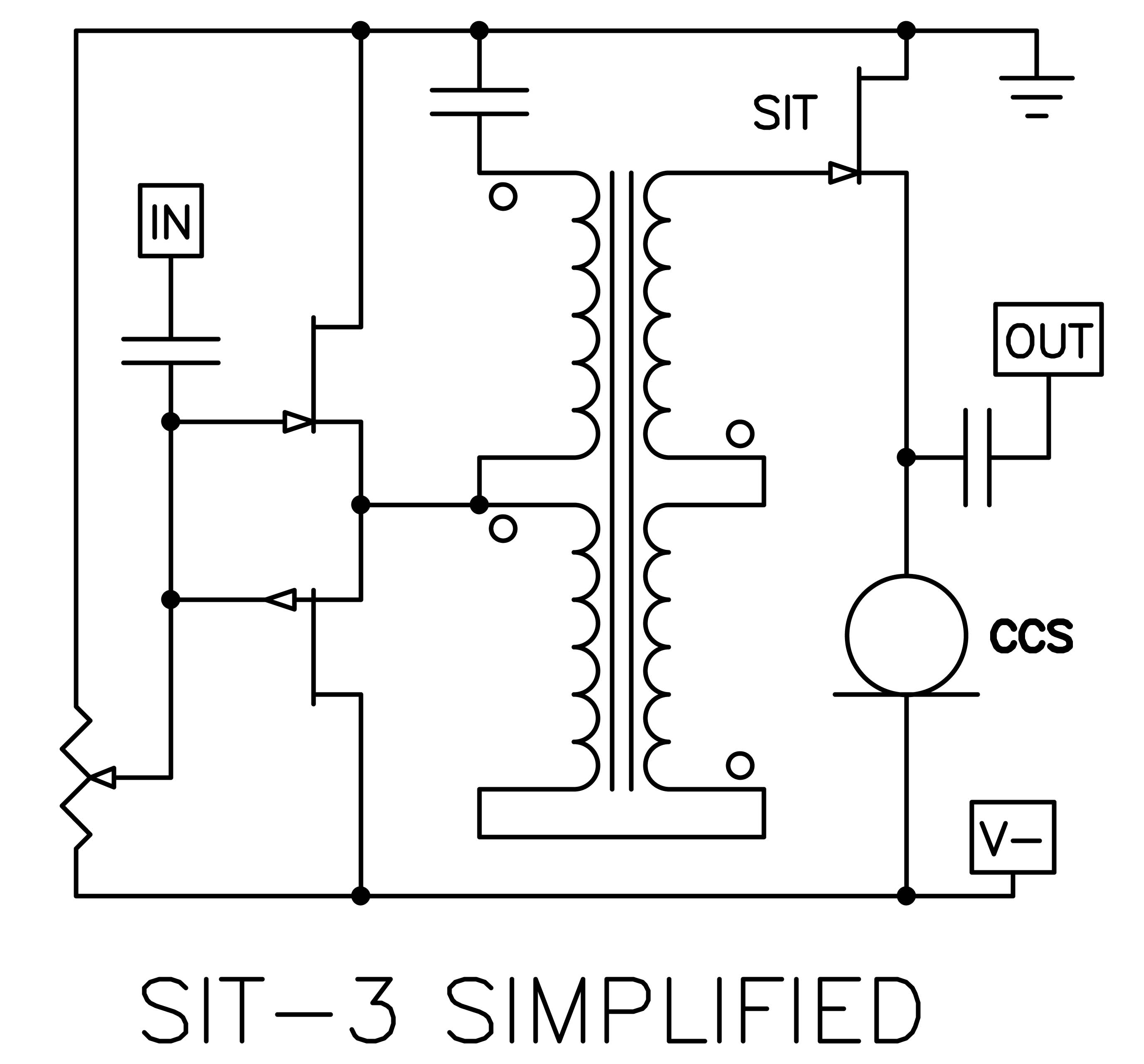

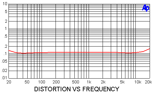

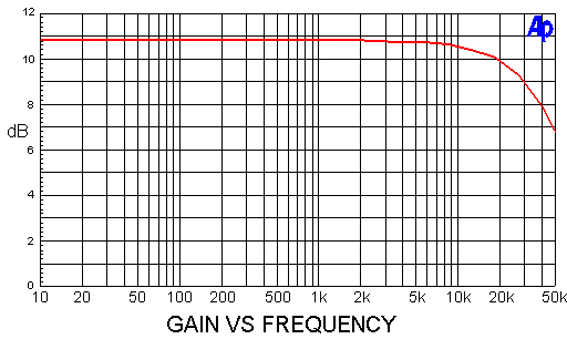

The simplified schematic of post #96 is now the SIT-3, and I have the pilot
production run near completion. Below is that image and also three
graphics of measurements on it.
Nice thing about this particular circuit is that accommodates all the remaining
SIT devices including the Sony parts, and you just reverse the polarities for
P vs N channel SITs.

Looking at the SIT-3...
If one wanted a balanced input, would connecting the two outputs of the BBA-3 balanced preamp to
i) the junction of the capacitor/transformer and
ii) the junction of the outputs of the input pair and the transformer?
Is this a reasonable solution?
thanks
thanks
One would drive one of the coils isolated, leaving the others in series to
give slightly less than 10 dB gain.
The input coil can be driven single-ended or balanced.
Keep in mind that you want the source impedance low or you will see
more distortion. This one has about 20 ohms source impedance.
