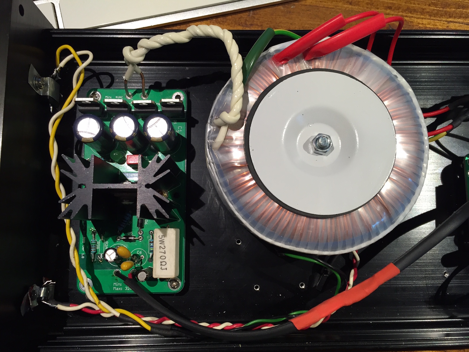

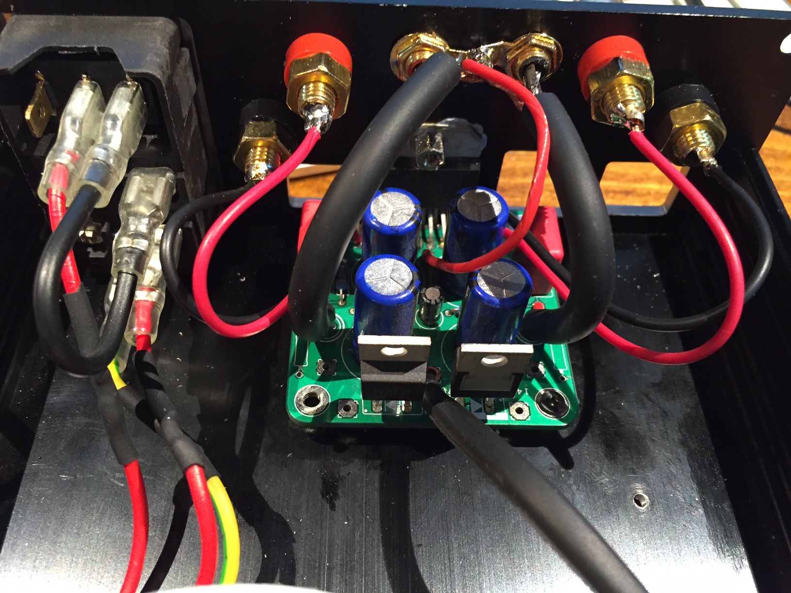

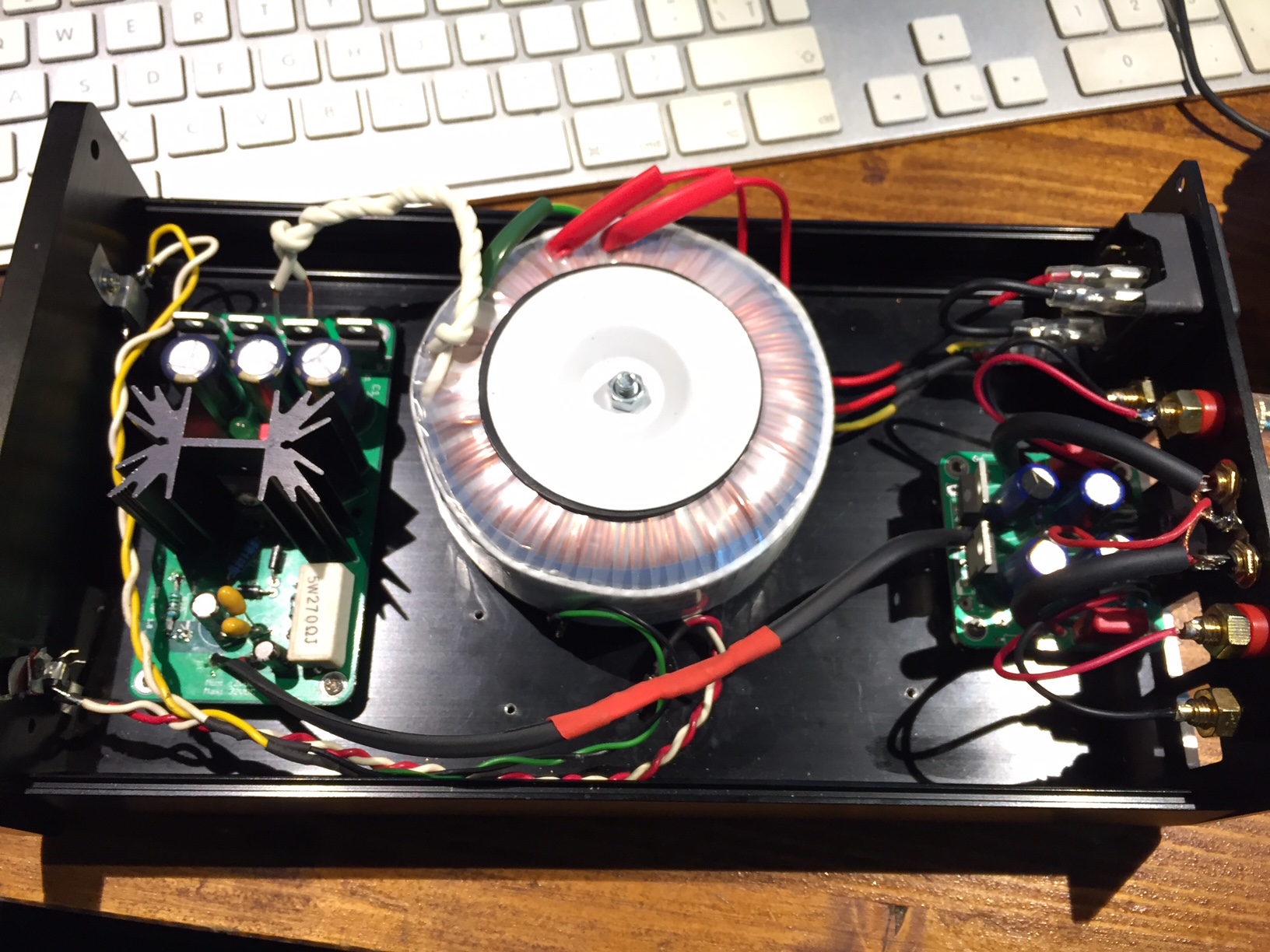

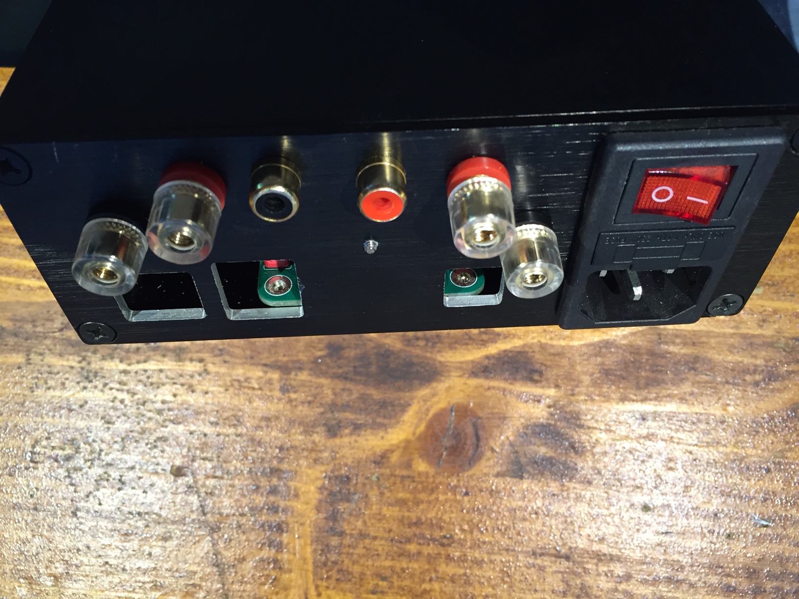

Decided to case the small amp today.
I repurposed a case that I used for a raspberry pi Airplay server. I made a smaller version with a Pi Zero and now I had a nice case for the tda7297 amp.
It's not yet finished, I need to add a soft power on/off circuit, and maybe even add a Pi Zero for Airplay use. There's some room left inside. Also I have to ground the case, and get better RCA connectors, isolated from the case. Right now I'm testing it's thermal stability.
The PS is a LT1085 application. The power transformer is a 14VAC/5A one, and the final voltage feeding the tda chip is about 16.4VDC. So far it sounds great, no noise, no pop at on/off.
