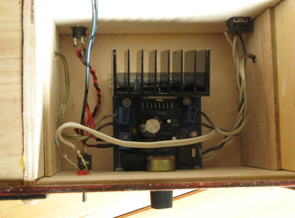

@Destroyer OS: I'm curious about the cap bank, do you think they could be that bad and did something to the current that fried the chip? I started making it when I read your thread in audiocircle and when I used proper caps, it works well. Out of curiosity, I put a new chip in, and ran it with the cap bank. Only played music for 30seconds, then nothing. The heatsink get about as warm as if it had been playing for hours.

Why don't you take some pictures? I doubt capacitors would cause the problem, but something is obviously wrong if you put in a new chip and had a failure.
Could it be the pot was fried when the voltage spike occured so it is not sending any signal to the chip? What angles of photo will help in this case? Thanks again.
Excuse the solder job on the chip, I was halfway desoldering them. The solder job was okay when it happened tho.
Some concerns include how and where SG and PG should connect, etc. Resistor value, etc etc. Phew. I have deep respect to those who designed great looking and functioning PCBs. Thanks.

It looks like you have some cold solder joints. One big DC cap, and maybe some chip pins.
SG to PG is just fine where it's at.
Wires under POT are safely not touching?
That makes perfect sense. I will actually desolder the parts and build another board of the same. Wires under pot are individually shrink wrapped, but I'll recheck just to be sure. Thanks J.
You were right, moving all the parts into a new board did it. It's now working well, just as it was before. I also ended up using the eBay caps cap bank. At some point I thought it funked up the current, but after some comparison, it gives a little 'air' that I like. Without the caps, it was a bit on the 'dark' side. Thanks so much for taking the time to help me.It looks like you have some cold solder joints. One big DC cap, and maybe some chip pins.
