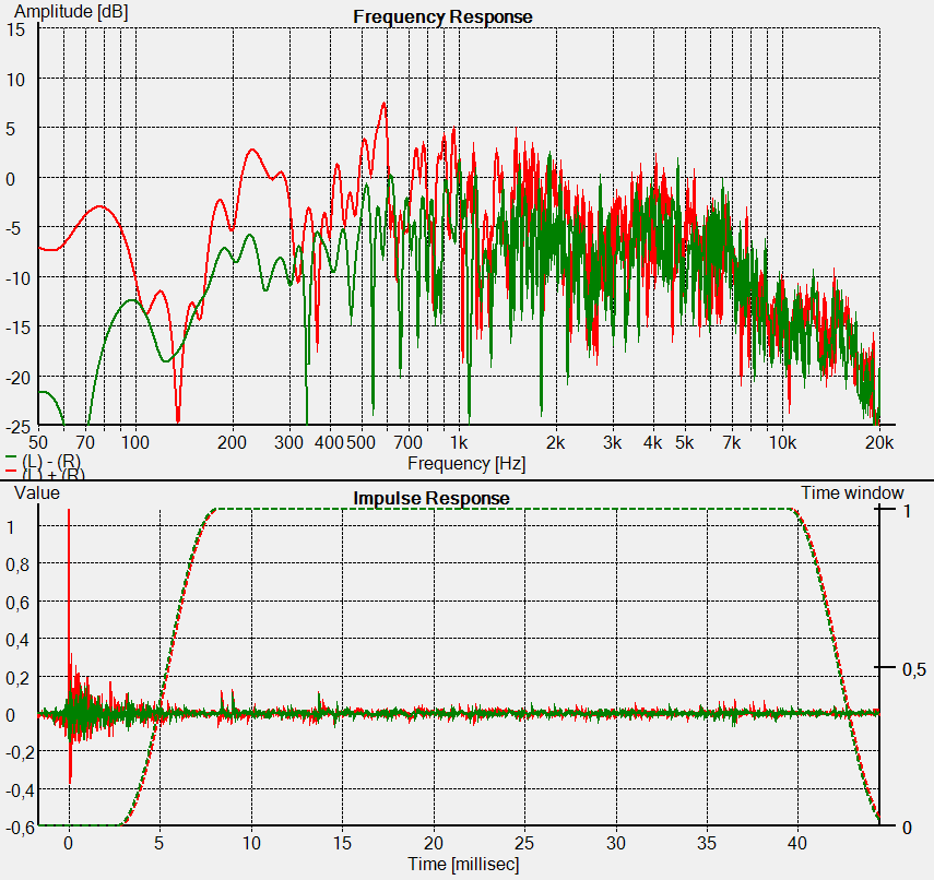

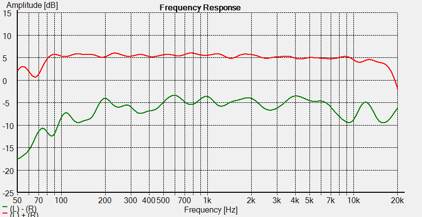

Hi Dave,Your time alignment could be improved a little. Your HF cancelation was weak and the blue impulse was still near full level. Either slide one speaker fore/aft slightly or sing the mic left/right until the top octave nulls as well as the lower octaves.
See graph for the best I can get with a sub-sample shift of ~0.85 Samples@44.1K (~7mm, 20uS) between the individual L and R channel recordings. So it was an indirect measurement using post-processing, not realtime diff, probably making the graph overly optimistic, notably at LF, using the data I took when I dialed in the system (with the Acourate software toolbox which does not do sub-sample pulse alignment by default)
I might try realtime test with out-of phase noise + RTA as well as out-of-phase logsweep, late tonight when it's as "quiet" as it gets, downtown where I live...
- Klaus

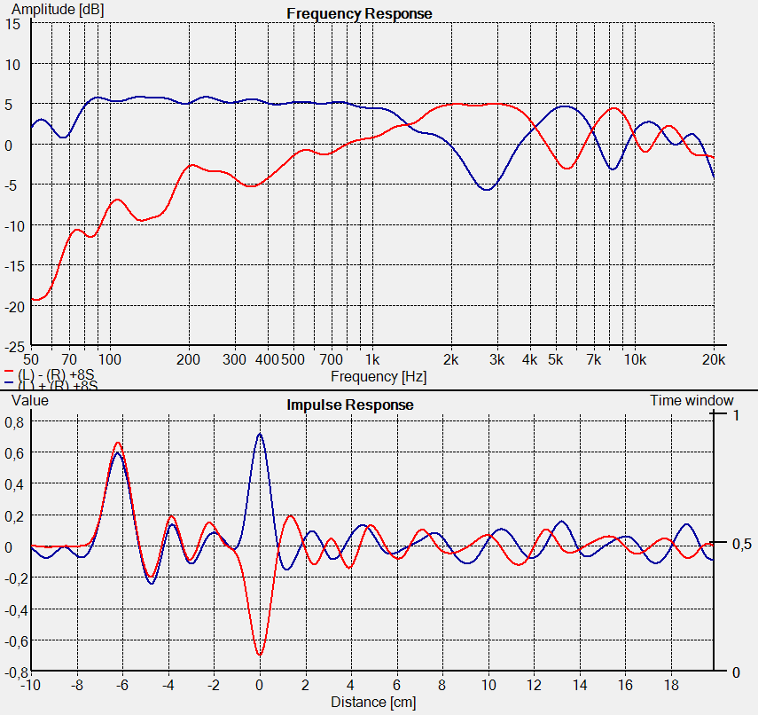

You're off center by less than an inch, from what your graph looks like, that's all.I'm really not sure what to make of this result... especially the crossing after 6K. I'll hopefully have the new crossover done tomorrow so will be interesting to compare after that.
See below what a pulse offset as low as 6cm (8samples@44.1K) does to the sum and difference, using the optimized data of my last post.

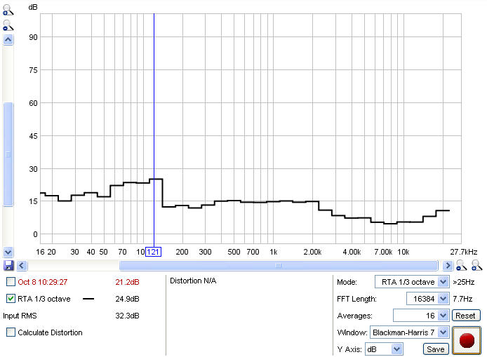

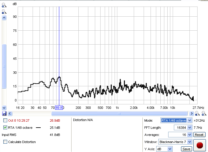

Markus - Here is my noise floor via REW. I did the calibration 3 times with different signals and checked it against 2 SPL meters. I swear it does not sound that quiet.
Overall the noise floor is at about 32dB. The individual 1/3 octave slices are lower, of course.
Looks unusual, especially at low frequencies. What does it look like when you're switching to 1/48?

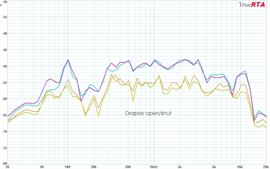

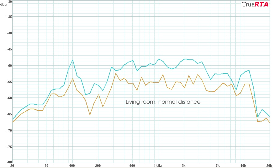

I also took a few different curves in my living room (main stereo room) and in the upstairs home theater.

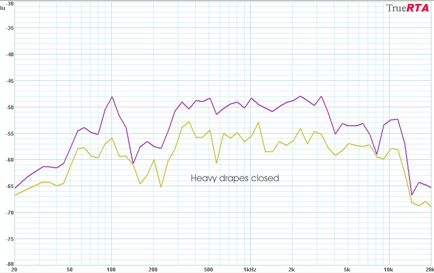

I started with the living room system at about half distance at 5.5 ft, then moved to the normal distance of 10 ft from the speakers.
The whole wall behind the speakers is glass and sliding doors, but we also have very heavy lined curtains that can be closed. I repeated the differences with the drapes shut. A second curve has all 4 curves on one plot (sums and differences for drapes open and drapes shut). Notice two things: drapes shut loses a dB at HF (there is a rear firing tweeter that would be well absorbed plus probably some miscellaneous energy coming from the front, and drapes shut knocks the difference curve down by a full 2dB. Differences are mostly in the 7-8dB range.
This speaker is a Snell XA reference with symmetrical arrays over most of the range up to the tweeter. The tweeter is in a waveguide to help match directivity. Still, it looks like directivity maxes out from 1 to 5 kHz. the dual driver arrays should have an added 3dB d.i. (2 units add on axis 6dB louder but only 3dB in power response, hence d.i. +3dB).

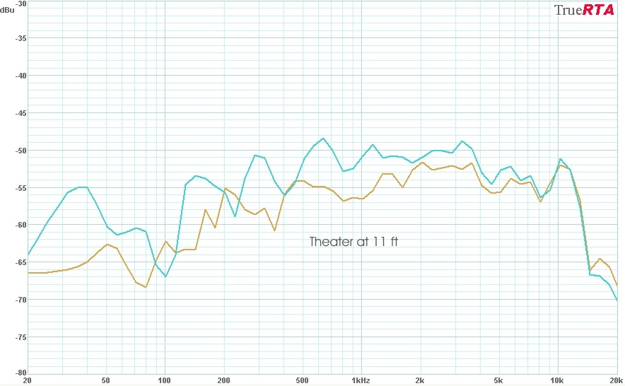

I went up to the theater room. This is a large bedroom with some damping panels and thin rugs over hardwood. There is also a lot of glass (1 window, 4 closet doors), so I consider this a moderately lively room. I also had a problem getting a good null here, something was going on around 3k, either some unbalanced strong reflections or maybe the speaker balance wasn't as good as it should be. I did try face to face cancelation, primarily to balance the subwoofer level (built in powered subs), and the nulling seemed pretty good. Perhaps I'll redo this with a better mic and also use impulses to see what the early activity is.

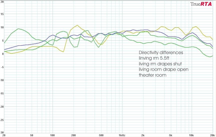

Finally there is a difference curve for all cases. Based on what frequencyies you look at the range is from 9dB to about 4 dB over most of the range.
So where is Earl? I'm wondering if his high waveguide directivity is enough to offset that marble palace he lives in?🙄

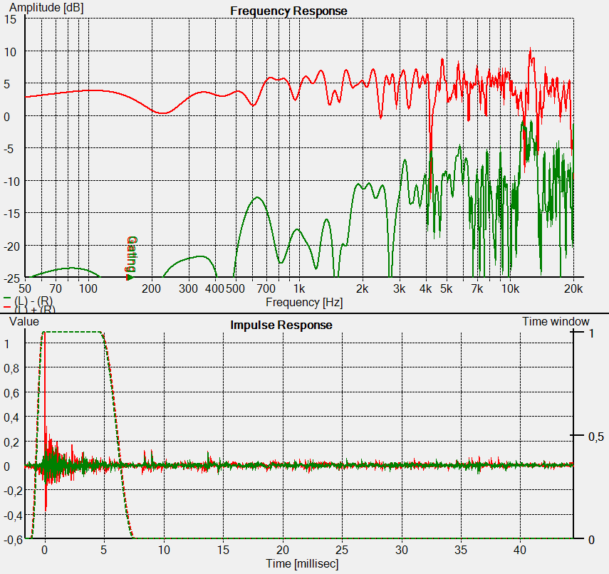

Hi Dave,
- Klaus
That looks like excellent cancelation, an even 10dB across the board. Is your speaker really that flat or did you just draw it in with a ruler? EQed system?

I'd have to set up again to test that. Notice that the drapes behind made a dB difference in the summed response. Some of that has to be the rear tweeter.Quite interesting how you're seeing sort of the opposite to me - you're seeing maximum ratio around 500Hz to 3Khz, with quite a reduction above 4Khz. A good ratio through the midrange due to the dual driver array perhaps, as you suggested ? Do you think the reduction at high frequencies could be the rear tweeter ? Does covering it up drop the reverberant field at the listening position significantly ?
