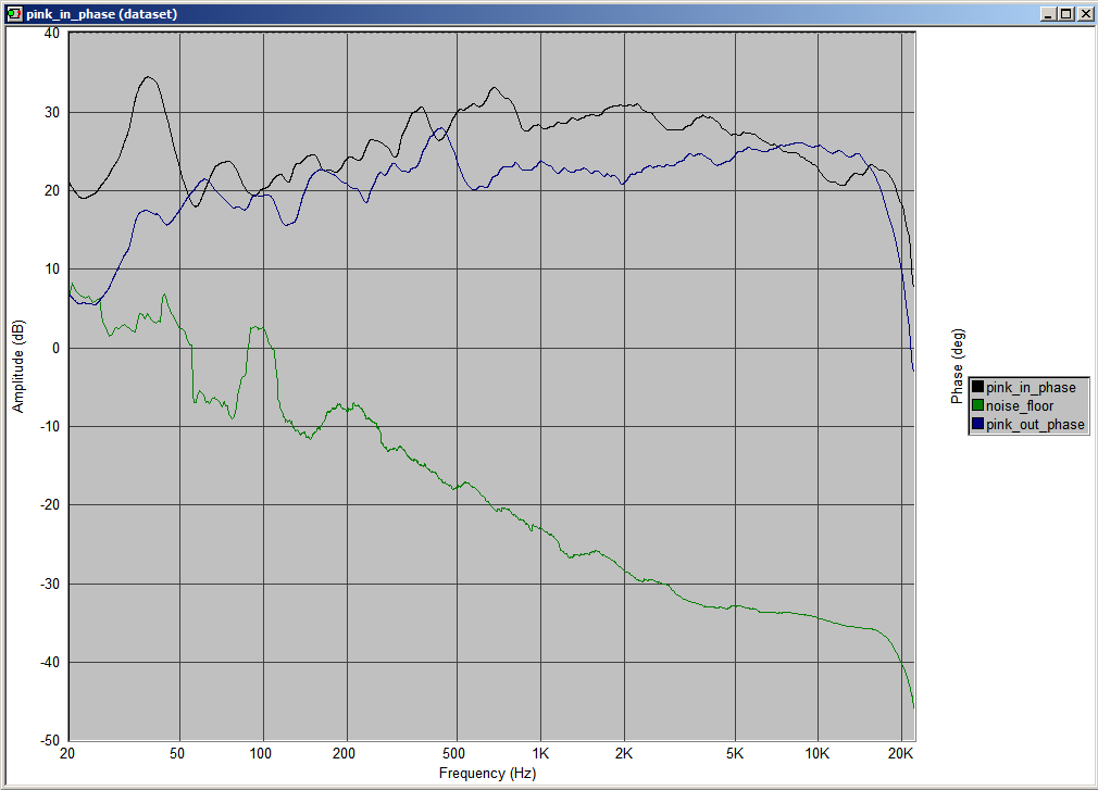

Well I've just tried the pink noise test. I'm not sure what to make of the result... Note I haven't tried to find the best null position, just did some short bursts of pink noise with the mic in the listening position without adjusting anything. (It's after midnight and I should be in bed, didn't want to push it)
I used REW with the same settings as markus, but exported and displayed using Speaker Workshop since that is what I'm familiar with, and 1/3rd octave smoothed it.
I'm really not sure what to make of this result... especially the crossing after 6K. I'll hopefully have the new crossover done tomorrow so will be interesting to compare after that.
Tony.
