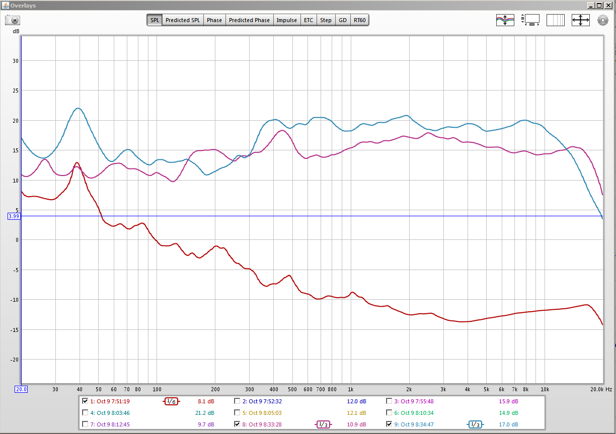

Its hard for me to measure the direct field accurately at 1Khz without moving each speaker onto a stand in the middle of the room to get sufficient window time, but last time I did this they were fairly well balanced through the 1Khz region as I'd applied a little bit of surround dip correction to both.I did notice that your 2 direct curves had significant imbalance there. Couldn't guess whether it is the speakers or some nearby reflection.
Certainly there isn't the 4dB difference in response which is showing up in the room response, they're within 1 dB of each other on axis through that region.
The speaker with the large bump at 1Khz is the right speaker, which has a strong ipsilateral reflection from a bare wall that's only 0.7 metres from the centre of the speaker, while the one without the bump is 0.9 metres with both a computer desk and a sofa along its wall providing a lot of diffusion. (The incident wall reflection is almost completely obscured)
(If you remember in the ETC curves from a while back, the ipsilateral reflection of the right speaker was less than 10dB down, while the left one was down below the reverberant field)
I'm hoping its just that side wall reflection that's causing the imbalance, and that the imbalance is resulting in incomplete cancellation in the Left-Right response, but I will be doing a bit more investigating to pin down the cause...
Dave,That looks like excellent cancelation, an even 10dB across the board. Is your speaker really that flat or did you just draw it in with a ruler? EQed system?
it's a fully DSP-EQed active 2-way system (convolution based), nude 15" PA coax, and no other response than the one at l.p is ever used to tune the system, the next level below that is the raw drive units.
Complete magnitude EQ to invert the computed original "weighted psychoacoustic response", a sub-process in tha excellent "Acourate" software package I mentioned earlier, and that's where the specifics are, using wavelets in the analysis, freq.dependant windows and what have you... the software really is a powerfull (semi-automatic) toolbox for most anything you need for elaborated pulse manipulation for whatever purpose, besides a plain measurement/display tool.
I'm using subs occasionally (3way active, then, but with no traditional band splitting XO) when I need more level or low end, they're not shown here as I tend to have them off most of the time.
"Phase EQ" is there as well -- which means pulse compacting and interchannel recorrelation, in the end -- to an overall minphase target (as given per above magnitude), spiced up with a overcompensated low end where phase rolls gently back to even more than flat linphase at LF (see plot), this is my try to partly compensate typical bass roll-offs from highpasses of the recordings. I'm a timing and timbre fanatic, that means I can definitely hear the influence of phase and polarity -- now that I managed to set up speakers that can do it... and one can play with these things so nicely with convolution-based DSP processing, exectionally well suited for realtime blind AB and ABX tests you can conduct yourself, for me there is no way back. That's "scientific DIY" at its best, first hand real experience with most variables pretty well under control, I don't need any other proofs than that.
- Klaus
You're off center by less than an inch, from what your graph looks like, that's all.
See below what a pulse offset as low as 6cm (8samples@44.1K) does to the sum and difference, using the optimized data of my last post.
That's massive!! I have a suspicion though that there was another problem... with some of the recent playing around I'd managed to hook up one of the tweeters with the wrong phase. I now get something more like what I'd have expected...though interestingly the in-phase/out of phase difference is now lower (but that could be because I moved the mic before I worked out the problem with the tweeter).
I have to get to work on the new crossover (one channel about 1/2 done).... the current one has poor phase tracking through the crossover region, the new one (in the sim) is very good. I'm very interested to see the difference. The other thing that is a bit confronting with this graph is how sharply the bass is dropping at 300Hz.... in nearfiled they are flat down to 200Hz and about -3db at 100Hz.... I don't yet have my subs running... the active crossover project needs to get some traction for that 🙄
Edit: the other very interesting thing is that the 2K suckout I'm always stressing about (in the gated measurements) is completely not there, and is in fact a bit of a peak in the in room measurement!!

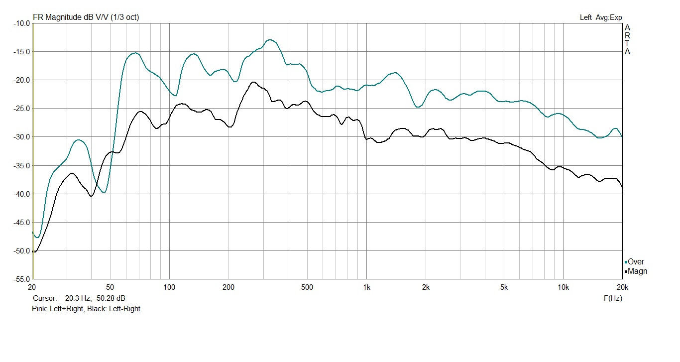

Ok, here's my measurement. Note that the scale is 5db/div. Measured just in front of the listening position, approximately 8 feet from the speakers. Room is 17 feet deep by 22 feet wide. However, speakers are in the left half of the room (11 feet wide).
Looks pretty similar to most of the curves being shown here. Speaker is a vented 15" crossed (LR4) to a 2 inch compression driver on a 90x40 horn at 1 kHz.

That's the whole point of the measurement - when we measure out of phase only the direct signal from the speakers will cancel completely, all reflections, except perhaps perfectly symmetrical early reflections (like the floor bounce) will arrive at essentially random phase angles and time delay and therefore will not cancel.Er.... impressive measurements you guys have, but I have a question.

What we're left with is a good approximation of the reverberant field.
When we measure in phase we get the direct signals summed together (6dB addition) plus the reverberant field.

The intention isn't to cancel everything in the room, but to simply cancel the direct sound to reveal the level of the reverberent sound. A deader room or more directional speaker would make the direct to reflected ratio higher yielding more cancellation (a lower difference curve) but that is not necessarily the intention, rather just to see what the ratio is.
