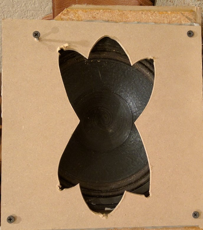

I don't like at all those drops at 1,6kHz. I wonder if the change of directivity below 1k is relevant?
I have good news on that one. I have a hunch that the dip at 1.6khz is caused by a gap between the RBI waveguide and the baffle.
Here's why:
When I first put the RBI waveguide on the speaker, I attached it with screws.
There was a HUGE dip at 1.6khz.
I took some mortite and I sealed off the edge of the RBI waveguide, and the dip mostly disappeared.
Then I rotated the waveguide 90 degrees, to do the other set of polars, and the dip came back again. I noticed that my screw holes weren't fully tapped, basically there was a gap of about 1mm because the two wood panels weren't 100% flush.
I used a file to reduce the gap, and the dip (mostly) went away again.
Long story short : I think the dip at 1.6khz is mostly caused by radiation from the woofer getting into the gap between the RBI and the woofer baffle.

Thanks!
The shape of the RBI has evolved over the last fourteen years.
First time I noticed it was with Doug Winker's car, this is fourteen years ago. I vaguely recall he worked for JBL? I'm not 100% sure on that, his LinkedIn is private. I don't think Winker or JBL patented this.
The next time the RBI appeared was in 2009ish. JBL filed this patent in 2008, #US20090310808 A1
The "teeth" are still there, but most of the driver's surface is masked off. This is just basic horn stuff, the RBI is a phase plug, albeit a different kind
In 2010, JBL's senior manager of transducer engineering and reasearc started publishing designs with this shape. JBL patent US20110085692A1
is where it first appears. It's clearly an evolution of his patent from five years before, #US8036408B2. But the new one has teeth 🙂 (Nothing like a little phase plug humor, amirite?)
Interestingly enough, Voishvillo put teeth on the compression driver first, but then put them on midbasses later patent #20150373445A1
I hope that wasn't the longest most boring read ever!

It's a phase plug:
It takes the radiation coming off of the radiator and changes the shape
There's a second component, which is the volume of air trapped underneath the cone. That volume of air acts as a low pass filter, just like a bandpass box
You might WANT that low pass filter; for instance the JBL EON 600 uses that volume of air to roll off the output of the midbass. Inductors are ten bucks, a plastic waveguide is a buck.
But if you DON'T want that low pass, you'll make the phase plug so that the volume of air is as small as humanly possible. That's what you'll notice in the Voishvillo patents, he's eliminated the volume of air between the cone and the phase plug
I have a feeling you could probably come up with a compromise between the two by making the aperture shape closer to circular, instead of elliptical.
I don't think that all the little deviations in the hole cutout have much influence. Basically an ellipse of various aspect ratios is what you are doing. The directivity will narrow when the cutout is small. A smallish circle will be wide axisymmetric and a very narrow ellipse will diffract wide and almost no change vertical. What one has to worry about are the resonances inside of the enclosed volume.
If that makes sense, then you can see that we have two ways to fix this issue:
1) We can use a waveguide that's larger than the woofer. This would prevent the waveguide beamwidth from broadening until we reach a lower frequency
2) but the JBL RBI basically accomplishes the same thing. Instead of making the waveguide WIDER, it makes the woofer appear to be NARROWER
I don't quite agree with point #2. They "do the same thing" in terms of matching the directivities, but they do so at very different DI values. To me this make approach #1 far preferable since I seek to have CD at as high a DI as possible. Approach #2 can only lower the DI, never increase it. JBL believes that a lower DI is preferable (a point which I take exception to.) It is a simple fact that lower DI CD is far easier to achieve than higher DI CD.
People often look at the polar maps for my 12" speaker versus my 15" one and don't see a significant difference until I point out that the DI for the 15" is flat at almost 3 dB more than the 12" is. This is not insignificant to me.

Just to clarify - did horizontal polars of the woofer was measured positioning baffle cutouts like it was in in JBL design (see attach)?
I mean, pictures of the mimicking baffle may be misleading as they are shifted 90 degrees to what is expected.
