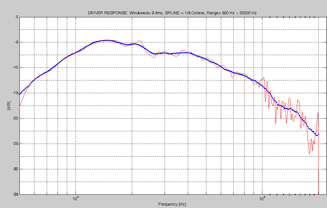

Hi POS,
Interesting words about M2 horn design, but some other presented data about the D2430K driver with the horn ( I believe M2) ,and M2 EQ parameters can make another point of view.
JBL Master Reference Monitor - Page 34
some notches in the F/R around:
- 9.3 kHz (Q=10)
-11.2kHz (Q=13)
-16kHz (Q=5)
can shown us that some problems are even there (M2).
May such thing can be expected if we are looking at the M2 horn throat, where I can seen quite sharp surface transitions.
May be Mr.Charles Sprinkle has to do that in order to produce wide dispersion ( as 2405 ) ( horizontal and vertical-???) .
May they are pushed to produce wide vertical dispersion too, and "fast flaring horn walls" in order to protect the driver from "the reflective sound waves".
