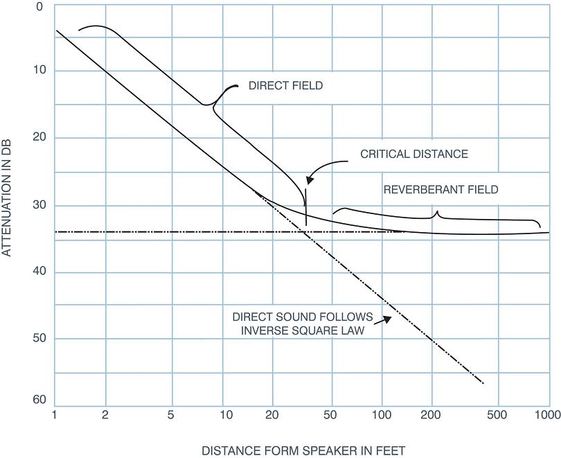

The real question is how low below the direct sound. This gets straight to what you desire: 10 or more dB down would be a high clarity, direct sound dominant sound. Something like a Bose 901 (negative effective d.i.) would give a reverberent field level higher than the direct field and a room involved sound.
Attached is a figure that shows how level drops as we move away from a sound source. At the early distances the direct field dominates and the level drops as we move away from the source, falling 6dB for every doubling of distance. At a certain distance (called the critical distance) the direct field and the reverberent field are just equal. As you go farther away than that the reverberent level is approximately constant. The direct field is still falling but we don't see it in the total result because it is now well below the reverberent level.
Both speaker directivity and room "deadness" would push down the level of the reverberent field.
The relative level of the two is exactly what we are measuring.
Actually come to think of it, this is not quite what we're measuring.
In the out of phase connection we're exactly cancelling the direct field from the two speakers (assuming the speakers are well matched in level and frequency response) leaving only the reverberant field. This corresponds with the dotted horizontal line on the graph.
However in the in-phase connection we're not measuring the direct field (represented by the downwards sloping line) because we're not windowing out the reflections. (Practically speaking we couldn't at the listening position anyway, except perhaps above 3Khz or so)
What we're actually measuring is the sum of the direct field and the reverberant field, as represented by the curved line on the graph.
So we're comparing direct + reverberant vs reverberant only. As a consequence of this we can't measure situations where the direct field is significantly below the reverberant field because its impossible for direct + reverberant to be below reverberant only. With a negative DI speaker the in-phase and out of phase connections will just measure roughly equal but with no way of knowing how far below the direct field is.
Also the critical distance where direct and reflected are equal will be represented not by equal amplitude in the two measurements but by the direct+reverberant field being 3dB greater than the rereverberant field only. (Non-coherent addition)
For ratios of over 10dB or so direct+reverberant/reverberant will start to approximate direct/reverberant.
What this all means is that my 4-6dB ratio is only just slightly above the 3dB that represents the critical distance 🙁

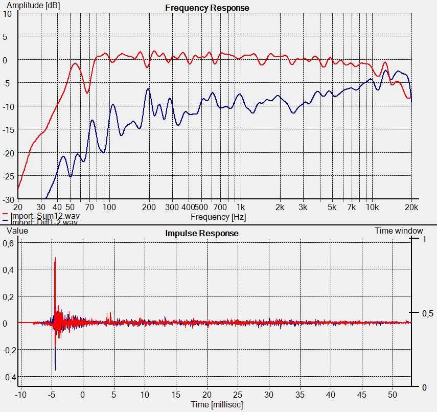

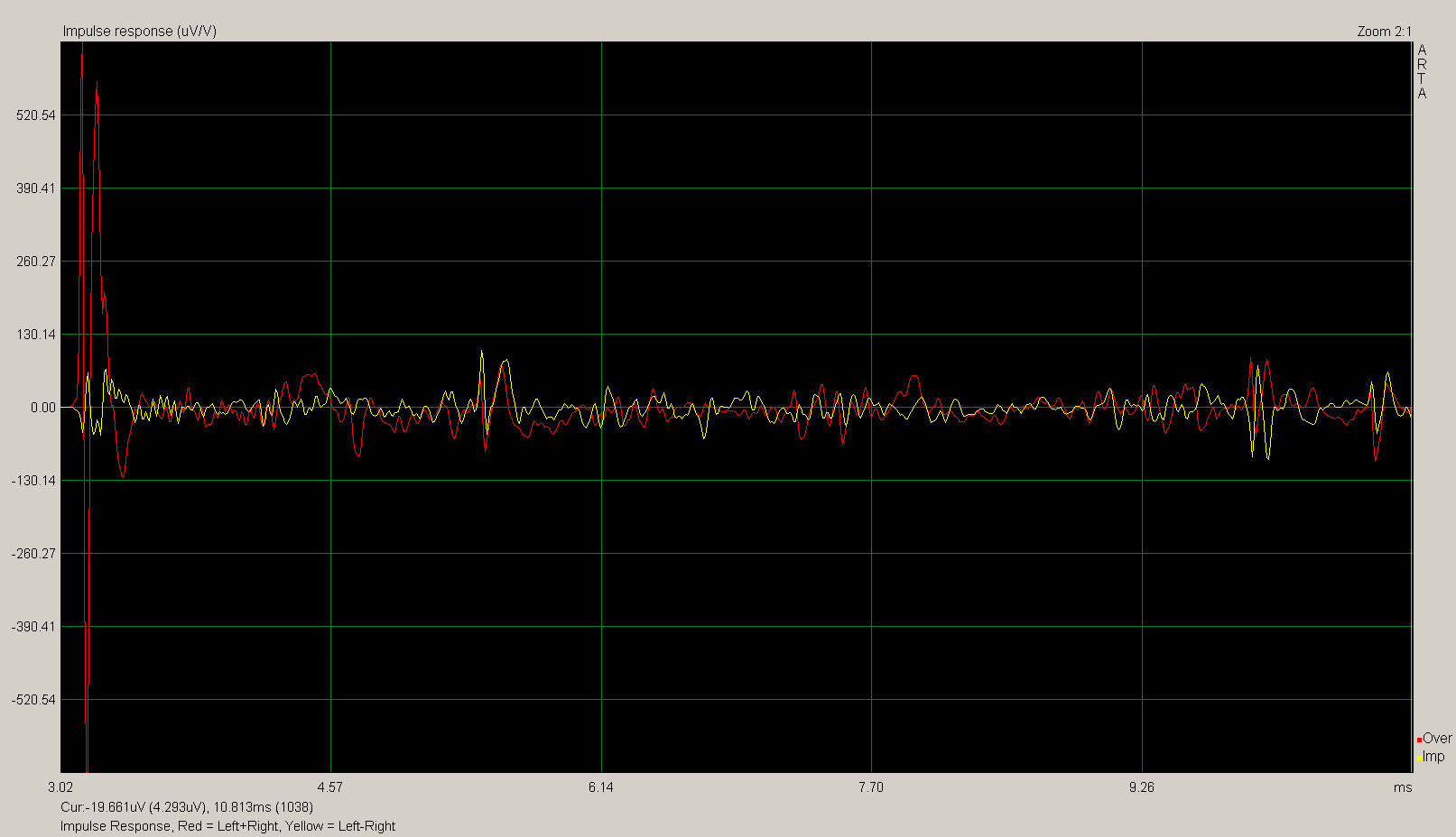

I was having a look at it earlier and thinking of posting it. See attached image. Red is in phase and yellow is out of phase, both in the same scale and from the same measurements as before.
The initial impulse is imperfectly cancelled, although to be honest I didn't try adjusting the channel balance for optimum cancellation during the original test. It's still smaller than the early reflections though.
Time zero is about 3ms on the scale. (ARTA always normalizes the initial impulse rise to sample number 300 in single channel mode)
In the out of phase scenario I reversed the left channel, so we can see that the early wall reflection from the right speaker at ~5ms (actually ~2ms) stays in the same phase, while the contra-lateral reflection from the left channel around 10ms is reversed.
The bump around 4.5ms is (actually 1.5ms from time zero) is probably the floor reflection - so when the phase is reversed the floor reflections also cancel each other. The bump just past 7.7ms may also be the ceiling reflection which will also cancel each other when in reverse phase.

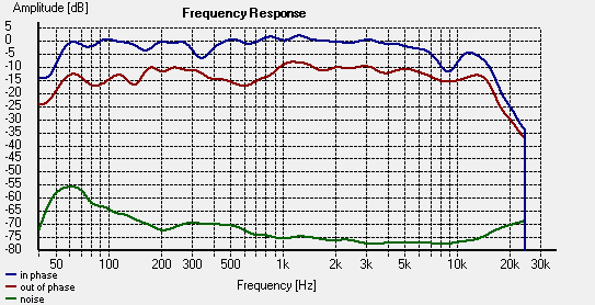

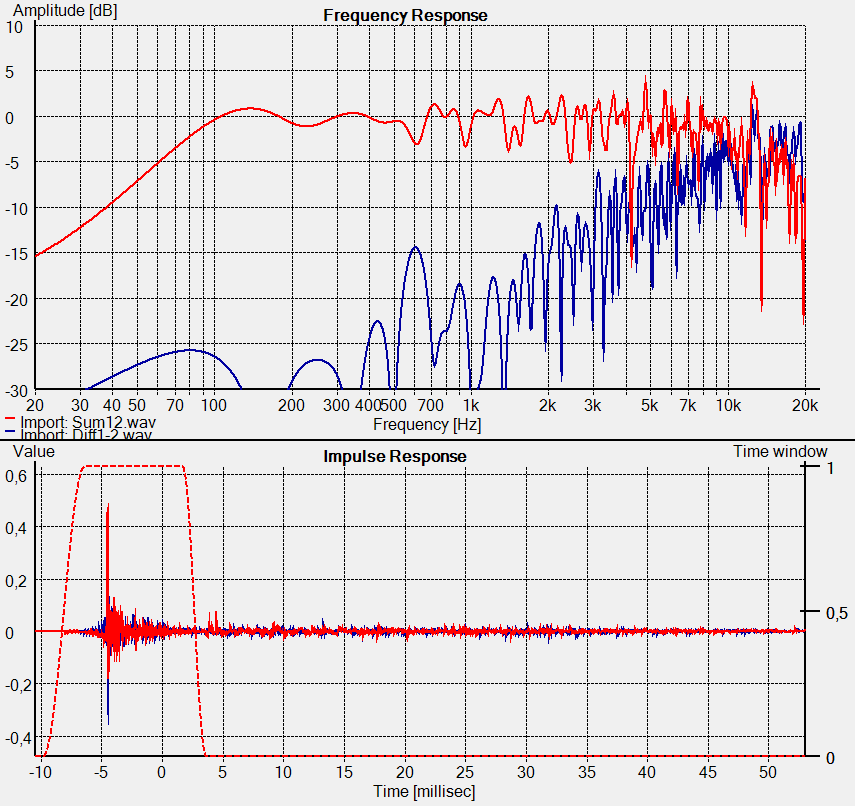

Done! Had to move right 7". Fixed now. Impulse and SPL matched very closely between the 2 speakers. Below is my attempt at the in phase/out of phase trick. Looks like between 10-15dB cancellation is the best I can do.
Will study the others posted here to get a better idea of everyone else's results.
Are you living in the countryside? The noise floor is unusually low. What does your room and speaker setup look like?
There is a narrow notch in the response (about 1/12th octave) at 8.4Khz on my Altec 1005 horn + 288 driver combo. I've been working with Jean-Michel to find the cause, so far no luck. 🙁 It looks wider here because of the 1/3 octave smoothing.
That noise floor is relative to the playback level circa 83dB. I live on a noisy, busy street so had to build a decoupled wall on the side that faces the street. It works well. Motorcycles and firetrucks are still loud, tho. Mostly thru other parts of the room like doors and windows, not the decoupled wall.

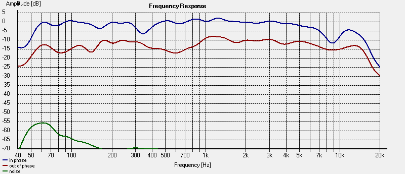

Below is the same graph at an expanded scale closer to yours, Markus.

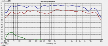

Yeah, more than 10dB is not easily achieved, I learned too. Obviously I missed the center, as the diff gets even louder at the top end (graph is 1/6th-oct smoothing),
It has to be noted that this is a DSP'd system which helps for flat freq response and for part of the nulling.
- Klaus

The problem is that you get very different readings even when moving the mic just for a few millimeters.
This is why I'm experimenting with multiple tweeters (4), 7kHZ and up, so cancellation nulls get filled in by adjacent drivers, which because of their different physical locations, and therefore time delays, will have their cancellations at differing frequencies. The end result should be a smoother response. I'm doing a 4 tweeter horizontal curved array (somewhat like the Bozak array). It would be too directional if the array wasn't curved (I'm using 20 degrees per increment). It won't fix everything, but it should be noticeably better.
