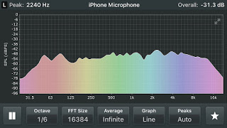

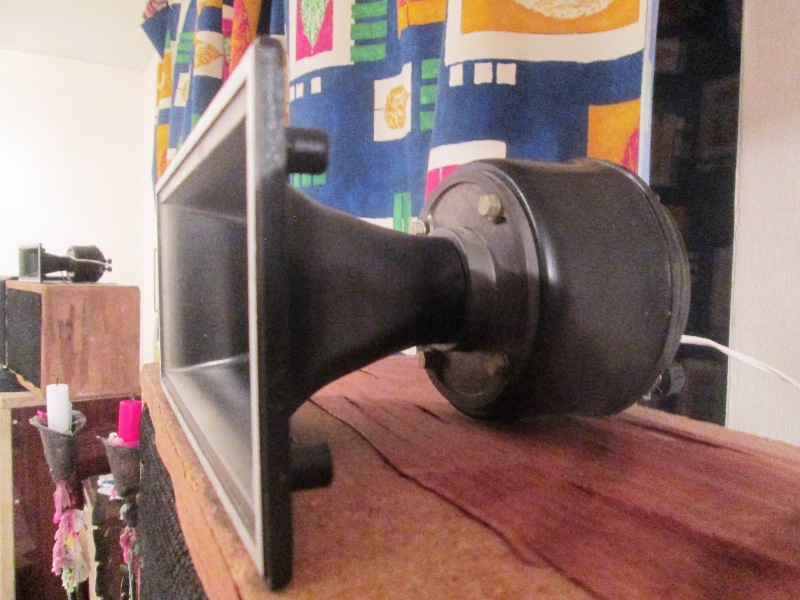

The late iteration with those Is using a 2" in 8" waveguide crossed at 1 kHz(I believe..🙄).
Nice behavior of that shallow WG, an old speaker, repurposed.It sits below the box.
The 8" woofer Is a Vifa from the '80s

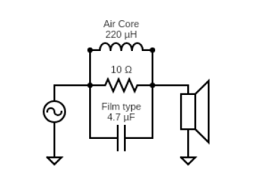

I made a pair of bass reflex boxes for a pair of Alpair 10 (aluminum cones). I find they sound a bit edgy in the highs, kind of forward sounding. They don't sound as smooth as the JBL LSR305 speakers, so I suspect they don't have a flat and accurate FR. Or maybe I'm hearing cone breakup in the 10kHz to 12kHz area (which is as high as I can hear these days). They are nice sounding, and you don't notice anything wrong until you hear something better. Maybe if I add some baffle step compensation to make them sound more 'full'.
I use those in my office, but i use a LRC filter to tame the highs and then they are great. The filter is basicly an inductor resistor and cap in parallel with each other in series with the driver and that tames the resonance of the driver (see pic). For nearfield listening those are great speakers, but they lack a bit bass and dynamics for big classic orchestra's or organ music. In my living room i use the same driver combined with a 10" scanspeak woofer (both in sealed cabinets) with crossover at 250Hz (1st order serial) and that works much better as the driver does not have to do bass so it can handle the dynamics better.

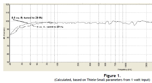

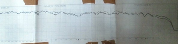

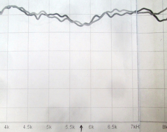

Because bass is not directional, it means there is 2 x 12 and 2 x 15 and 470L of cab which handles the bass. so, 226 + 353 sq in of cone area. a total of 580 sq in devoted just to the bass in massive cabinets the size of large fridges!
On tests, there is ZERO tail off below 100hz, giving at least 10-15dB more sensitivity down there - ie. a more or less linear response curve fed by 170W of valve amps.
I have never heard organ music ever reproduced with such accuracy, it sound truly wonderful on any silbermann, cavaille-coll or willis good quality recording.
but you can play absolutely any music through it, including the well known opening minutes of dark side of the moon which make the concrete + brick walls & pine wood floor vibrate.

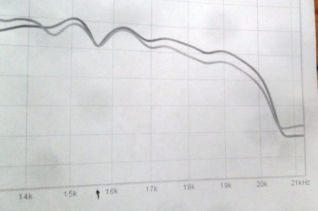

This was a system specifically designed, invented to monitor studio recordings done elsewhere.
The tweeters are old LOMO russian cinema units with massive alnico magnets - pretty much a copy of the old and outstanding Altec 288B.
Those are running off totally different windings on the OPT from the bass units, with totally independent wiring harnesses.
Good studio mics register those as still developing acoustic power at 18-28khz.
I have just ONE live recording of Ural - Yekaterinburg orchestra playing Tchaikovsky Francesca da Rimini which has a bass drum part in the finale. Not a single system before this one was ever capable of reproducing it, and even this one struggles. https://ks4.imslp.info/files/imglnks/usimg/d/d5/IMSLP41385-PMLP19413-Tchaikovsky-Op32.TimpPerc.pdf
Look at parts pages 4-6 with the tamtam thrown in too!

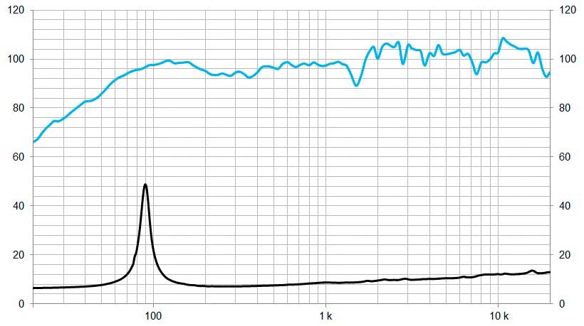

Once you get into the area above 2-3khz where most people would like to cross over a compression driver comes into its own because of the high efficiency.
That was my thinking behind using a good C-D above 3khz, taking over from a good full range dual cone at the point where that starts to display cone break up and high distortion.
On my drivers I discovered a nasty resonance at 6khz which is dialled out with a DSP.

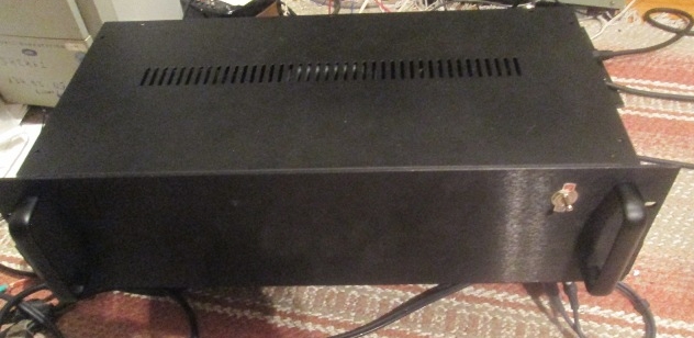

I also auditioned my own design of "studio monitor" valve amp, with the same combos of music and speakers.
This showed the same clarity of the solid state amp, but something else indefinable (which is why I spent 3-4 yrs designing and building it), which was a much more "living" sound, which we could only define at certain moments as 'sheer magic".
It also passed the same barrage of tests driving the 4 speakers, showing up similar clues as the 1950 amp, and very clearly not liking having a "distorting" preamp feeding it with "euphonic" valve sound, which the solid state didn't mind so much.
Very clear conclusions were drawn, confirming my own bias for my own favoured solution, which was for a speaker array, with each little section dedicated to doing what it does best. (7 drivers in total for each front channel).
In that case it's irrelevant what music you put through it, it always sounds fantastic, but I simply haven't found a tweeter that works as well as my old "Altec clones" from Russia. (which of course are cinema drivers, eg.compare-with modern beyma).

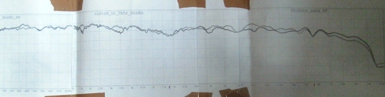

Here are various views of bits of all this including the "idealised" Harmann curves.
We didn't totally fail in our search for the "perfect combo" for each music, but there were some things we still didn't fully understand at the end, especially after measuring everything in great details with Neumann microphones.
It was great fun, including a long debate about why the manager of the local "hi end" music shop has an auditorium which has horrible resonance problems, favoured one of my amp restorations where it's clear the sound is extremely coloured (1950s 6V6 based amp), and clearly struggled to identify uncompressed 24-96 PCM audio compared with high rate mp3, and misidentified the mp3 version as being "BETTER".
In this game you only know what you don't know, and/or struggle to explain.
When it becomes a question of money, cables, components or budget, it's clear after double blind testing, bias is obvious.

Thanks for the notch filter schematic, I'll try it.
Do you use that same notch filter in the living room setup (with the 250Hz crossover)?
No, designing is half the fun for me so i did my own design that you can find here: Dropbox - Mark-Audio-Alpair-10M-Slot-Ported-Official-CAD-drawings.pdf - Simplify your life. I never build kits for myself, only for others on request (and paid).
And i use the same filter in the big setup indeed, it's not really cabinet depending this, this is purely to tame the resonances in the top of the response of the driver outside the band that is affected by the cabinet design. so it's rather universal for this driver.

As for recreating bass, it's got nothing to do with "equal amplitude" because all speakers apart from some very rare drivers roll off the bass by at least 5-7dB per octave below 90hz.
(Almost the only ones that don't are studio monitors like great-plains-audio, derived from Altec).
See graph of the 15" unit. 98dB at 1W at 40hz....and only about -1dB down dropping only about 2dB more at 30hz.
It makes Tannoy look the really weak out of date stuff it really is.
I arrived at a solution where the bass simply doesn't roll off, which is similar in some ways to Altec, because by accident or design I used the recommended size of cabinet they do
