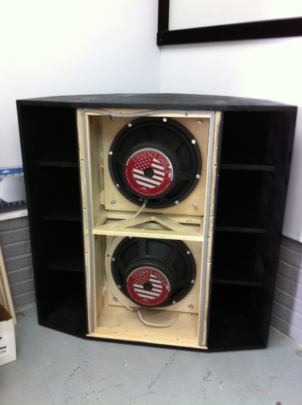

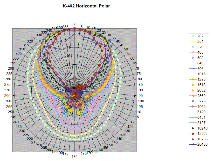

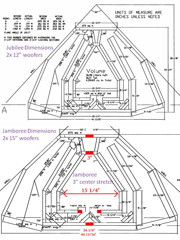

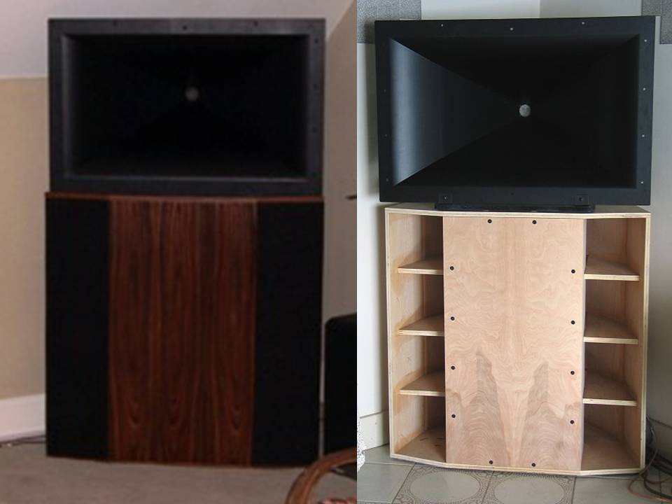

For corner placement high efficiency, there are positive reviews for the klipsch K-402 Horn with the BMS 4592ND driver, on top of the Jamboree(dual 15" woofers) corner bass horn. Because the BMS 4592ND is a coaxial compression driver, a crossover of 450Hz to the Jamboree corner woofers is said to have a natural sounding transition. Construction plans available for Jubilee and Jamboree corner bass horns. Should deliver 98-100db/watt driven by 2A3.

The K-402 multiple entry horn (a single horn that is smaller than all the choices that you show above) is neutral, cohesive, and produces a huge soundstage. It exhibits the bass reproduction cleanness and phase/group delay behavior as the Klipschorn but without the issues of midrange-bass time misalignment and dual-mouth bass bin diffraction/polar coverage in the midbass region above 200 Hz. The K-402 multiple entry horn also avoids the issues of direct radiator distortion. Controlled coverage is 90 degrees horizontal by 60 vertical down to 175 Hz (i.e., much better than all other choices shown above).

To the potential builder: There are many mistakes in the above post. If you think you might go in this direction, please go to the Klipsch site and do some research first.
Like? Or are you playing Brockian ultra-cricket?
I am not very smart so I don't understand your reference.
In answer to your question, the biggest problem, and there are others, is the schematic shown. The bottom half is labelled as a Jamboree with a pair of 15" drivers. That is not a Jamboree, not even close (first clue is that the drivers are facing the wrong way and the folding is entirely different). Again, if a builder is interested in following along these lines they will need to do some research over at the Klipsch site.
In reference to the OP's original question, he might want to listen to some Klipschorns to see if he likes the sound of them. They can serve as a reference point since there are plenty of them around. Although the Jubilee will sound better, they share the same relative strengths and weaknesses as the Klipschorn.
