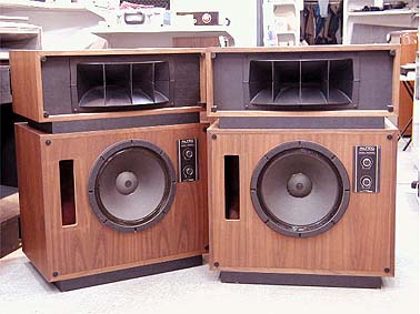

with the right combination of horns/drivers/amps and setup this can be very satisfying. It can be passive line level if the input impedance is kept high enough and you use a low impedance source - again the amps need to be dead quiet
I also was wondering if listening distance (around 3m, 10') is not too short for a big 2-3 way horn speaker.
The other alternative would be a corner coaxial speaker (Altec 604 or Radian 5215) in BR (Altec 606 like or Billfort) or BHL (Brociner...).
What would you advice ? Do some of you ever compared 604 and 5215 ?
Radian can provide Neo and Berylium diaphragm, any experiences ?
Knowing than active DSP crossovers and EQ (room correction) with Rephase and Minisharc can be applied (2A3 DC for med-high, Hiraga class A 20W for bass under 1000Hz).

For your application use of either of these smaller cabinets is contraindicated if you want to reproduce the 'big-air' of a full concert orchestra.
If anything, I would be looking at an even bigger bass horn & drivers. With the K402 on top, the c/o between it and the bass unit could be set lower to accommodate such a configuration.

Listening point will be at 10', maybe coaxial or full range shall be better. Listening room 12'*15'*10' height.
For GPA 604, a good choice I saw :
- Brociner Jensen corner Horn
- Altec 606
In a general way, how could the Altec sound be described compared to Tannoy or Klipsch ?
