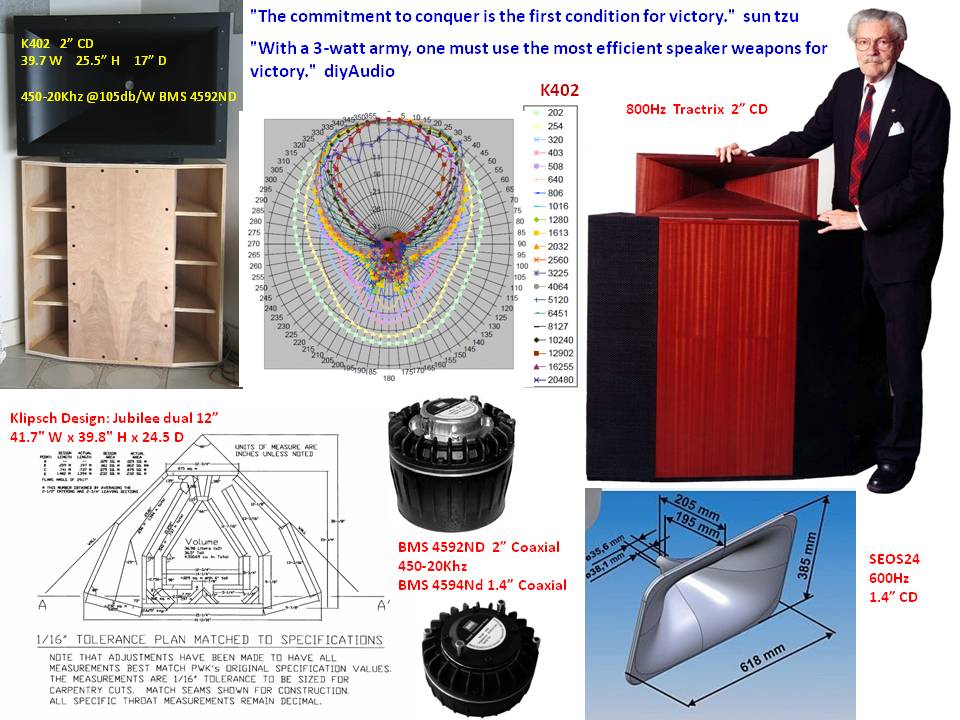

BEST WEAPONS for 3-watt army
Corner Loading for +6db low frequency SPL.
For corner placement, a 90-degree horizontal pattern horn with 40-60 degree vertical pattern is necessary.
Using a Fc~300Hz horn, the BMS 4592Nd coaxial compression driver covers 450Hz-20kHz at 110db/watt. Moving mass is just a few grams, ideal for a 3-watt army.
K402, eJMLC 300, JBL 2384
The Klipsch Jubilee corner bass horn with two premium 12" woofers is measured at 105dbwatt. 41.7" W x 39.75" H x 24.5 D

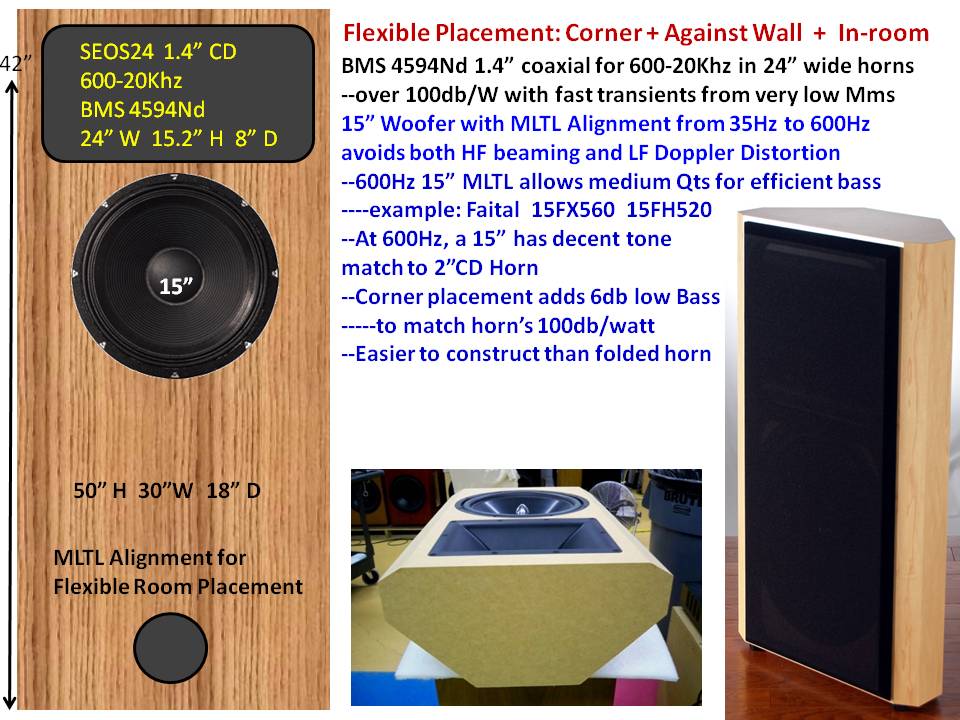

FLEXIBLE WEAPONS for 3-watt army
BMS 4594Nd 1.4” coaxial for 600-20Khz in 24” wide horns
--over 100db/W with fast transients from very low Mms
15” Woofer with MLTL Alignment from 35Hz to 600Hz avoids both HF beaming and LF Doppler Distortion
--Flexible Room Placement: Corner, Wall, OpenSpace
--Easier to construct than folded horn
--600Hz 15” MLTL allows medium Qts for efficient bass
----example: Faital 15FX560 15FH520, BMS 15N620,
--At 600Hz, a 15” has decent tone match to 2”CD Horn

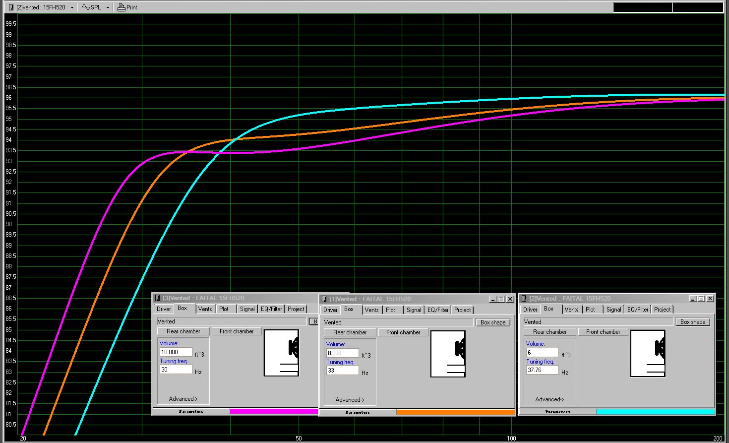

Simulations of the Faital 15FH520 woofer in 6,8,10 cuft ported box volumes illustrate the potential of ~100db/watt SPL 35Hz bass with corner placement gain. A tall MLTL with acceptable 28"-30" width is worth study for 3-watt amplifiers. Other potentially superior MLTL 15" woofers probably exist.
