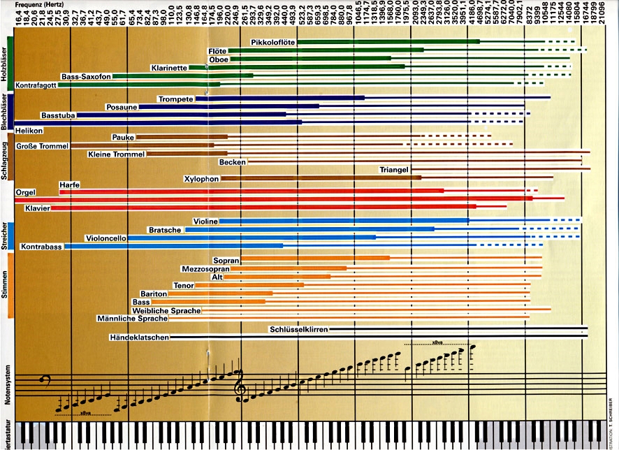

I totally agree with Eldam, harmonics of instruments do not exceed 15kHz, and piano/big chord need under 30Hz.
That is why hollowboy solution could be a good one. What do you think :
604 in closed box with DSP active filter <100Hz (passive or active between 15 and HF)
One BR subwoofer with a fast efficient 18'.
A great point source speaker with bass extension ??
