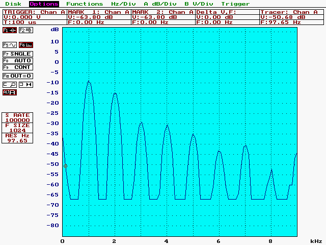

Given that many of the nastier distortions are generated in response to higher power signals in the mid ranges but emanate from our tweeters with lower levels of signal information giving spatial detail is, I believe, why such detail information is easily buried/masked in hash/noise. While crossover notches are fairly easily tamed and don't get worse with higher level, the output commutation n harmonics spray, as seen in my thumbnail (posted again here) in response to a pure sinewave signal and intruding through the PSRR or induction, GOES UP WITH POWER.

Oops, forgot the picture -
This is the 'spray' of harmonics generated into the supply lines by each half of a Class AB amp's output stage as it delivers a pure 1KHz sinewave to the load.
This is what masks your low level detail -

Hi Andy c,
Don't read too much into it - it was done as a simple lash up, the conditions weren't detailed. It's simply the FFT of a half sinewave, I created by running an amplifier output sinewave through a diode.
If you put a resistor into either the upper or lower supply line feed to your output stage and drove an 8 ohm load with a 1K sinewave you would get a spray of harmonics according to the fourier series -
f(t) = A/pi + A/2sinwt - 2A/pi[1/3cos2wt+1/15cos4wt+.....]
actually all the even harmonics decreasing out to infinity . The higher ones can be easily re-emphasized into the amplifier by a falling PSRR characteristic as frequency increases, typical of so many IC opamps.
