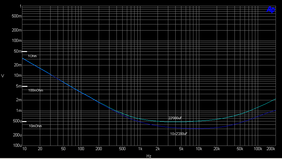

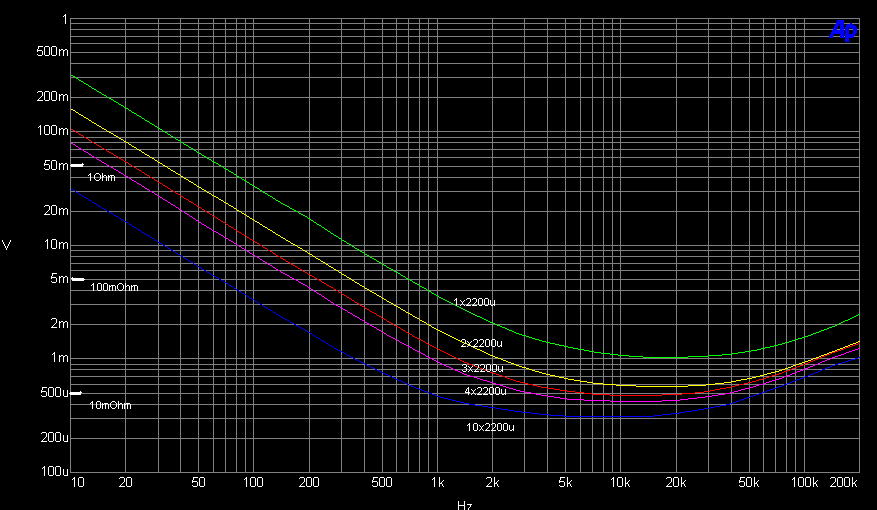

These are impedance measurements of 2200uF 35V Panasonic cups up to ten in parallel. The resulted impedance is higher than expected due to leads and solder joints resistance. As you can noticed no dips.

The graphs are excellent Dimitri.
It seems chemicon have a very non-inductive package if I read those frequencies correctly. And that dip is interesting?
Jacco, If c is x5 and L is /5 , L*C= same so no change in resonance?
Dimitri's measurements actually show the resonance coming down with multiple AND the diminishing benefit of paralleling at HF. However the 40% reduction in impedance at 5-20KHz over the single 22mF could be worthwhile. I note that 4x2m2F is the same at HF as one 22mF.
Are they as close as practicable, Dimitri? Yours are not the Chemi-con?

the 10*2.2mF cf 22mf makes sense, the hf performance of 10*2.2mF is superior due to the effect of the smaller caps(less inductance).
The 10*2.2mF cf 1*2.2mF also makes sense. The high frequency performance is dropping off slightly due to the added inductance of the interconnections.
The movement of the minima relative to frequency tell a large part of the story.
It appears from these that many small caps are always better than a small number of large caps provided the interconnections are kept very short.
Has anyone come up with an explanation for the weird behaviour of the earlier paralleled comparison graphs that show gains much greater than 10* and at higher frequencies?
