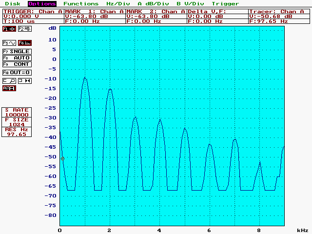

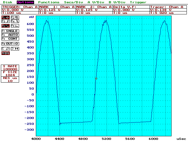

Now with each output half having to deliver half the waveform, just look at the spray of harmonics that are generated in and around the outputs and power supply lines
Hi Mr.Greg,
Your posting displayed the spray of harmonics in supply lines as well.
My WISE question is this what will happen when a birdged amp sprays the harmonics, Aren't they cancelled[I may be Wrong] due to out of phase waveforms in case of harmonic spray.
Kindly , share your views with regarding us.
