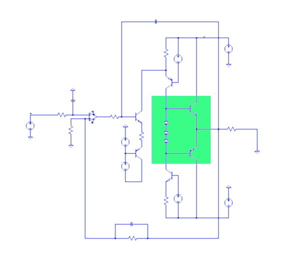

Hi
I try to understand what kind of circuit is under discussion. A green box in attached file just indicate a place for output stage, not a real OS.
But other part may be real. OpAmp like OPA603.
Is this circuit fit to the block diagram from p.60?
What kind of real circuit more or less fit to described design?

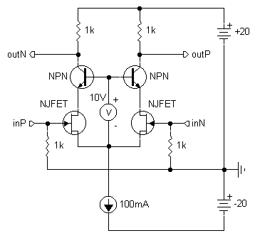

AndrewT said:Hi Ilimzn,
what is a bootstrapped cascode?
Are you able to post a sketch?
I am attaching a sketch - just for reference, the part values are not representative. The voltage source fixes the Ugs of the JFETs, if the FET was an ideal follower, the voltage swing seen by Cds and Cgs would be zero.
Since the real version of this circuit would require a relatively low impedance node at JFET source potential, it is taken from the feedback divider or from a dedicated divider with the same resistor ratio. It is also possible to connect it as it is on the sketch - all approaches have virtues and flaws...

AKSA said:Ilimzn,
That's a very interesting JFET connection.
I guess a constant voltage across the JFET will improve its linearity as a pure transconductance amp (gate voltage in, current variation out).
However, the curves lead me to think that any deviation in Idss, and I assume we are operating these JFETs with zero gate bias, should preferably be accompanied by a tiny variation in voltage across the device. That is, increase JFET current, and decrease voltage across it as a form of negative feedback, fully linearizing the JFET.
I assume you meant Id not Idss (Idss = Id @ Vgs=0).
Please note that the circuit above just shows the principle, the main feature being a voltage source between JFET Ss and cascode Bs (BTW this circuit can have many variations, not just a LTP). In a real implementation, as I stated, the Bs of the cascode can be derived in many different ways, for instance a voltage divider, or bootstrapping 'degeneration; can be introduced by adding suitable value resistors in the Ds of the JFETs.
Your suggestion certainly deserves serious consideration, and do plan to investigate this when time alowes. The tradeoff is balancing the nonlinearity of the JFET transfer characteristic and the nonlinearity of Cgd with voltage. This will vary with JFET chosen as well as DC operating points. A simulator with reasonable JFET models should be a good tool to test this and at some point in time, I probably will
The good thing with FETs is that units with fairly large Idss are common, which means a large tail current is used WRT typical BJT LTP implementations. This makes it easy to use a regular voltage divider from +Vcc to the common source point of the JFETs, since typical base currents for the cascode BJTs will be small compared to the tail current (bypass caps need to be used as appropriate, of course, to set proper AC returns and/or ratios vs DC operating point). MOSFETs can also be used with this topology with similar benefits.
This above approach eliminates one problem from my original question: the bootstraping (which is a form of positive feedback) loop is short and mostly confined to this stage, and limits the bootstraping to any value from 0 (Bs of cascode at AC ground) to ~~Vin (Bs of cascode and Ss of JFETs AC connected like in sketch above), so no problem with stability. Deriving the bootstrap in different ways gives more flexibility but also a danger of oscilation.
And is constant voltage operation of the JFET by using the cascode really the best way to go, since gain is simply gm x RL?
Well, since the cascode BJTs have Av~~1 you are limited to gm*Rl anyway, that is as long as you use a resistive load - and as long as you do you cannot escape relatively low JFET and MOSFET gm. Keep in mind that resistors in the sketch were just shown to make the circuit complete, they are not representative at all.
Decent voltage gain from this circuit requires an active load (eg. current mirror), or you use current drive for the next stage. Using this circuit as the front end of an amp feeding a BJT VAS would probably work just fine with resistors as shown (tail currents for JFET inputs tend to be quite high, so plenty of drive current is available). If you wanted to drive a MOSFET, voltage swings need to be considered, so different arrangements might be used.

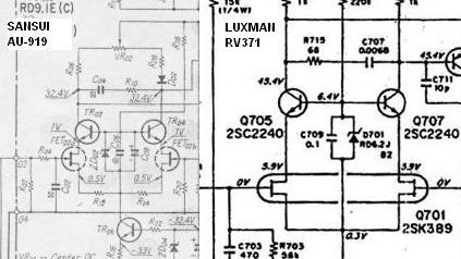

Upupa Epops said:Hi Hugh, nothing new . Is thruth, that this combination give much more better sound results than the same with bipolars.
There is one small but crucial difference between my sketch and the schematic you posted - in your schematic the JFETs are connected to a regular cascode without bootstrapping, which means Vds is not constant, but has an AC component roughly equal to the common mode voltage of the LTP (in actuality somewhat smaller as JFETs are not perfect followers due to finite gm), that in turn, is roughly equal to the input signal.
That being said, the schematic I posted indeed isn't anything new - I am not taking any credit for it, though I have not seen it widely used.

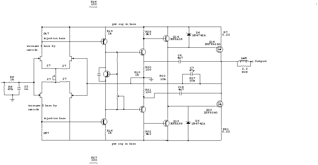

amplifierguru said:
No cascode in diff stage, yes?
No
Keep it simple and let NFB to do the job?
absolutely
I don't know.AndrewT said:did Luxman & Sansui have the same designer at some time?
Search diyAudio for "AEM6000". You will find there a lot of information about amplifier AEM6000 that uses this concept for the input stage.What effect does the bootstrapping have either on measured output or on the sound quality?

Thanks amplifierguru,
Is it possible to think about circuit from p.14 as about design which use your ideas and includes proper nested integrating loops? Close to real possible circuit?
Application of Vout = A [ Vin + Vs/(PSRR*A1)] is understandable, OK.

Ok, thanks a lot,
And on the diagram p.60 what are values of amplification of A1(input stage) and A2(Vas+O/P stage)?
I mean amplification at low frequencies open loop feedback.
And what are the open loop bandwidth of A1 and A2?
I am not interested in exact values. Only orders of values
