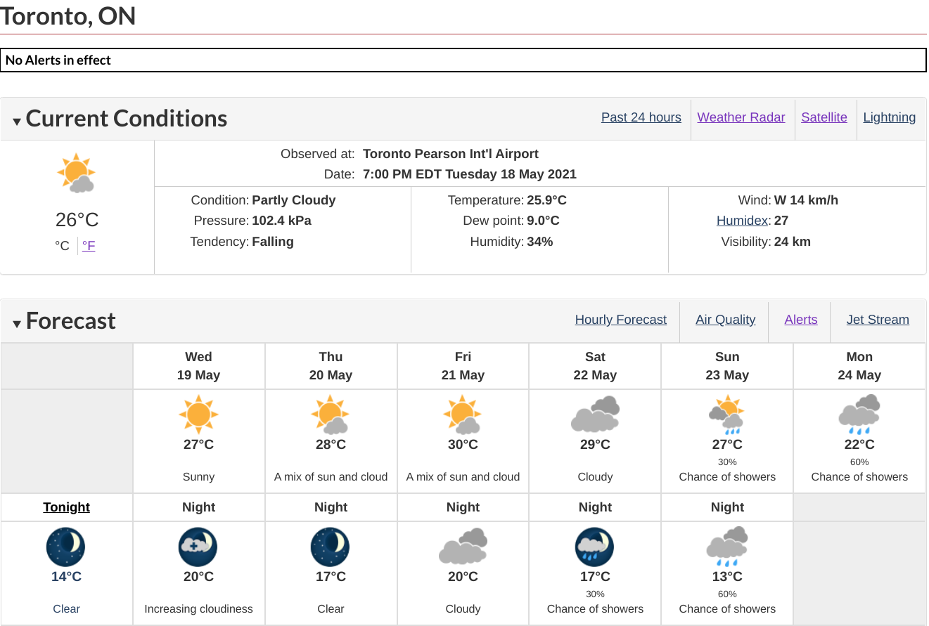

It's warm here now, too... Toronto... 27°C... (80°F for those still in archaic places of measure 😀😀😀).
Gonna be warm all week apparently... So much for a comfortable May.

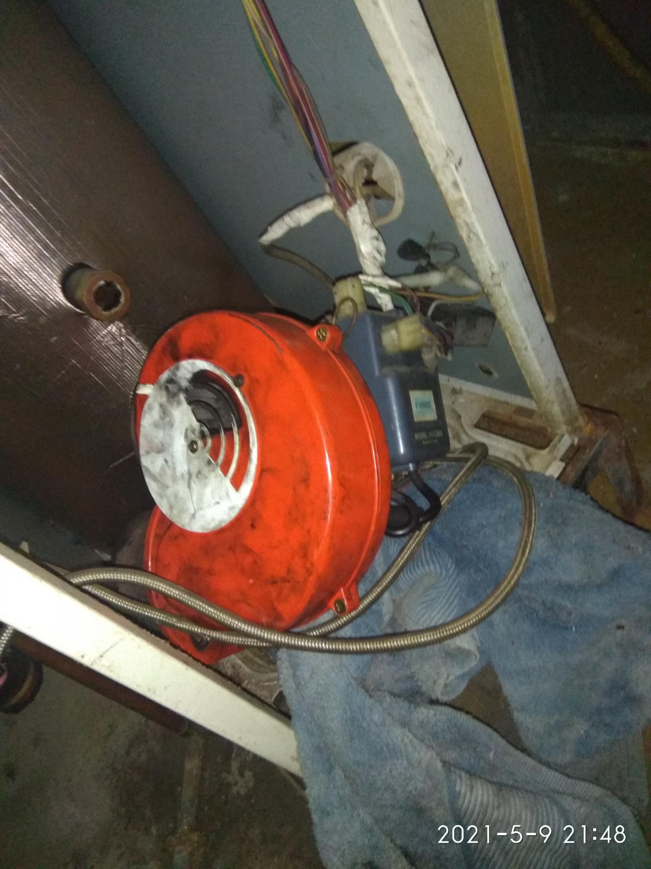

Repaired a leaking Westinghouse dishwasher, it would halt on a F1 error which did not finish the washing. F1 is a flood alert on the base pan. I tilt the DW and water comes out. Removing the base plate, I raised the DW about 1 foot high and placed my mobile phone camera under the DW. Starting recording when I start the DW. about 20mins, the outlet hose starts to leak when the water is hot. Replaced the clamp on the outlet end of the water pump. Took several tries as some cheapo hose clamps didn't do the job right.
Back to clean dishes.
