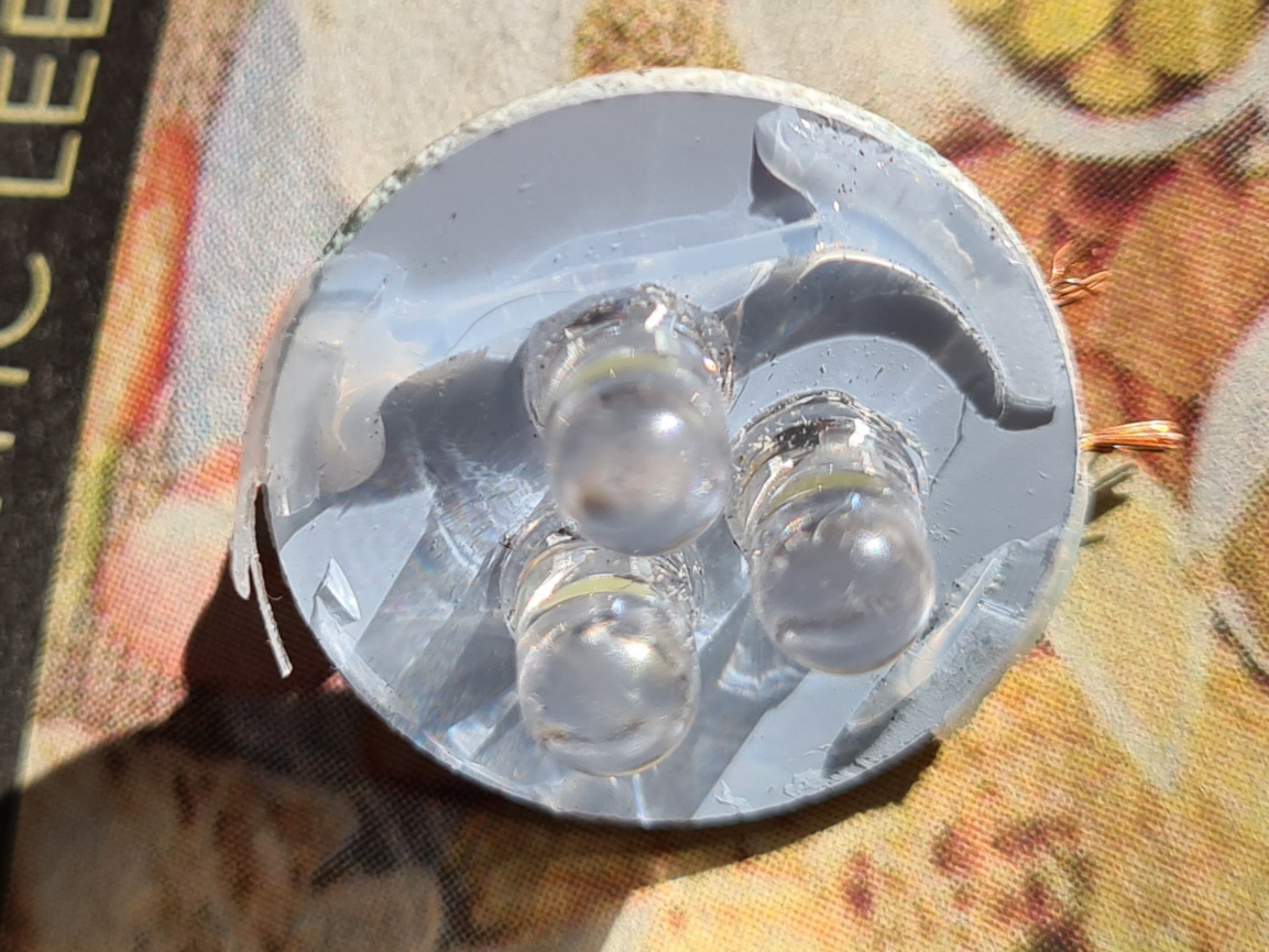

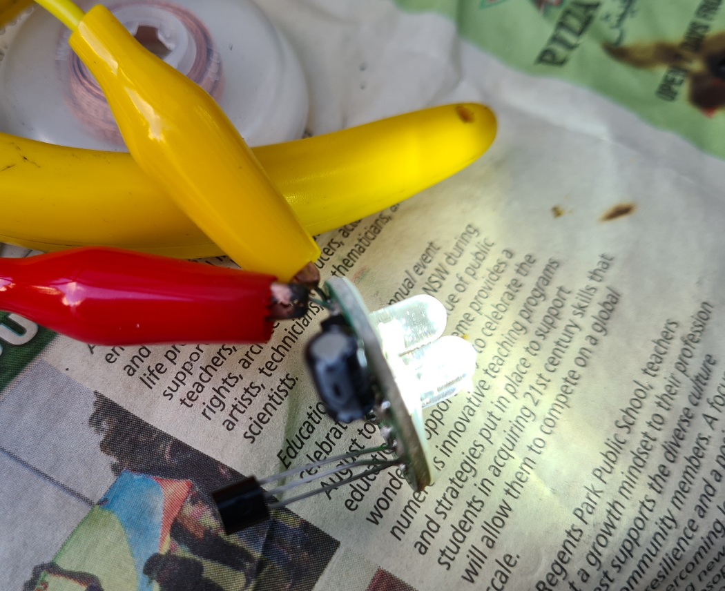

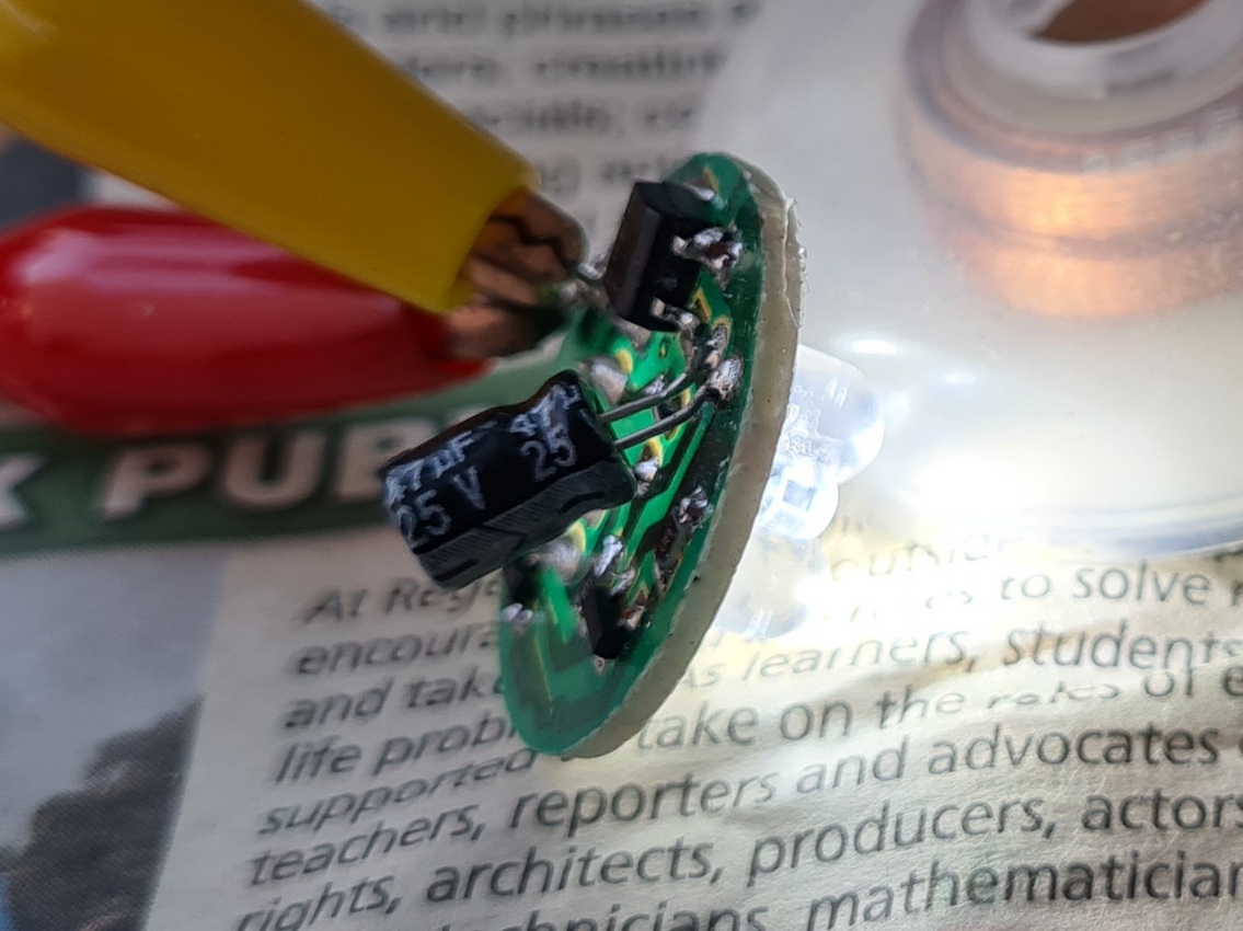

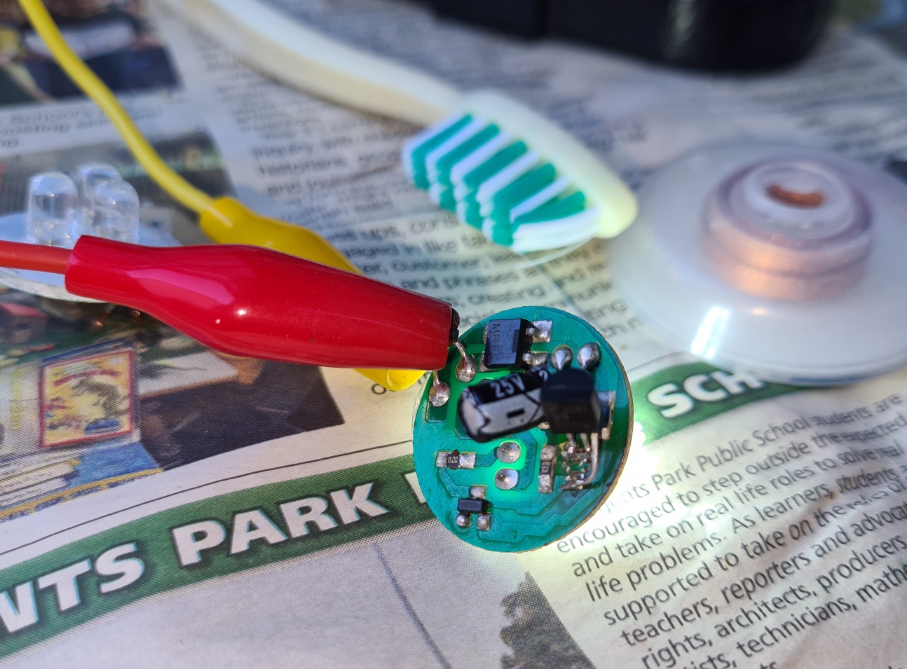

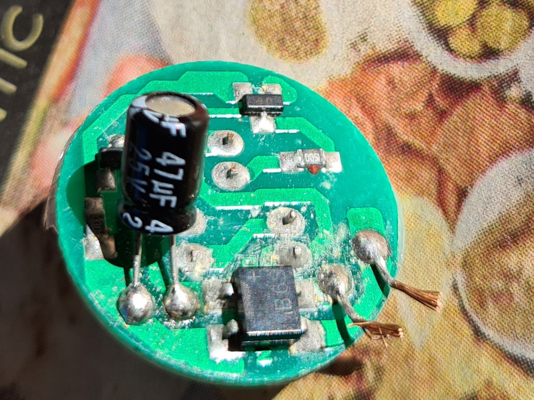

Two small led light modules. They are used to mark a low srep at night so people don't trip on it. They run off 12v ac. At first I thought it was corrosion due to water ingress (from a cafe on a warf). But even after cleaning and reflowing it still did not work. Seemed the smd transistor under the cap was faulty. Pulled it off and replaced with an equivalent to92 to see if it worked and it did. So I trimmed the leads and it will now be good.
The second one had a faulty led. Replaced with one in the parts box and it's good too. The leds are in series so one goes they all go.

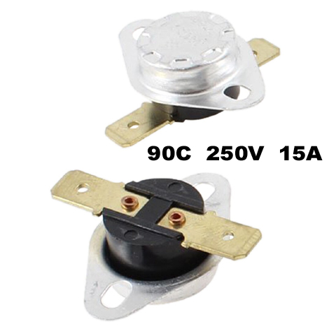

Today's job was to repair the bathroom ventilator fan up in the skylight.
I custom installed it a while back, but it crapped out as I was crapping the other day.
Basically, it's an older Sears 16 inch window fan, 3 speeds, reversable.
However I use it on exhaust low speed to draw air up and out of the skylight when it gets warm upstairs in the summer.
I designed an adjustable thermostat/controller that senses the room temp, and when triggered, it slowly opens the framed hinged glass skylight panel several inches and kicks on the fan above it.
The system works great.
But the other day the fan quit.... my first thoughts were that the aged thermal fuse in the motor opened up for no reason.
Yep!.... it was blown. - 105C/2.2A
No motor issues, it draws 60 watts on low at .45A
I replaced the fuse with a re-settable thermal switch screwed to the fan motor body - 90C 15A.
If any overheating should happen, it will cut off, and reset once cool.
No more ladder climbing!

Once tripped the polyfuse stays hot at a reduced current. So you have to break the circuit to let it cool down, then power up again.
What I replaced isn't a polyfuse.
It's similar to the thermal switches used in coffeemakers, that open when the water runs out and the element heats up.
Upon cooling down, it re-connects.
