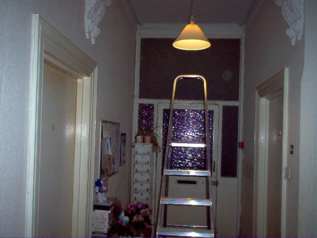

Minor crisis tonight. The hallway light blew... 🙄
I was confused because I thought 9.5W LED lighting worked for 10 years, and I surely installed this one about 5 years ago, replacing a dubious Fluorescent bulb which was slow to warm up.
Anyhow, dug up a new bayonet lightbulb and a ladder with some experimentation as to whether it might be an Edison screw.
All Happy Days now. And, FWIW, "How many Engineers does it take to change a lightbulb?"
Answer: One. 😀

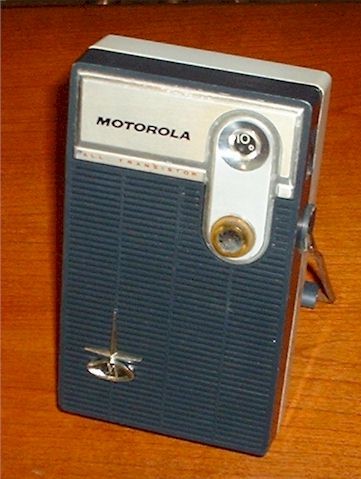

One thing not worn out yet is my STILL WORKING GREAT 1958 Motorola X-16B pocket radio.
Plug-in germanium transistors, nice full bodied tone, why should I toss it, it's a classic.

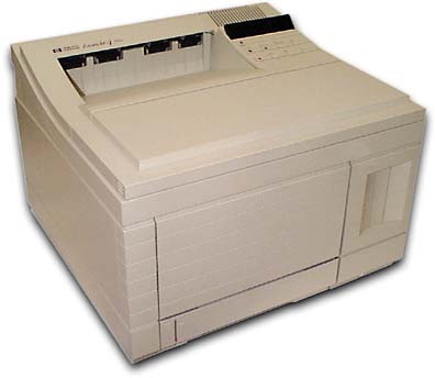

Funny you should mention that, because a few years ago, a friend gave me an old mid-90's HP Laserjet 4. (monochrome beast)
After repairing some minor issues with the display, the sucker works just fine, however I need to get a refilled black toner cartridge for it.
Does great for printing up schematics when I need them.
