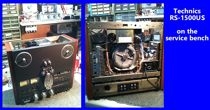

I finally got around to finishing up doing service on my neighbor's Technics RS-1500US reel tape deck.
The machine needed a thorough cleaning, re-lubing, and repair to the audio board - some lousy PUTZ with a screwdriver from hell apparently got inside and twiddled almost every adjustment pot - damaging several in the process.
Now, however, she sings sweetly again, up to spec, all the leaky caps are gone, and set up for Maxell and RTM tape bias.
If you don't know what you're doing, and don't have the proper tools and test equipment, stay the hell out of stuff, it makes my job 100X more difficult.
